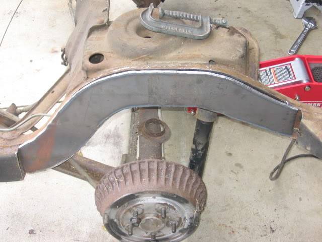

      Pics for now, ill explain later.

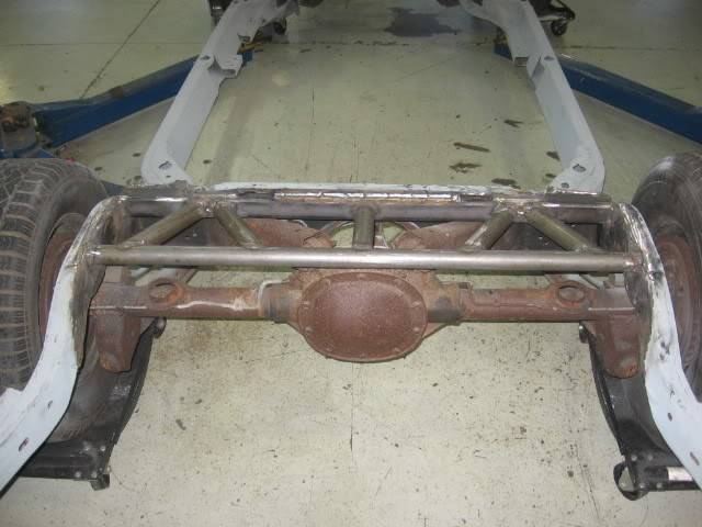

      Uhhhhh.........HUH? What gives with the axle cross bracing? Is this going to be attached to the diff or axle in any way?

      As you can see I have cut out the stock spring pockets. I replaced it with THAT. I ran a peice of 2x2 1/4 wall tubing under the stock UCA mounts. Then put in a peice of 1 3/4 in tubing for the coilover mounts. The bracing.
      More to come.

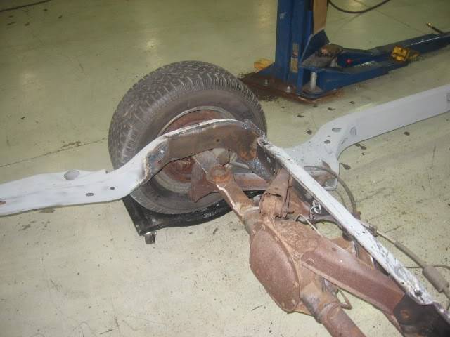

      jeff...looks awesome!! Do you have any comparison shots from the stock frame...to what you have now?? I like what you have done!!!
      Farmington Hills, MI
      1,038
      I think I do. Let me look.
      J
      JEFF SHORTT
      -IDEAL STEEL
      1,038
      This is the best comparo I have
      JEFF SHORTT
      -IDEAL STEEL
      Woodbine, MD
      2,770
      whoa.........
      thats awesome. i want...i want...i want
