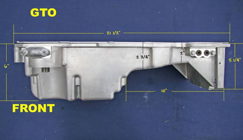

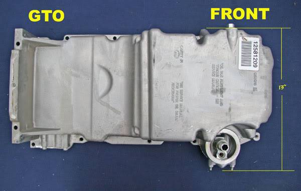

      I have read that a stock LS1 GTO oil pan will work since it is a front sump. GM part number 12581209

      I read that on LS1.com or LS1Tech.com. That is what people are using in other swaps that have crossmember issues. I have been researching my swap, and I just found that about the GTO oil pan. You might wanna try posting your question on one of the sites I listed above.
      This link shows the demensions of the GTO oil pan. I hope that helps
      Heres a couple of good links. Make sure to read the whole thing about page 4-6 are what your looking for.
