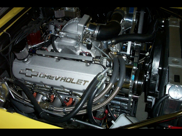

      You can still run a line to the regulator if you want; I never did and had no issues. I ran that setup on my Procharged 540 at 16 psi, ran fine.

      A fuel pressure gauge is in most of my cars. With the regulator out back I don't remember seeing any drop, as that would be an issue.
