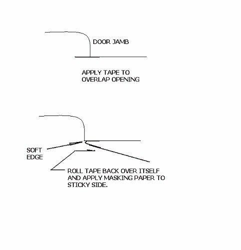

      If you don't want to see the overspray when cutting in the jambs the easiest way to get around it is called "back taping". Use a piece of 1 1/2" wide tape and outline your door opening, laying the tape so an inch or so is hanging into the opening. Once you get the tape in place grab the sticky side and roll it back over the taped edge. This will give you an edge to stick some paper too and, depending on how hard you roll it over, will leave a soft edge that feathers easily with a little wet sanding before you top coat the outer panels.

      You can do it either way. I have done it either way many times. The real issue is what type of paint are you spraying. If you are shooting an opaque (can't see through it) topcoat leaving the overspray isn't a bad thing. The problem comes into play when a translucent paint is being sprayed and any changes to the base coat, such as the double coverage you will get when cutting in jambs, will cause dark spots and noticable transitions where the first "coat" stops and the new topcoat picks up. This is impossible to control by free spraying the jambs. I will always use the back taping method to shoot the jambs first and THEN back tape the jambs when shooting the rest of the car. It is easier to transition the paint on a hard edge then in the middle of a panel.
      Of course it is easier to color match everything by spraying the jambs with the rest of it and only cutting in the front jambs which are much less noticable the the rears.
