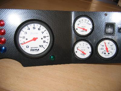

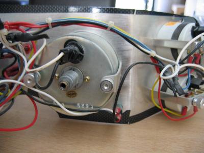

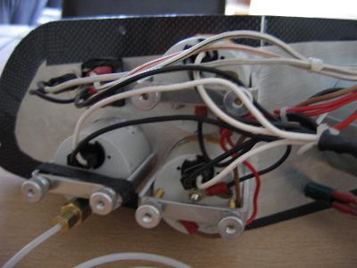

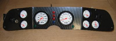

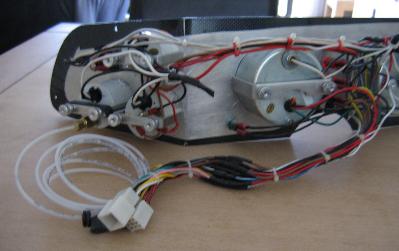

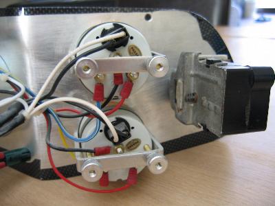

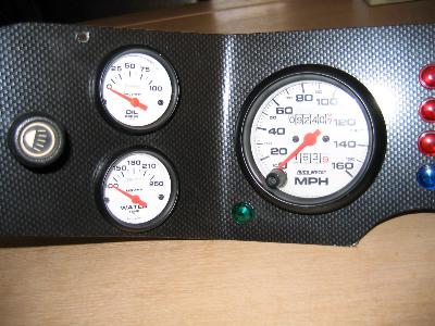

      won't be much different from my 71 Camaro....
      on my page I have pics of the dash build and a wiring diagram
      www.pro-touring.nl
      just go through the pages and you will find it (also gauge sizes are mentioned)

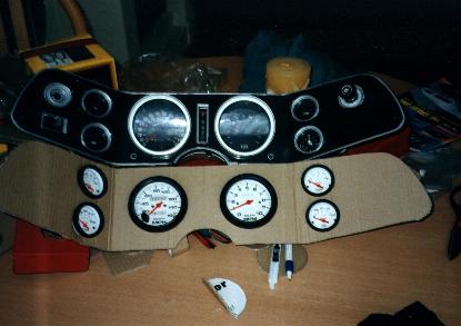

      hmmm, your dash isn't flat though & I thought, it's been a while, that the gauges were different sizes...no?

      I have 3 3/8" speedo 160mhp, 3 3/8" tacho 10.000rpm, 2 1/16" fuel , volt, oil pressure and water temperature meter and added a 2 1/16"boost/vacuum gauge a while back. I made the dash panel from aluminum plate and bend it into the proper shape.

      Wow, thank you very much for taking the time to post those pix!
