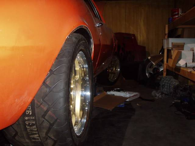

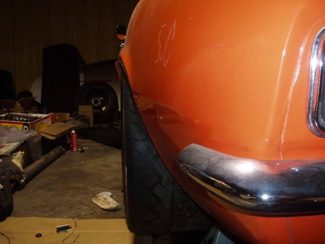

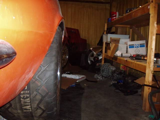

      My car is a 67 so the measurements will be off slightly.
      I am running an 18x 12 in the back with a 345/30/18 drag radial
      6 inch backspace, 56 1/8 axle flange to axle flange width.
      Add on the discs and that gives a total 56 5/8 total rear width.
      What I did: Order the wheels first in whatever offset you want, then stick them in the car on jackstands in the exact place you want them, then measure the width from axle flange to axle flange you need. Subtract a half inch for the width of two disc brake rotors and you have the width you need your axle.
      Here's my car at ride height:
      tucks nice when under compression

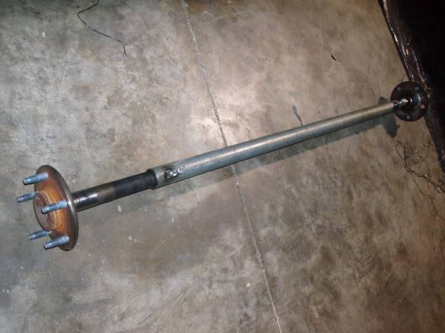

      Here's the tool I made to measure axle width. Two 4th gen Camaro axles, with the splines cut off, slid inside a tube, with jamb bolts welded to the tube. Bolt the wheels to this dummy axle, roll them under the car, expand or contract the dummy axle, then tighten the jamb bolts and measure it.

      Thanks chicane67, and Chris, by the way thats a great mock-up rearend ,it eliminates measurement errors and looks simple to make .
