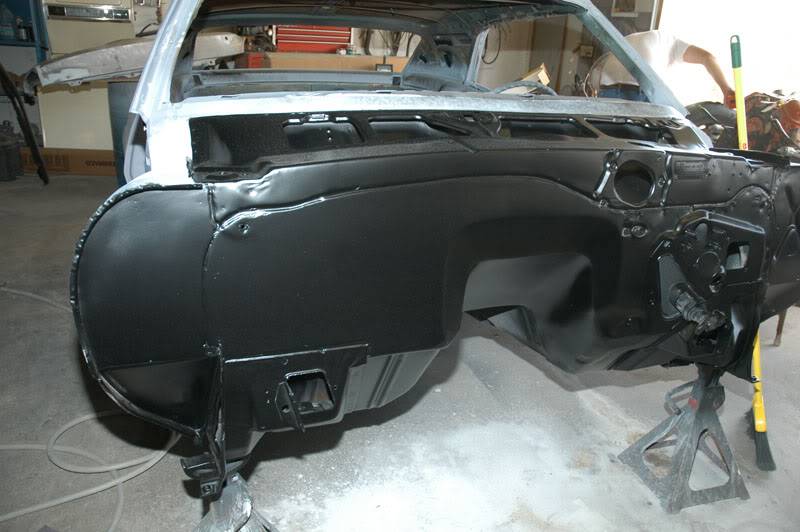

      smoothed out firewall:

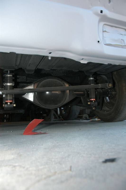

      DSE rear suspension:

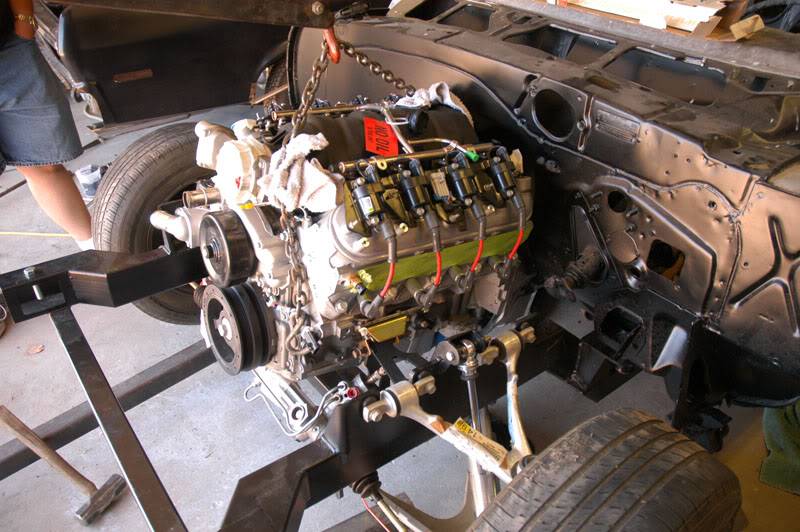

      21st Century Subframe:

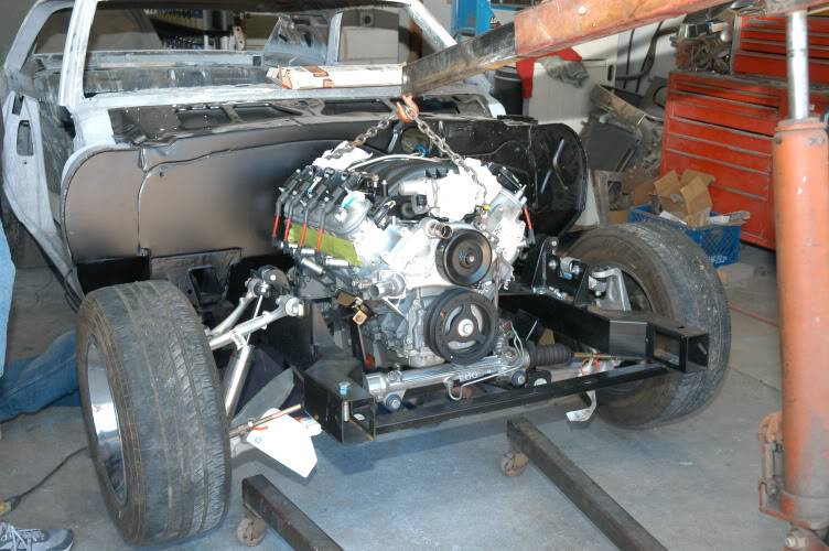

      LS7 in the car:

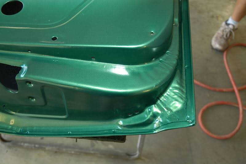

      Finally the paint color, and the pic doesn't do it justice. It is very similar to the stock Rallye Green, but it has a lot of pearl in it to make the car 'pop':

      Def looks like a killer project in the making...... What did you use to paint the firewall? Thats the look I'm going for on my Nova.

      Looks good man. Have you decided what you are going to do for a drysump tank?

      Steve, I wish I could show you more of the paint, but right now the only stuff getting painted is door jambs, etc. Painting the whole car is going to be one of the last things done.

      NvrDun71, I think it is just 60/40 semigloss black. I told the painter wanted a stock look, plus I didn't want to have to wax the firewall. I wanted it to just be a funtional and clean engine bay, without going over the top to make it look pretty. This car is being built to be driven.
      Haven't decided on a dry sump tank either, Philip. Intially I was thinking of putting it on the firewall, but I am not sure it will fit there. I like what they did on the Camaro X though by putting were the battery went. I'll have better idea of where I can put it after I see the car with fenders and wheelwells on it. This was just a trail fit to make sure no more bodywork had to be done. The bodyshop should be done in about a week, so it won't be too long before I can start measuring for it.

      I have a genereal query, though- Dooes the DSE firewall plate just go over the old firewall or do you have to cut/weld it in?

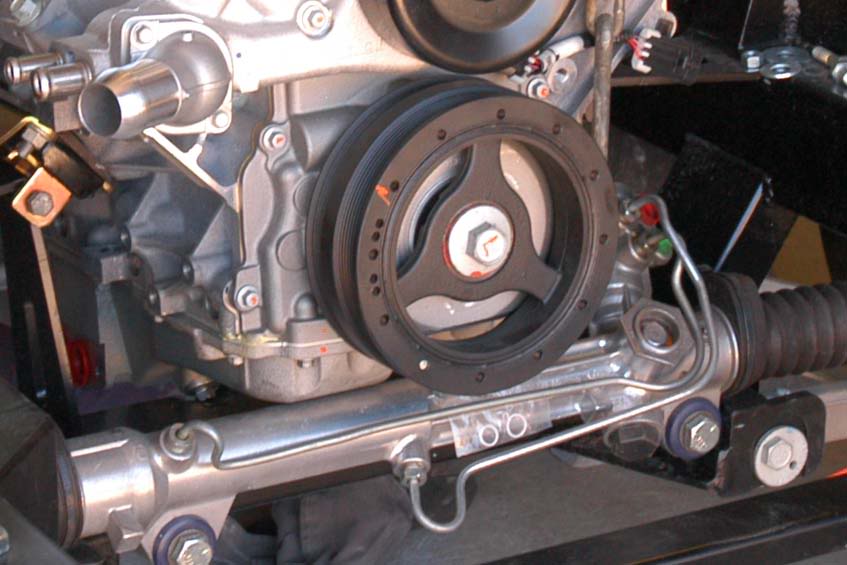

      Do you have a picture of the oil-pan to rack and pinion clearance? I have not seen a really good photo of the stock LS7 pan, and am not sure if I'll need to go with something else on my own car, it'd be nice to know in advance! Steve Rupp's car runs the 21st front so I have a good perspective of where the rack is, and better photo showing this would be super cool, and very much appreciated.
      Cool car, the "different" color is really going to set it apart, good choice!

      Y-TRY, we smoothed the firewall the old fashioned way, so I can't answer that question.
      Mean69, the rack is really close to hitting the pan; 21st Century actually built the frame to raise the engine about 1/4" to get the some clearance. They also notched the crossmember so that you can use the front oil drain plug. This is the best pic I could find of the rack clearance:

      I feel exactly the same way about the car being a "different" color. Initially I was thinking blue, and then we got a car that was Rallye Green. After going to a few car shows, we just decided that we didn't want another blue or red Camaro.

      We actually went through 3 racks before we found one that would clear the oil pan. The rack castings vary in diameter buy up to 3/16. What we did on you frame was build it using big block motor perches, which raises the motor by a 1/2 inch from our standard lsx position.

      How about adding a 3/8 plate or any size spacer between the block and engine mount (engine side) to raise it to where you feel comfortable with space. That looks real close and unless you are running solid busings won't it flex?

      Wow, that is really tight. I haven't seen Steve's car with the engine in it in person yet, but his is darned snug too, I know he had to use an LS1 pan on his LS2 motor.

      Thanks for the pic, very informative.
