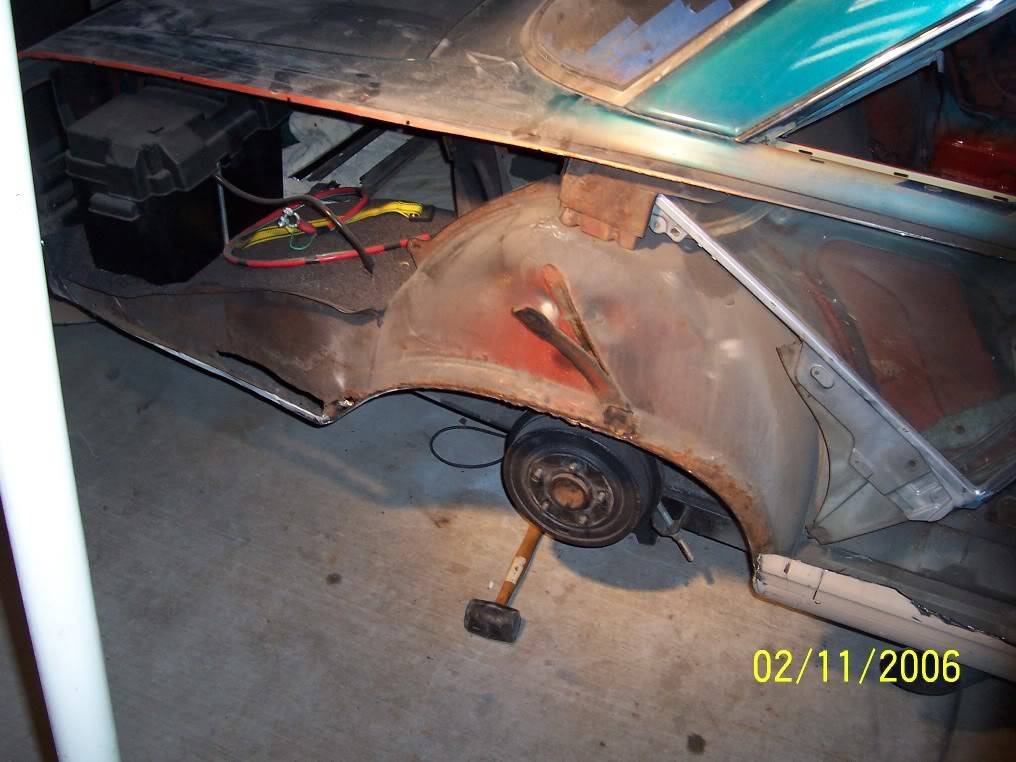

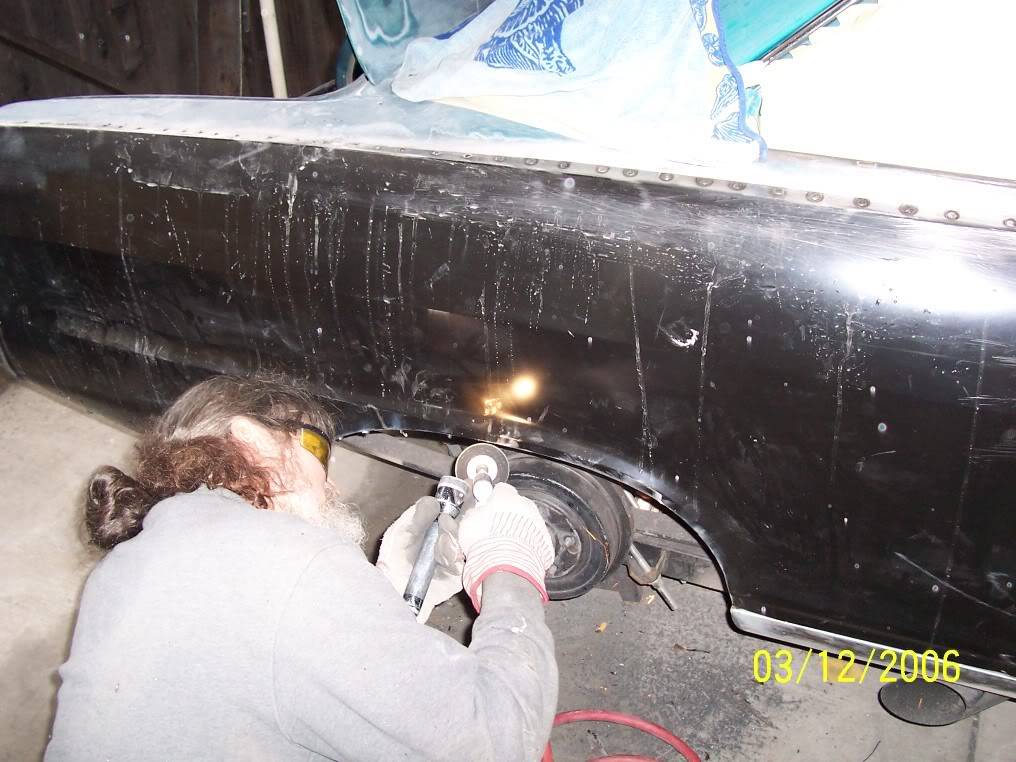

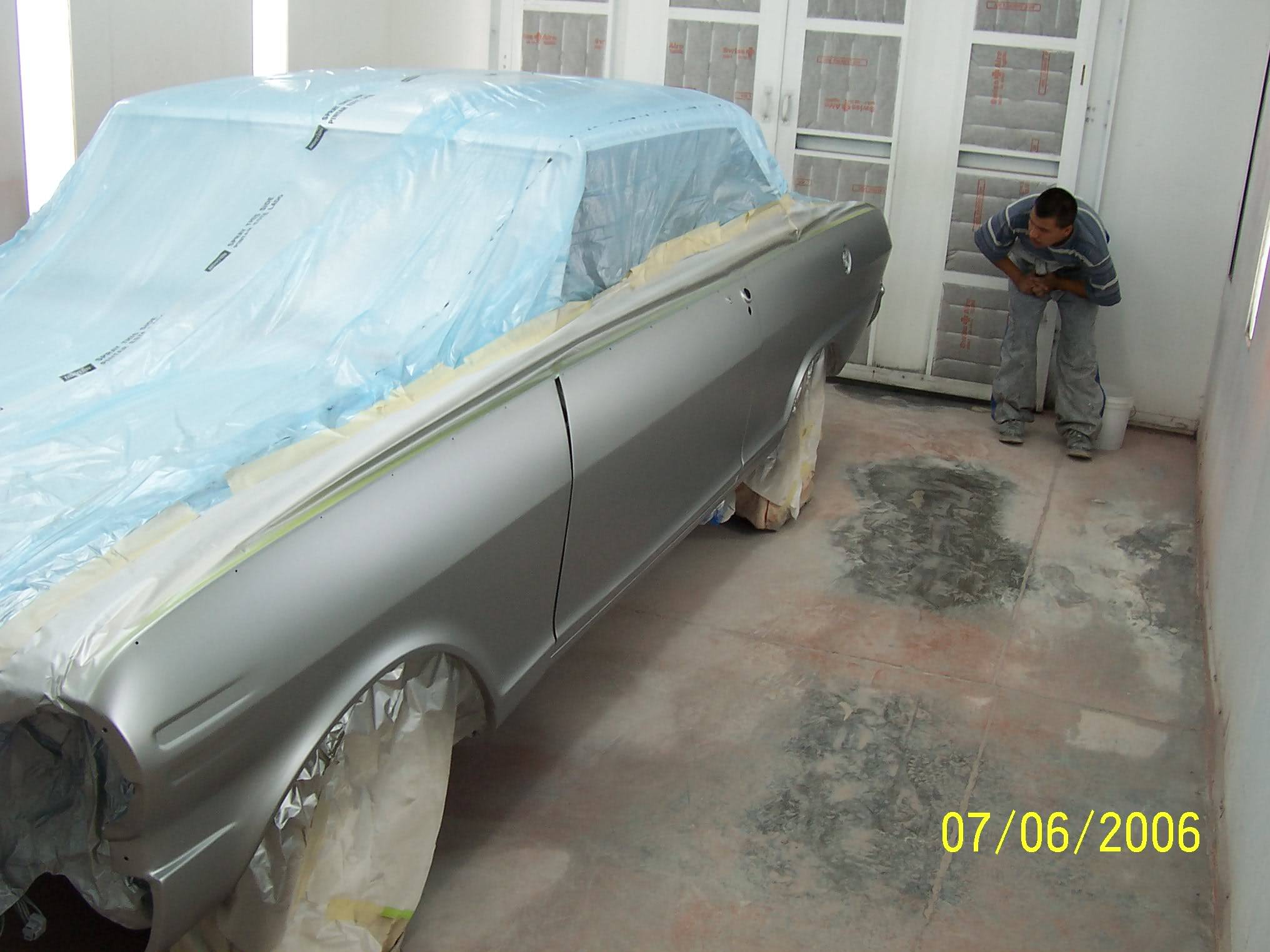

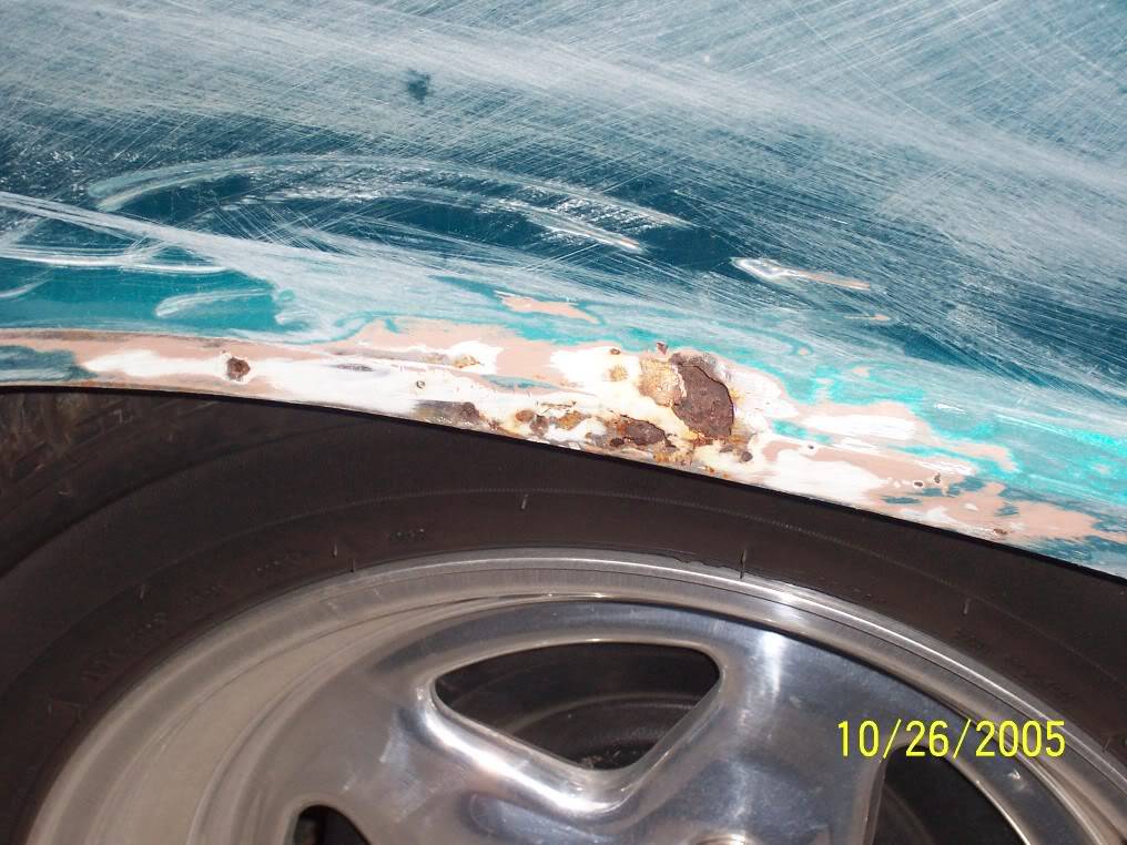

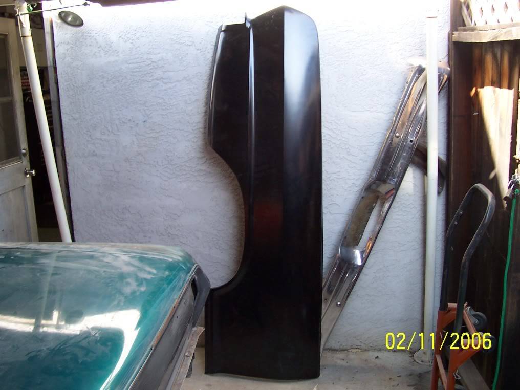

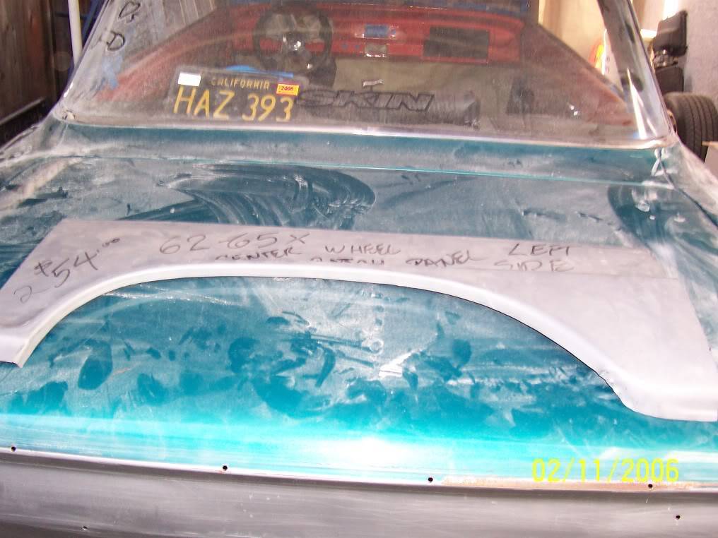

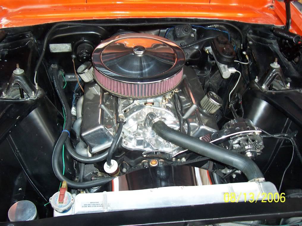

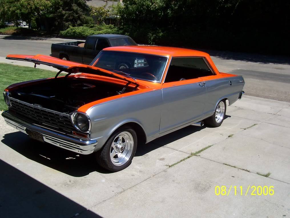

      well its done after about 2 years on and off or whenever i had money for it. heres a little info on what i have done. front end all new 5 lug with disk brakes and new polly bushings,new rearend with 3.73 posi. new gm crate 350 with pete jackson gear drive diff cam and roller lifters and roller rockers. new th350 with shift kit and 3500stall convertor.

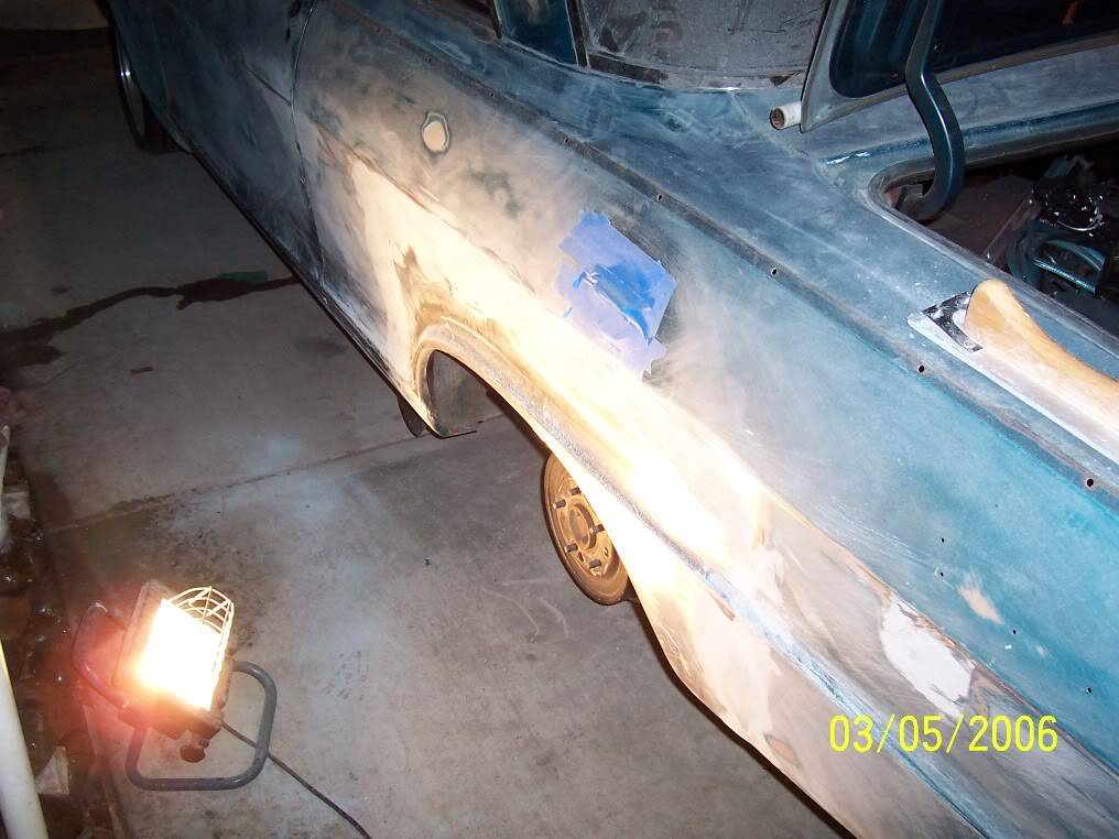

      body: new quarter panle and fender wheel secsion and new driver side fender. all new crome and new bumbers headlight bezzles ect
      the paint is hok tangelo and platinum silver. here are some build pics
