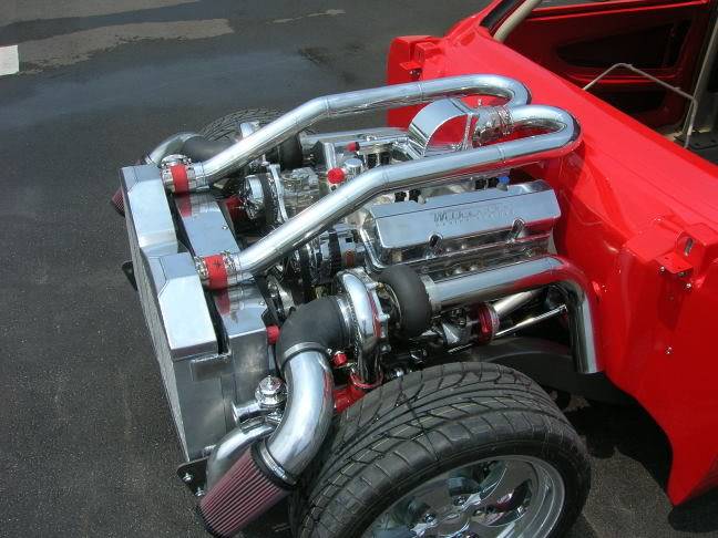

      Is there a benefit to bringing the air from the intercooler into the hat from the back, or is just an appearance thing?

      Why is the intake mounted backwards with the pipes plumbed around it?

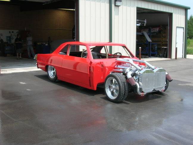

      With the radiator completely eclipsed by the air to airs, does cooling capacity go to hell as charge temps increase?

      Having the throttlebody and such mounted around the back doesn't do anything but make for a cleaner install. The Twin tubes from the IC are nice and symetrical, and you're not staring at the TB, linkage, sensors, etc.
      Yes having the IC mounted in front of the radiator makes it quite a bit harder on the cooling system. Normally you should venture on the bigger side for the radiator and make sure there are massive fans on it, as there is very very little airflow through it till you're up at highway speeds.

      Quote Originally Posted by derekf
      Nice.
      The throttle body elbow has a couple degrees down angle and was causing a problem with the waterneck.

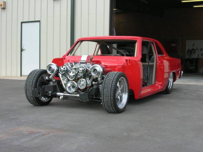

      Shay? Is the chassis all custom made? I thought the front end looked kind of like one of Chris Alstons although the shock mounts look different.

      That is awesome. I wonder though, why did you run two tubes from the intercoolers to the throttlebody instead of joining them close to the coolers & run one tube to the front side, instead of looping it around to the back?
