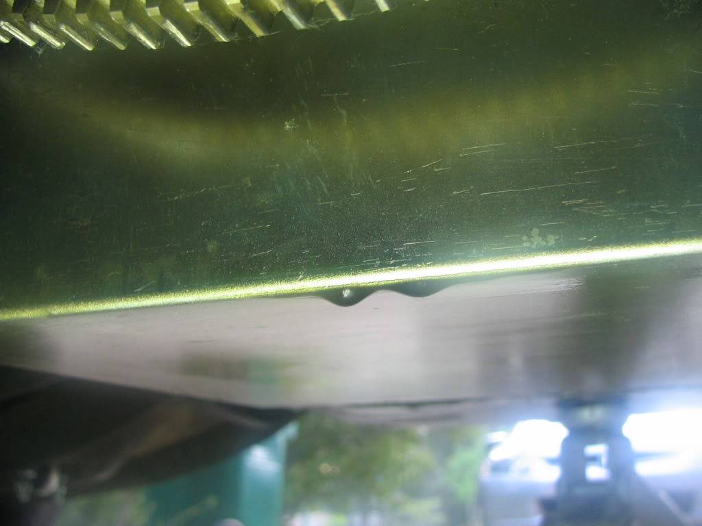

      This is the source of my latest frustration... if you look close you will see the hair line crack.. Just above the drip. What in the world causes this... All I know is that I was cruising down the road when all of a sudden tons of smoke started pouring out from under the car. When I parked it I saw tons of oil pouring out of the pan and 2 days latter when it finally stopped dripping this is what I found....

      Could be a couple things.
      a) Bend radius is too tight.
      b) The mfr got a lame batch of metal.

      youre either stuck pulling the engine and swapping the pan or drain the oil and weld it up. sucks though since you spent the $ on a nice pan, milodon will probably want it back to get a refund or replacement.
      Do NOT weld on an oil pan if it has ANY oil in it. It WILL catch on fire.

      I saw that once, the pickup was set too deep.
      Did it hit/rub the pan?

      Yeah, I should have said it bottomed on the pan.

      Who built the motor? Or more accurately, who installed the pump and pan?
