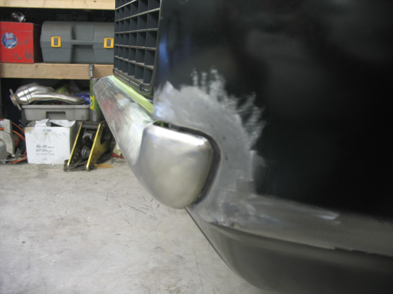

      New hidden bumper mounts finished. Ready to fill the stock bracket holes in the lower valance.

      Front Bumper is done!! The holes where the bumper bracket goes thru is covered up also. There will be some more mods to the front but thats it for now.

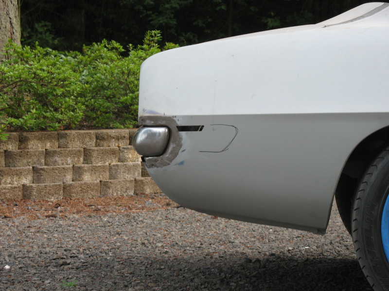

      They got the car outside for a couple pics.

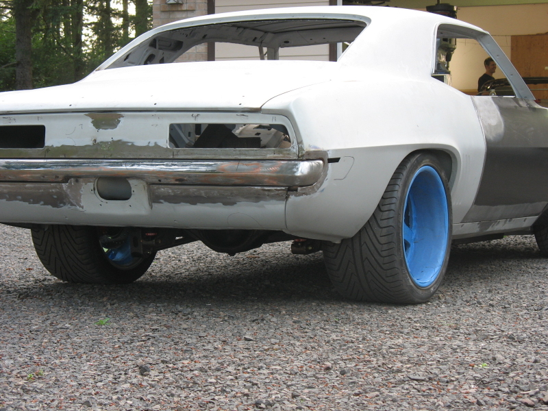

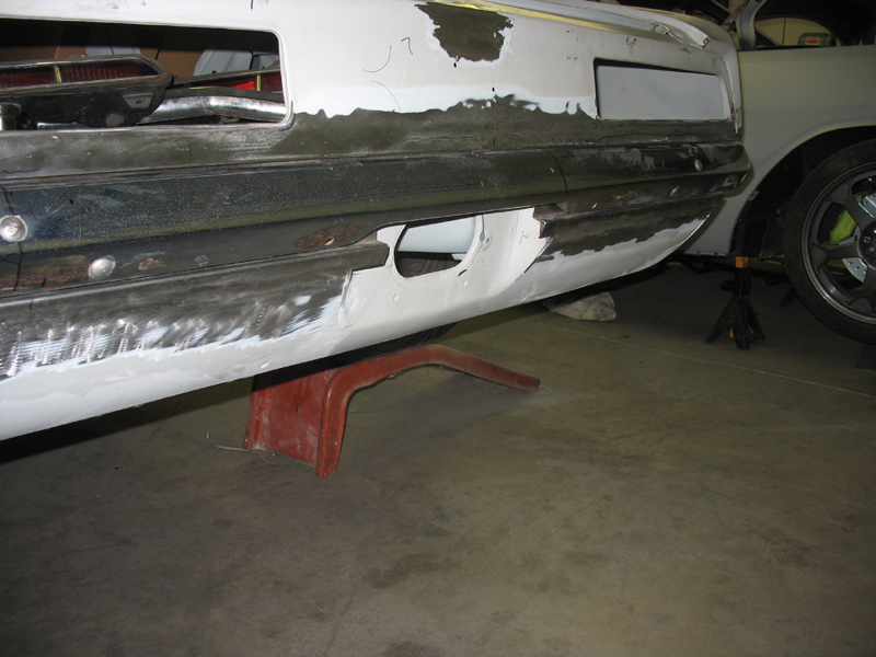

      Rear Bumper updates.
      Rear tail panel was cut and a channel was made for the bumper be recessed in.
      The car is really starting to take shape. It really does change the whole look of the car.
      Things will get trimmed and smoothed out and it will flow better.

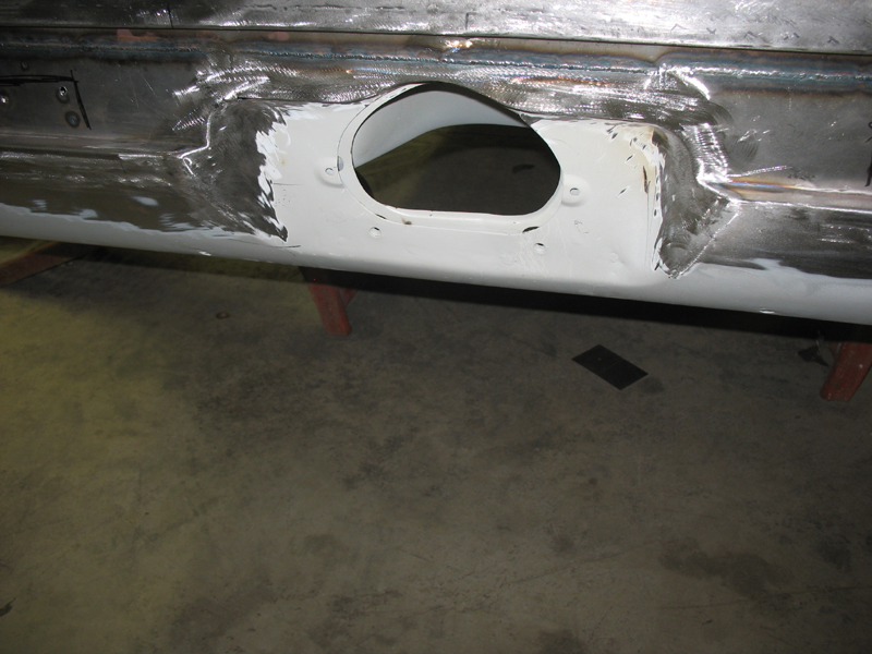

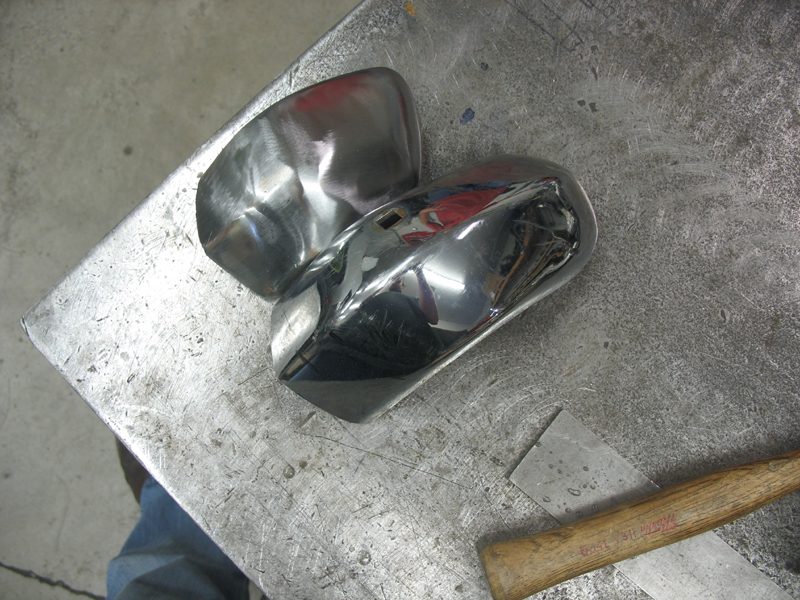

      Most of the trimming is done on the tail panel.
      Also I didn't like the way most of the camaros looked with tucked bumpers the ends have way too much of an arc and look like an old truck bumper. So Tim and his awesome abilities at metal fabrication, hammered and reshaped the ends of the bumper. Giving the front and rear more of a matching appearance.
      Just look at the difference between the end of the new reshaped one vs the stock end.

      Are you going to re-chrome those bumpers ?
      What I don't quite understand about reshaping bumpers is how you manage to metal finish them smooth enough for chrome. Is that the real secret, you just have to be super good at the metal finishing ?
      Maybe I don't understand the chroming process but I wouldn't expect it cover any flaws in the metal.

      Quote Originally Posted by preston
      watch power block more they have showed how its done also recent episode of muscle car when they tucked the bumper on thier impala project and sent it off for chroming
      they will sometime fill areas with lead and grind smooth, but there is alot more to it.

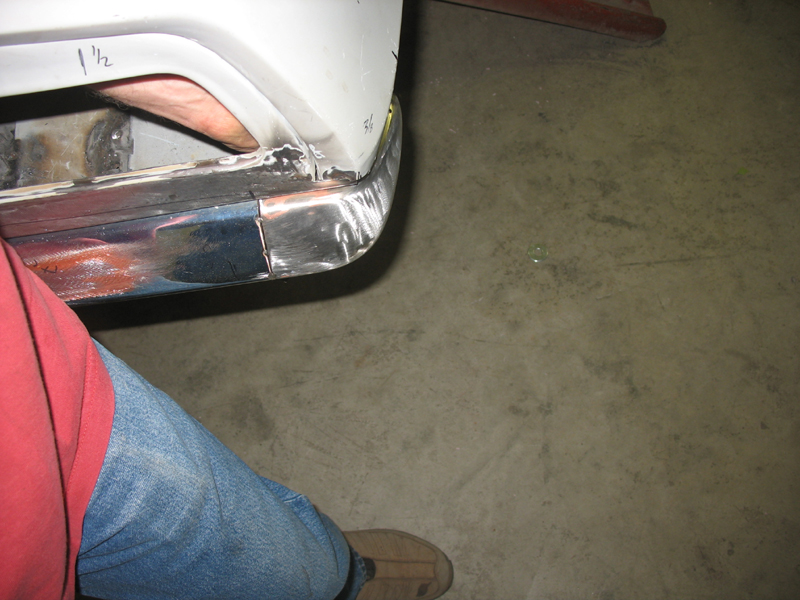

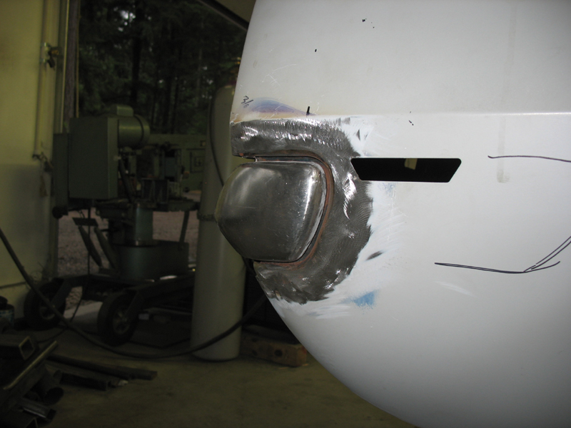

      more shots of the rear bumper and shows how the ends were reshaped to give the bumper more of a similar look to the front. The stock rear bumper just looked to much of a bubble.
      I like how they use the quarter panel as a sketch pad.
      This shot also shows where the license plate recess on the bumper was shortened to match the opening in the rear valance.
      From the factory the bumper opening is wider than the valance.

      Dang, Tim is good at working metal
