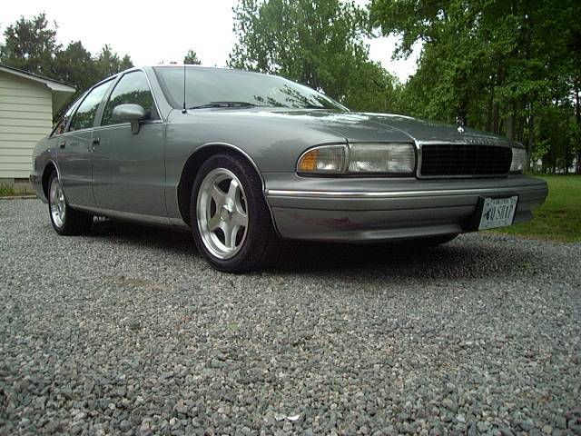

      i just did the ones in my caprice ,i would go 1/2 a coil till you get the height you want ,i cut one full coil for almost 2 inches of drop ,but i have a little more weight so just do a lille at the time ,it sucks ,but i know mine turned out just right ,i also rebuilt my entire suspention up front so that helped
