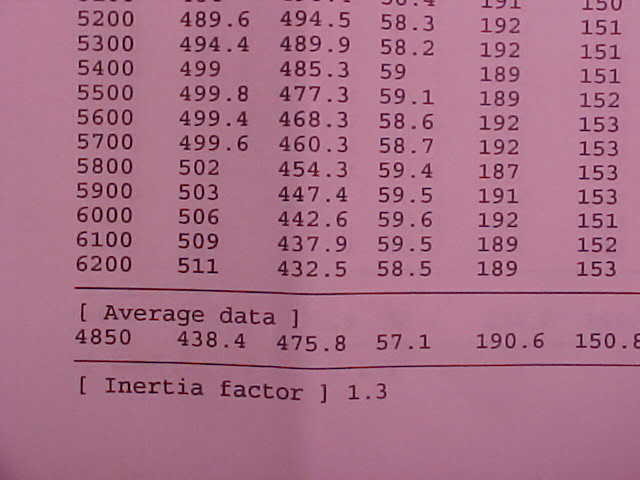

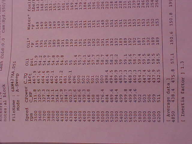

      I have had these for a while just never got to post them. This motor was dynoed about a month a go on 87 octane. Many peopel say that it will gain more horse when run on 91. I wanted 550-600 but every 17 year old onyl wnats more more more. I ahve to keep reminding myself that its ALL ALUMINUM. Oh and new camera is coming...sorry

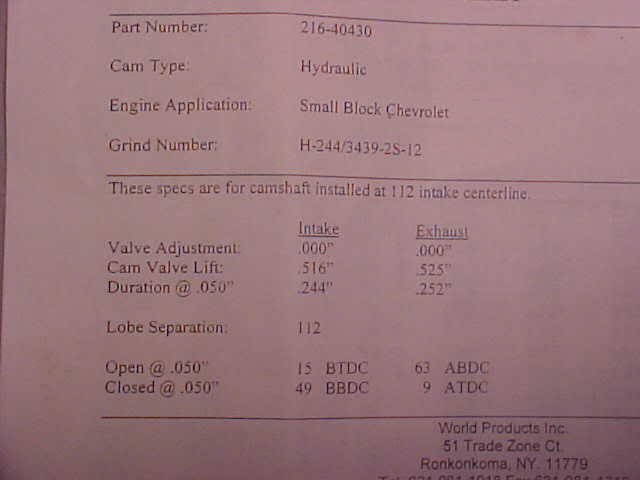

      Heres detailed engine info....
      SPECIFICATIONS:
      ENGINE BLOCK: Motown 9.025” deck height 4-bolt main
      CRANKSHAFT: Eagle 4340 forged steel 3.875” stroke (415 engine) 4.00” stroke (427 engine)
      CONNECTING RODS: Eagle 6.00”
      PISTONS: JE/SRP forged 4.125” bore
      COMPRESSION RATIO: 9.5 to 1 (415 engine) 10.0 to 1 (427 engine)
      PISTON RINGS: Speed-Pro
      BEARINGS: Clevite H series
      CAMSHAFT: Hydraulic Duration @ .050 is 244 intake & 252 exhaust. Lift .515 intake & .525 exhaust. Centerline is 112
      CYLINDER HEADS: Motown Aluminum or Cast Iron 220
      VALVES: 2.08” x 1.600” Manley valves: Severe Duty intake & exhaust
      ROCKER ARMS: 1.5:1 ratio roller rockers (Aluminum heads utilize a .150 offset intake rocker)
      INTAKE MANIFOLD: Motown 4150
      CARBURETOR: Hardcore 870 cfm. Hi flow 4150 style carburetor
      IGNITION: Hardcore HEI distributor, Taylor Motown 8mm ignition wire, Accel spark plugs (276 for iron heads and 416 for aluminum heads) gapped @ .035
