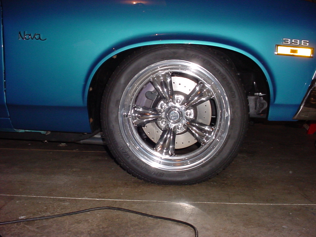

      I'm running 17" TTIIs with the Touring-Classics "Hybrid" kit (13" C4 rotor). I have ~1/8" of clearance between the wheel and the C5 caliper.
      http://www.touring-classics.com/C5%20kit.htm
      http://www.danhardison.com/discs/DSC00870.JPG

      Quote Originally Posted by dhardison
