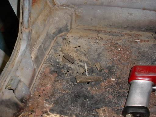

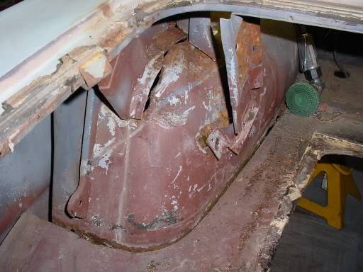

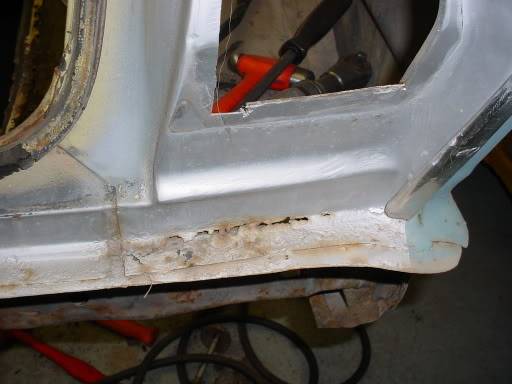

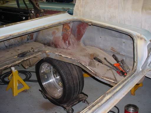

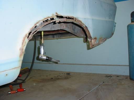

      Not much to show yet, but I'm pleased with any progress at all right now. The car's in the shop and we're cutting the wheel wells out to fit the 285-40-17's and measure to order the 9 inch. Then install the truckarm suspension and finish the min-tub. You can see the rust problems I have to replace, new quarters are ready to install. My four year old son was really impressed with the "turny things that spin" on the front of the car, LOL.
