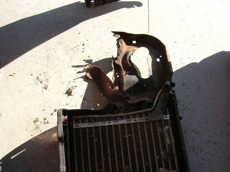

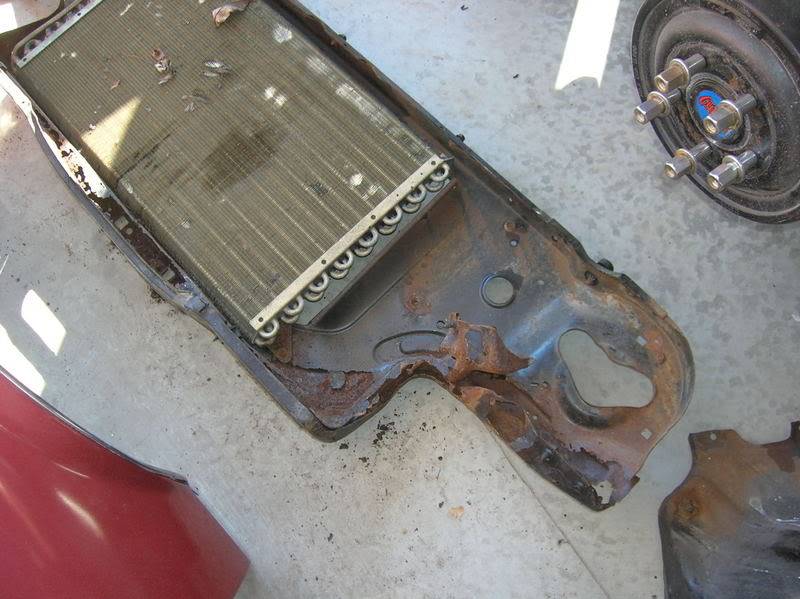

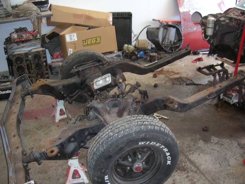

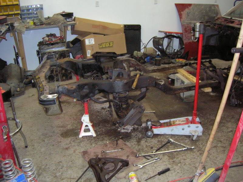

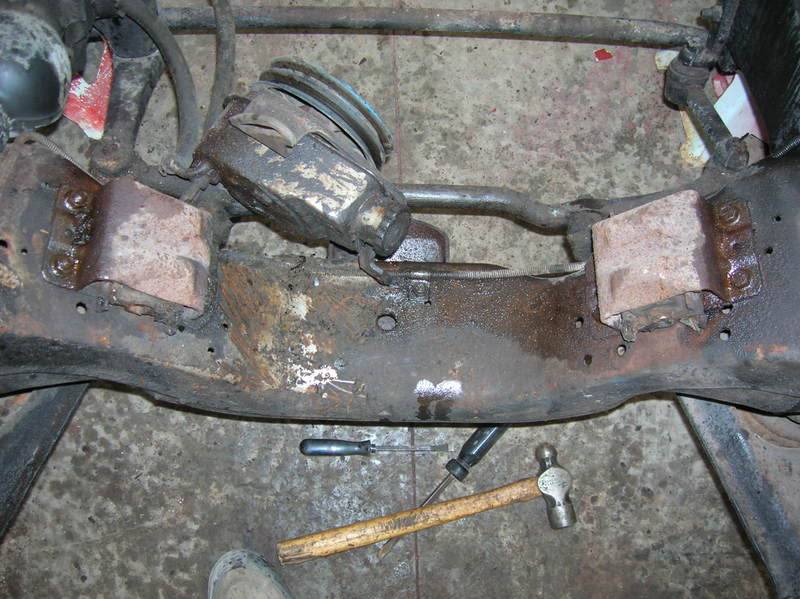

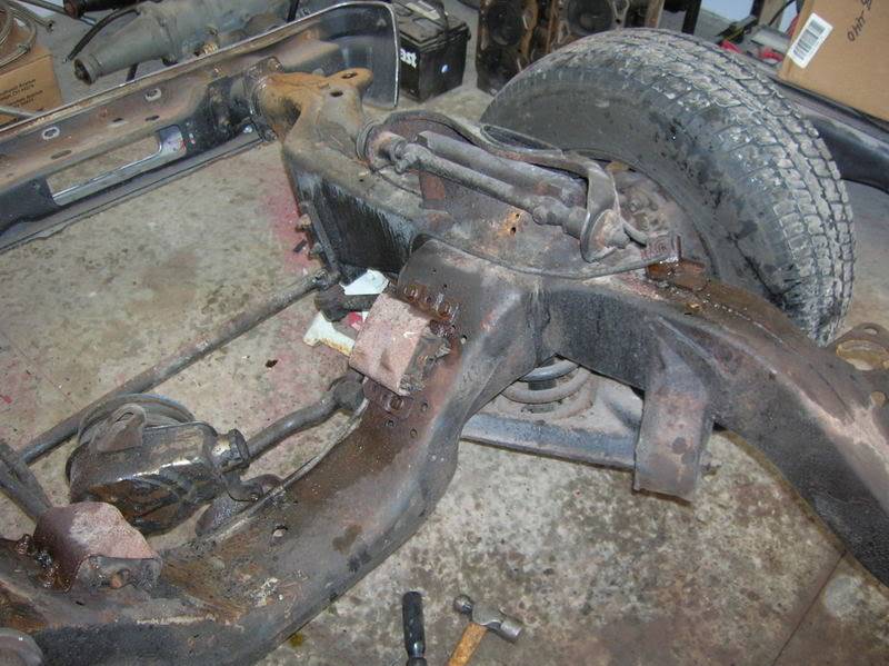

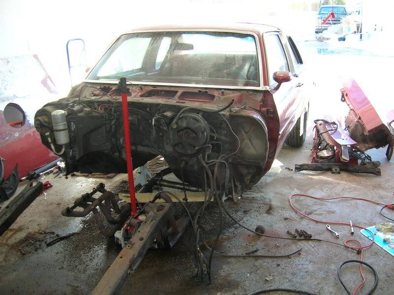

      I know this is an old thread, but I'll revive it. I am working on a '77 Pontiac Ventura. What started as a simple engine swap as grown out of control. I am looking to see if the tall balljoint will help when I reassemble the front subframe. Here are some pictures for everyones enjoyment...
      and the reasons for all of this fun...

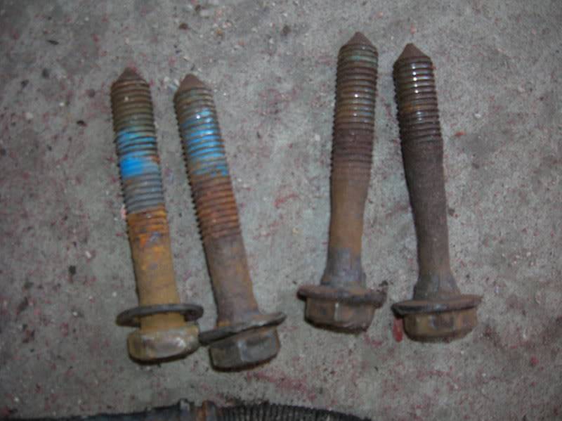

      toasted subframe bushings ( here are the bolts)
      and the core support was completely rusted. the body bushings were long gone.
