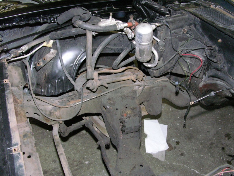

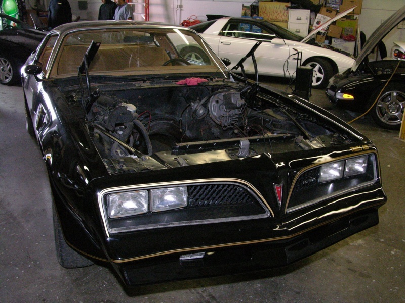

      Not a huge step, but it's a step ... the old Poncho 400 is out. The car has much more ground clearance now!

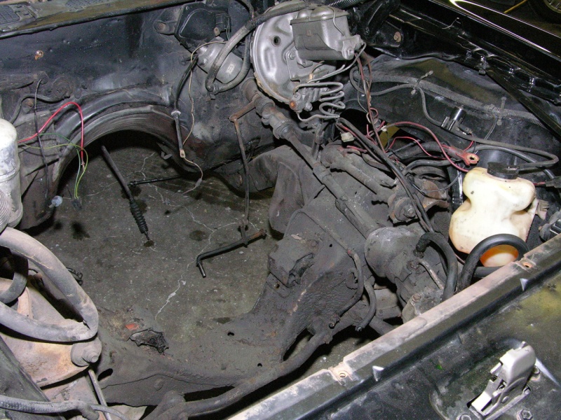

      It was really disappointing though after I pulled it. It looked pretty ugly in there. For what the restoration shop charged me, he should've sand-blasted and powder-coated all of that, or at least given it a good cleaning! And all the suspension parts look kinda shot (hence my thread in the suspension forum ). Now I'm left with the dilemma of whether or not to go ahead and have someone drop the subframe, blast it and paint it. I'd like to, but it's yet more money which could be put to functional/performance mods.
      I know it's kinda tough to say from the pics, but I'm curious if any of you think anything else needs to be replaced besides: control arm bushings, ball joints, sway bar bushings, sway bar endlinks, springs, shocks and possibly upper control arm (and of course I'm adding SFC's and solid body mounts).

      IMO, One of the best things you can do to clean up the eng. compartment is to get rid of the stock heat and a/c, install a vintage air unit, really cleans up the firewall getting rid of the fact. "evap suitcase" definitely a lot of work making the gen 2 compact to fit, but worth it.

      Hey Bandit78, I would drop the Sub Frame, look how nice the above pics look.

      I would drop the subframe and blast it, powdercoat it, all new bushings, blast the radiator support and paint it. but to save money, you could get rid of the AC unit, and buy a heater box from American Graffiti so you still have a blower motor and heat for the cold nights. vintage air is expensive :(

      Looks good, there is no time like the present to drop that subframe, maybe a little extra money now, but when you look at it in 1 year or 10 years from now and wish that you had done it. That being said, I am pretty utilitarian and it wouldn't bother me that much if my subframe wasn't nice and painted, depends on what kind of person you are.

      Yeah, I know ... like I said I'm trying to figure out what to do given a constrained budget. I can make the subframe look really nice or I can use that money for functional/performance mods. And since someone else is doing the work, pulling off the fenders, dropping the subframe, blasting it, painting it and putting it all together is not going to be cheap. If I was doing it myself, that'd be a different thing.
      Yet it really bugs me to have it like that .... Sigh.

      In terms of "more things to do" - one of the things I was concerned about was the steering linkage. I'm not sure if there's anything in there I should consider replacing.

      It is really amazing what a power washer and a spray can or 2 of paint will do Taking it all apart is a lot more money and time that it sounds like you might not have, but like has already been said " no time like right now" to do it nice.

      i agree a can of Easy Off oven cleaner, pressure washer and a weekend - way too much work to drop and all - it is a driver not a trailer queen , you decide you will be happpy with the results but you gotta do it now while its out

      I'll second (or is it third?) the suggestion for oven cleaner and a power washer. Follow that with some John Deere Blitz Black spray bombs and you'll be set. Sure, it's not free, but it's pretty cheap. You'll regret it if you don't clean it up a little.

      Thanks for all the advice guys! Hadn't thought of using EZ-off! I think the power-washing will have to be in the middle of the night to avoid calls to the EPA. At the moment the power-wash, ez-off and some quick paint sounds like a reasonable compromise. Now I just have to figure out how to do that! Since there's no engine, the only thing I can think of is trailering it to a car wash or something.

      I'll answer Zee and Bonzo in a bit, I gotta run right now, but I do have a question on the power-wash and spray can. In addition to the dirt, there's also rust. Is it going to be an issue if I spray-paint over rust?
      And the John Deer paint - where can I get that? Auto store, Home Depot .. ?
