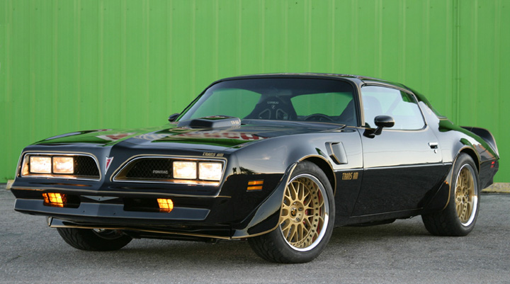

      FYI. Here's a pic of the wheels I'm getting. Full credit should go to the owner of this vehicle (I think it was Trev on transamcountry.com). His car looks just like mine and when I saw the wheels he chose I just *had* to have them. I almost shorted my keyboard out with drool.

      I would go with the 10.5" also. with that bs I think that you would have the rim sticking out of the fender with the 11". Just my .02 cents but I have 6" fo bs on my 11's and they are right flush with the fender lip.
