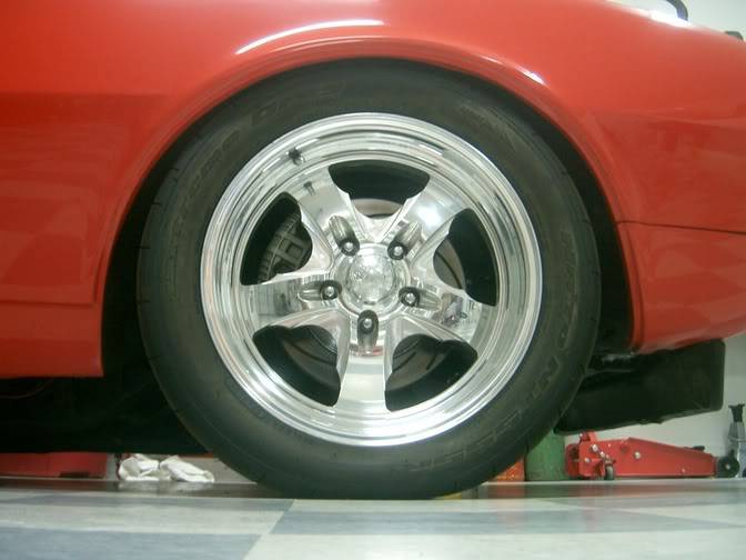

      How about some pics of your front end with profile and front view. What was the BS of the 7" wheel? 7" wheel seems small for a 245, does it create sidewall bulge? SS

      i'll be getting 8" up front down the road but these work for now.
      BTW, i am now a somewhat competent electrician and UV protection is required when entering my garage.

      Thanks for the pics ( nice shop by the way, I could use some more room and light).
