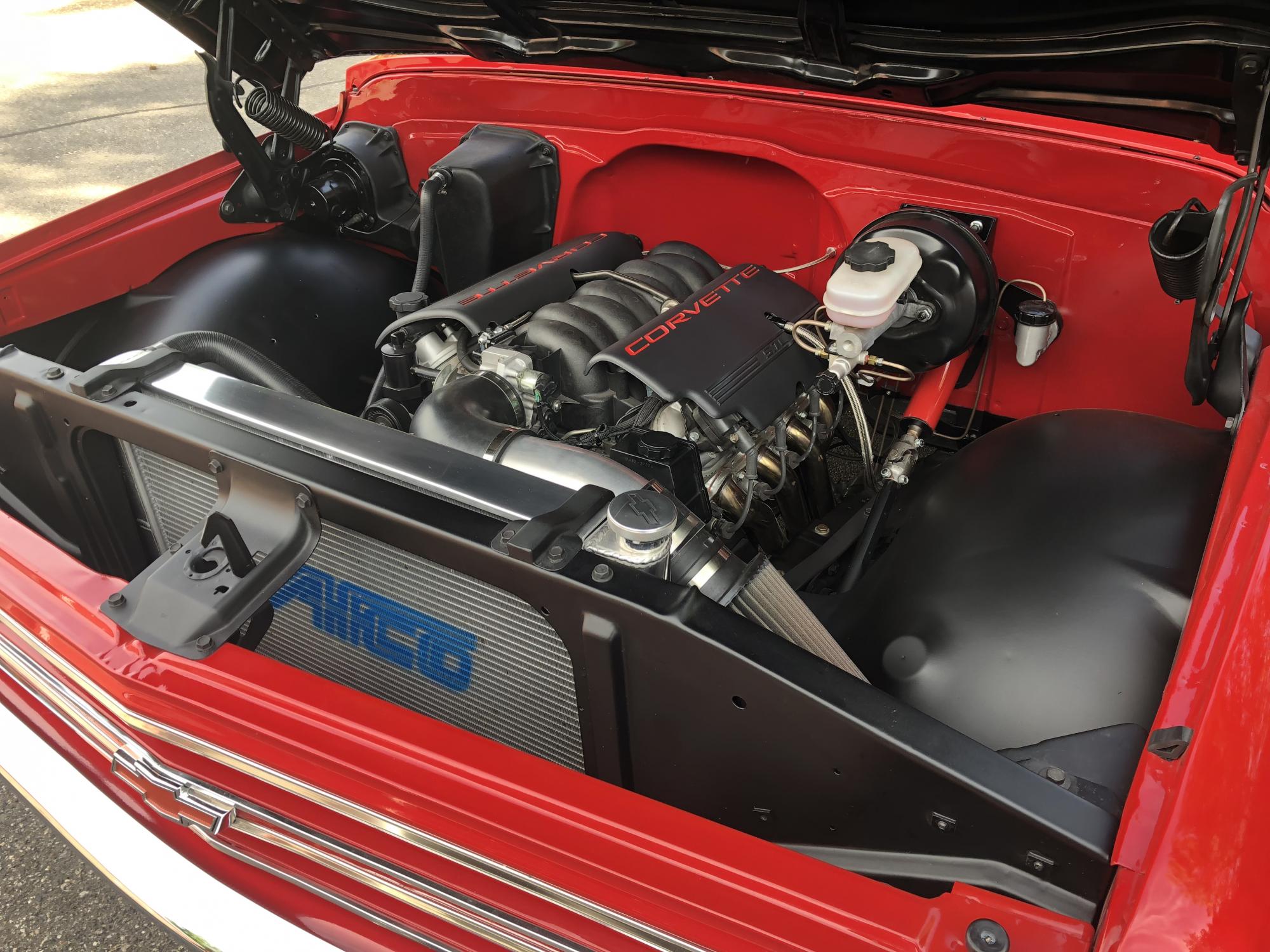

      I've used the C5 booster with the DSE adapter mounting bracket on a few swaps. 80 Camaro and 68 C10.
      I buy the the booster and master at NAPA. Lifetime warranty.

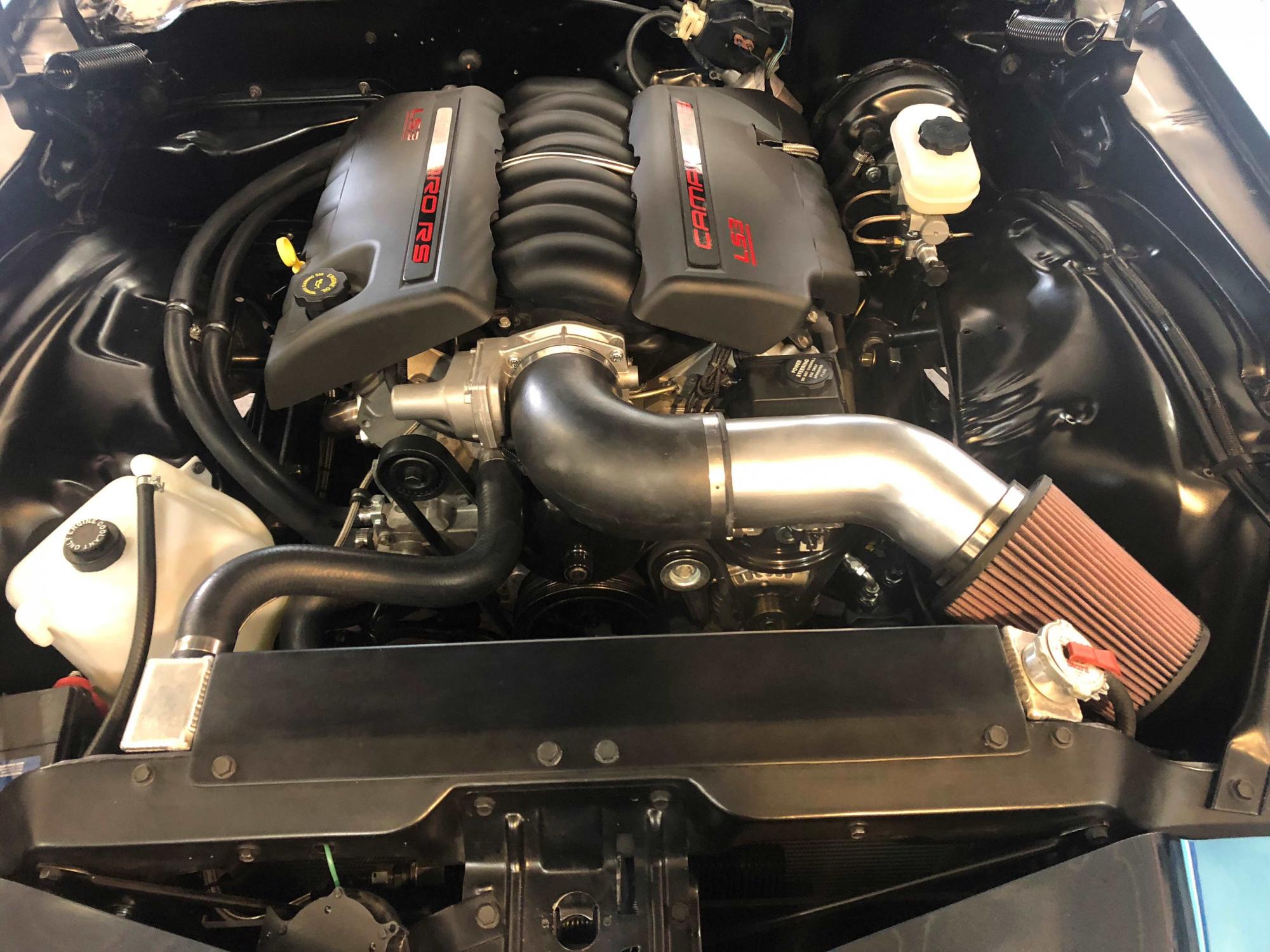

      I do use a 2002 Camaro master to get the brake linesName:  IMG_0214.jpg
Size:  362.3 KBName:  IMG_0816.jpg
Size:  319.7 KB on the opposite side. Wilwood prop valve.
