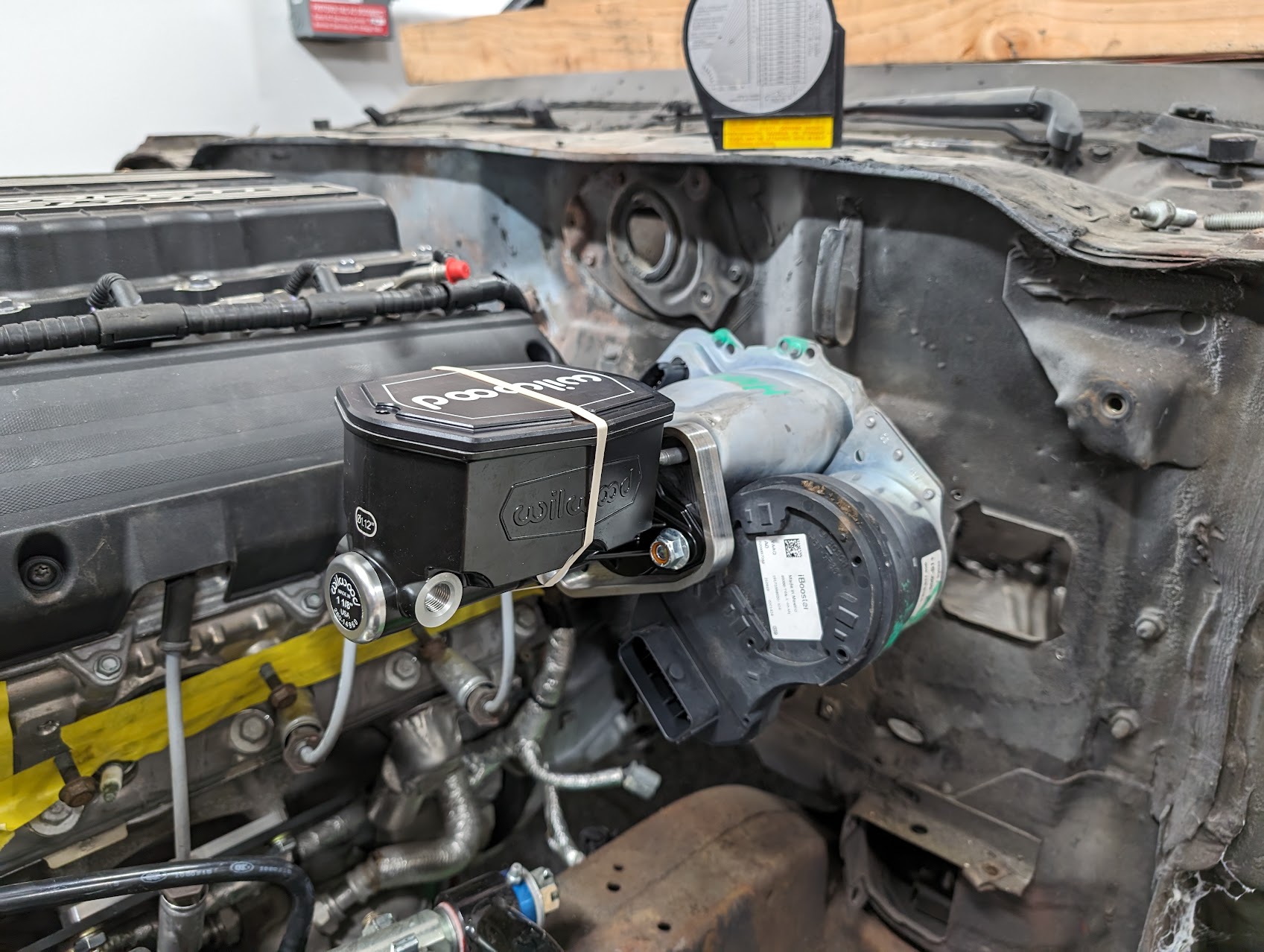

      Anybody have a picture of the ibooster installed in a first gen. I am concerned on the clearance with valvecovers, coils, and procharger piping.

      Tesla Gen1, DSE low angle brackets and the Intekotto adapter. We designed the MC adapter to reclock the Baer remaster.

      Not too helpful for your question, but I also have a gen 2 ibooster from a honda accord in my 2nd gen, don't have any clearence issues. Got the adapter plate from back bay customs https://backbaycustoms.com/
      Pretty simple setup, just 3 wires like others have said. No clearance issues with my LT4
