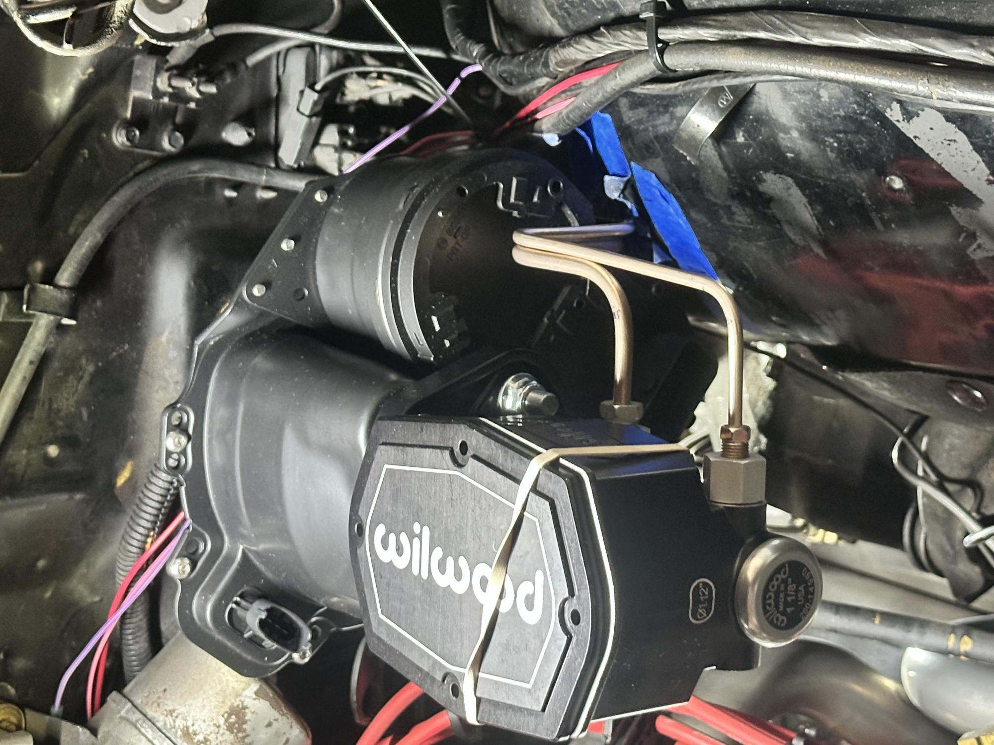

      I am just finishing up a Gen2 Ibooster in my 70 Chevelle. Install was really easy. Have not driven yet to give feedback on pedal/brake feel.
      Click image for larger version.
