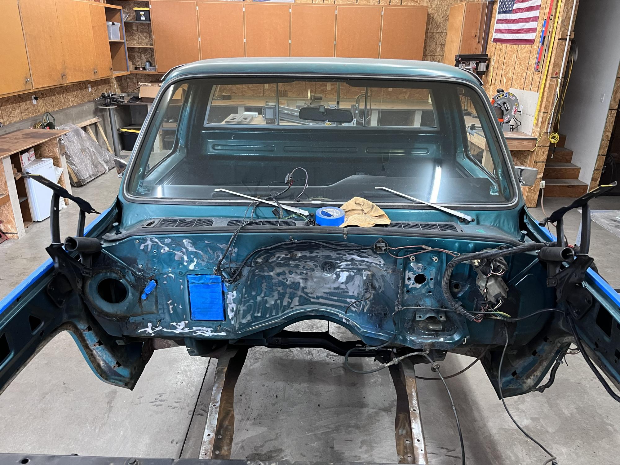

      1979 No Limit C10
      Getting things torn down. I started this project a couple years ago so I'm behind a little on posting but the plan was to use No Limit Engineering front and rear suspension to start.

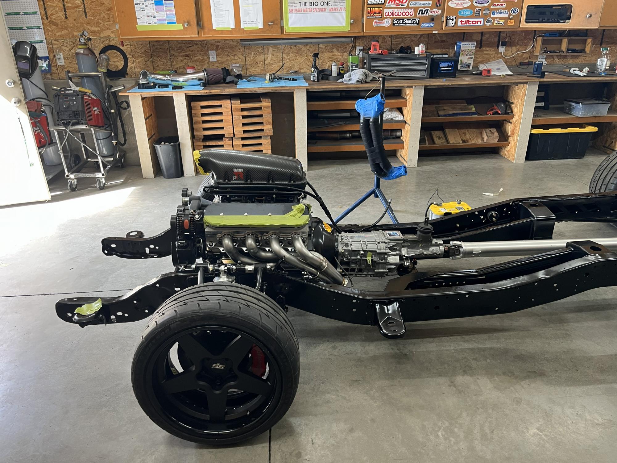

      1979 No Limit C10
      Progress on Suspension mock up and tunnel ...

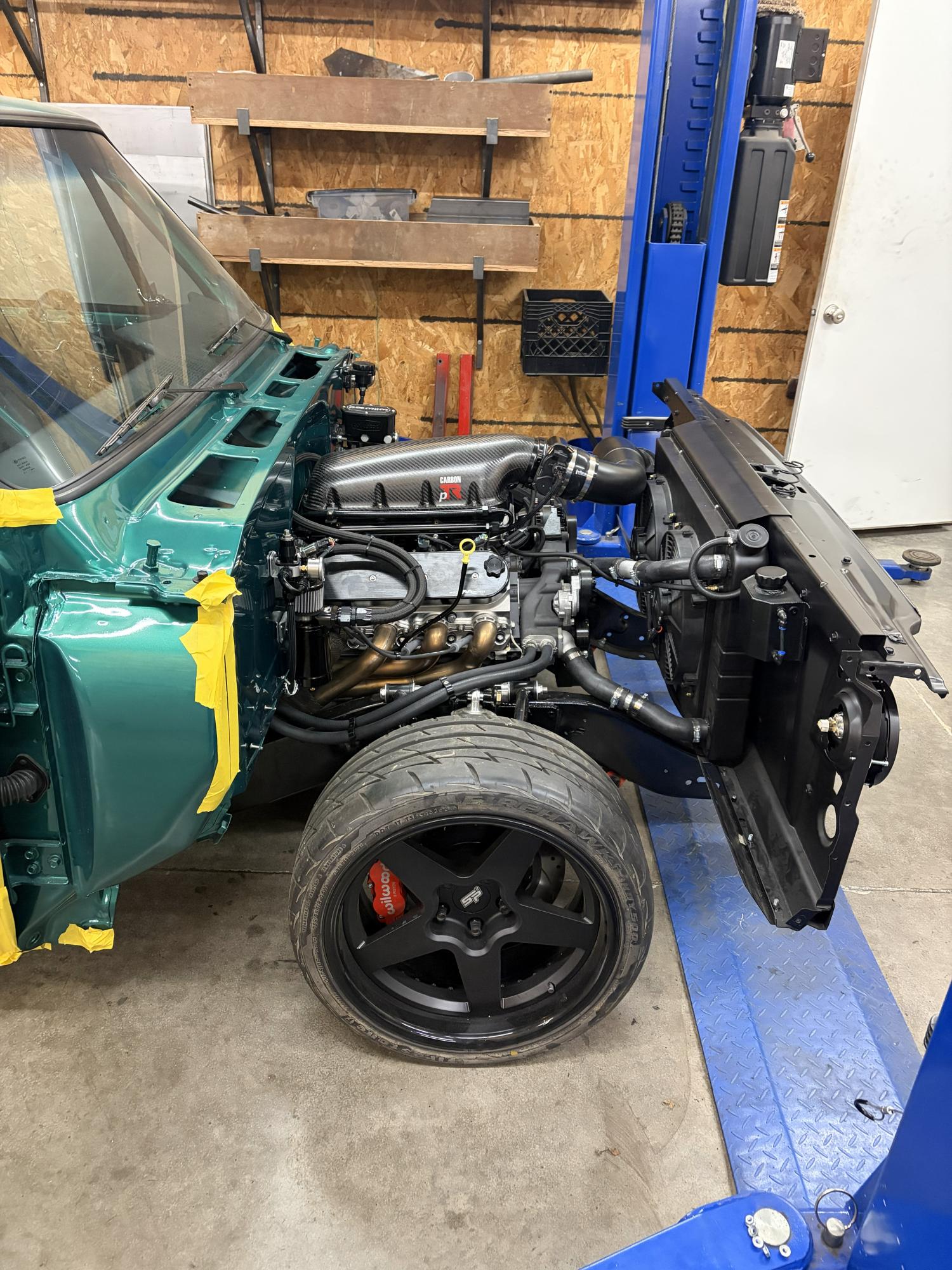

      1979 No Limit C10
      Had a small set back.... Wasn't happy with the fuel lines (Too close to headers) so I tore the front end off for better access and started over.
      All Back together now...

      1979 No Limit C10
      ...Also changed back to coils mounted on the valve covers. I wasn't very thrilled about my first idea of mounting the coils under the dash and running spark plug wires through the fire wall. It cleans up the engine bay but was a pain to get the wires isolated and safe from header temps.
