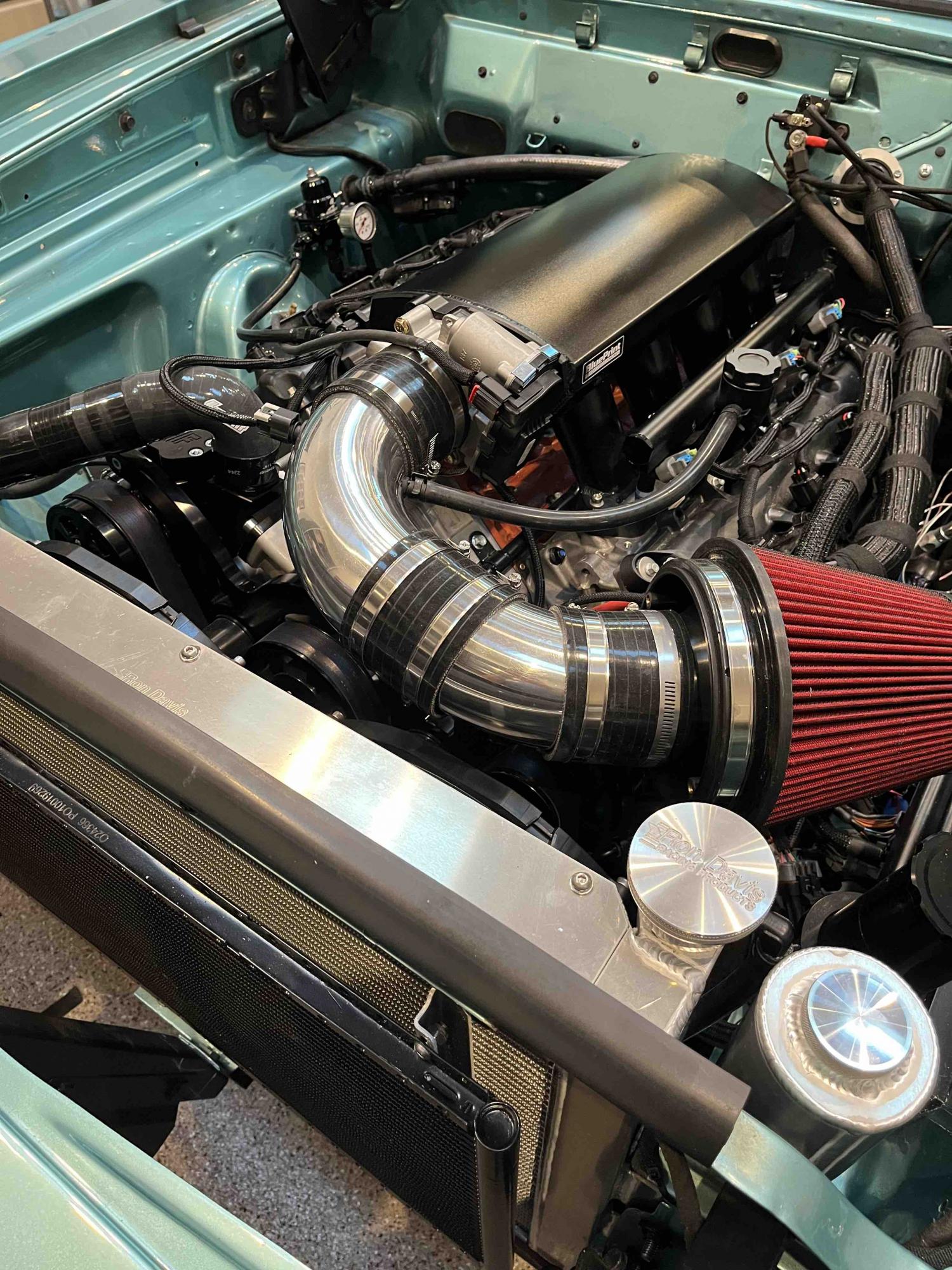

      My project is:
      1964 Dodge 330
      426 Gen III Hemi from Blueprint, 627HP dyno @ crank
      Hellcat block
      Apache Heads
      Holley term x max
      TKX
      Malwood hydro clutch
      McCleod RST
      Dana 3.55:1
      Ron Davis radiator
      TTI headers and motor mounts
      SST trans conversion
      Aeromotive fuel system
      Mancini oil filter relocate
      Suspension mild update including stiffening, gas shocks, tubular control arms
      Vintage air
      Bluetooth hidden sound system
      Interior and exterior stock OEM
      A more complete parts list and install notes are available if someone needs info for a similar project. I try to do most of the work in my garage.
      Car is 2 months away from completion. Last 10% takes time. Remaining items are final ECU wiring and programming and installing carpets and seats. Shopping for 18” wheels.Name:  Gen III 426.jpg
