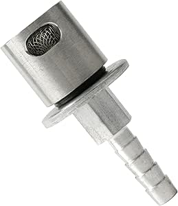

      Just a quick side note, you really shouldn't vent the tank directly into a charcoal canister. I know lots of people are doing it and there are several products out there to facilitate this, but it's bad practice.

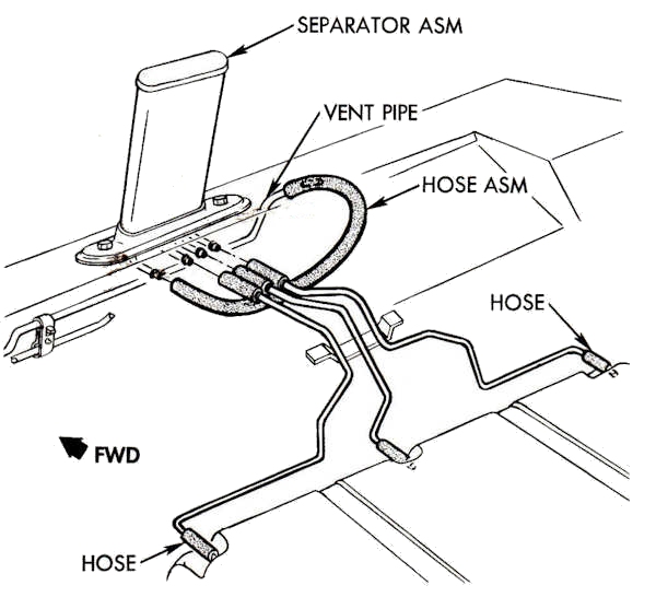

      If you look at what the factory did when they added charcoal canisters, they added a vapor separator first. This is essentially what a IIMuch can is. I still run the factory separator in my Camaro but without the charcoal can. My garage doesn't smell like fuel at all. ****Side note in a side note - most guys that complain about their garage smelling like fuel still have carburetors and that is typically the source of their issue. ****
      That is to keep liquid gasoline out of the charcoal. Once the charcoal is saturated it is junk. Later tanks were all built so that you can't fill them all the way or they have a vapor dome on the top. That allows the fuel in a "full" tank to expand without pushing liquid to the charcoal canister. This is a vapor dome.
      - - - Updated - - -
      That aside, the IIMuch vents are awesome but it doesn't matter because they can't be delivered in a reasonable time frame.

      I simplified my vent system down quite a bit with my Tanks EFI tank... bypassed that fuel separator thing behind the seat (which I never really liked anyway)
      I have a 90° 5/16 hose barb fitting high up in my filler neck near the non-vented cap. The barb is NPT and screws into the steel filler neck. The neck is thin wall steel, but I tapped it and it works adequately. That barb connects to the steel line going to the front of the car (using 5/16 rubber hose), and the steel line goes to the charcoal canister.
      The vent port on top of the fuel pump module goes to both of these two vents which are set up "in parallel" with eachother.

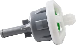

      The rollover valve is mounted upside down. When the charcoal canister is activated by the ECM, the tank draws air in through this valve. When the car is off, the valve seals up and doesn't let vapors out. I know that's not the purpose of that rollover valve, but the odds of me rolling the car over are essentially zero.
      The mushroom vent valve is there for safety. If the CCP system fails to operate or something, the mushroom valve will bleed off pressure before it becomes dangerous.
      I've had this setup for many years now and it seems to work beautifully. Never get pressure build up in the tank (positive or negative), and never get any smell in the garage.
