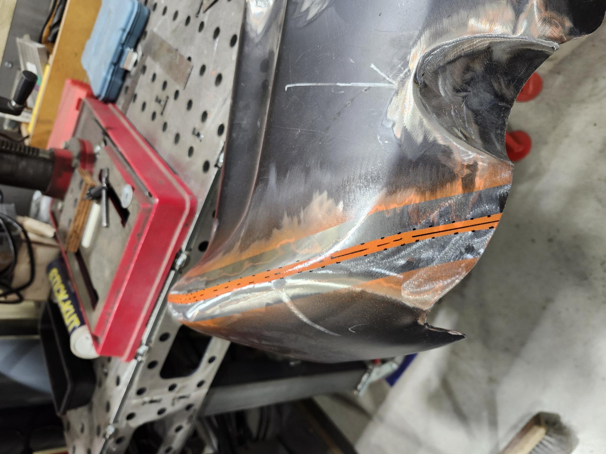

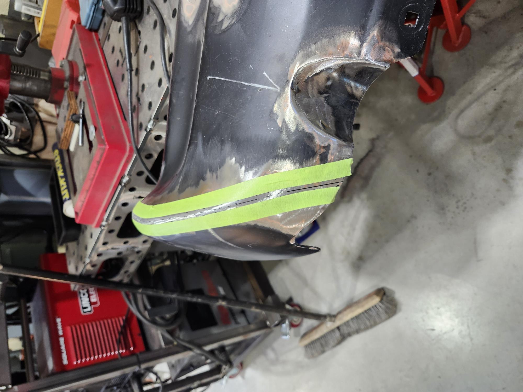

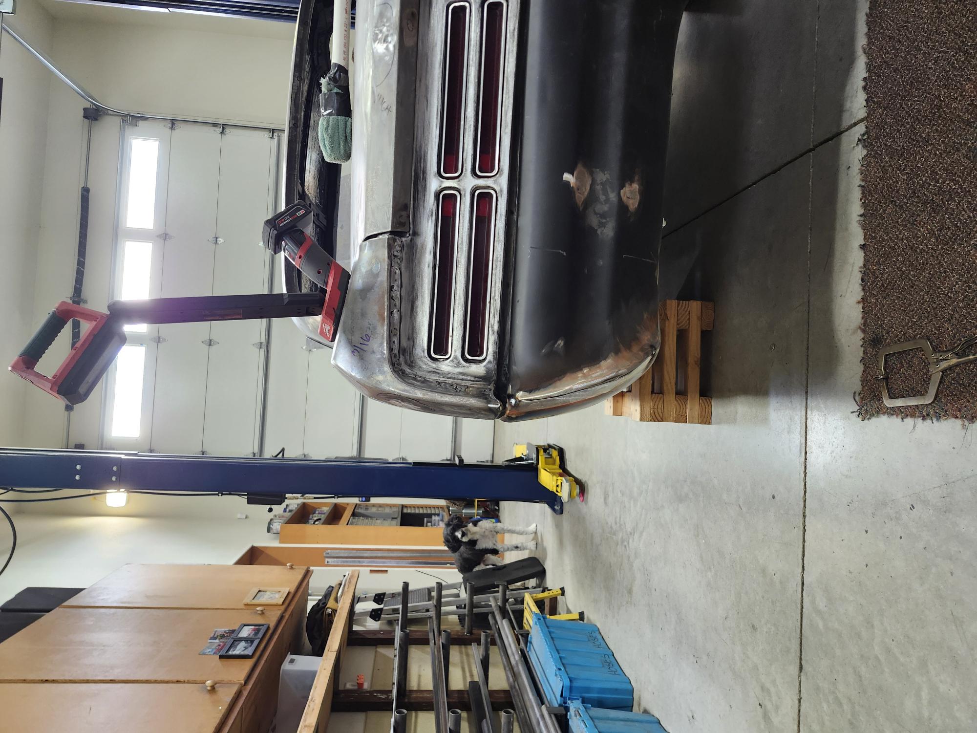

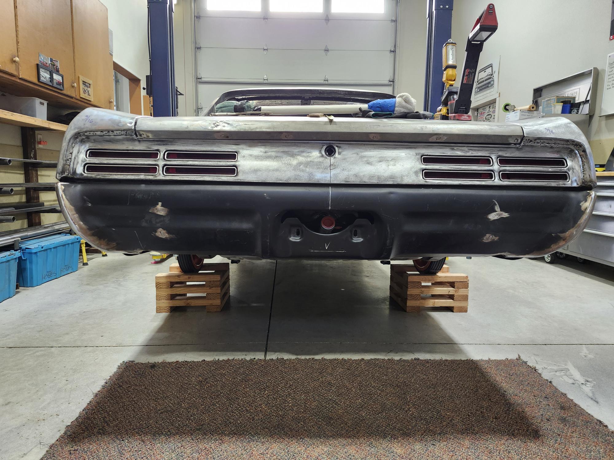

      Bumper Tuck
Size:  271.5 KBName:  20260126_111022.jpg
Size:  342.9 KBName:  20260126_102927.jpg
Size:  700.0 KBName:  20260126_123342.jpg
      Jeff #aurorarestomod
      Have a Great Day!

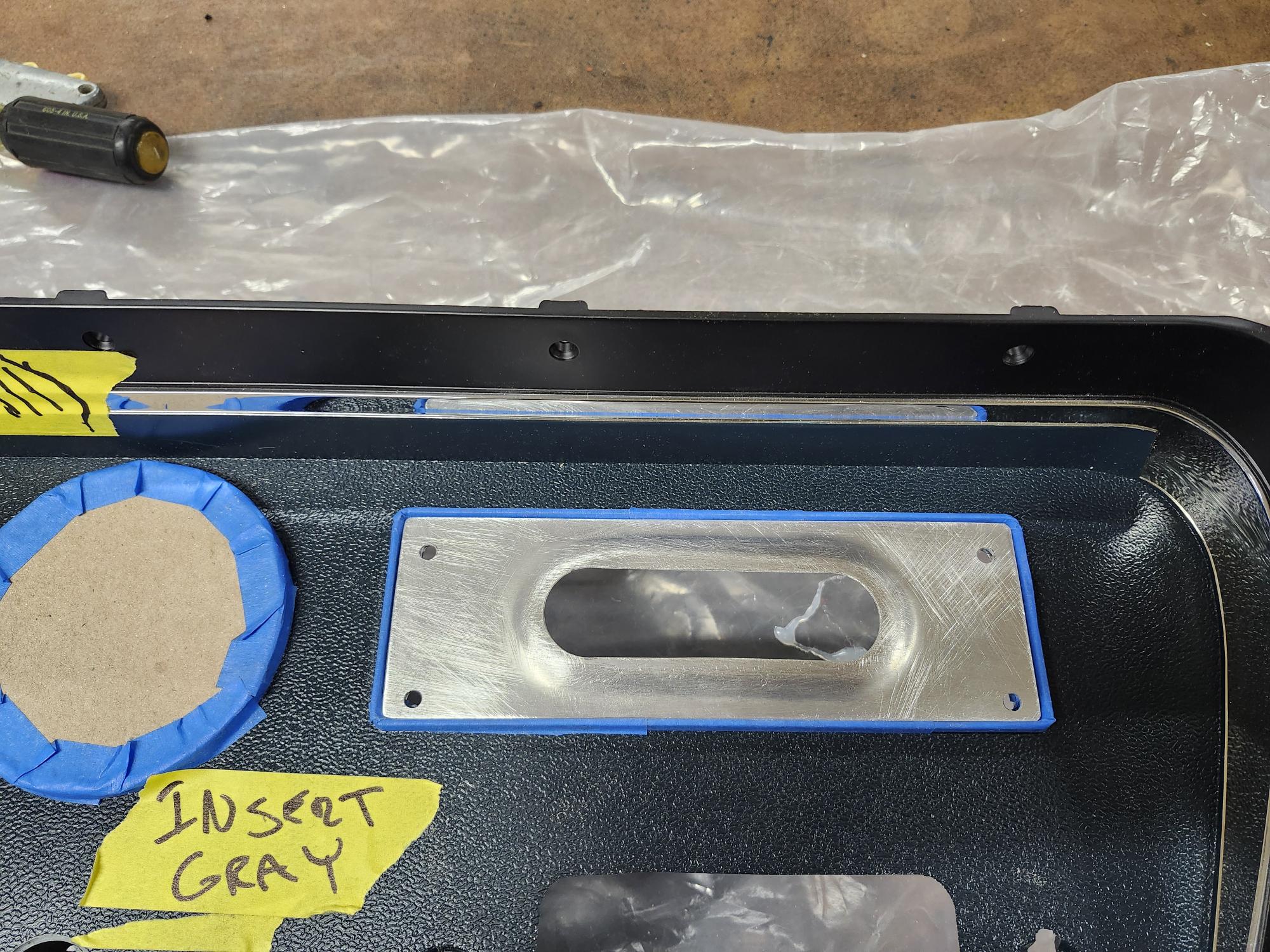

      Gen 5 Control from Dakota Digital

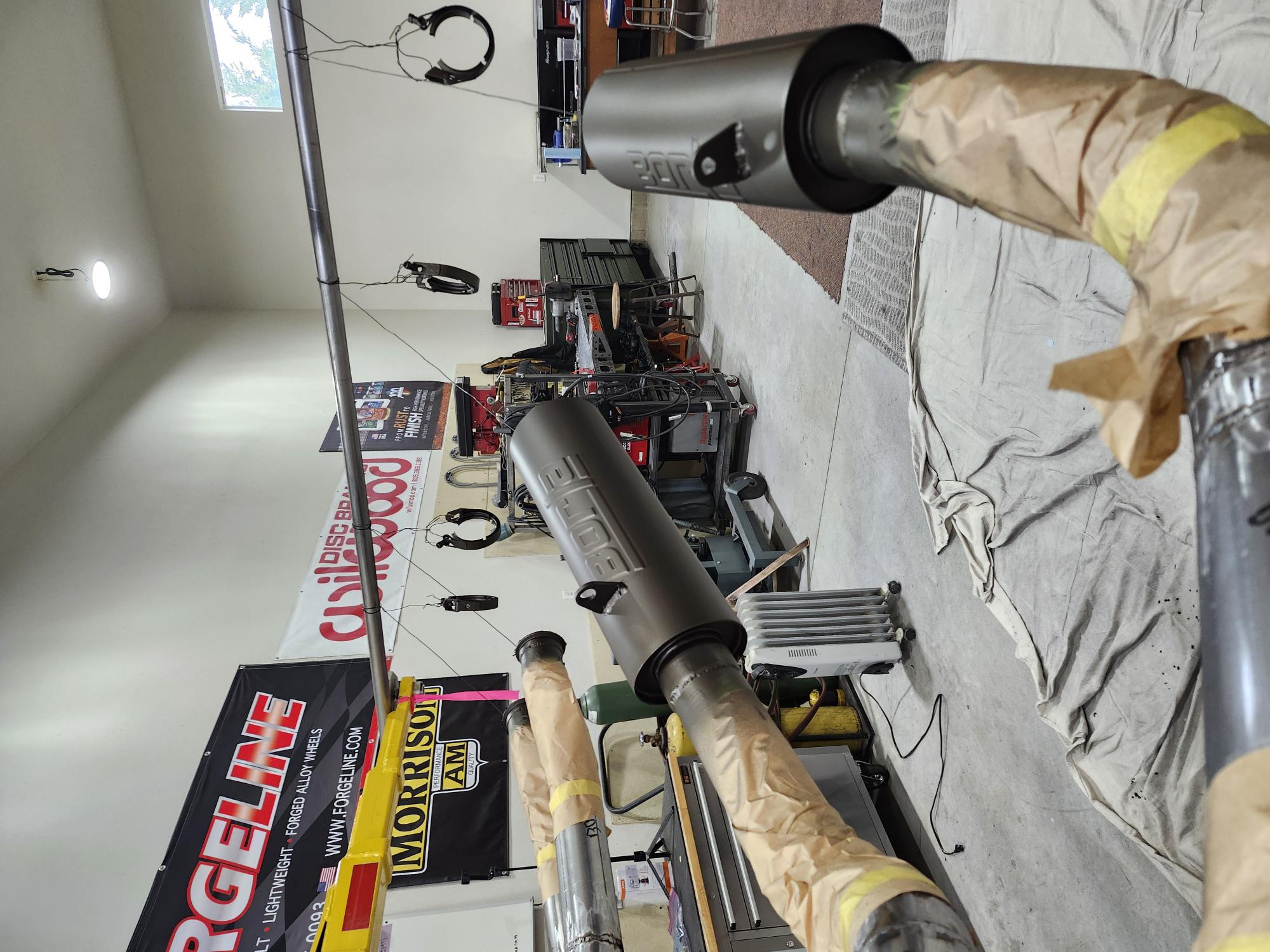

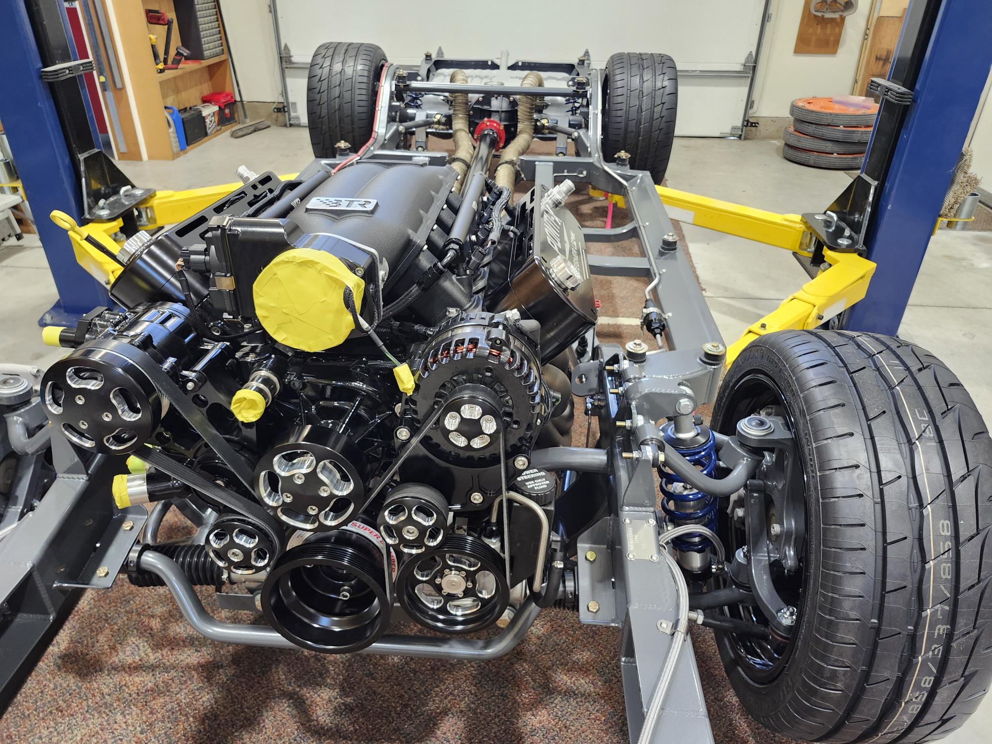

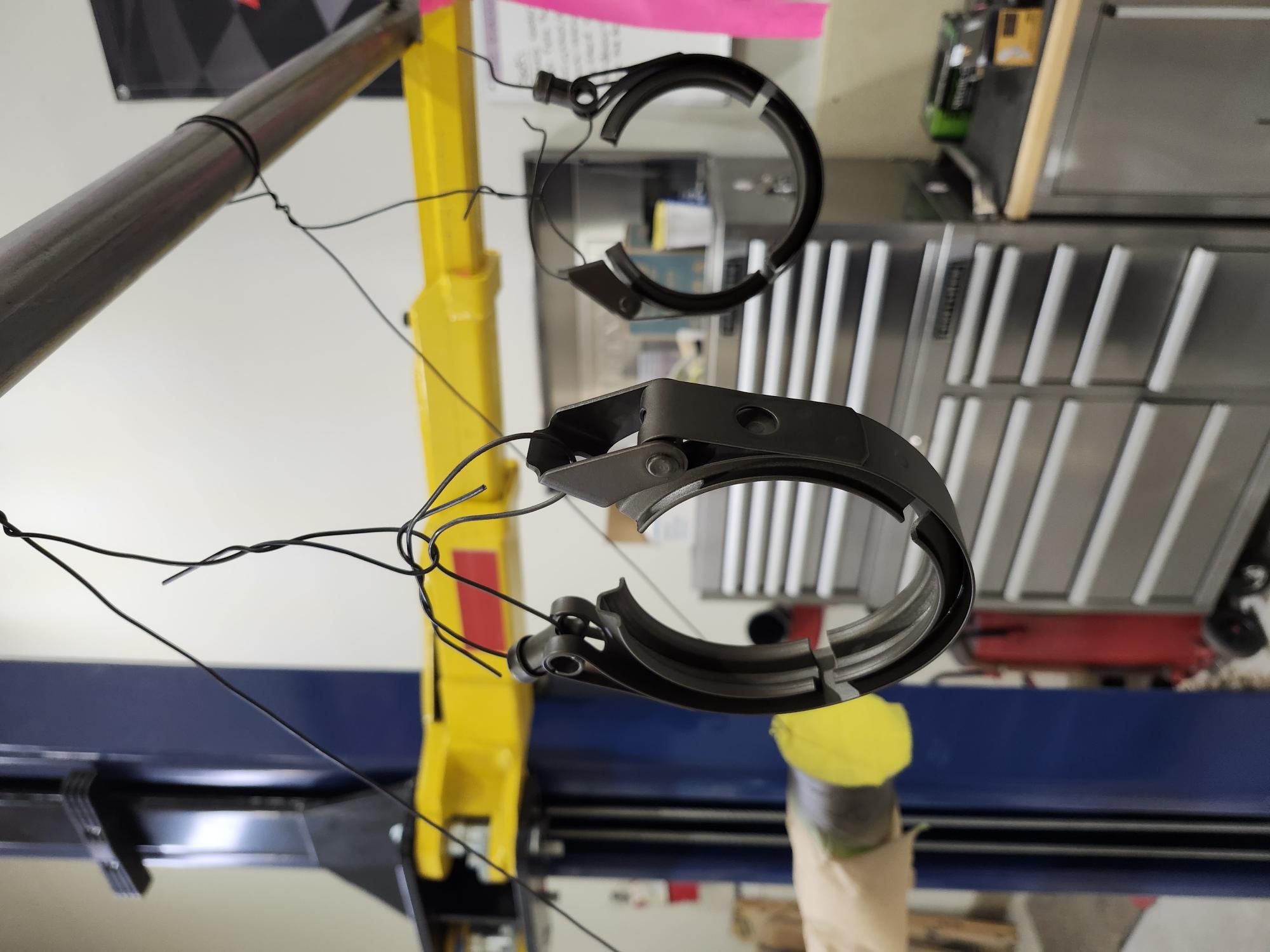

      ZYbar on Exhaust

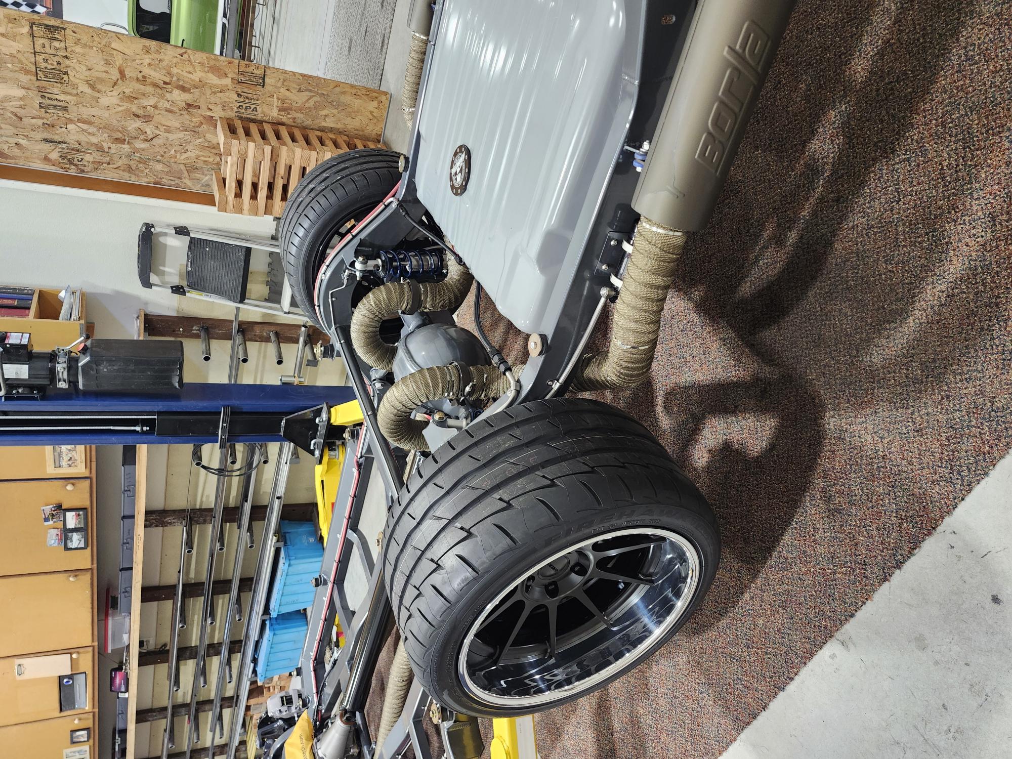

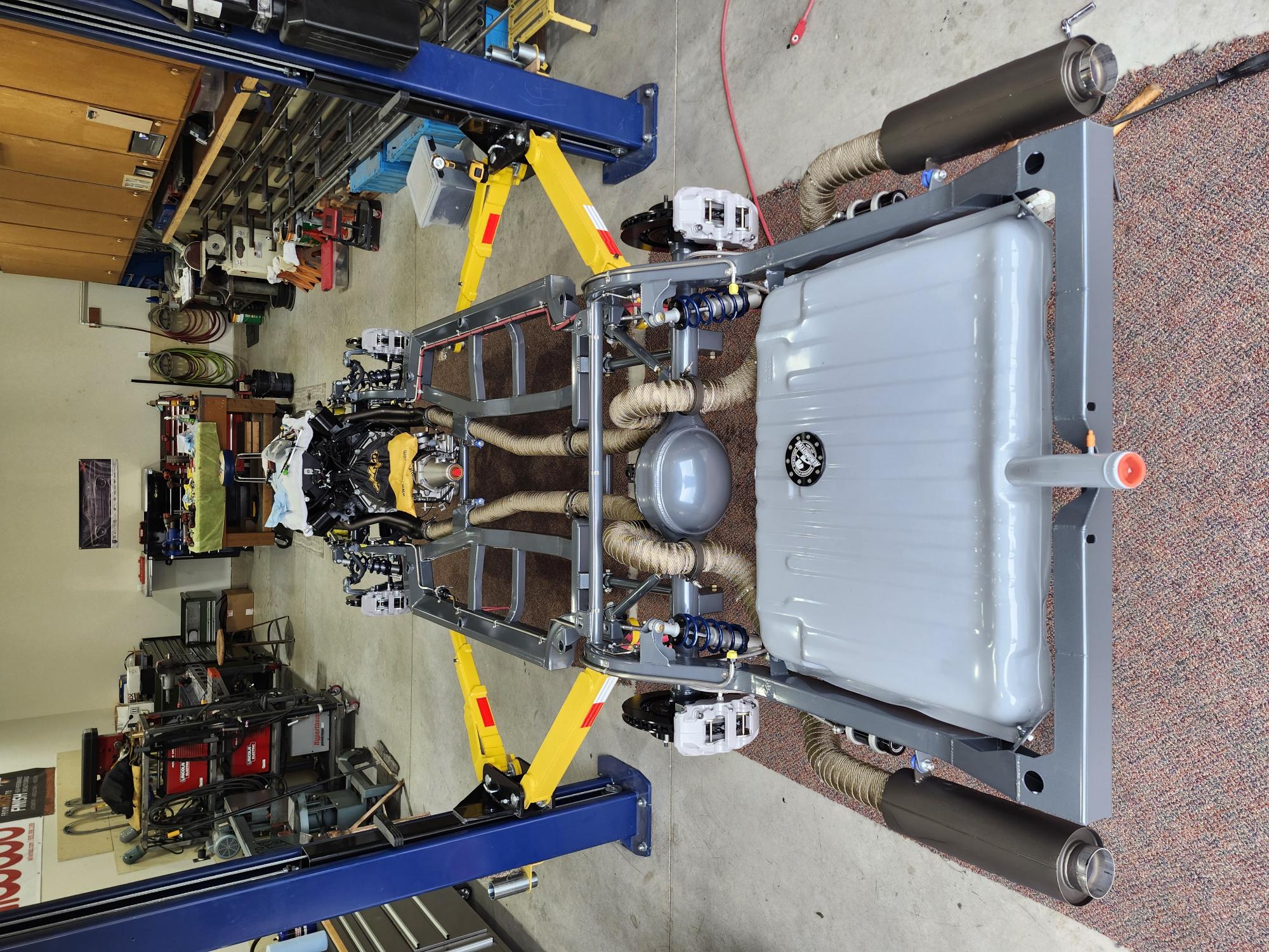

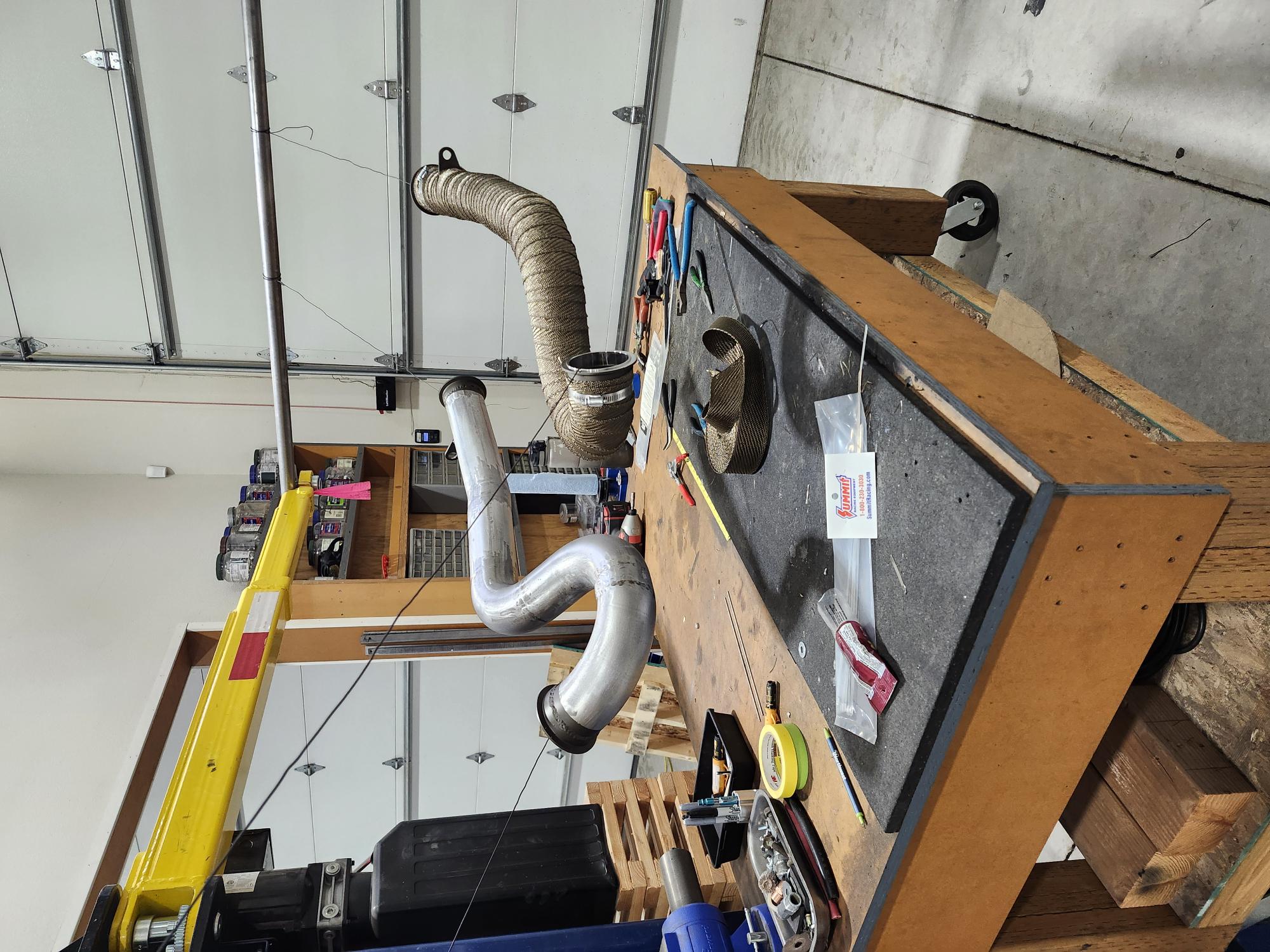

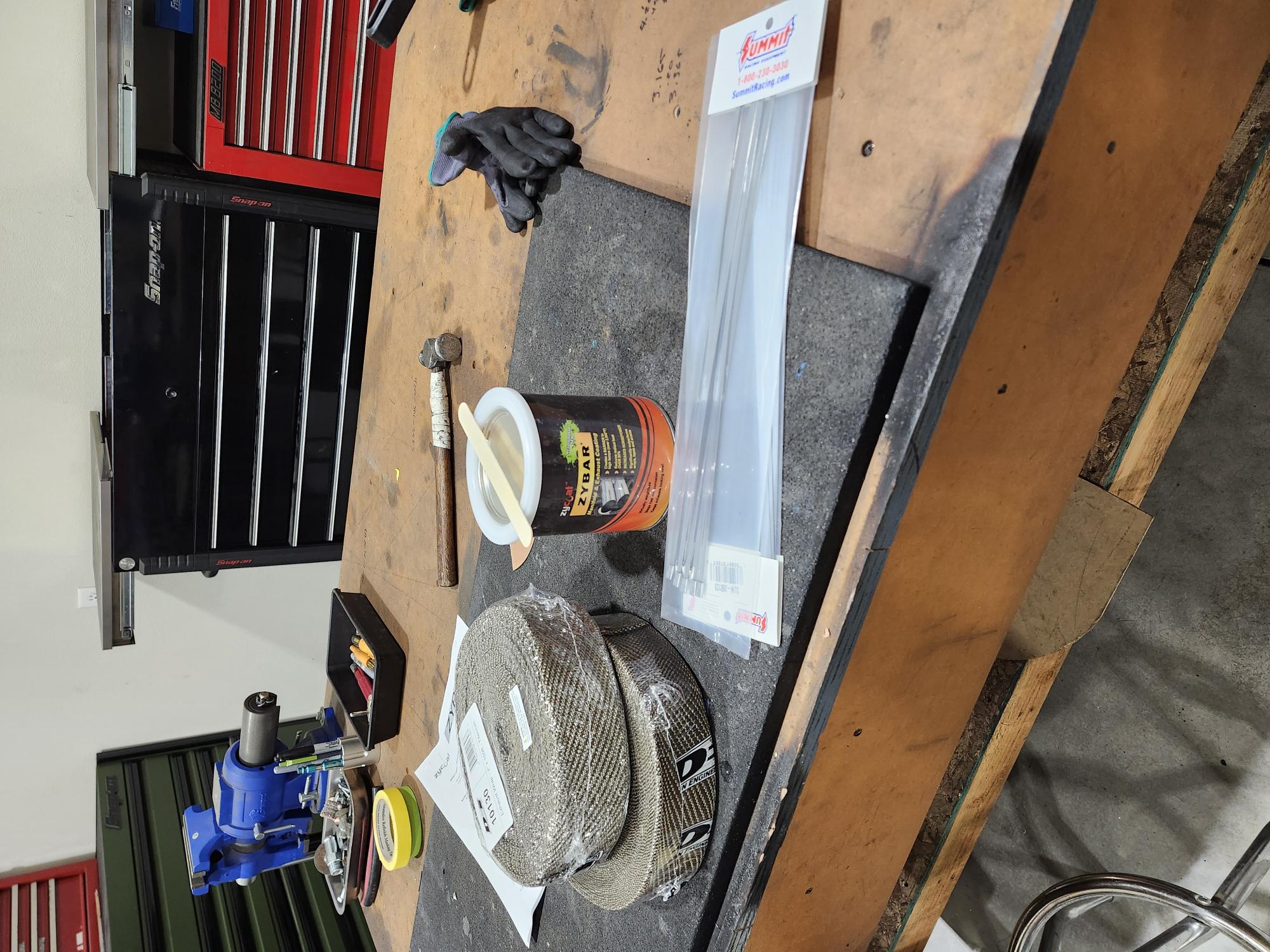

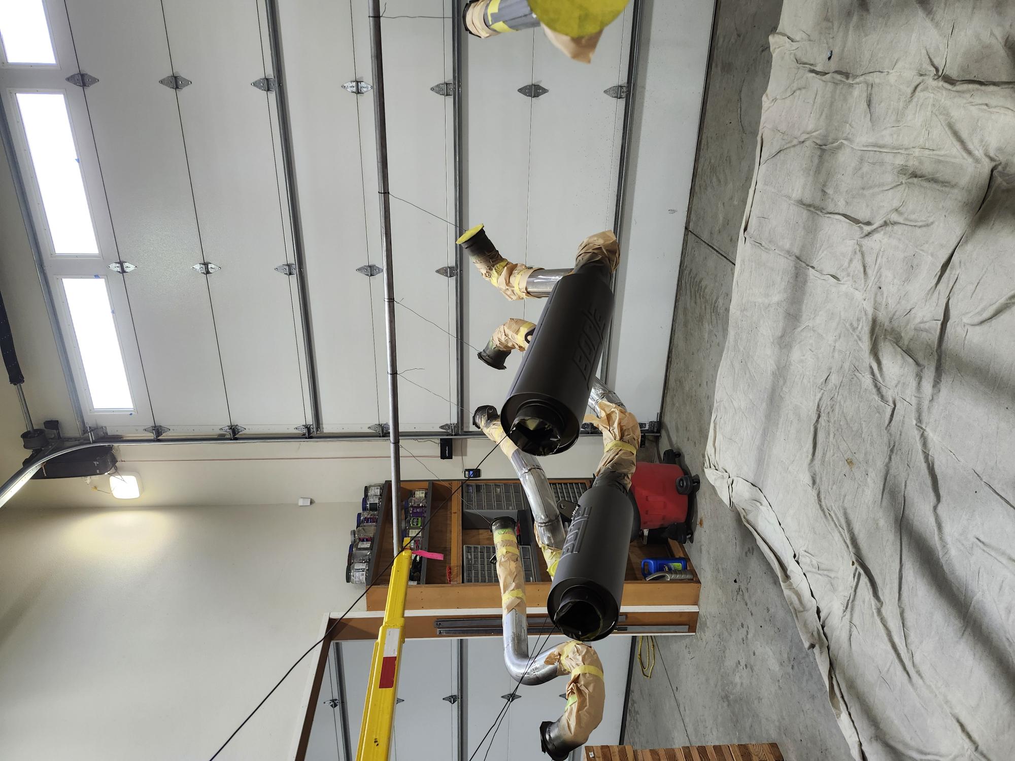

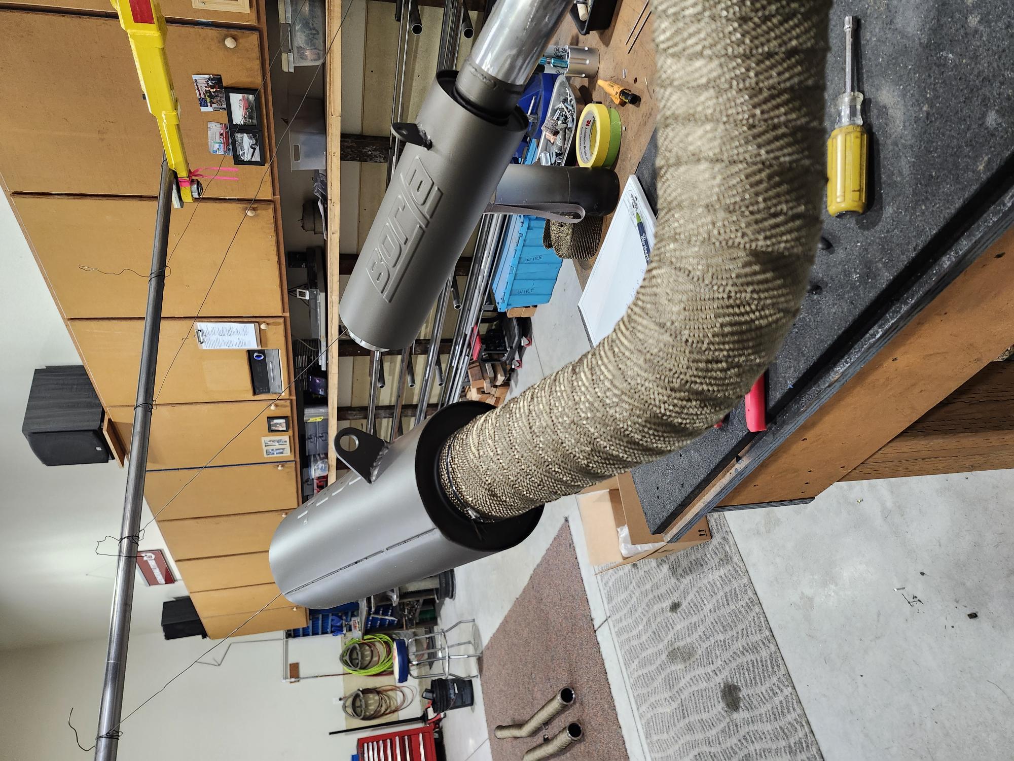

      Exhaust Wrap
Size:  450.2 KBName:  20260311_102458.jpg
Size:  367.7 KBName:  20260311_102441.jpg
Size:  460.7 KBName:  20260311_121119.jpg
Size:  1.01 MBName:  20260311_113857.jpg
      Have a Great Day!

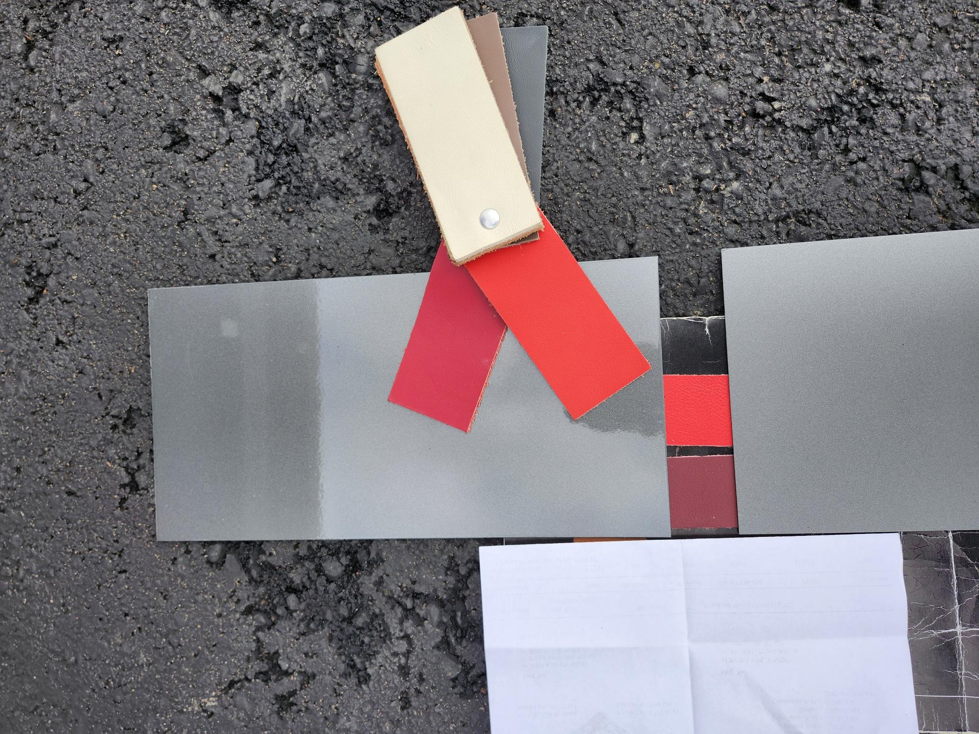

      Scheme

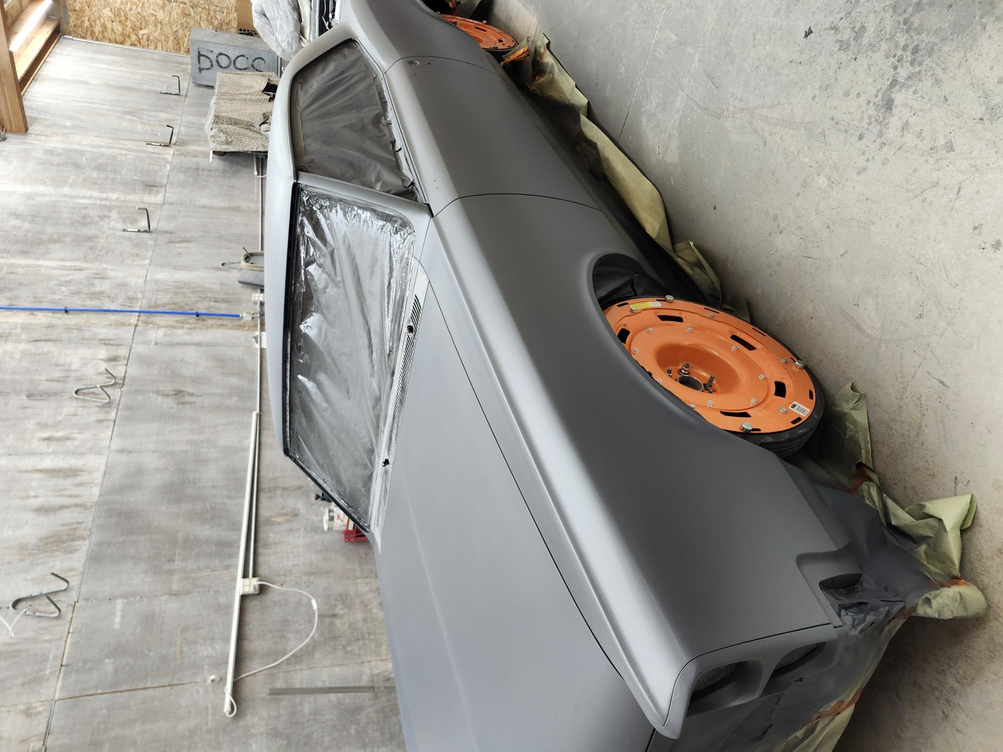

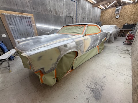

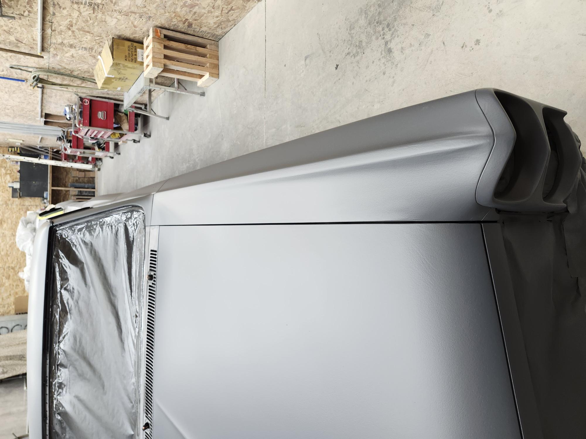

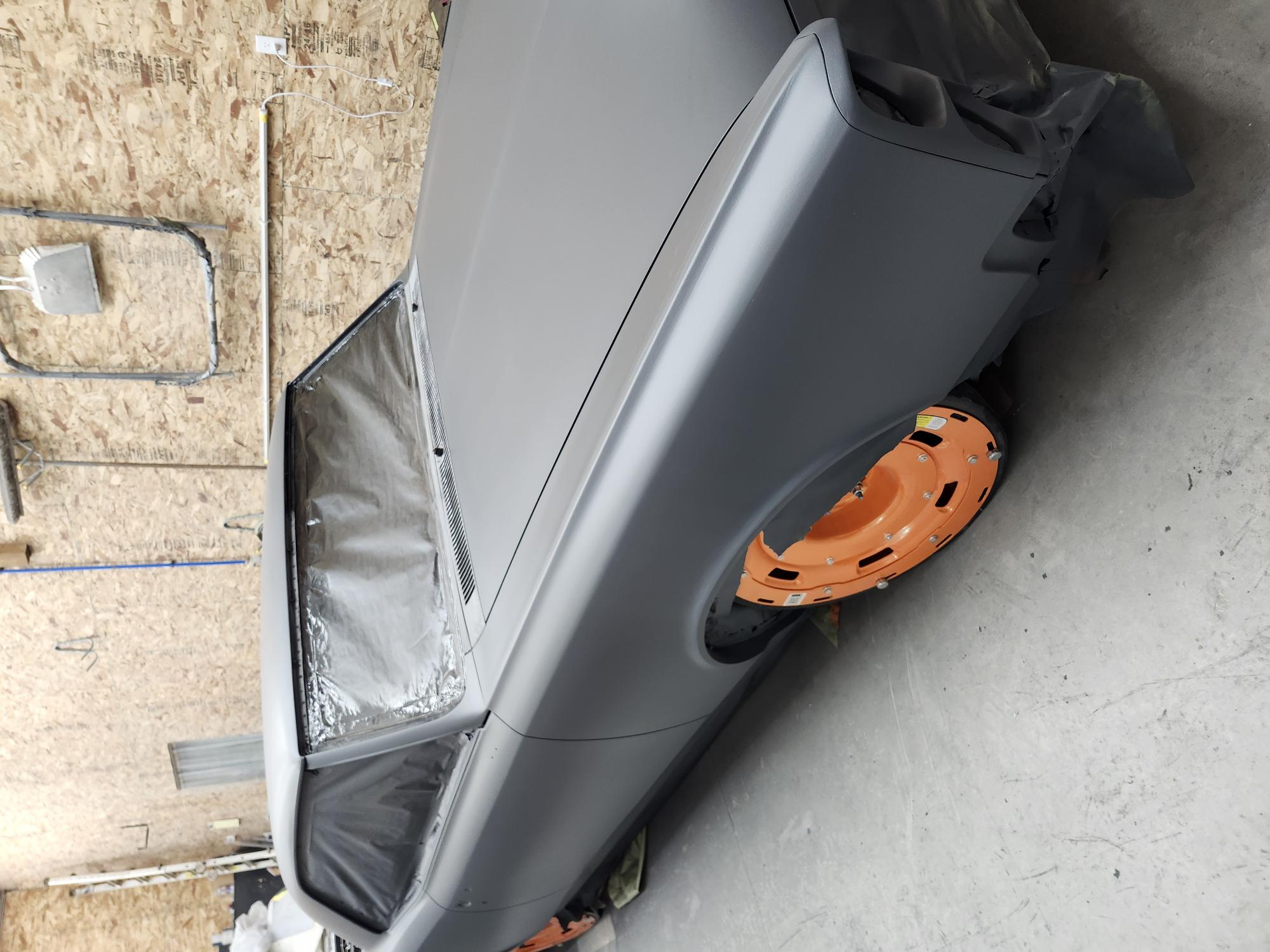

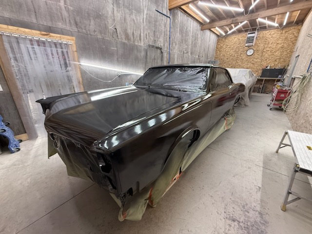

      Epoxy Primer
      Hit the car with high build epoxy for blocking. Repeat this a couple more times than the car comes apart for fine tuning panels.

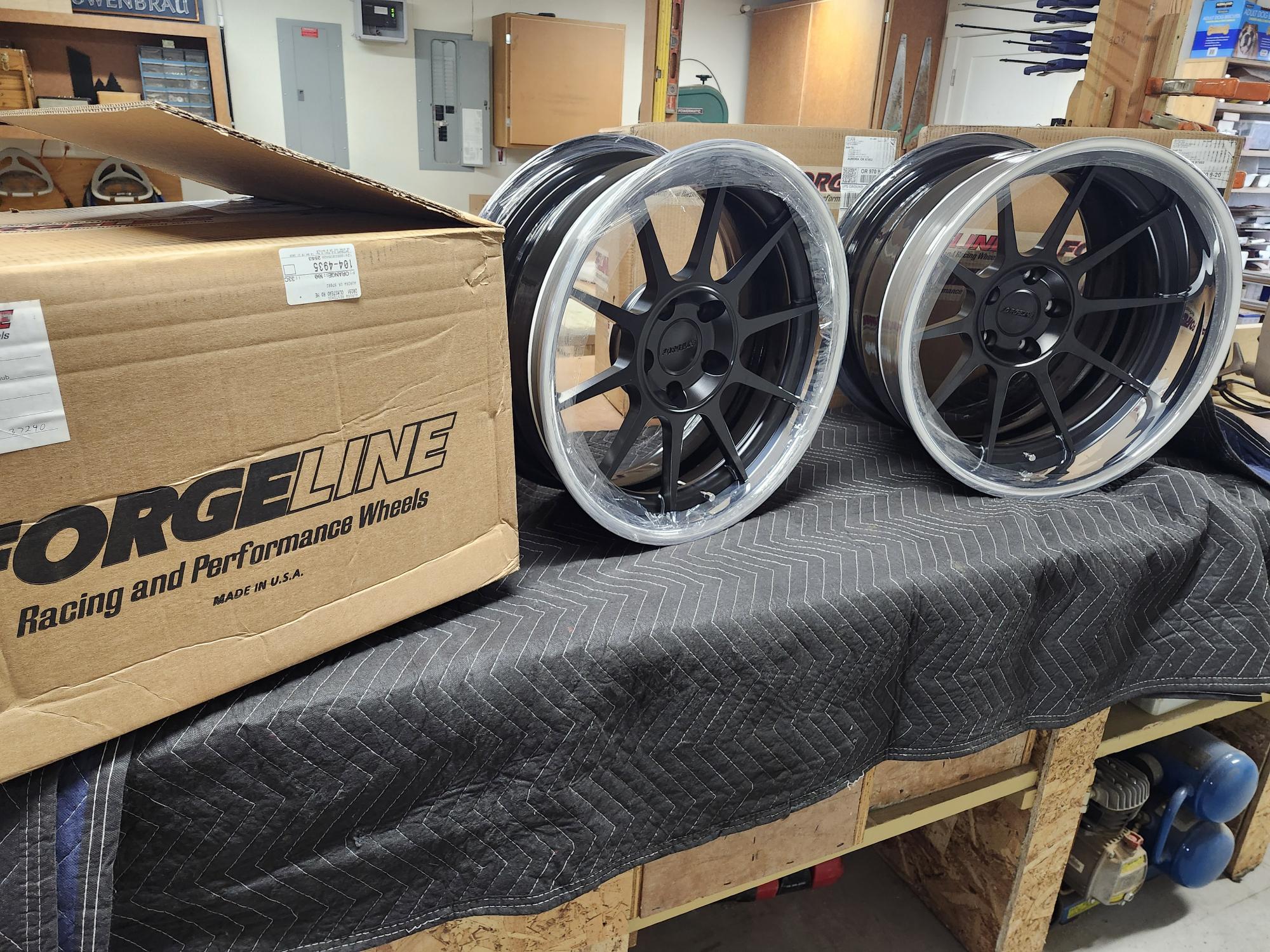

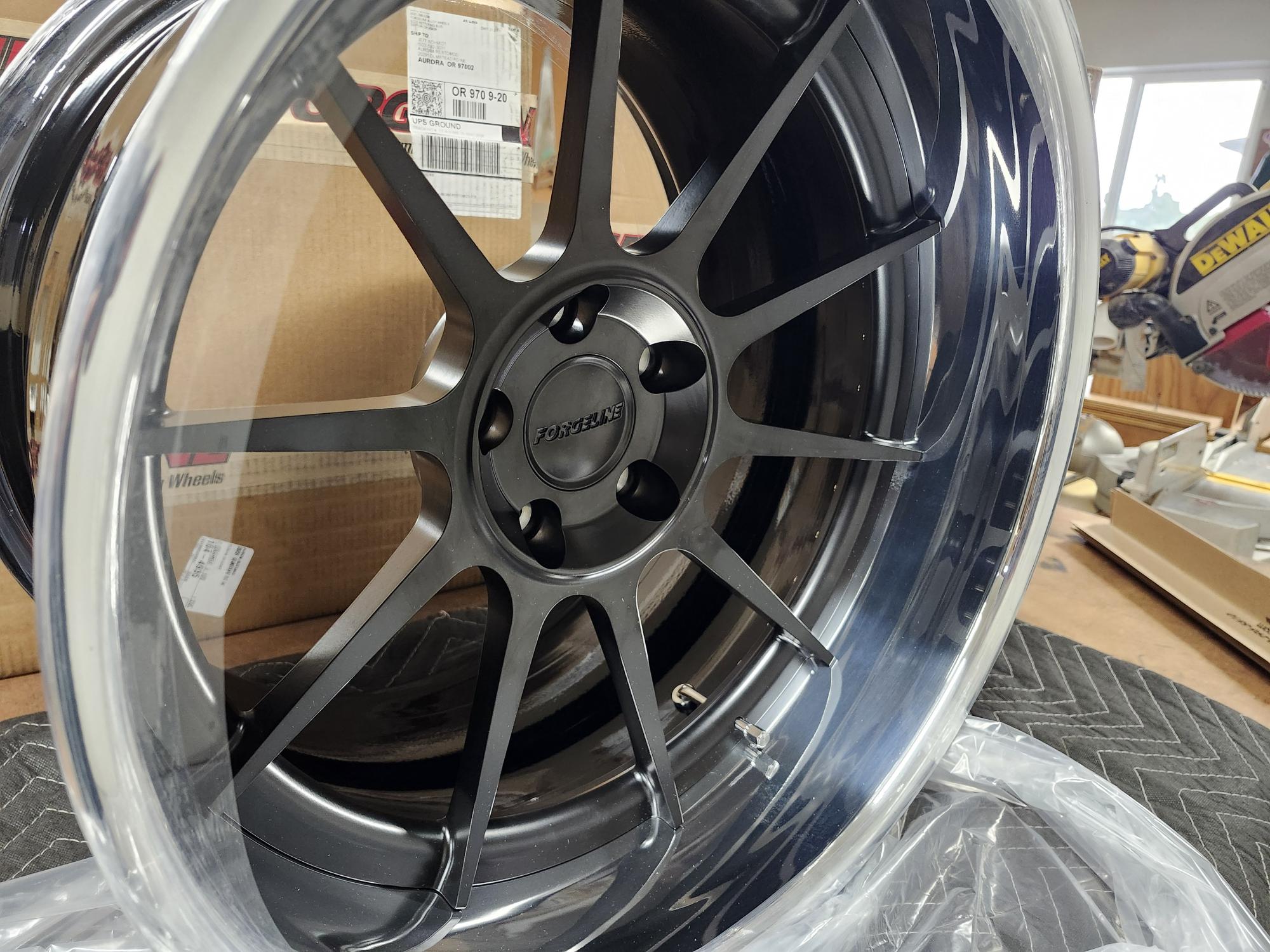

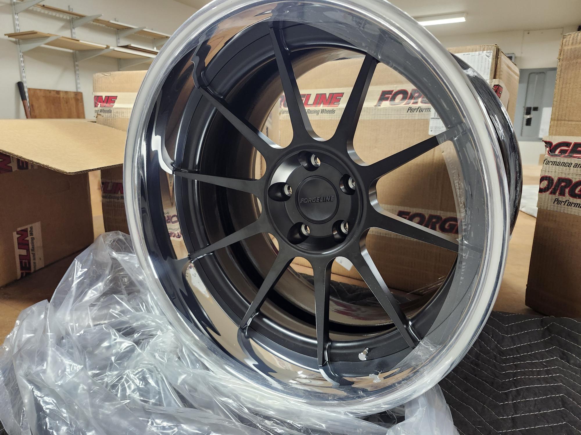

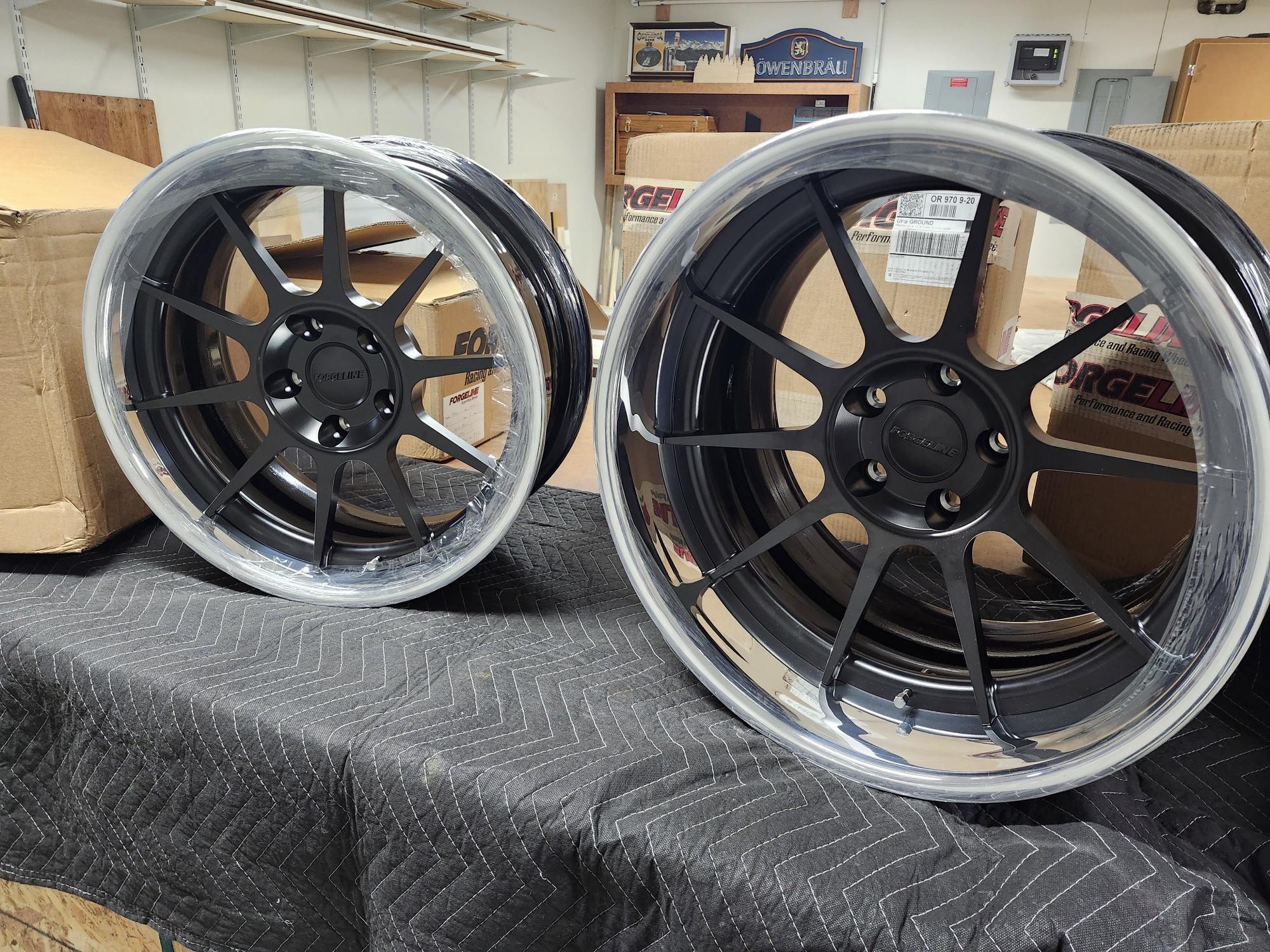

      Forgelines
      Forgeline builds an awesome wheel.

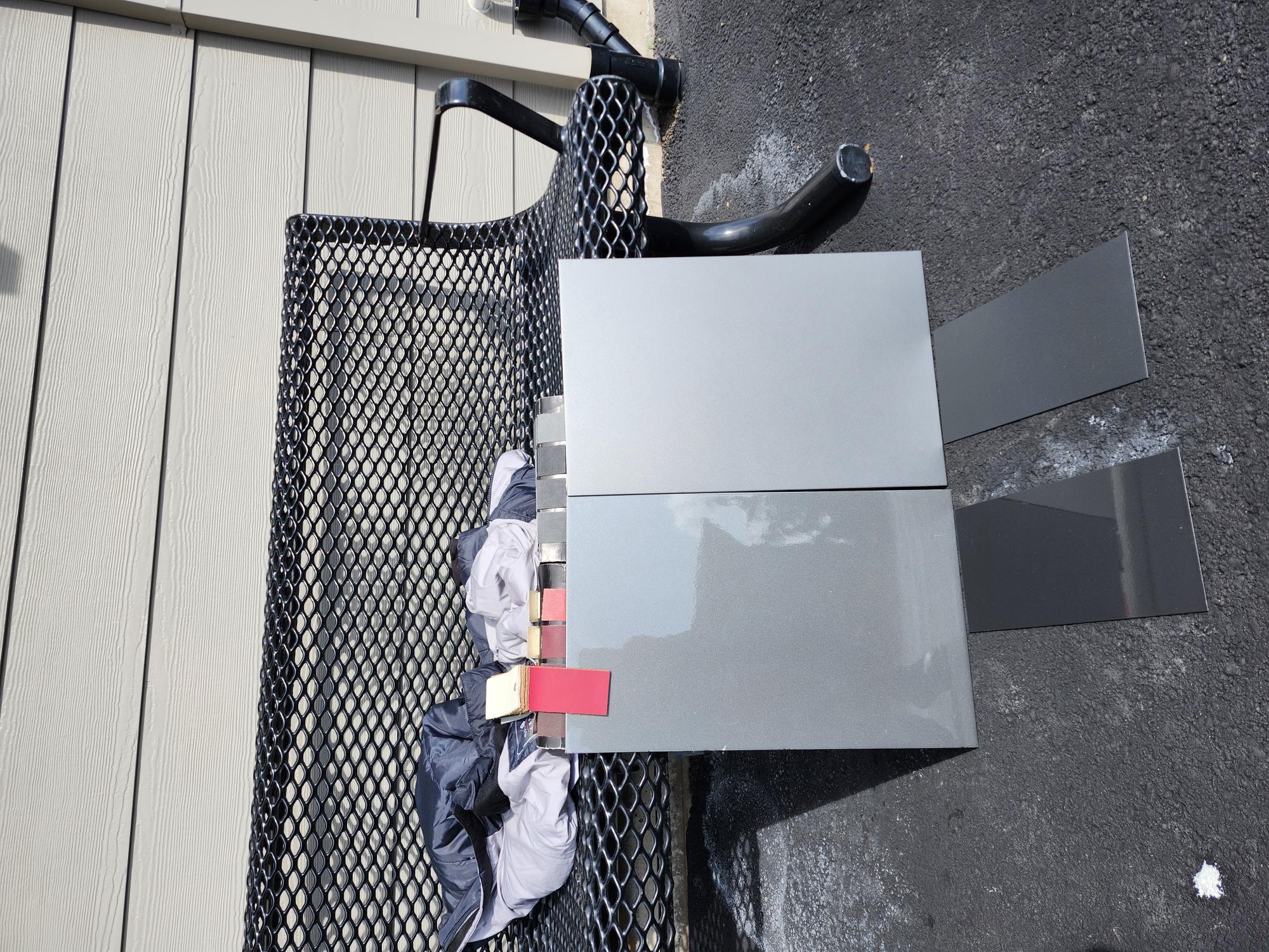

      Round 2 Primer and Blocking

      Which epoxy did you use and how does it sand? I have been away from the painting scene for half a dozen years and these high build epoxies are being used more and more but I have never tried. Few questions:
      - How does it build? Comparable to a good 2K? How would it compare to a polyester?
      - Economics and time of using? Traditionally I use Epoxy as a sealer and base then immediately fill and polyester over the epoxy to do my block down work. Once I have done a couple passes I will spray 2K for a final block down getting out all sanding scratches.
      Thanks for sharing your process & great work! I love these 66-67 Pontiacs.

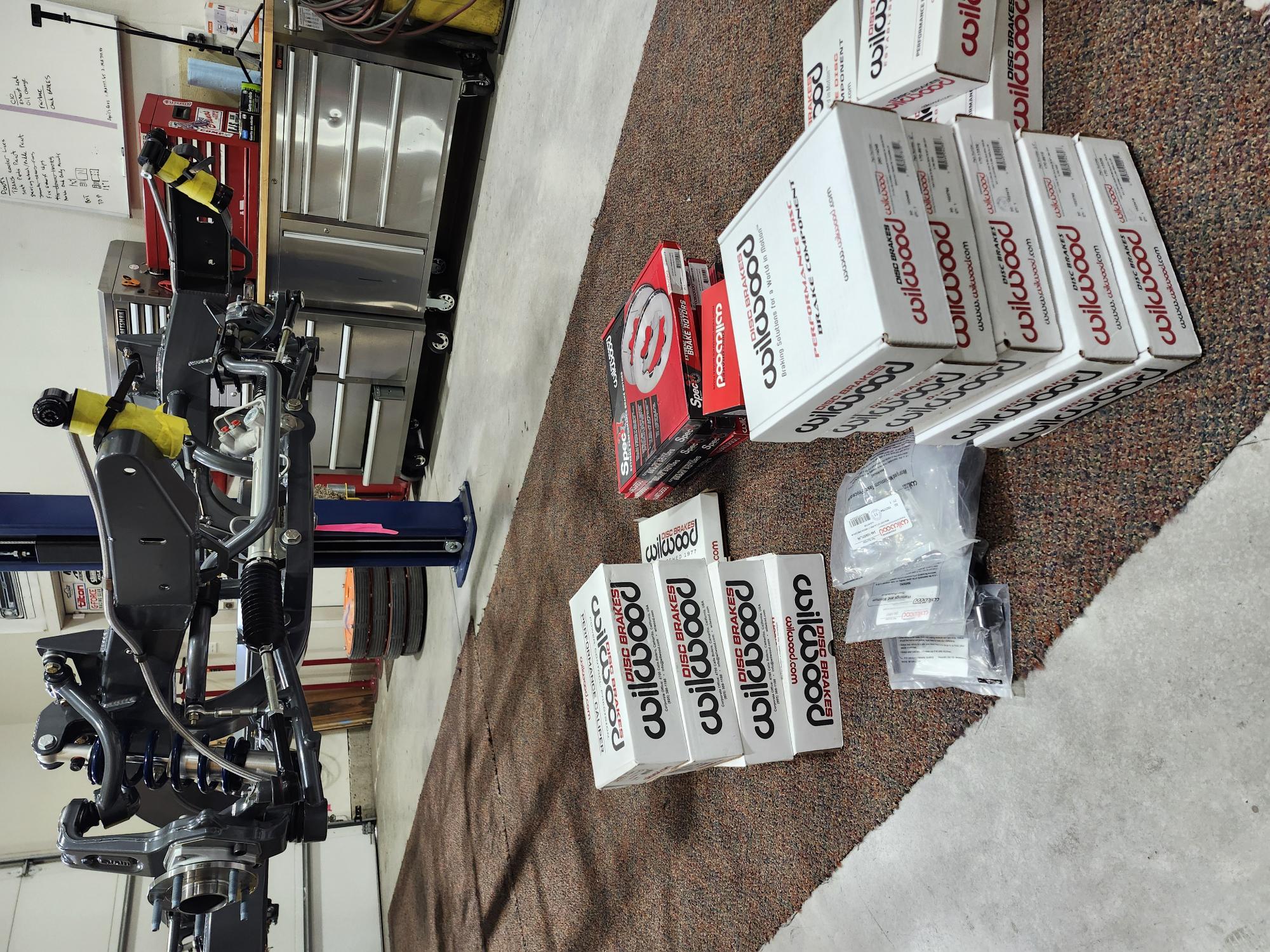

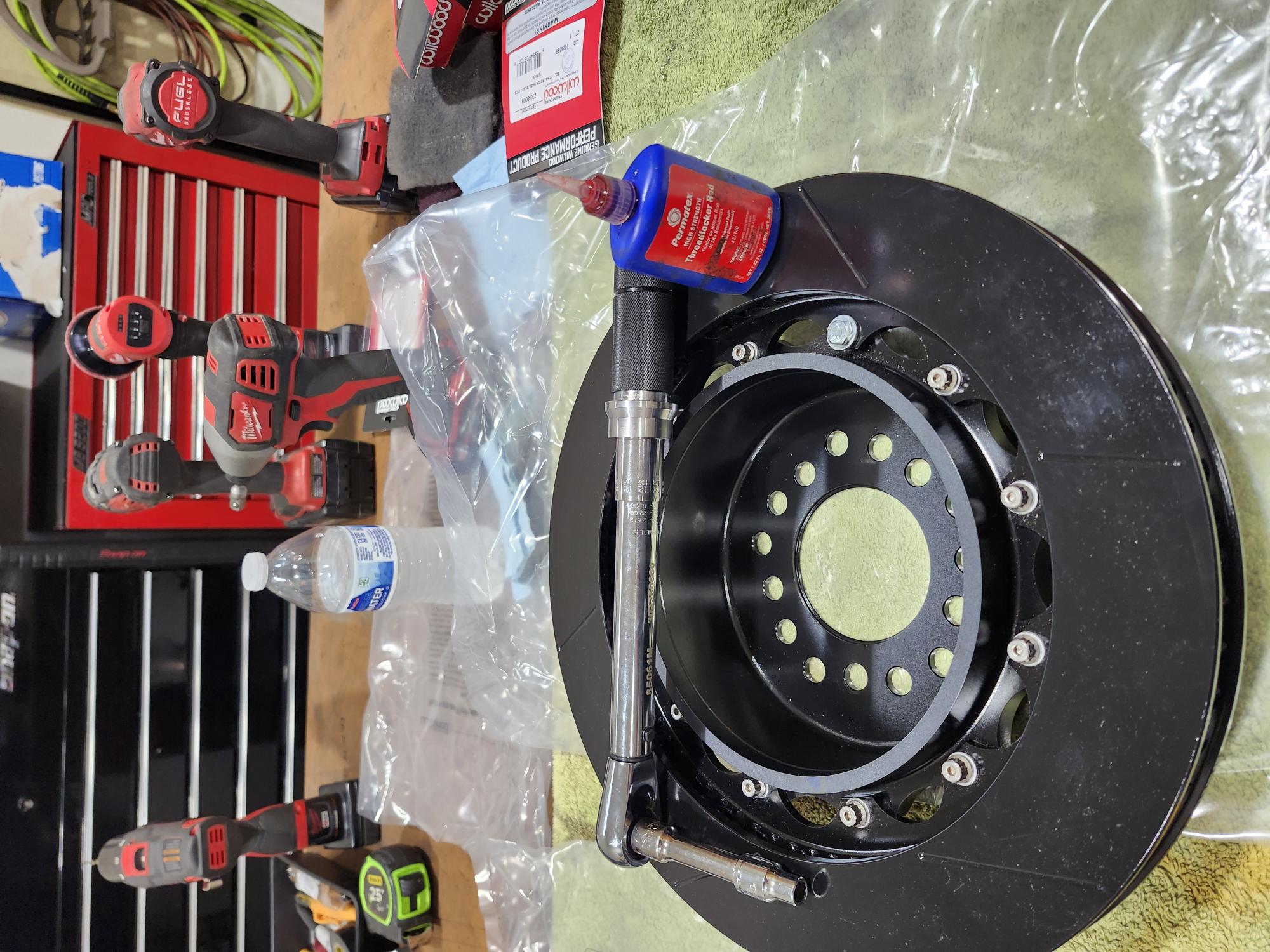

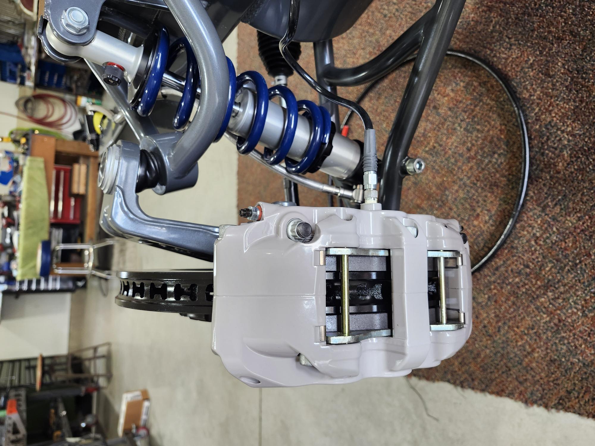

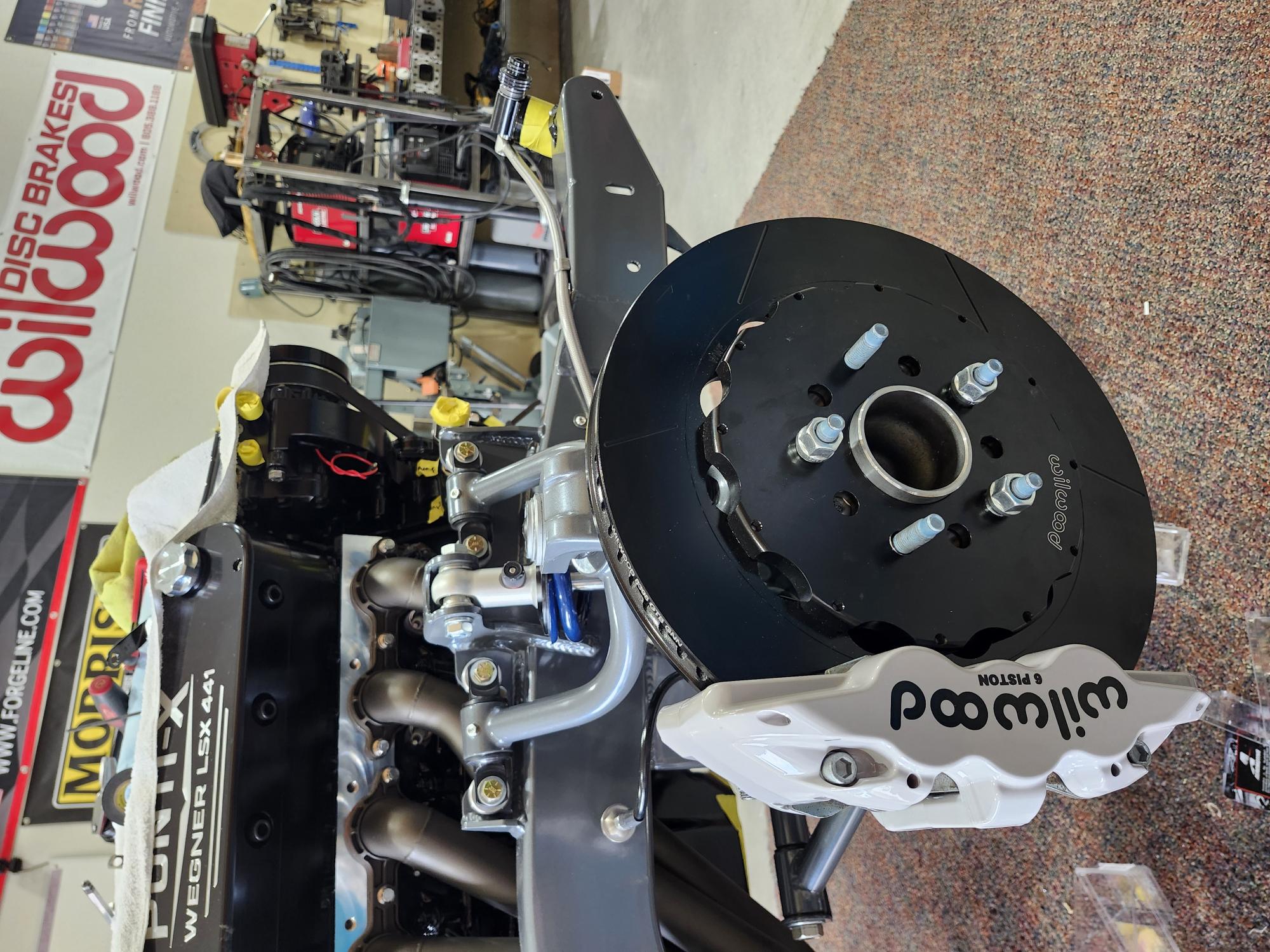

      Wilwood Aero Brakes
      Super Clean and Light Aero Brakes from Wilwood. Installed like a dream.
Size:  391.2 KBName:  20260529_114504.jpg
Size:  327.8 KBName:  20260604_113130.jpg
Size:  358.4 KBName:  20260604_113105.jpg
      Have a Great Day!
