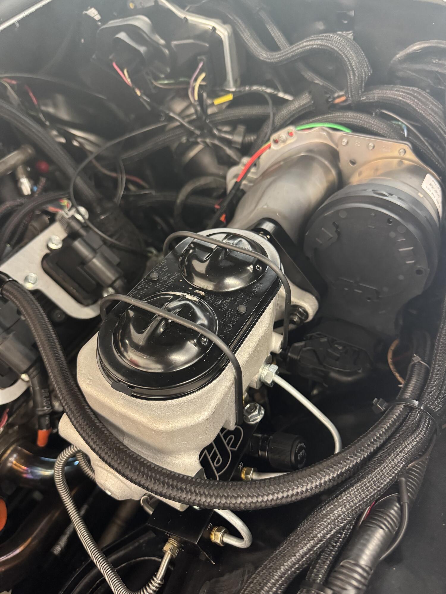

      Well, got the kit and installed it. The kit is nice quality and mounting brackets are CNC made, the bracket that mounts booster to the firewall needed a little modification because the bolt hole for the studs on the firewall were too small. The kit over all is OK but you will likely need to make new lines yourself and relocate the proportioning valve.
      On my car the prop valve wouldn't fit due to the wheel well. I bent the lines and pushed it in just to complete the install, I'll make new lines and relocate the valve this winter more than likely. The brakes have a completely different feel to them, less mechanical which makes sense, hard to describe but the car has exponentially better braking. Overall I'm pretty happy with them if that helps anyone else.

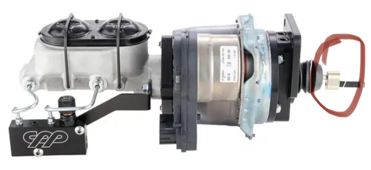

      I basically split the difference between the power brake pivot point and the manual brake pivot point. It’s pretty easy with the CPP kit because it comes with an offset adapter for the Ibooster pedal rod. Instead of running in it the stock configuration which puts the pivot point in the stock boosted location I rotated the offset adapter 180 so that the pedal pivot moved up about an 1” then re drilled the hole where the brake pedal clevis landed. Pedal is still light but much more modulation. I wouldn’t have a problem running it on a track.
      Dec 2011
      Oregon coast
      255
      Just flip this piece so that the rod is on
      the top Name:  IMG_6172.jpeg
