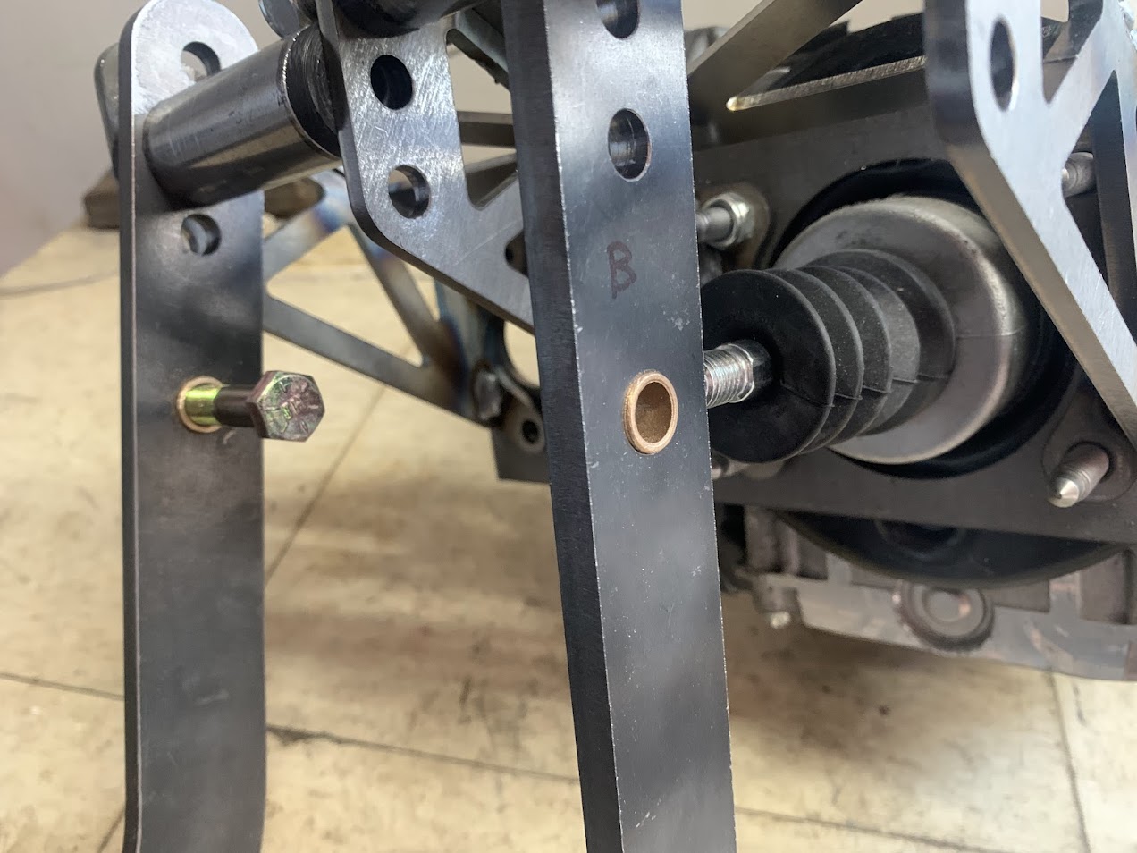

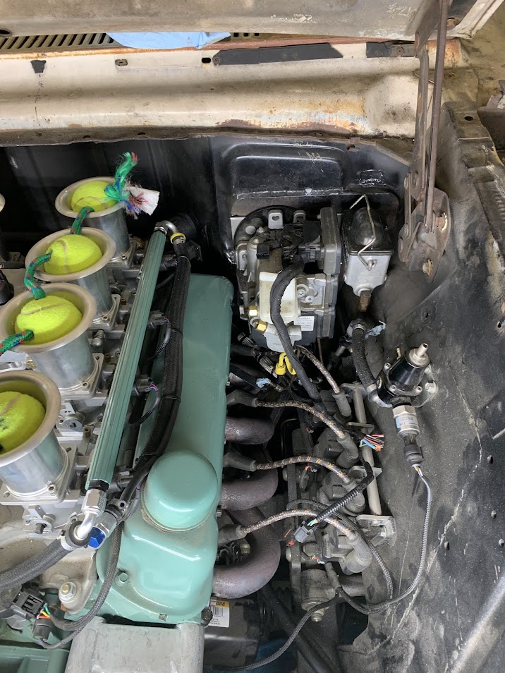

      Here's my setup. 1962 Falcon with Mustang II front suspension. this includes 11" front rotors with 2.75" single piston floating calipers, and 10.5" rear rotors with 2.375" single piston floating calipers. The brake booster is an electric Bosch iBooster and a 26mm (1.02") master cylinder. I think just based on the math the bias ratio is 1.34:1.
      This is a new master cylinder setup. I was using a pedal assembly from wilwood with dual masters and balance bar. I did not like the brake feel, and to keep the rears from locking first under heavy braking, I had to adjust the balance bar to it's extreme. Also I've never been able to get the fronts to lock. So I've designed and built a new pedal assembly with the Bosch iBooster as it is very compact.

      Since this is a frankenstein setup, I'm assuming a proportioning valve would probably be a good idea. However, I can't find any good info on why I would choose a dual input/ouput prop valve vs a single input/output. What is the difference in function between the two desigs?
