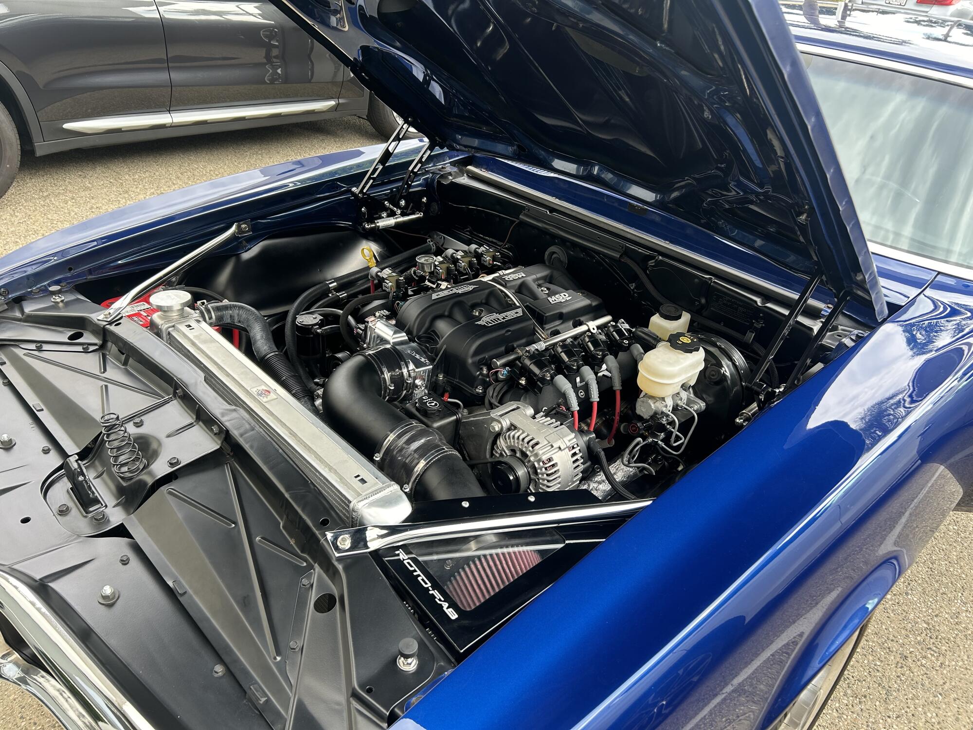

      The dipstick that came with my LS7 is between 4 and 6. I believe it’s a 4th gen F-body dipstick. No issues with plug wires, as that’s how at least some of these came from the factory.
      DewChugr,
      I’m assuming a stock type plug wire with the metal shield won’t fit? I have Granatelli wires that use the stock metal shield. I had a set of MSD wires with long, skinny, bendable boots with heat socks on them. I believe MSD calls them multi angle boots. Something like that could work for you. I’ll post a pic if I have one.
