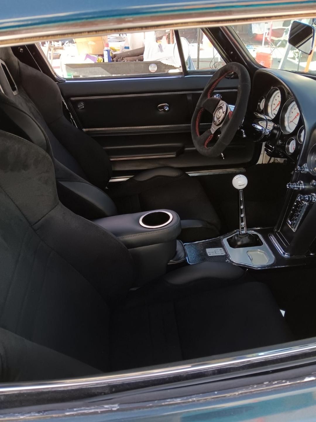

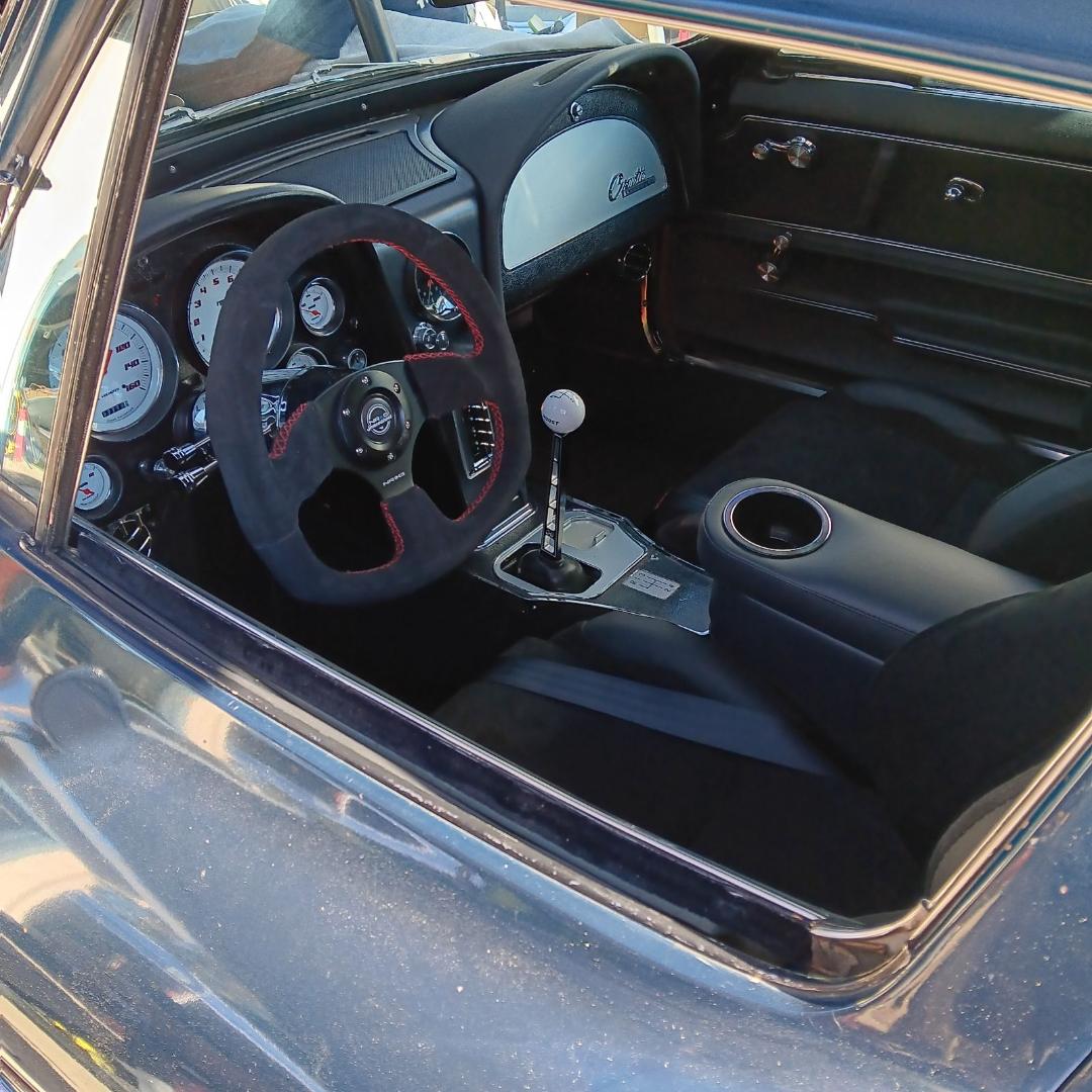

      I recently bought a 65 vette 7 months ago and here is what I did I completely gutted the interior and installed hush matt everywhere then installed new gauges tilt steering column with borgeson box with vintage ac and dewitts radiator with dual fans and a tkx tremec with a quick time bell new flywheel and clutch with billit throw out bearing also a big willwood brake kit and master and wheels and tires and vansteel offset trailing arms with there front upper and lower a arms with coilovers and viking triple crusader shocks front and rear with a fiberglass rear leaf spring and then all new interior peices with newseats and steering wheel and as far as motor went did dougs header side pipe combo with a champ road race pan and a team g intake with a edelbrock vrs 650 carb and all msd ignition and new rear bumpers I think I covered most of it . here's some pics . Name:  65 engine garage.jpg
Size:  251.0 KBName:  65 front.jpg
Size:  690.6 KBName:  65 new.jpg
Size:  140.7 KBName:  65 glove box done.jpg

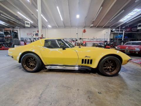

      Thanks just getting the bugs out which was a leaking new borgeson steering box and the ididit steering tilt column turn signal canceling switch is acting up and will fix that next but overall its been great I have two other corvettes I enjoy as well .Name:  69 side shot joes.jpg
Size:  31.4 KBName:  69 side shot joes.jpg

      another vette Name:  65 vette at dicks.jpg

      How are the seats? I've been considering something like this in my 66, stock seats are not very supportive and sit a little high for my liking. I'm guessing it didn't do anything for seeing out the back window.
      Also what front air dam is that?

      seats
      The seats are great but if your over a 36inch waist prolly not at least in a vette but the wider seats they have prolly but won't fit in a c2
