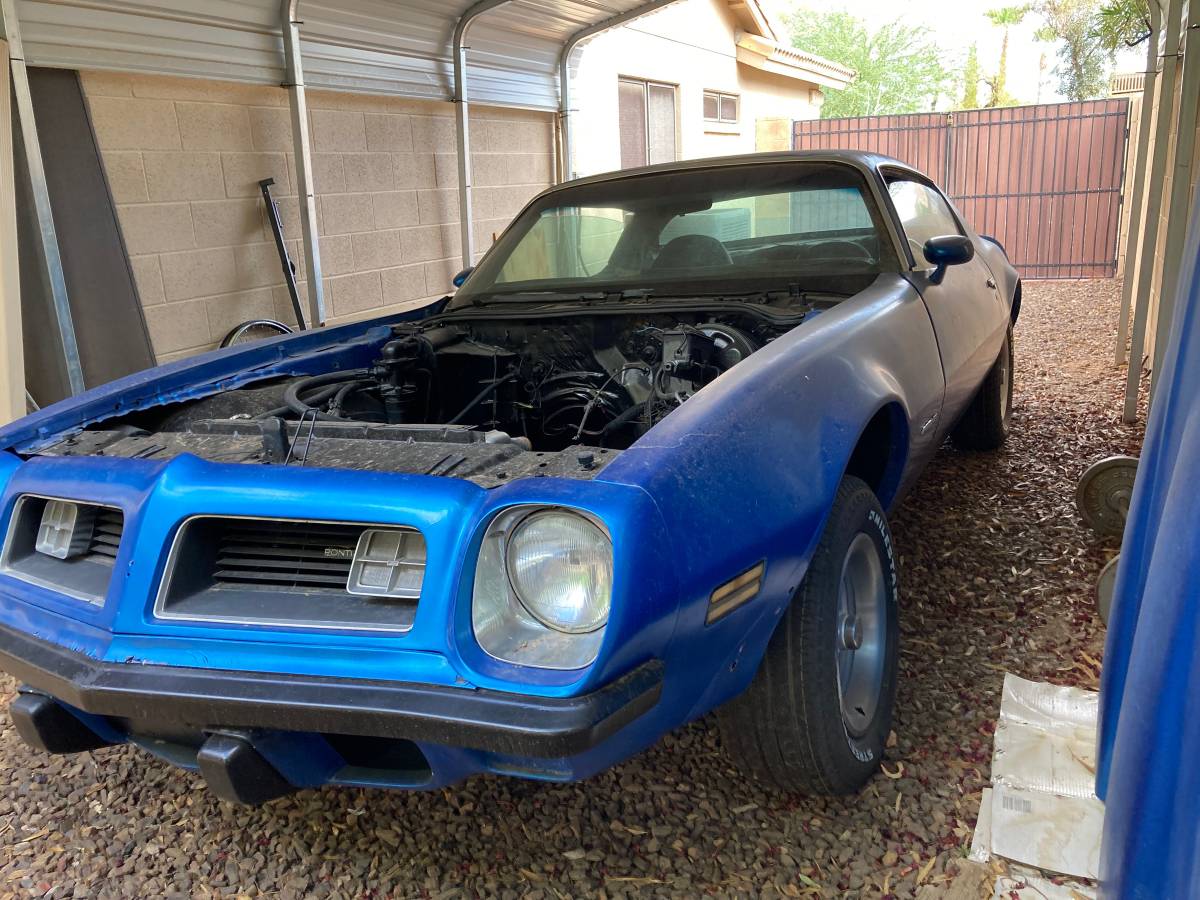

      Long time lurker. Too lazy to work on the car tonight so figured I’d bite the bullet and share some details about my project.

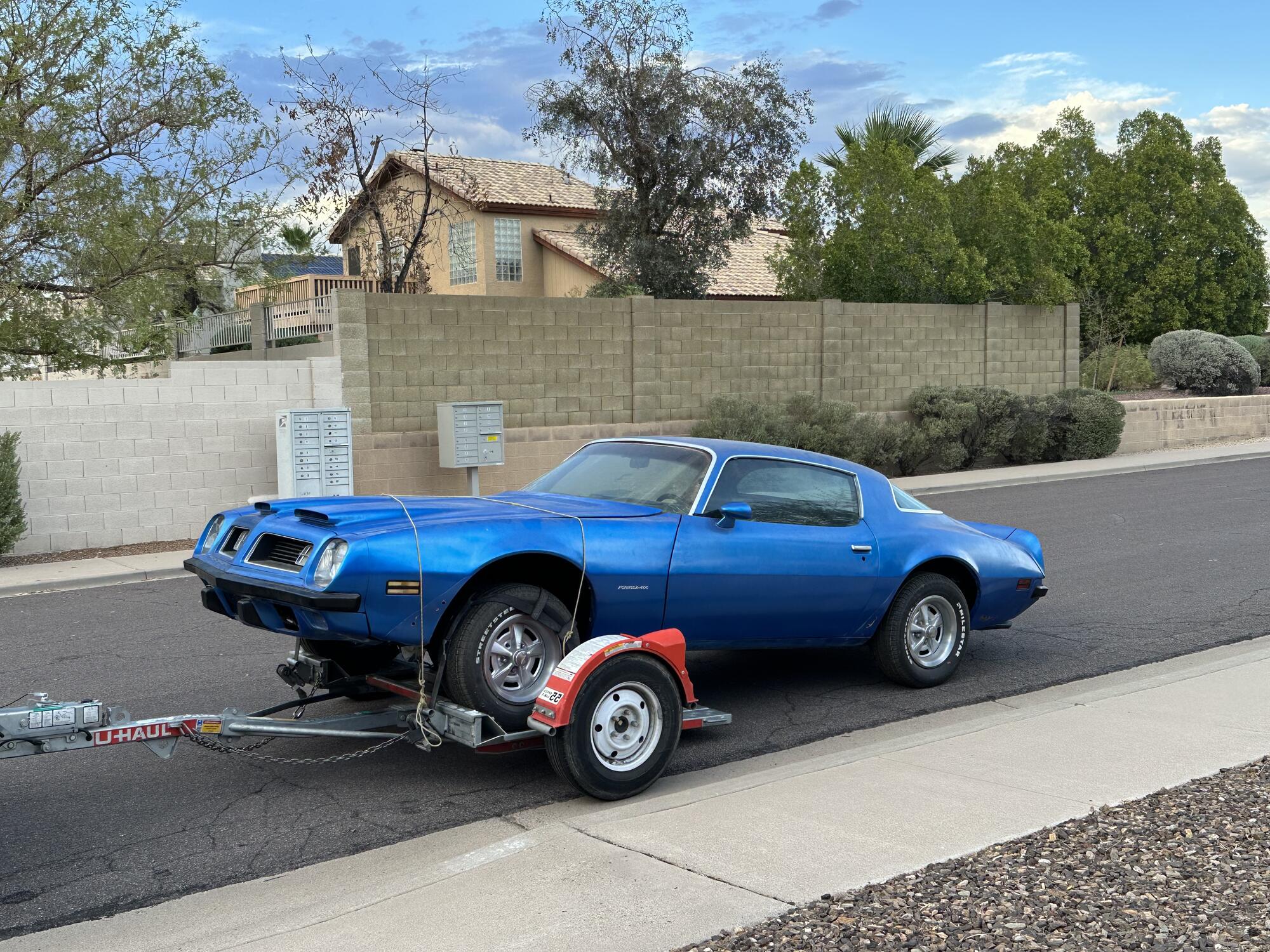

      The car is a 1975 Firebird Formula I purchased in Sept 2023 in Mesa AZ. My family has always been a Pontiac family, the price was right so I said wtf. From what I was able to research, it’s been an AZ car for at least the last 25 years. When I bought it there was no motor or tranny.
      Why the project: I'm in the 7th inning of my professional career and wanted to build a car I can drive in retirement. I am a Mechanical Engineer by schooling but actually work in tech. Always been a hands on guy but I’ve never taken on a project like this before. My auto experience is built on basic car maintenance (fluid changes; wheel bearing changes, tune ups, etc). I needed a new challenge so here we are…
      Back to the car. When I bought it I knew it needed some work. I saw there was some rust in the passenger floorboard, driver rear quarter needed to be patched, and the trunk pan needed replaced. I uncovered more rust but I’ll save this pleasant surprise for later. Name:  IMG_0089.jpeg

      The car used to be Bimini Blue. What drew me to the car was the hood scoops. I just think they’re bad ass and you don’t see formulas around all the time.

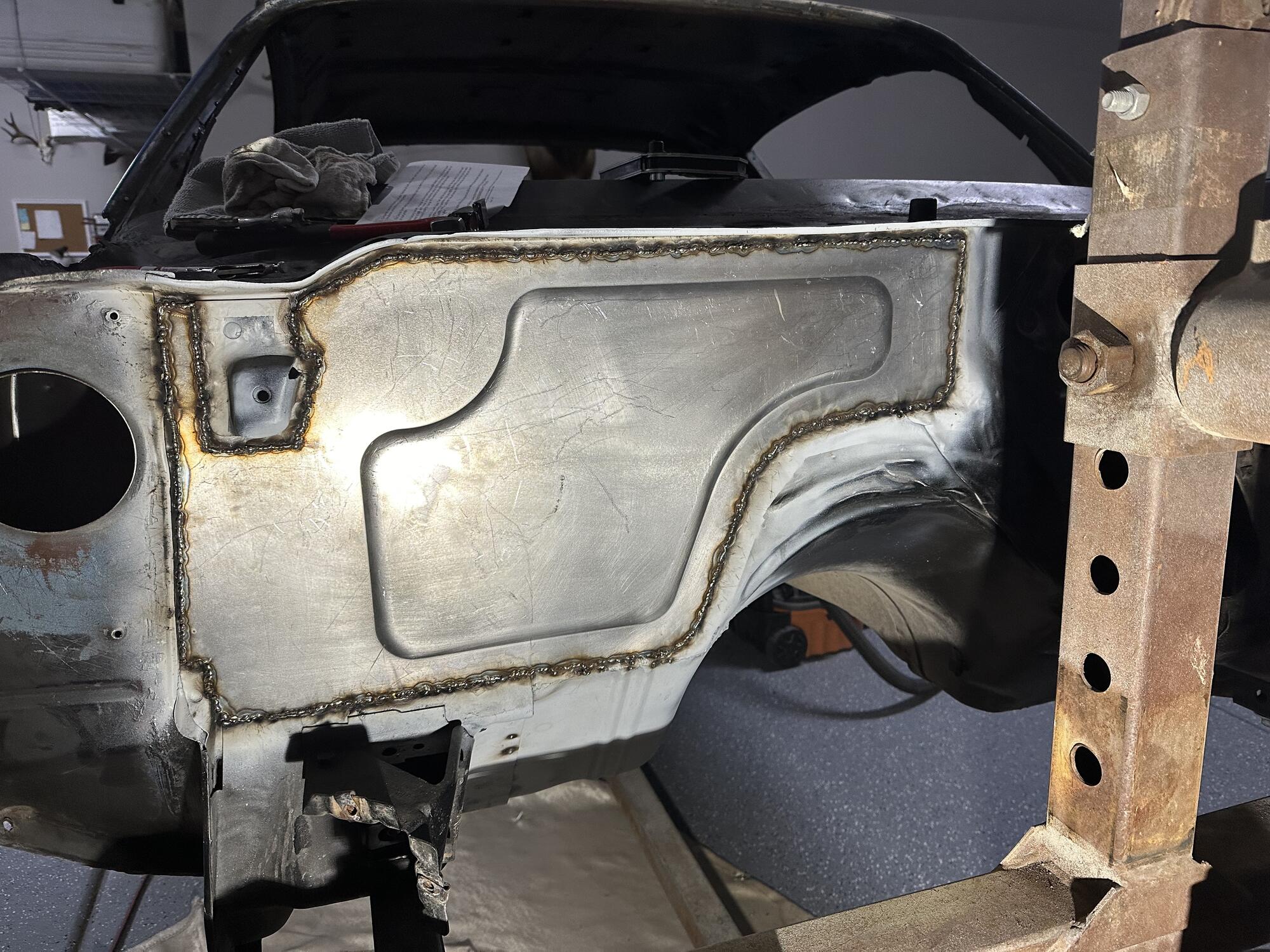

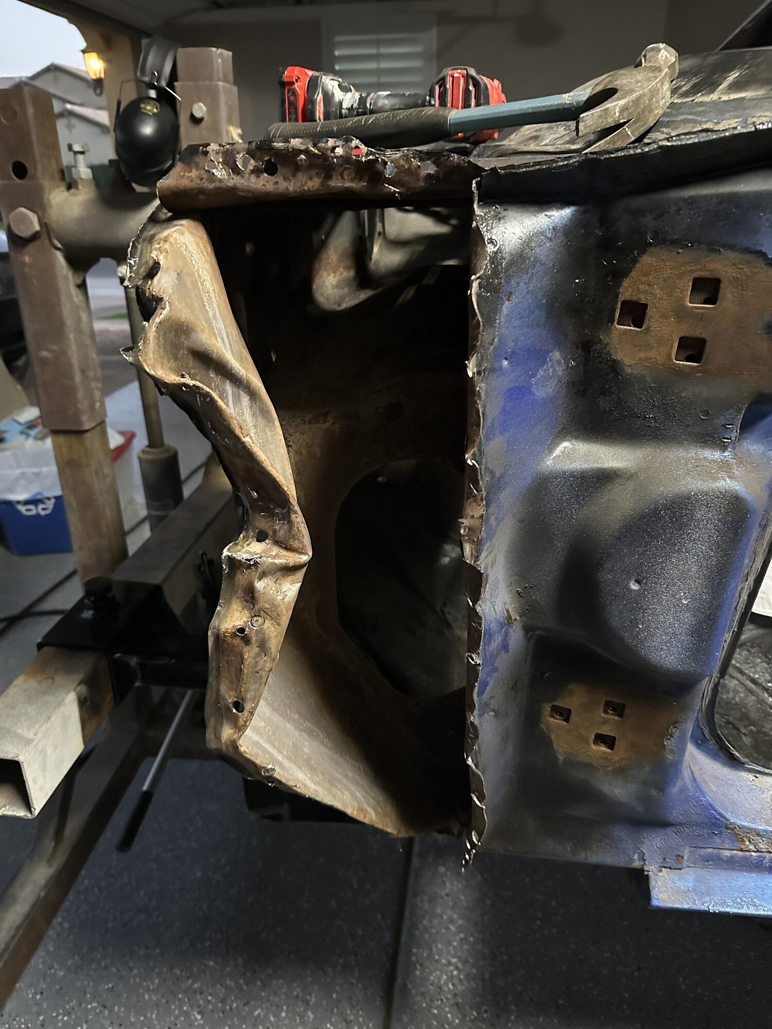

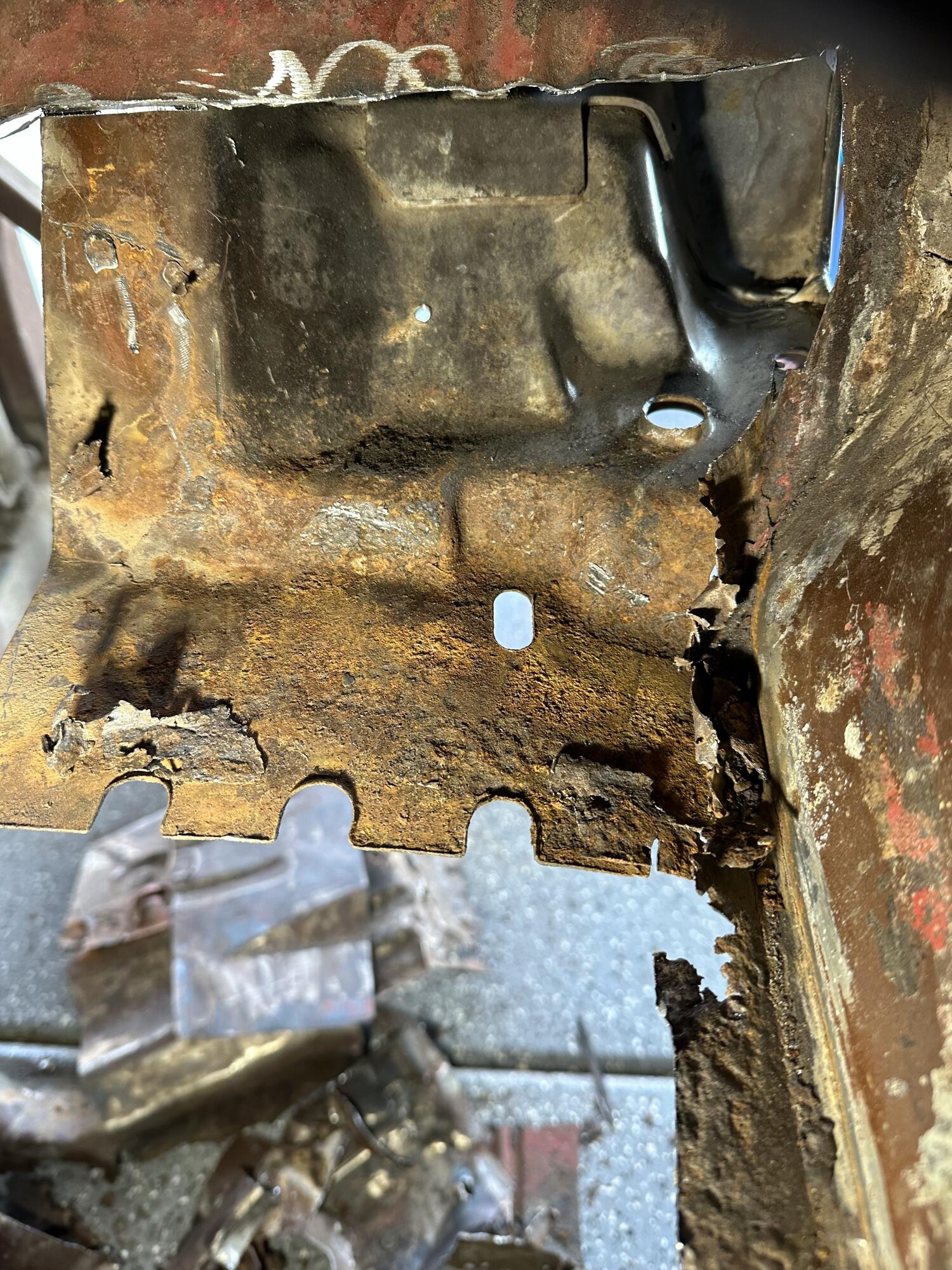

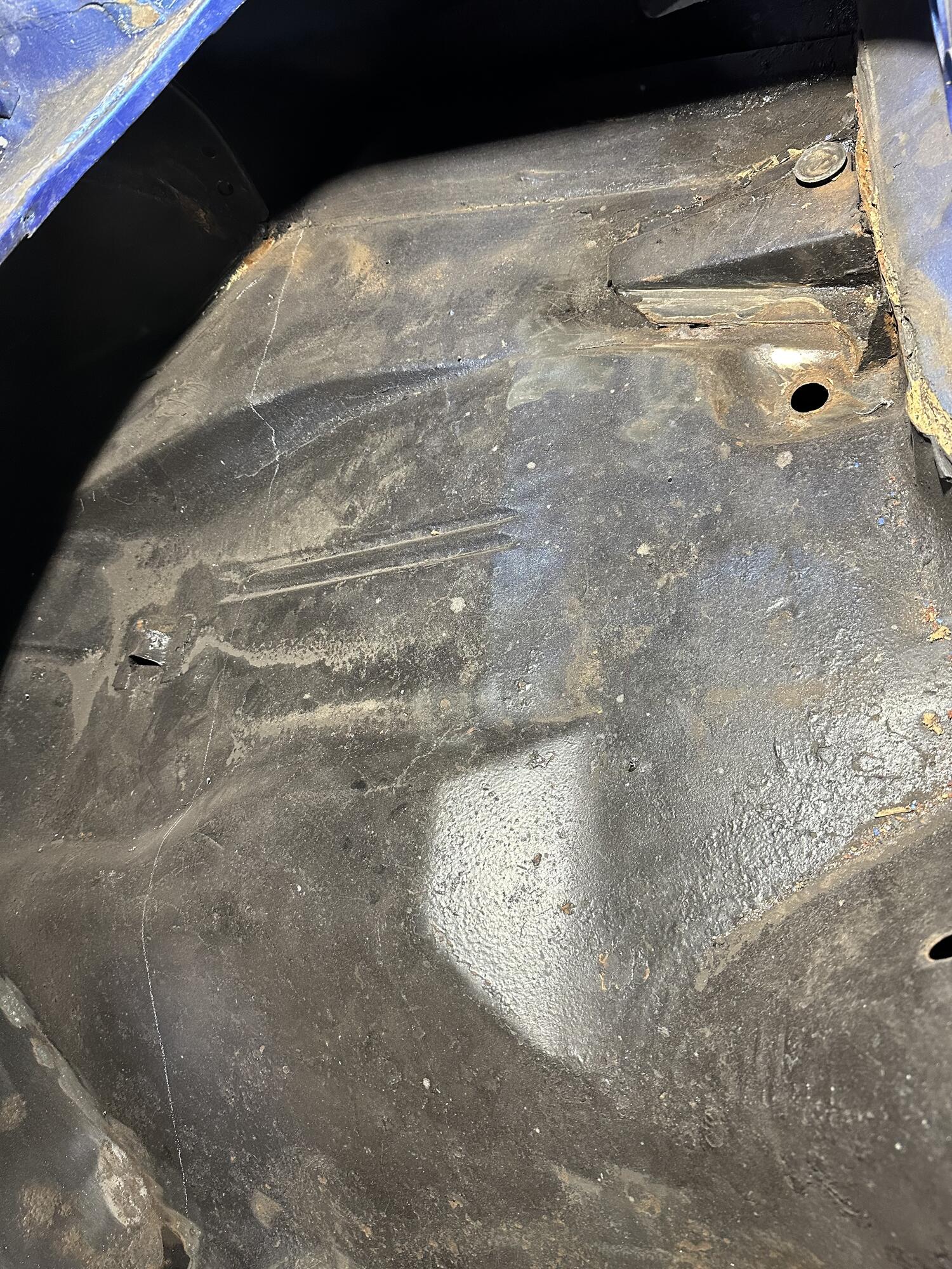

      The disassembly went fine… just a lot of bagging and tagging. One surprise was this collision damage on the driver side cowl. This would be my first real project…holy **** we’re really doing it buddy!!!
      I drilled out the spot welds and was able to remove the outer metal. Then once I had access to the inner cowl I used a handheld crowbar, a long screw, nut, and two large OD washers to gain leverage and bend the damaged piece out. Once it was most of the way there I was able to use a hammer and dolly to get it as flat as possible. I welded the holes I drilled closed when done.
      Overall it came out good for what it was. It won’t be visible anyway when the fender is reattached.

      I should also highlight that before I welded the outer piece on I neutralized any rust on the inside with ospho, cleaned it up good and sprayed with epoxy.
      This was my first time welding. I bought one of the HF Titanium welders. I watched some you tube videos to figure out how to mig weld. This project gave me plenty of plug welding practice. It wasn’t pretty but after belt sanding it was respectable.

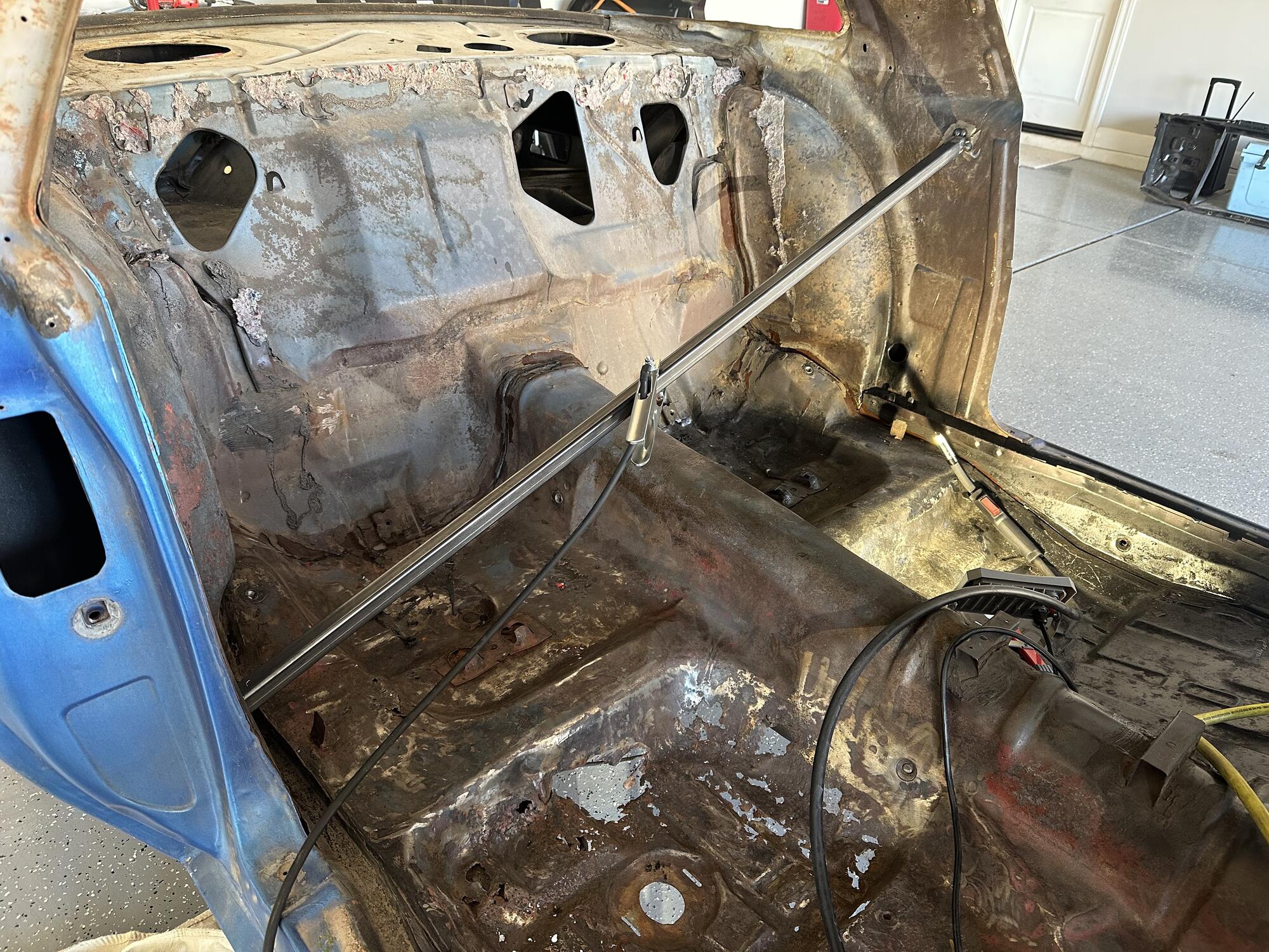

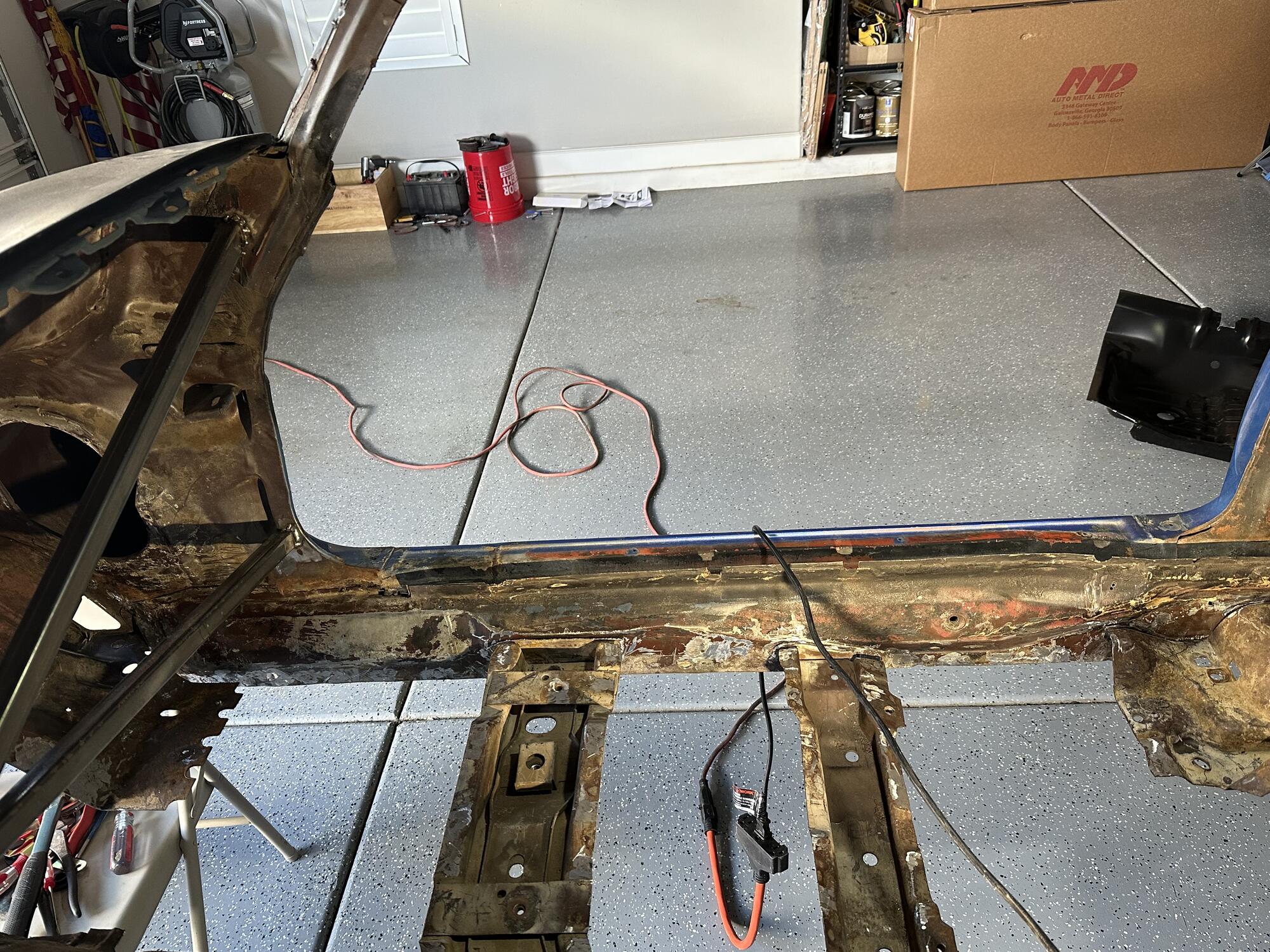

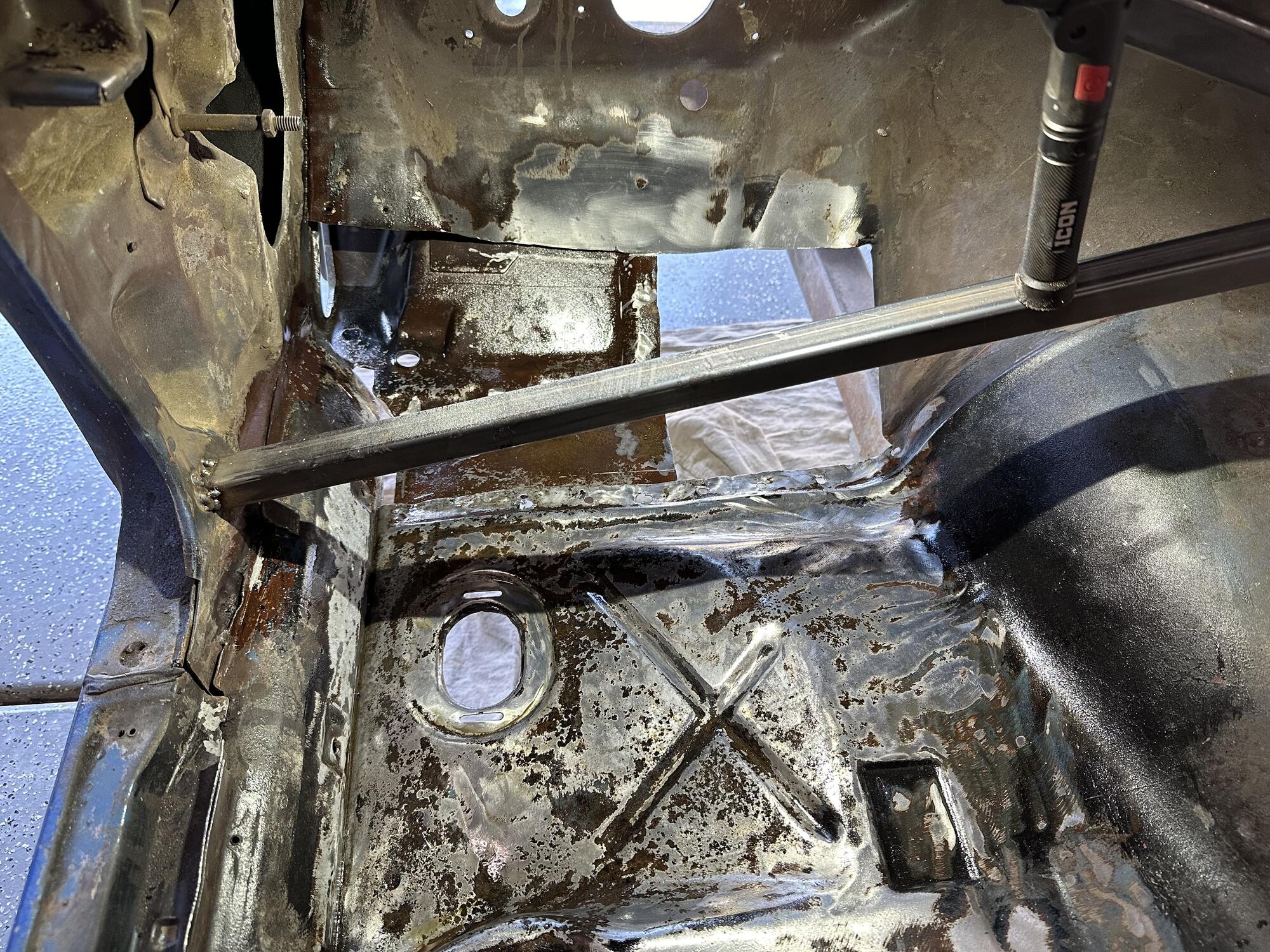

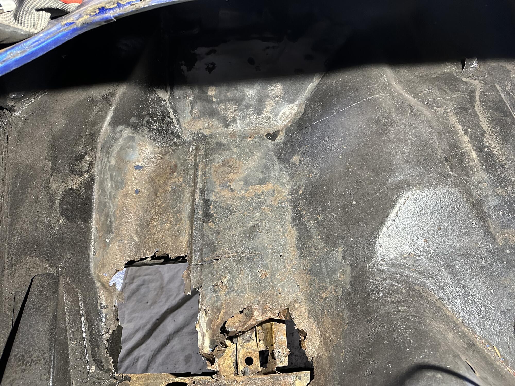

      Ok, so now that I was a self trained welding expert I decided to step up my game and tackle the floorboards. I figured if it wasn’t pretty at least it would be covered by carpet.
      During the euphoria of the initial vehicle purchase I surveyed the car and purchased various sheet metal/panels because supply chain was still a little sketchy. My original assessment was the rear passenger pan had to be replaced and the passenger side floor pan up to, but not including the toe board. After I started tearing into though I realized the passenger toe board was all pitted as well and needed repair. It was just too thin to leave it as is….Unfortunately I could not source a third piece in the toe board only. I had to buy another entire passenger pan including the toe board. This was an unforced error and cost me a few hundy. Maybe I’ll take on another f body in the future and I can use it lol. If anybody can use it lmk I’ll give you a good deal.
      I used a cutoff wheel, body saw, and air hammer to cut out the old floor. The torque box had some surface rust but nothing I couldn’t clean up. The frame rails were just dirty no rust.

      To prep the new area I used wax and grease remover and applied ospho to treat rust. Then I cleaned everything up including in the rails, applied epoxy and weld thru primer on the areas I would be welding.

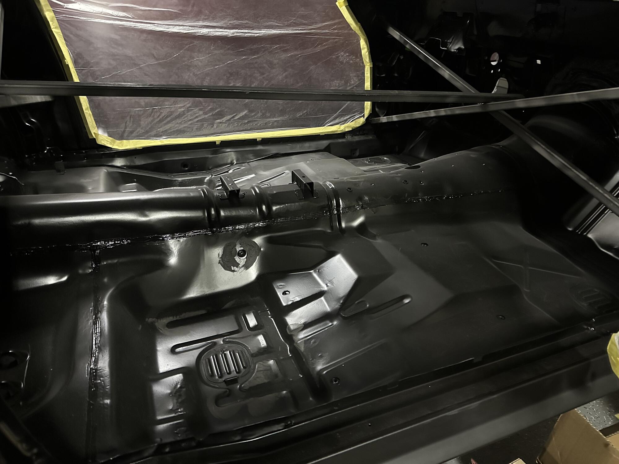

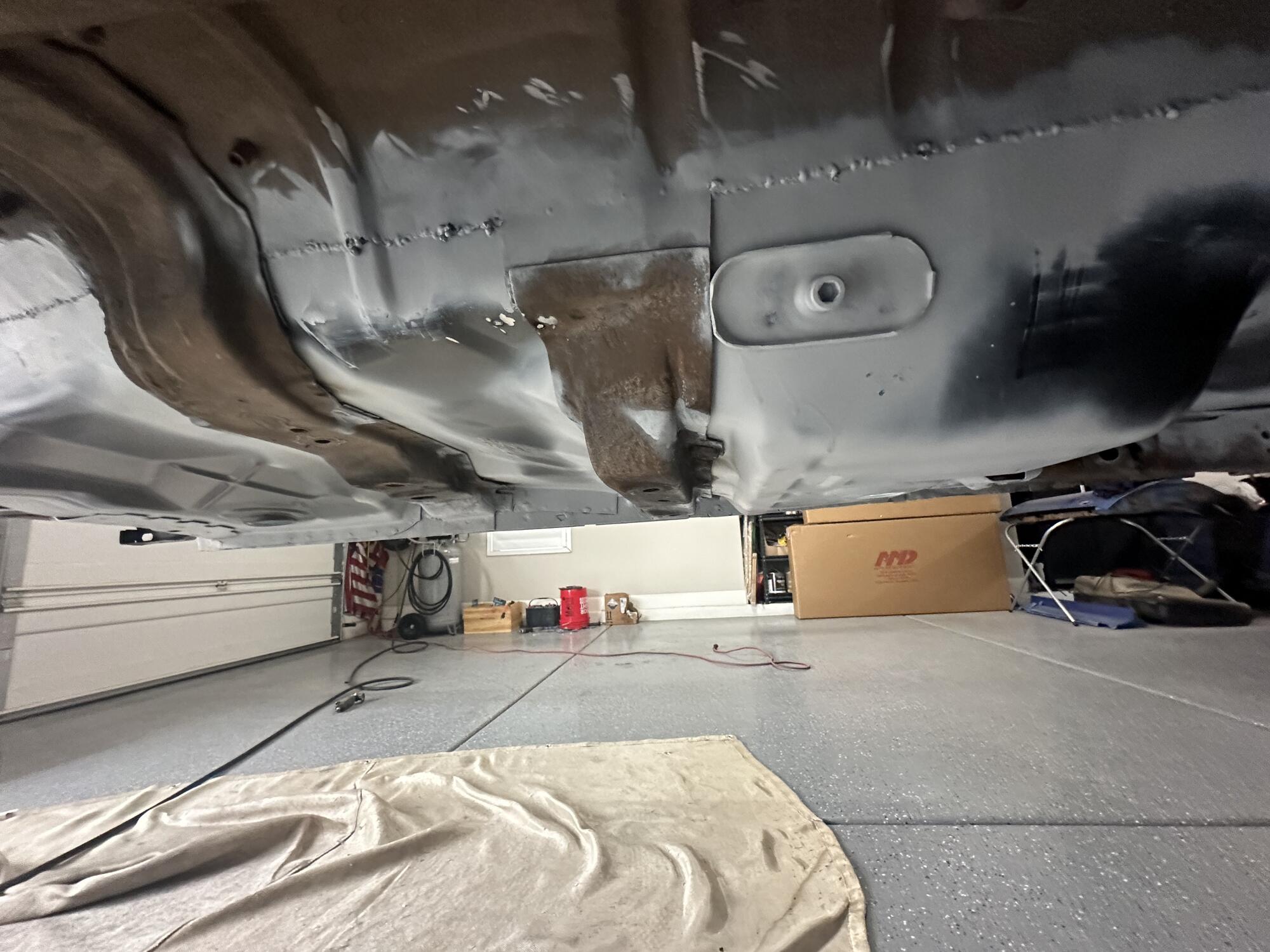

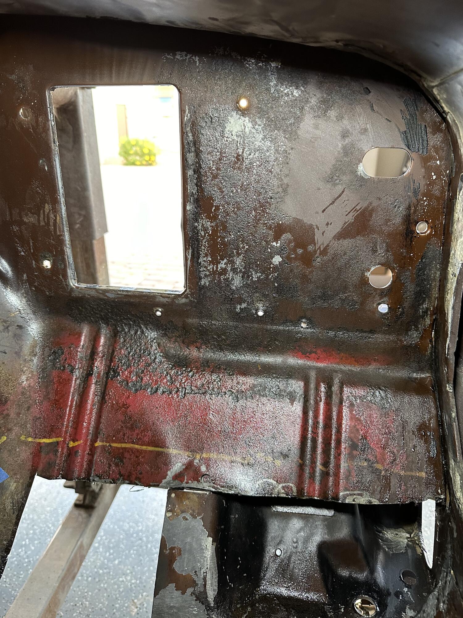

      The installation of the main passenger pan went ok. One thing I did which I think was thoughtful is there is one cross member that doesn’t go all the way across (one does, the other doesn’t). I made sure to keep enough original floor pan connected to the shorter cross beam and then attached the new pan to that cross beam also. I felt like this would be stronger way to tie in the old pan with the new.
      As you can see from the pics it looks like I got good penetration.
      For now, I just sprayed the welds with primer and moved on. My plan will be to dress the welds better under the car, apply some duraglass on the welds and do what I can, within reason, to hide the welds.
      As a SPOILER ALERT, I actually recently did this body work with Duraglass, took it to 120, reapplied epoxy primer (SPI) and applied raptor liner and it came out really nice. You can hardly tell it was replaced. For the inside I applied 3m seam sealer to the welds and seams and sprayed it all with SPI Epoxy.

      A recent pic on how it looks on the inside with seam sealer and epoxy. For my first time I’ll take it!

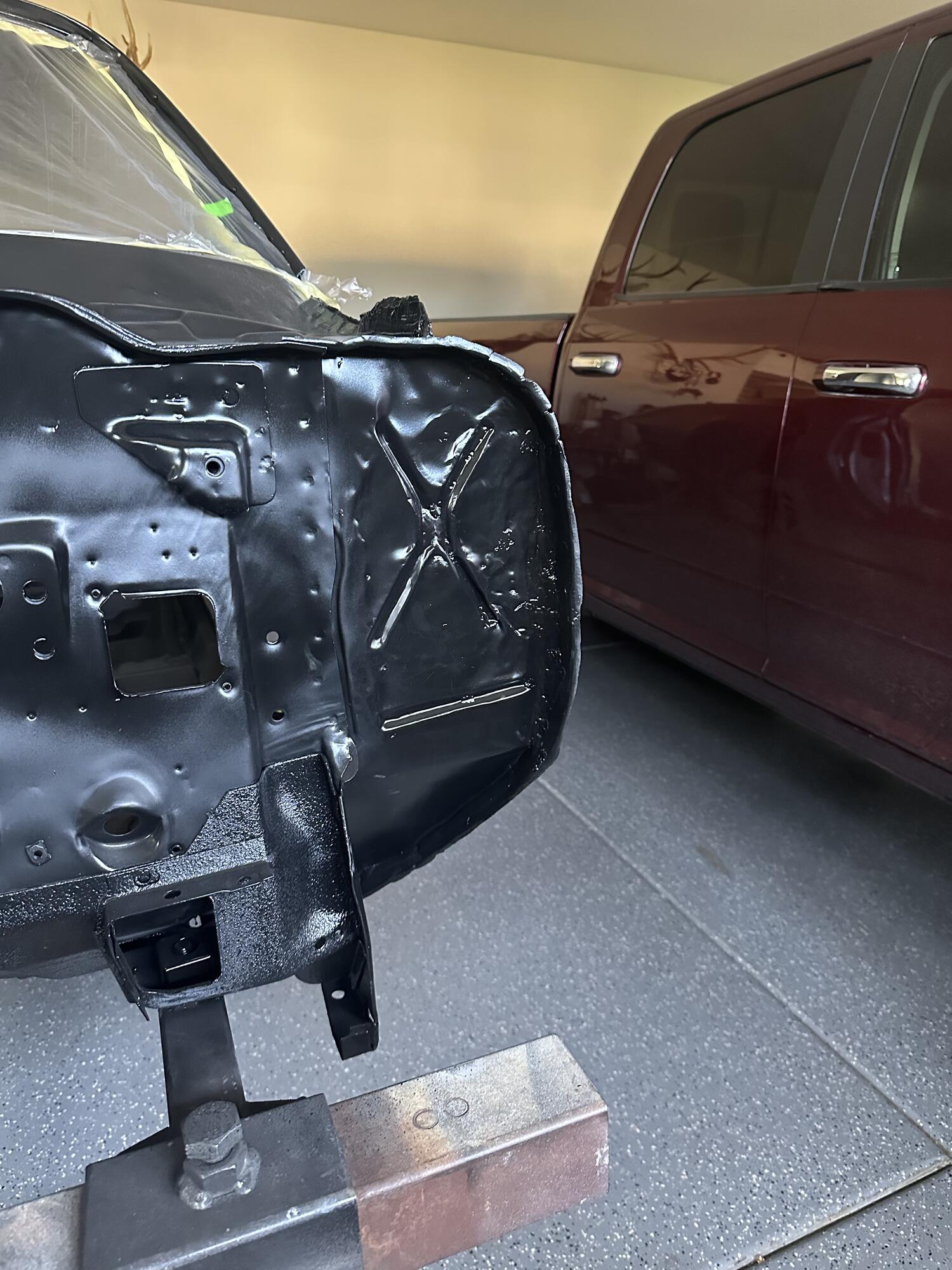

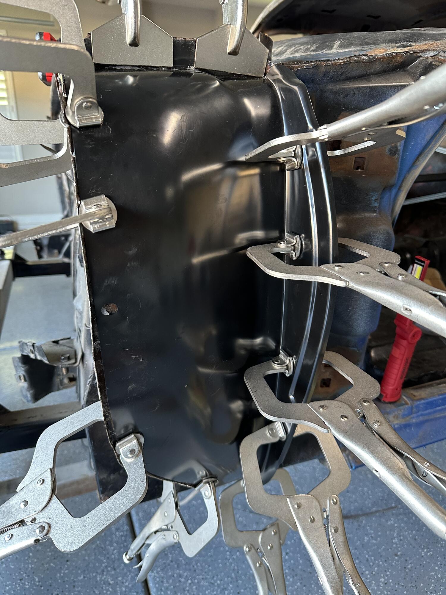

      After the floor pan the next step was to install the Detroit Speed firewall panel. Im going to go with a Vintage AC System so the holes on the passenger side are no longer required.
      Overall it went on fine. It’s a lap weld joint for this install. I took the firewall down to metal then used epoxy primer for the middle parts and weld through primer where I need to weld. Overall it’ll work I think….. Ill dial it in with some body work later in the process. Name:  IMG_0760.jpg

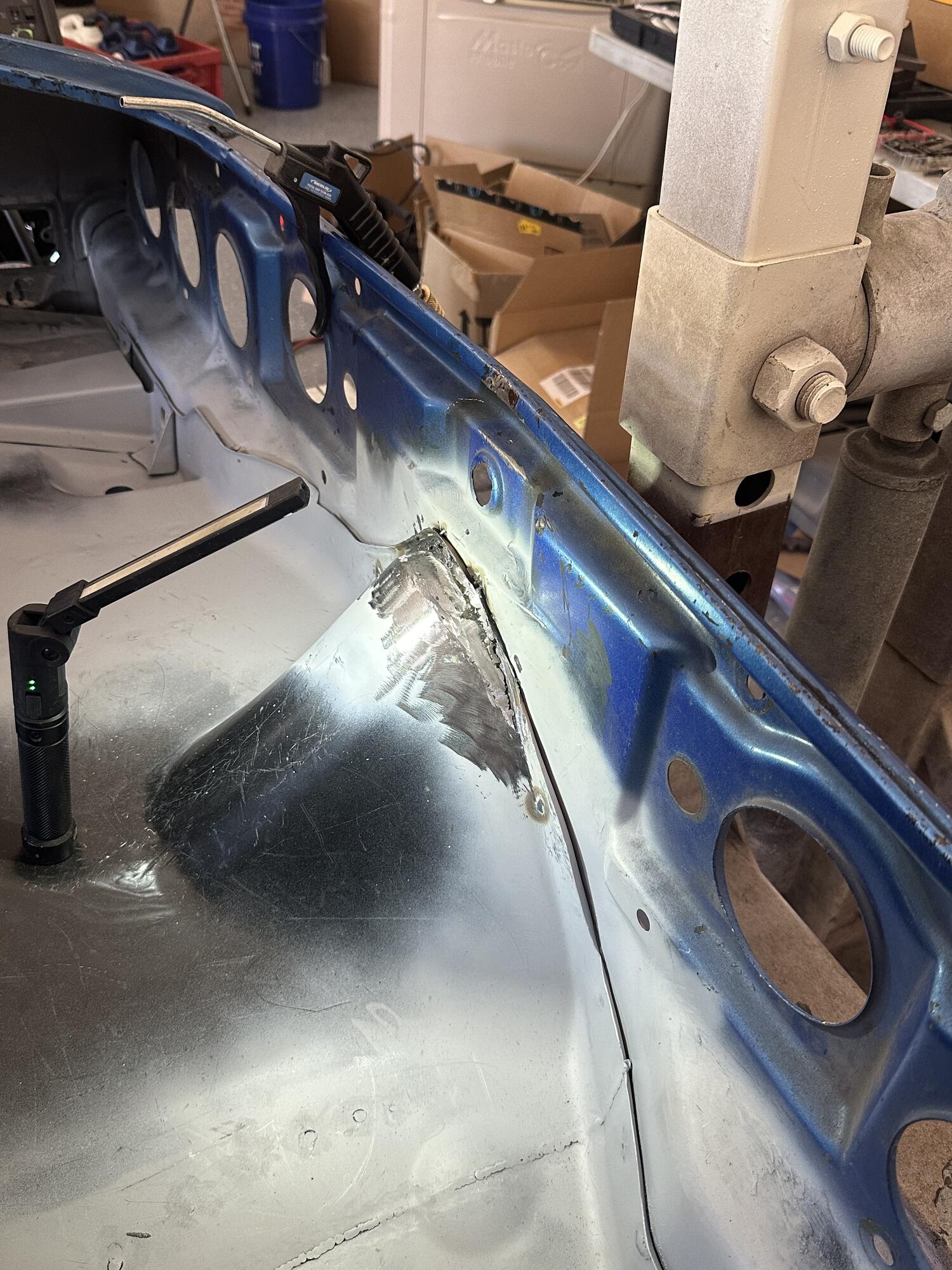

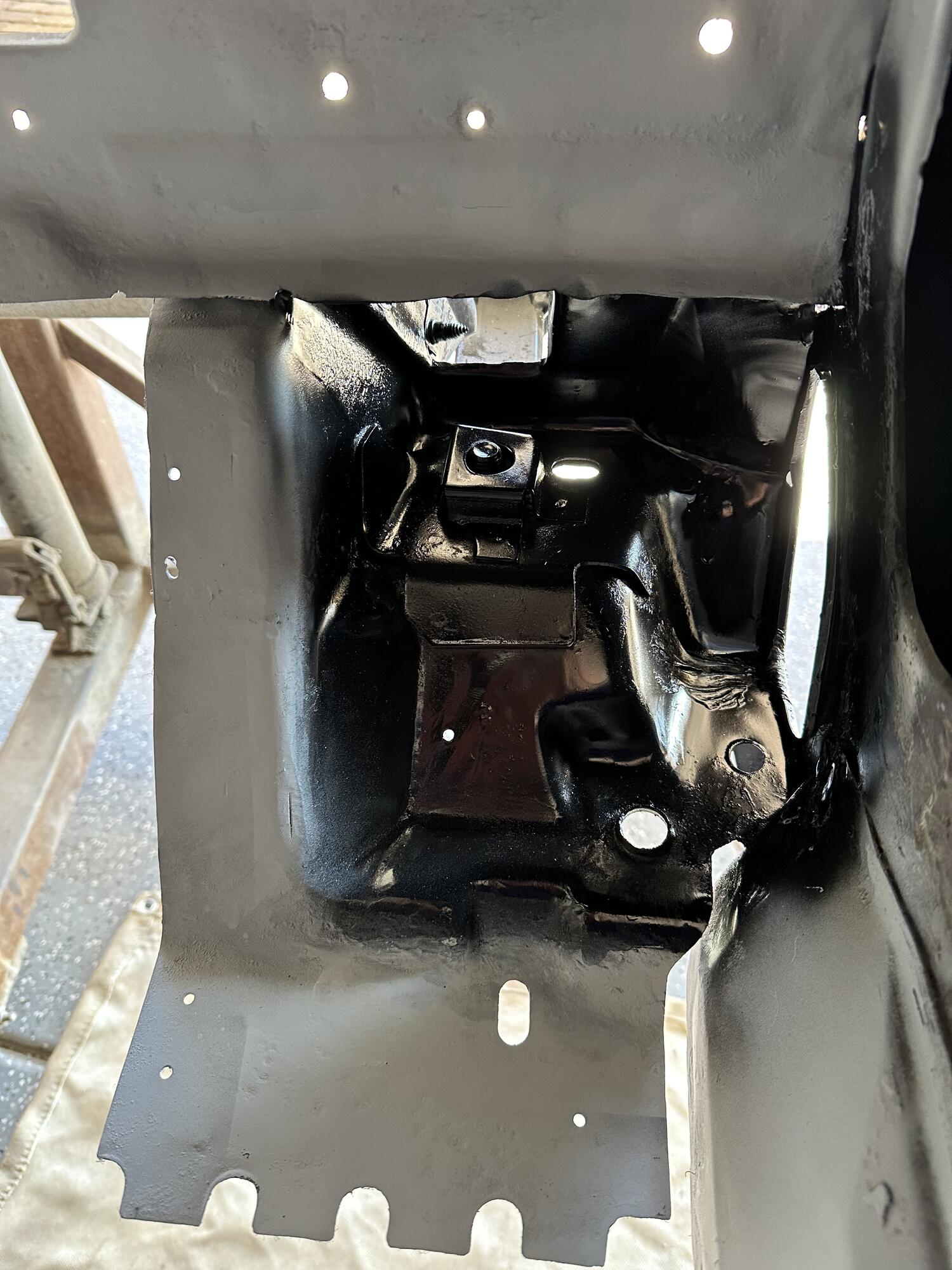

      Sticking with the metal work theme, I realized around this time that the drivers side toe board had some rust. It was small rust holes. I could have left it and used Duraglass but I didn’t want to half ass it. Had I known the extent of the floor damage I would have done a total floor pan vs how I did it. I guess as a consolation it’s nice to know there is still approximately half an original floor in the car.
      Anyway, this patch went on pretty straight forward. Similar as the passenger side, I cleaned and osphoed everything and then applied epoxy to hopefully protect it for another 50 years.

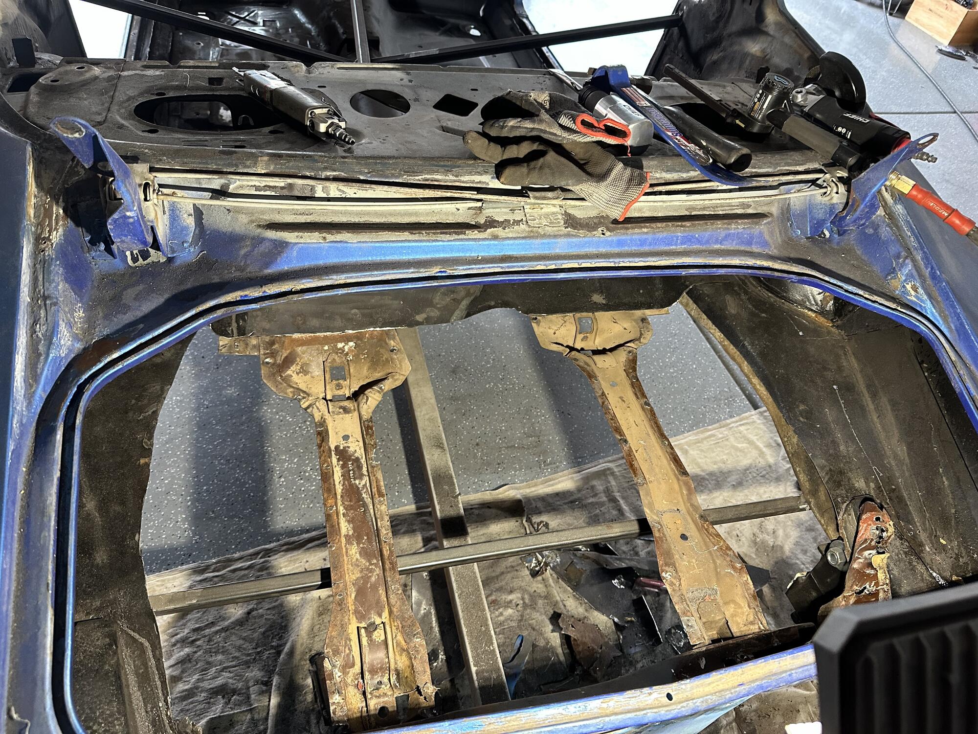

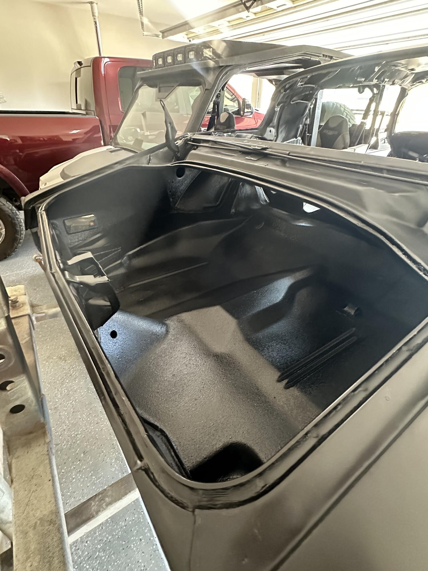

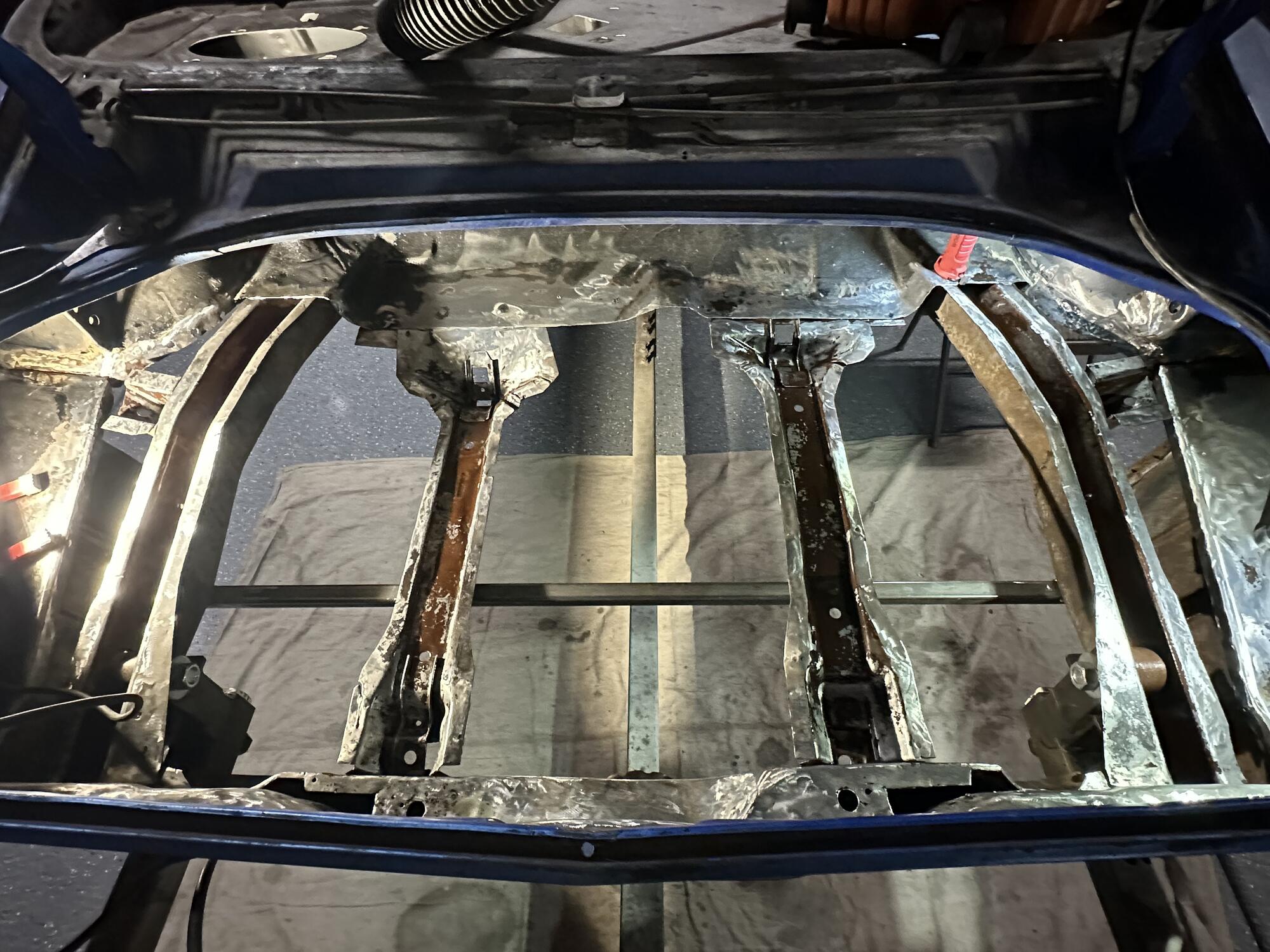

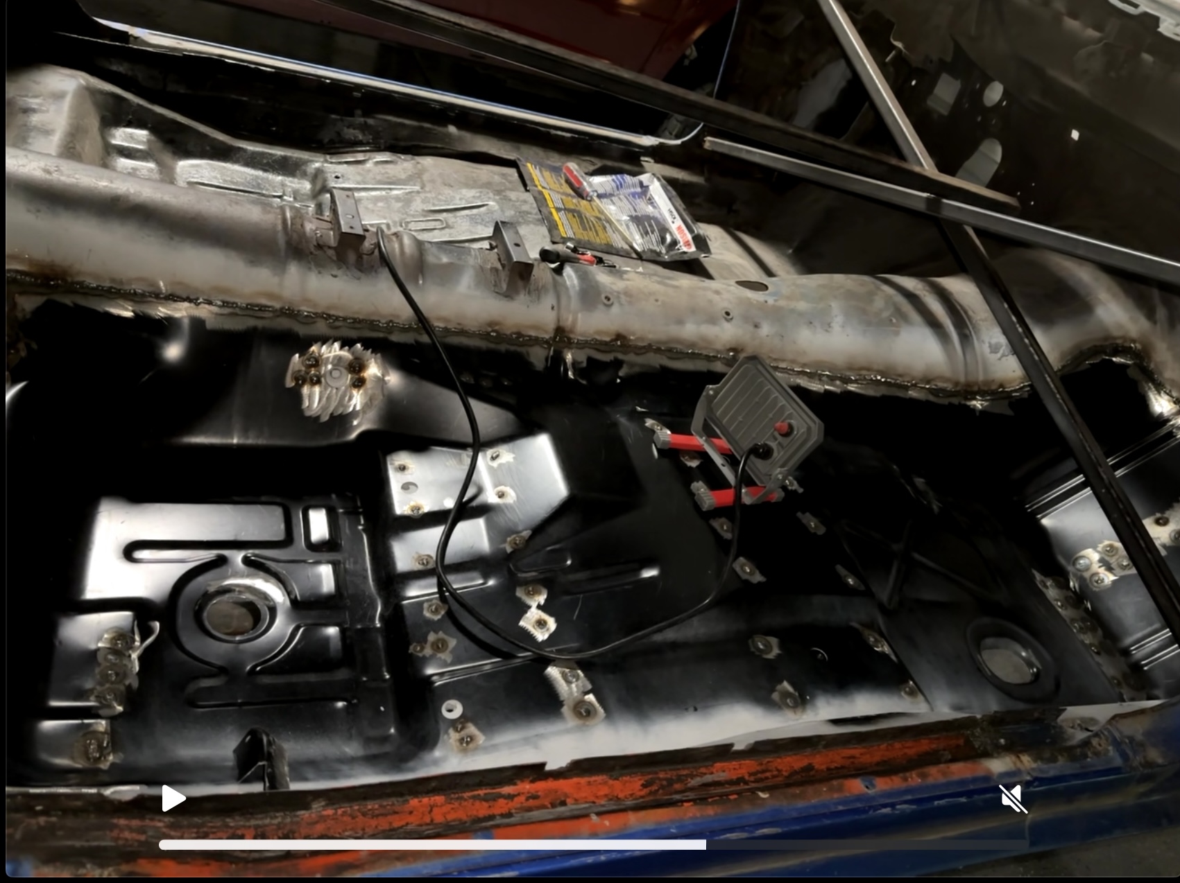

      Next step was to get the trunk repaired. I wasn’t looking forward to this project given the awkwardness of working in the trunk.
      As you can see from the pics the rust was concentrated to the pillar structures on either side of the trunk pan.
Size:  692.8 KBName:  IMG_0777.jpg
      I elected to not replace the pan 100% but instead patch it side to side completely (all the way to trunk drop offs in other words) but only high enough into the trunk so that the rails that hold the fuel tank straps would still be welded to the original metal. I also decided to put the new pan in two pieces. Lots of cars offer pans in two pieces only so there is precedent from a quality and robustness point of view…and I figured I could save some labor with respect to removing the tail pan (which looked like a whole other can of worms).
      I strategically made the cut in the new pan so the butt weld will be concealed underneath by one of the rails. I then also plug welded the heck out of both pieces onto that rail to give it added strength.
      Similar as other phases of this project, thoroughly cleaned up the rails and applied epoxy and weld thru primer.

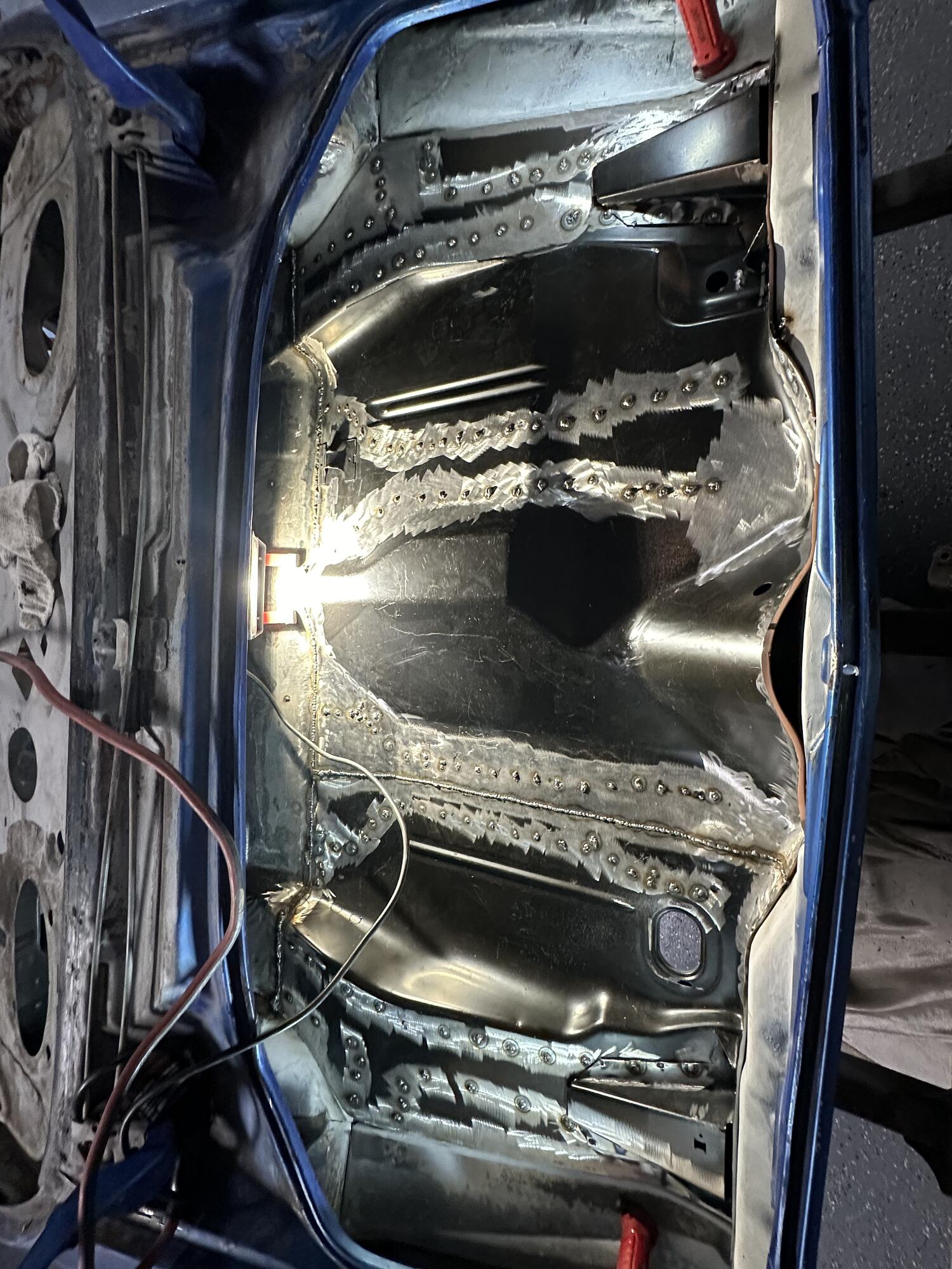

      Once I had it welded in, I applied SPI epoxy to seal it up and then did some minor body work to hide the repair. I knew I was going to raptor line the trunk so I didn’t have to go too crazy on the body work because raptor would offer some coverage.

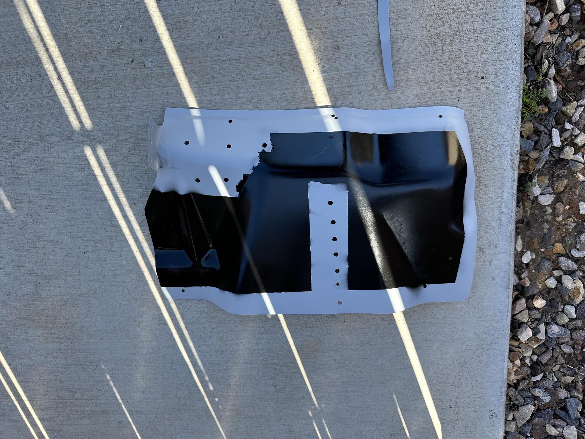

      I did have a zinger on this project. The new patch piece wasn’t in spec. When I fitted it in the trunk the hump section did not sit flush with the tail pan (see pic). Given I already cut the part I couldn’t get a refund so I had to fab a small patch to fill the gap. What I did was cut the hump area and bent what flange I had to work with flush to the tail pan. Then I used tape to create a template and I welded the patch in. It’s not perfect but I didn’t worry too much about it because the trunk latch mechanism will cover 90% of that area anyway. It’s solid and sealed so should be good to go.
      One last consideration, the driver side quarter needed to be patched and when I cut into it to investigate the extent of the damage I saw the drop off needed replaced also. I used the old rusted drop off as my reference for the new trunk but I didn’t weld that part in. This way when I tore out the rusty drop off the new trunk pan could then serve as a reference for positioning the new piece.
      I was kind of 50/50 on raptor in the trunk but after I got it done im very pleased with the outcome.
      Metal work is kicking my butt. I smell like a steel mill and feel like I have metal shavings sweating out of my pores lol. Should be all downhill from here as it pertains to metal work…I did not keep perfect accounting but this probably took me 5 or 6 weekends. Big job!
      Apologies for some reason the pics are not uploading in the right order

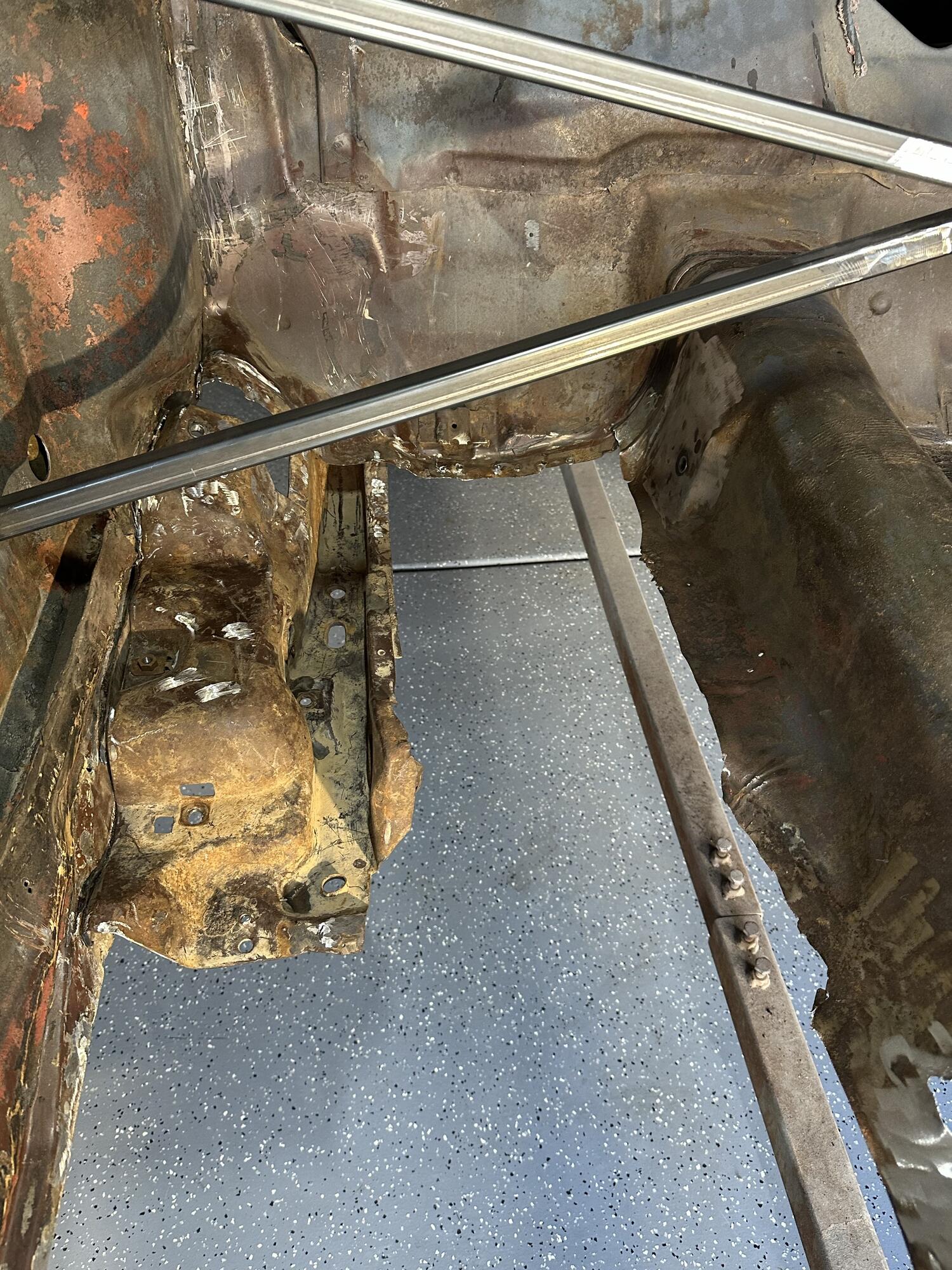

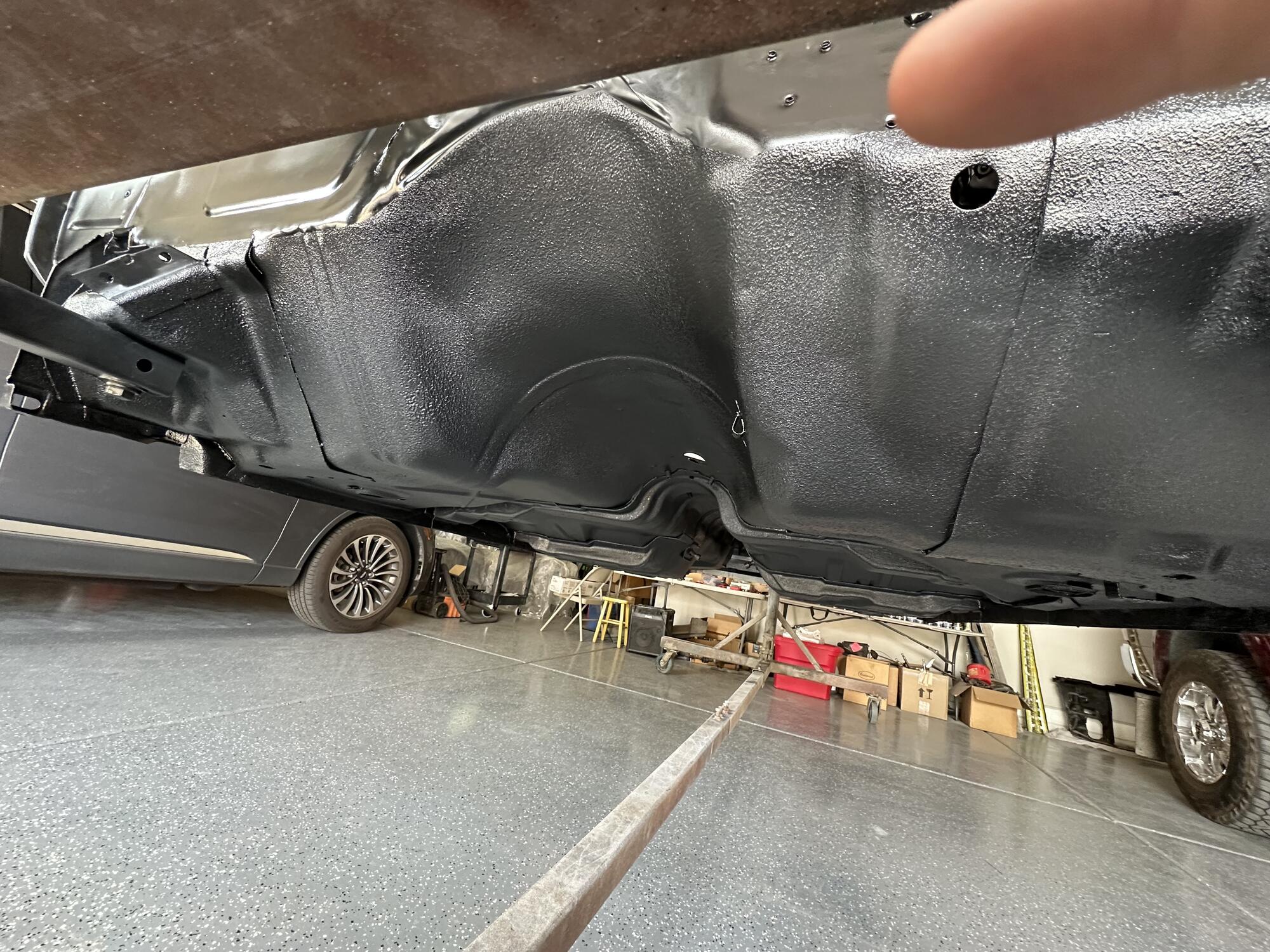

      I should also mention while I had access to the frame rails I bought some of that Eastwood spray that’s supposed to neutralize and treat rust inside of frame rails. While I was at it I also blew out the rockers as best I could and sprayed the Eastwood stuff in the rockers too. They looked in good shape so hopefully this buys me another 50 years.
