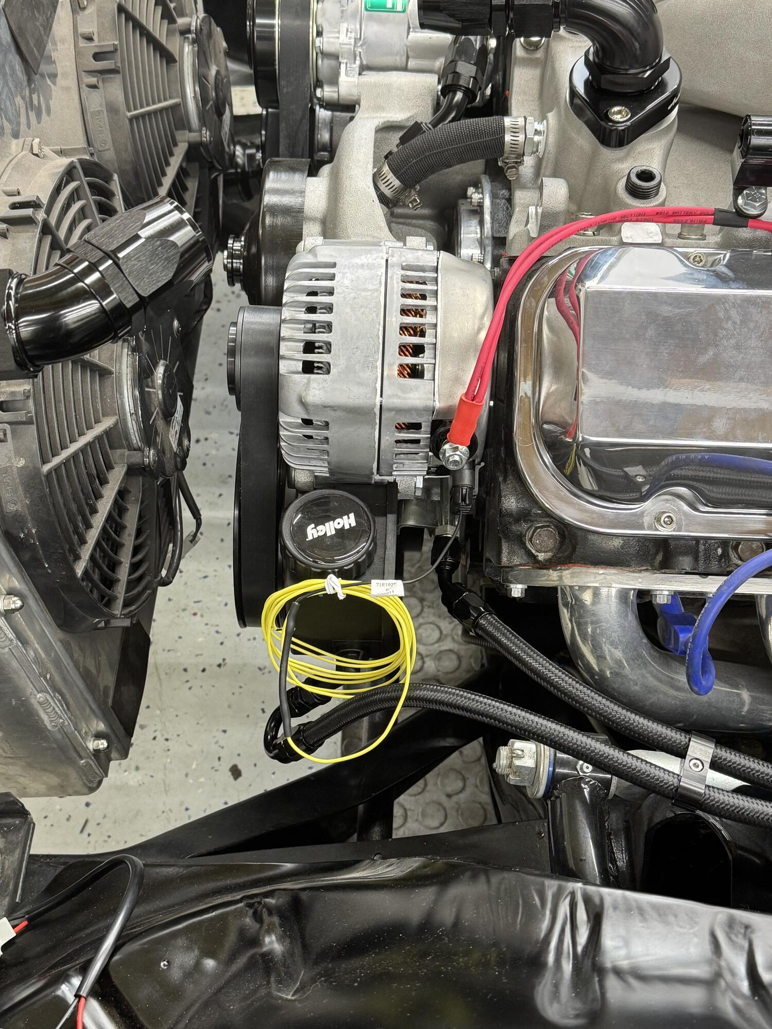

      Where does this Holley alternator wire go?
      Just making sure I get this right

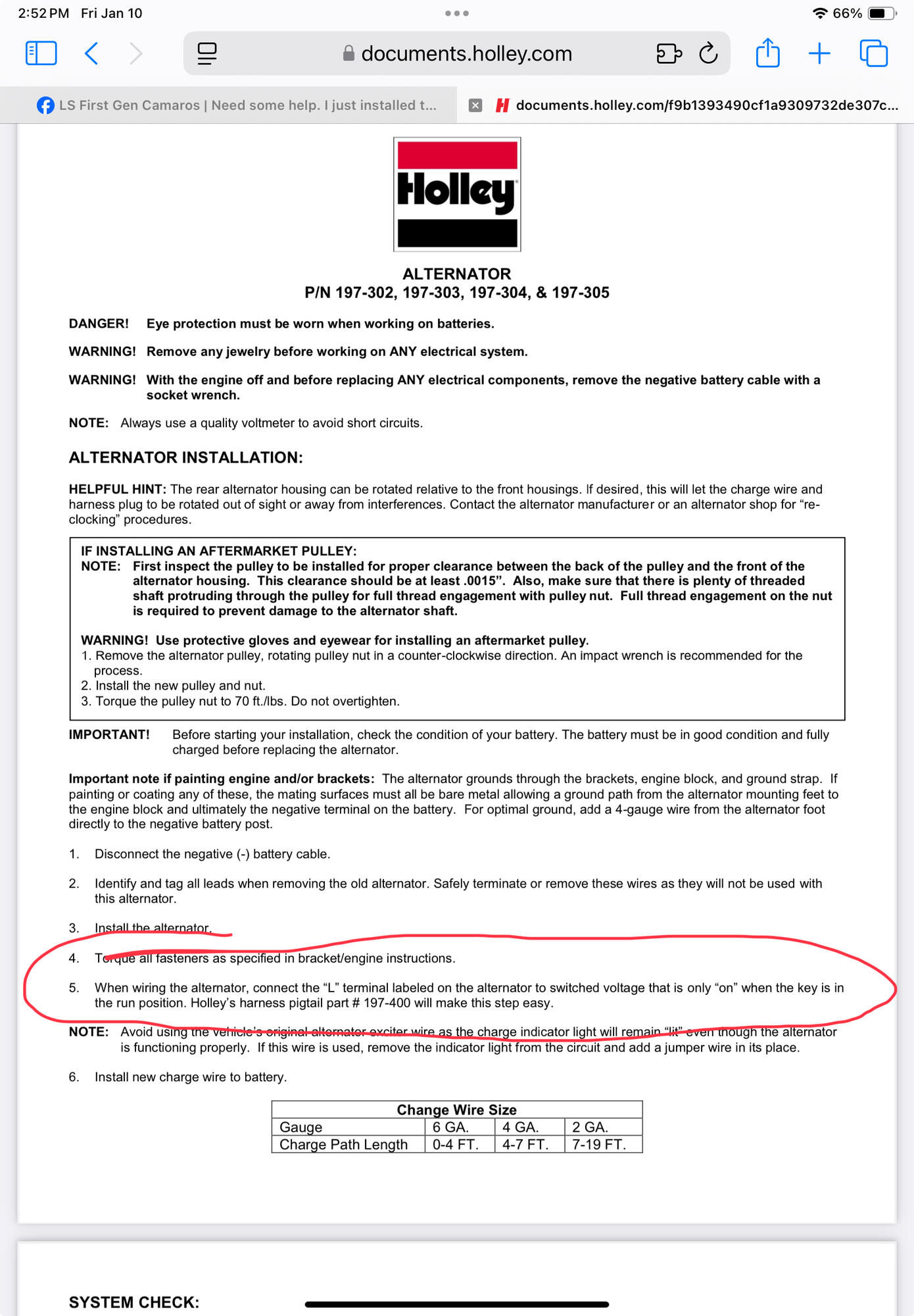

      To a switched 12 volt source. Needs to be 12 volts only when the car is running.

      it need's to go to a switched run positive.
