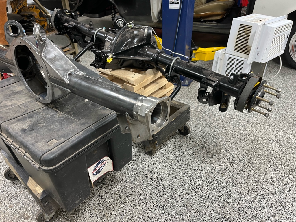

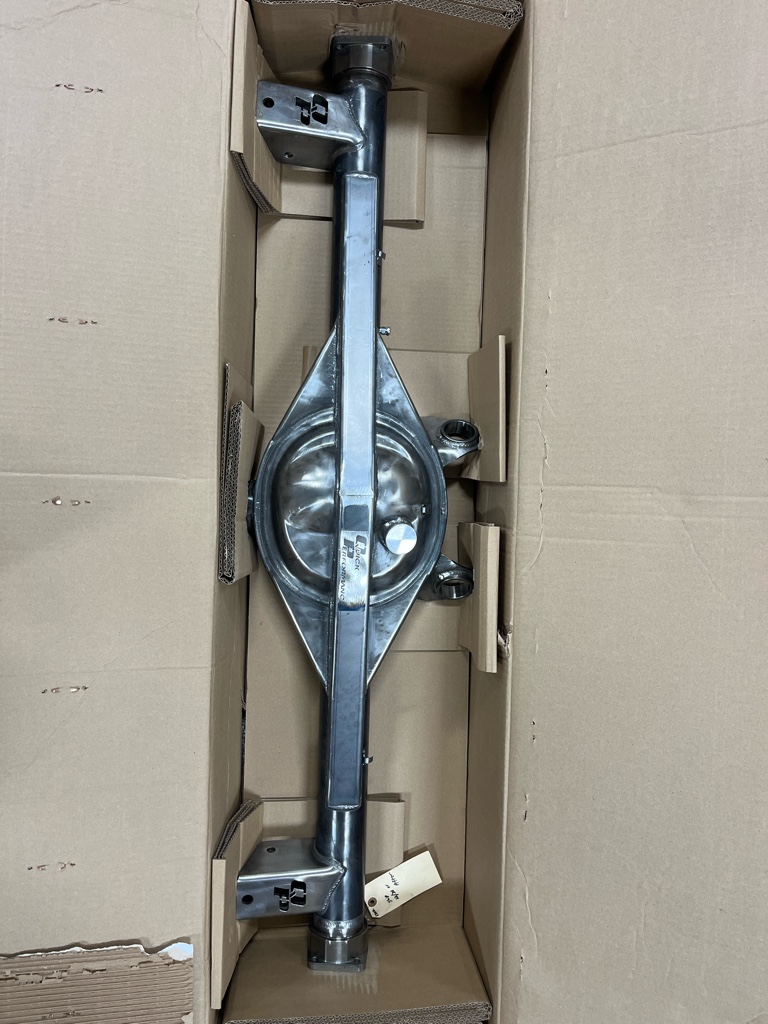

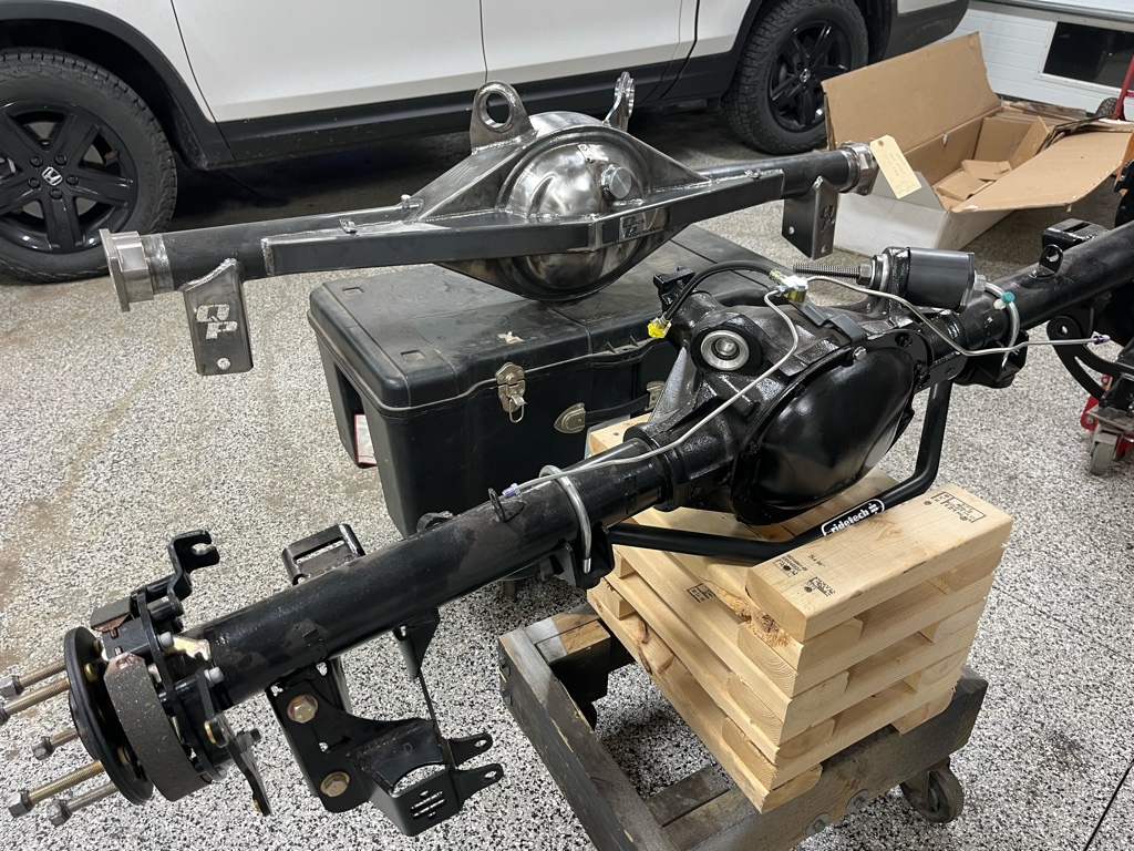

      Well….didn’t think this through. 66 GTO going from a 10 bolt to beefed up 9” with back brace.
      ridetech muscle bar won’t fit….easily.
      Any ideas??
      I figure I can cut the bracket that bolts to tube so it’ll fit. I’ll then weld it up to tube instead of bolting it down.
      The problem is I won’t be able to bolt sway bar bracket to tube bracket.

      You can eliminate the U strap and weld a nut to the top side of the ridetech bracket and bolt in from the bottom up or drop a bolt down and tack the head in place so it acts as the U strap.
      Also there is a guy in the Pro Touring Chevelle FB group that makes brackets for the coilovers on these rear ends
