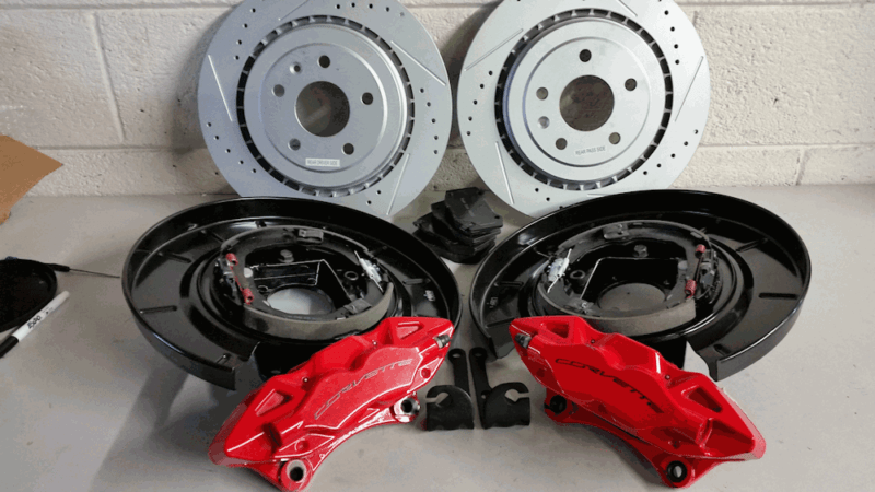

      Since you mentioned the C7 Corvette front brakes, here's a pic of their rear brakes that shows the little drum brake that fits inside the rotor.

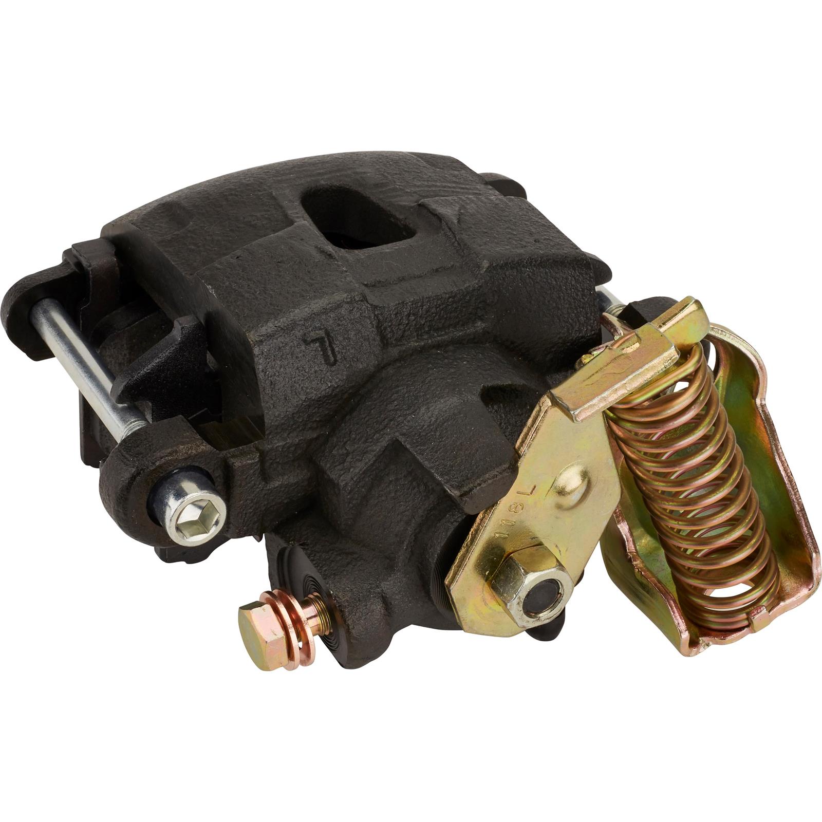

      This one is the mid 80s Caddy El Dorado rear caliper. The spring assembly is the lever for the emergency brake. This one will use your Buick's existing emergency brake cabling, although you may have to fiddle with cable lengths, or use an 85 El Dorado rear cable assembly for the wheel side of the cable. Underneath there is a single cable from the pedal that hits a bracket that lets the one cable pull both cables for the wheel side.

      The little drum brake inside the rotor is what I mean by drum-in-hat which is what the Q45 already has, this would just be turning the solid (i.e. the disc is solid without the ventilated webbing between the friction surfaces) rotor into an adapter to work like ones of these:

      I really don't like those Eldorado style calipers, I could do the math to see if they are a good balance fit for some of the front brakes I'm considering but I'd rather go with a set of VAG Brembo's for 4 piston fixed rears as I'm also considering the fronts since the complete upright will be fabricated I can make a mount for anything.
