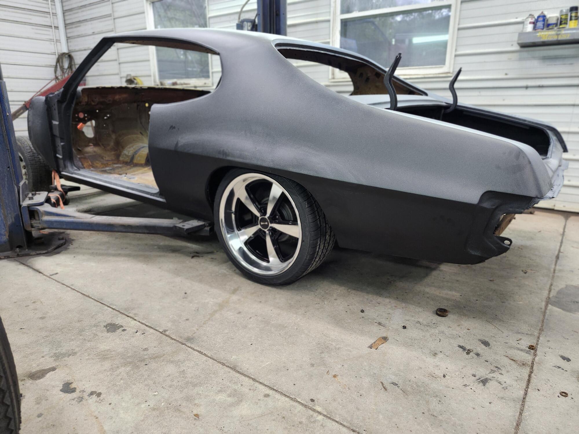

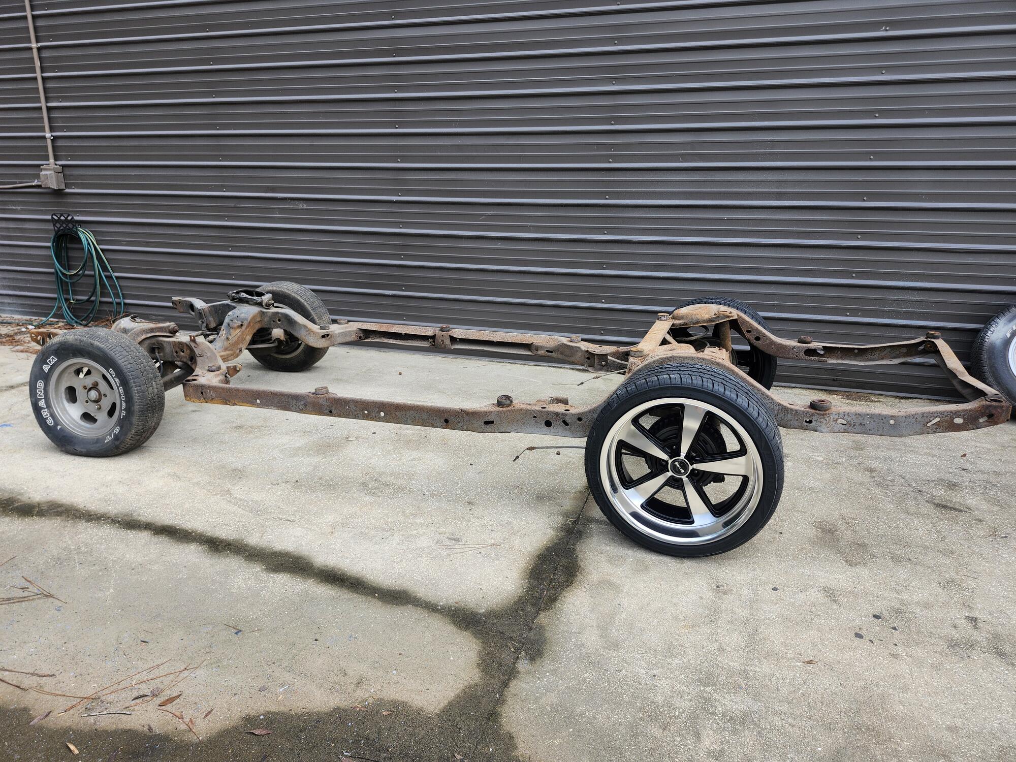

      I put the tire on the rear end today. This is just a rear i had to make it roll. It's a 10 bolt out of a 65 so it's one inch narrower that what the car would have came with. It does "fit" though. I have the tire on the wheel simulator set to my correct 5.5" backspace.

      What size is that?

      That's the 305/35r20

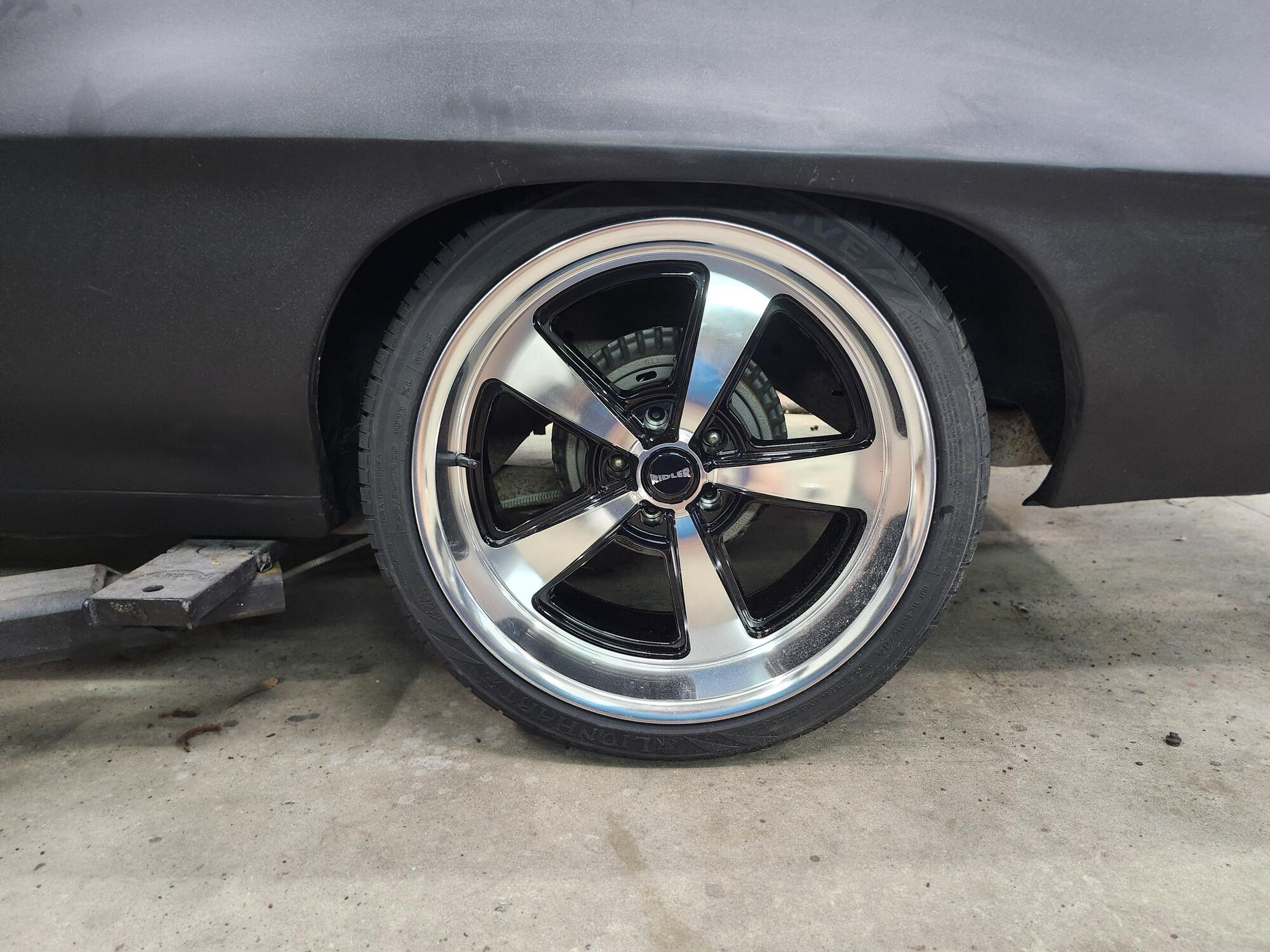

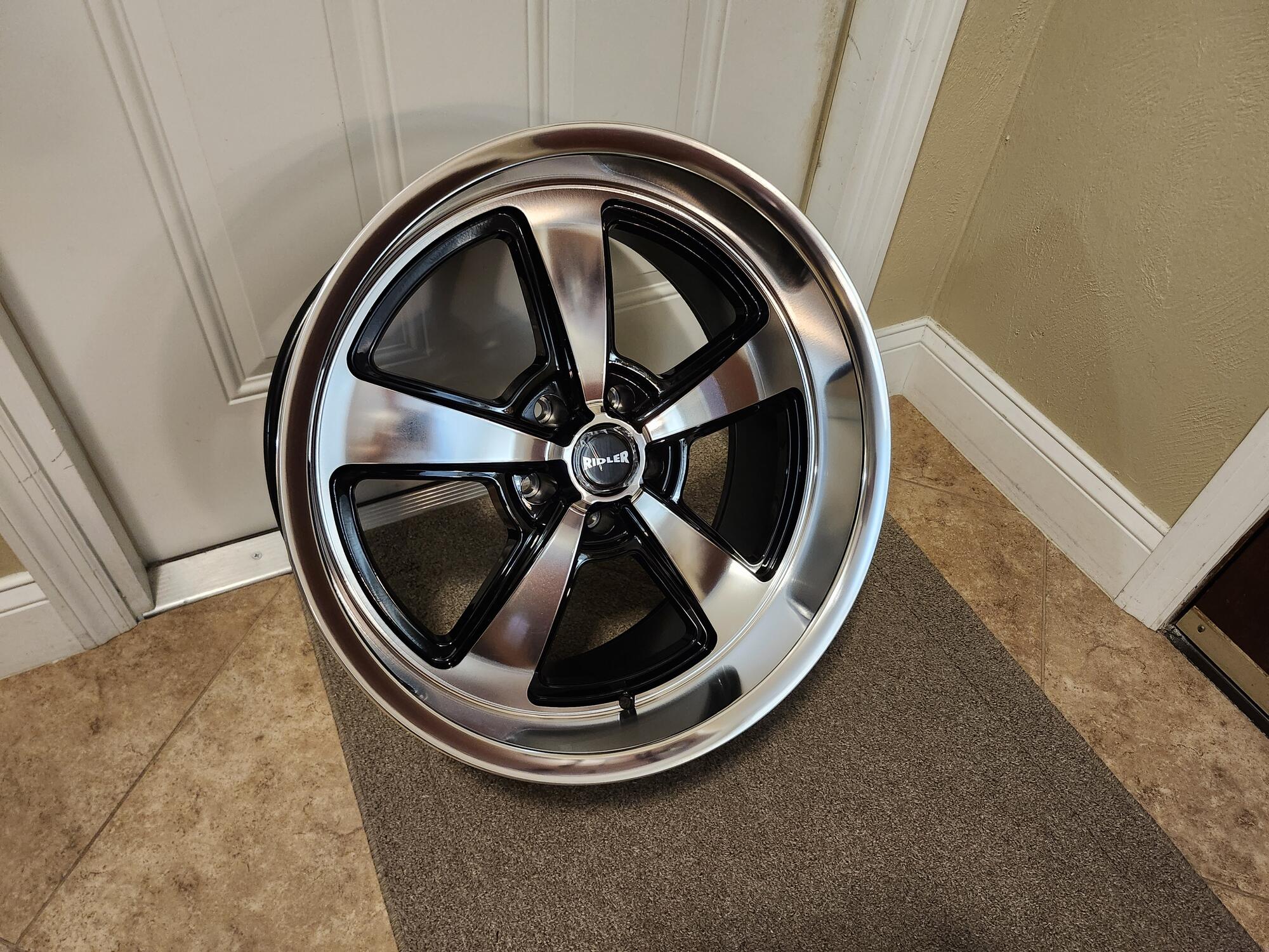

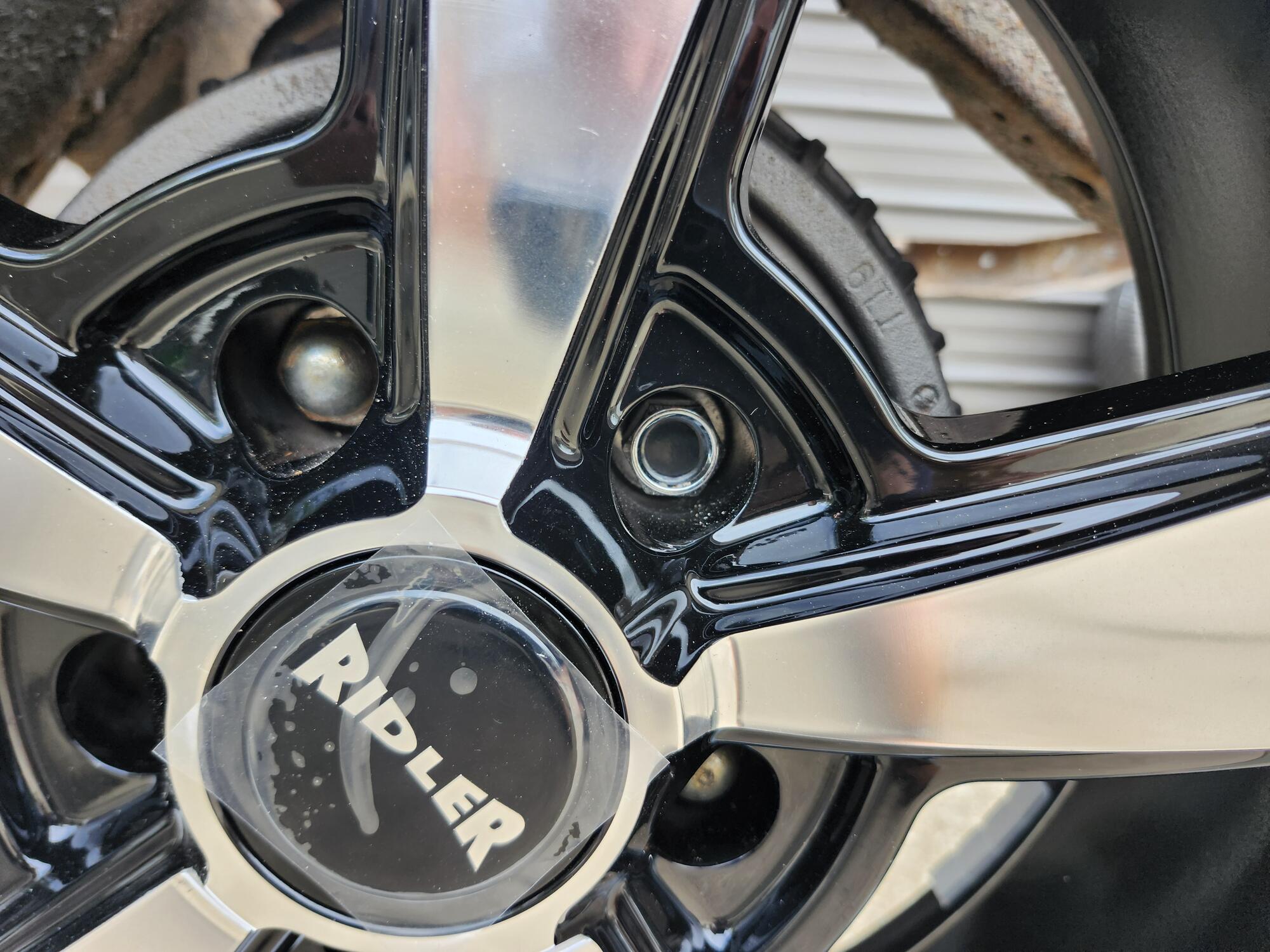

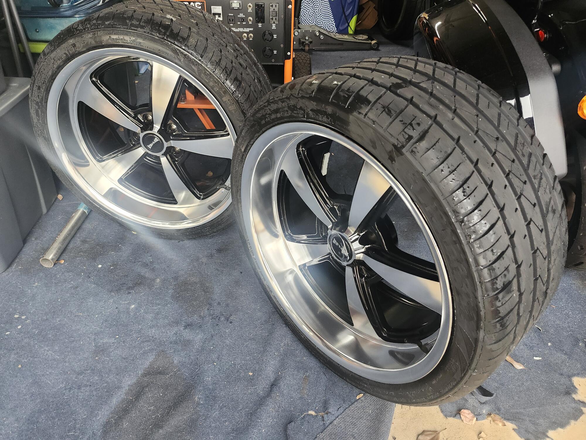

      Got the rear wheels today. Look ok for $289. Fronts will be here Wednesday.

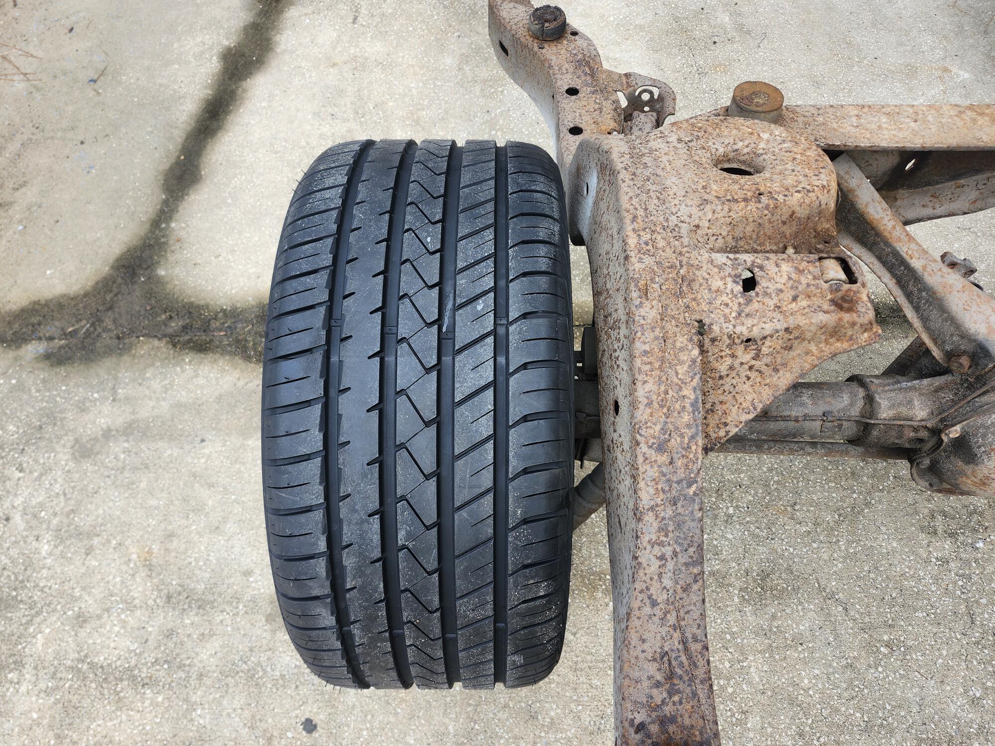

      Also got the new tires. Got 295/30r20 for the rear and 255/40r18 for the front. The 295's are kind of disappointing compared to the 305 I was hoping to use.
    8. #28
      168
      Had the tires mounted today. I was kind of pissed because they chaeged me $88 to put 2 new tires on 2 new rims. Then it started to rain as soon as i put them in the truck. Oh well. This weekend I will put the body back on the frame and do a test fit. I know these will fit in the car, but I can measure for the rear end now.

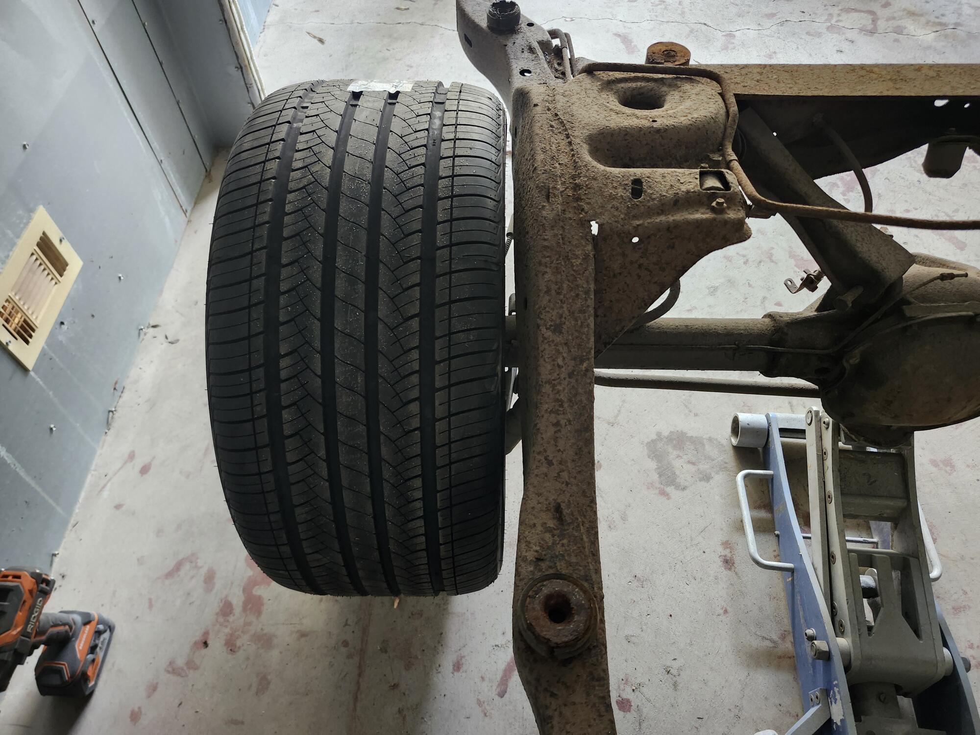

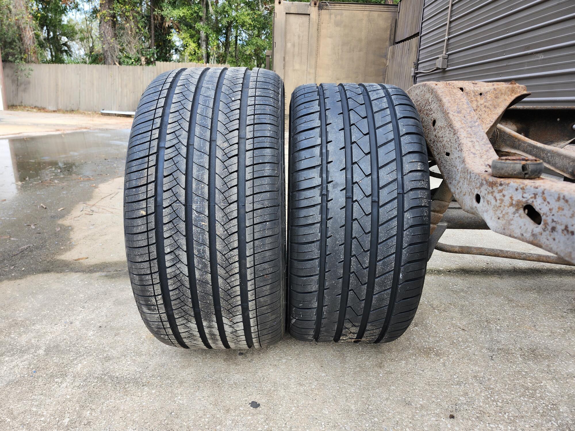

      Looks like there is plenty of room for a 305 in there if I decide to go a little bigger in the future. I bought the wrong lug nuts, so I had to put some old ones I had laying around on it. I tried a 70 GTO style lug nut on it, but it's so deep in there you really can't see it. Also rolled the 305/35r20 to put next to the 295/30r20 that is on it, for a comparison. I'm a bit surprised how much taller the 35 is than the 30.

    10. #30
      16,125
      The shorter tire will work better.

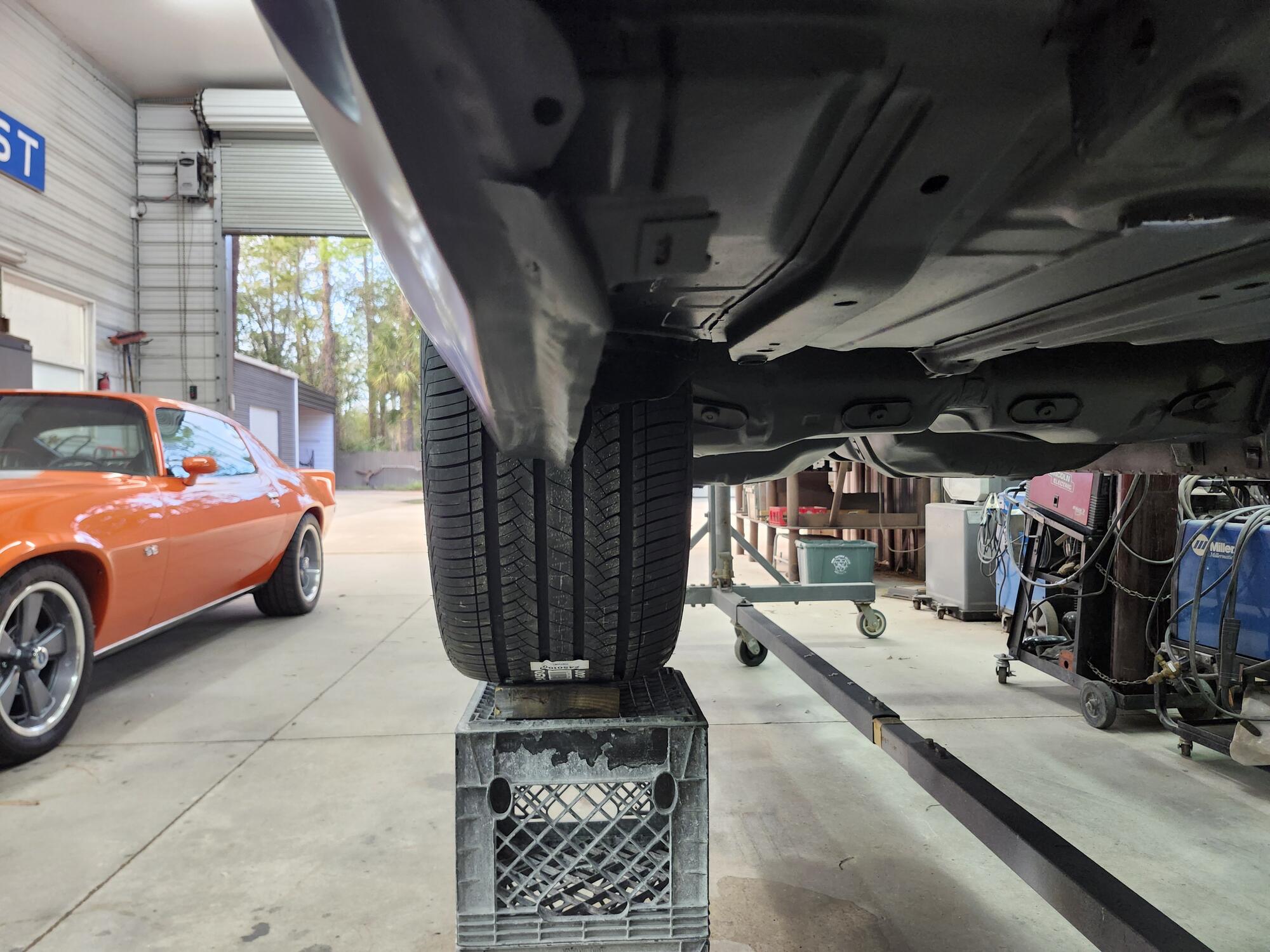

      Grrrr! I could have easily fit those 305's in there. Maybe even a 315. Oh well. Maybe once these are burned off.Name:  20241110_165716.jpg

    12. #32
      16,125
      I told you I use 305/35-18s on my 70 GTO and there is plenty of room if the wheel offset is precise.

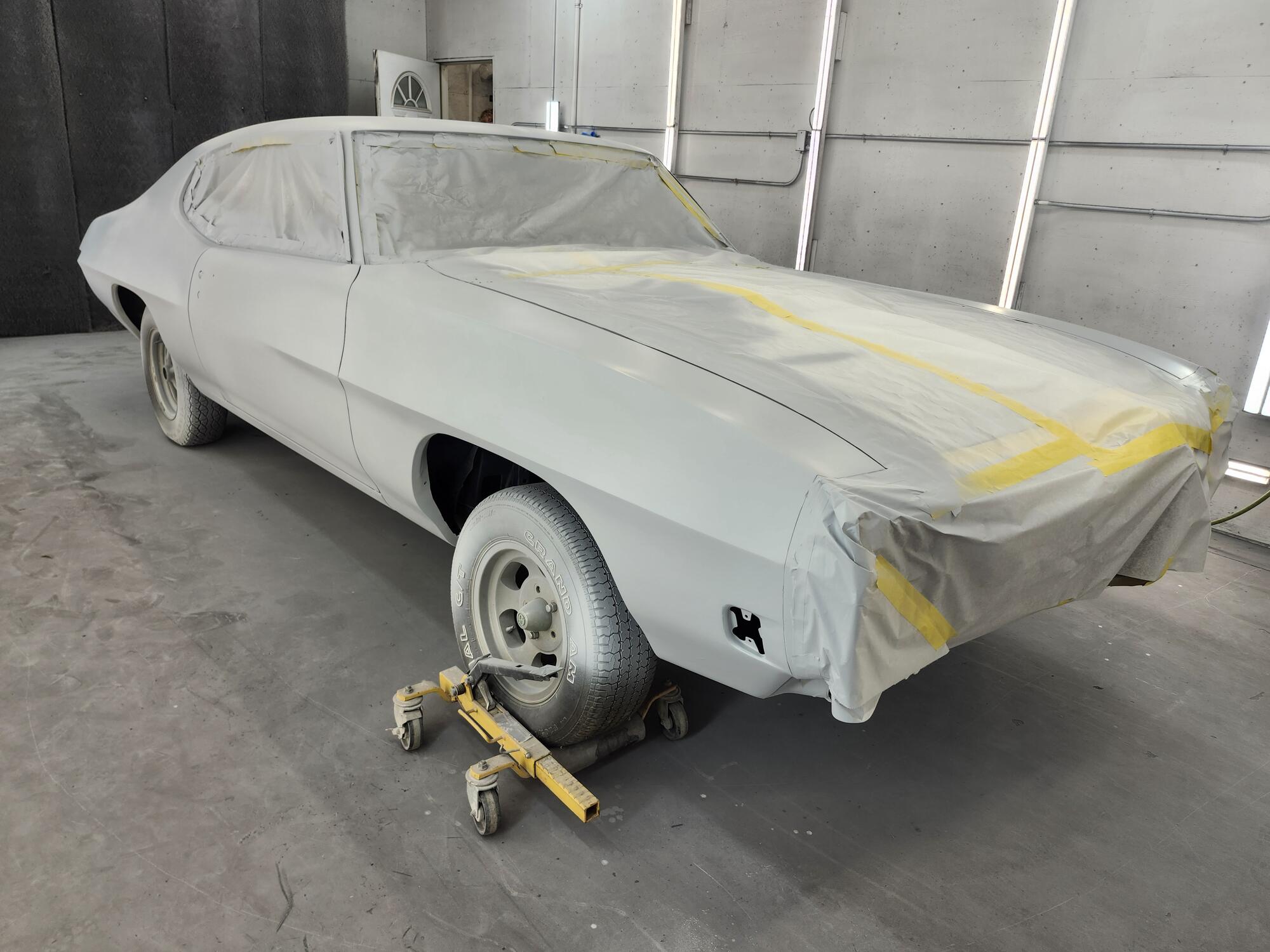

      168
      Still grindin. Got all but the hood and nose in final primer.

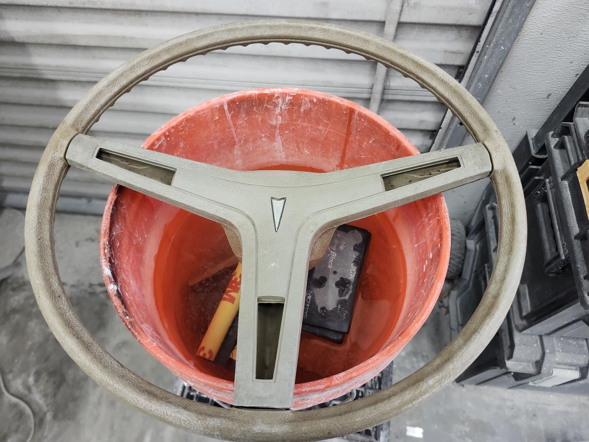

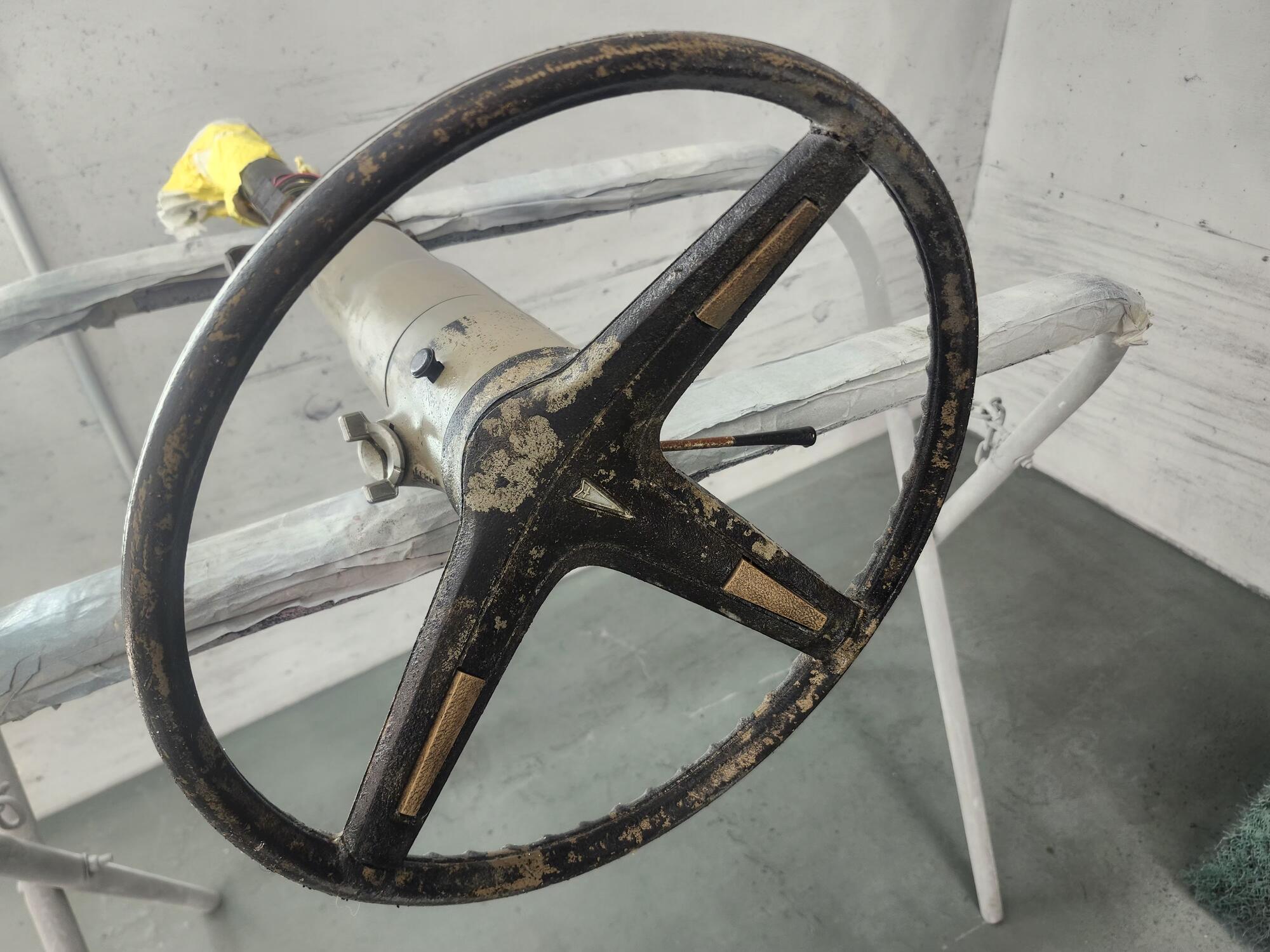

      Trying to keep moving forward during the 3 weeks of winter we have. This wheel has been staring at me for a while. Probably the most disgusting one if ever seen (or felt!). Soaked it in Dawn overnight. It's not great yet but it helped a little.Name:  1000001895.jpg
