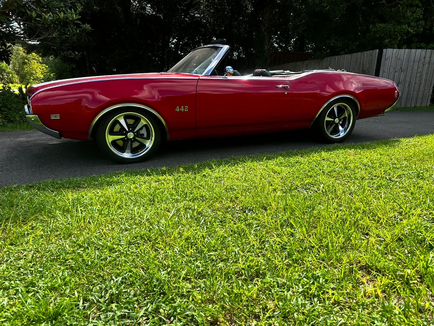

      Another vote for Kore3, Tobin is awesome to deal with. I just put front/rears on my cutlass. Make sure you plan your wheel setup though. Not all 17/18s wheels fit (spoke/caliper clearance).

      Thanks guys. I haven't made a decision on wheels yet. I would really like 20's and 19's, but I'm trying not to spend much there. I am trying to find a reasonably priced 20 for the rear with a nice deep dish that isnt too expensive. Not easy. I also have to restore the entire car so this will be a lot all at once. Well....kind of at once. Of course I can't restore it and do all this work in a short time.

      Actually I love your wheels and they are exactly what I want, but I want them in a 19 & 20 one piece with a deep dish. That's not asking too much is it?!?

      I don’t think you will get much deeper than that without narrowing the rear end and ordering custom wheels which will be expensive.

      That looks great!

      I used these 18’s, look like the same wheel.
