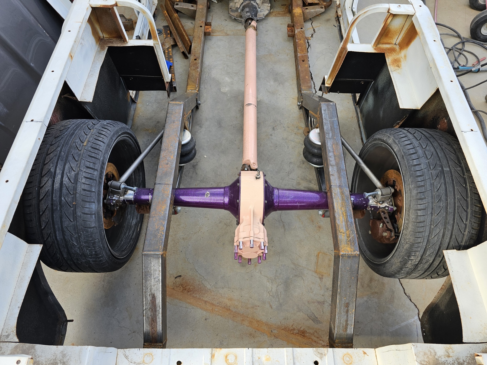

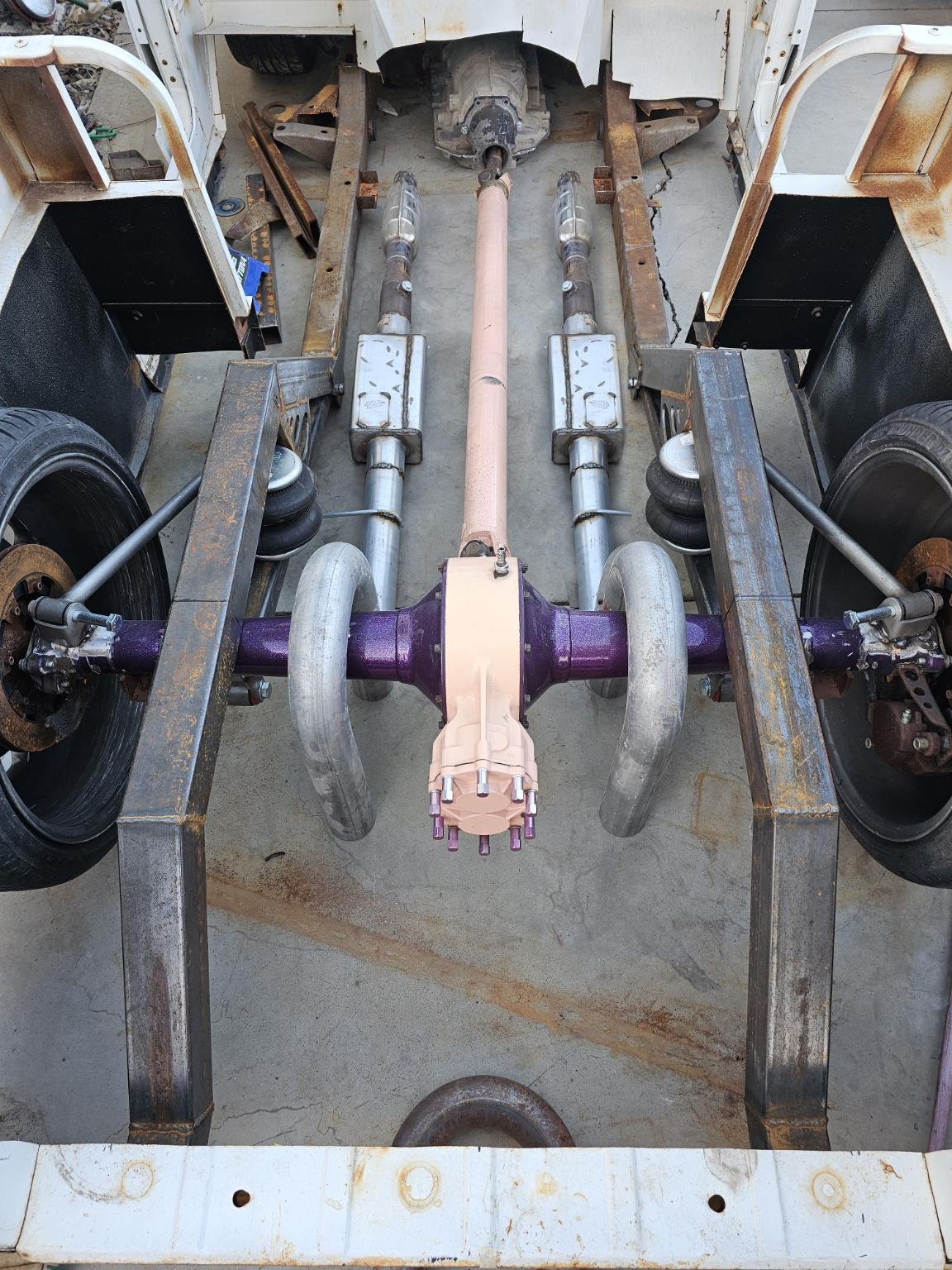

      Was able to get a few hours on the rear suspension.
      Got the 4-link all tacked in place.
      I lifted it 8 inches and had 2 degrees of movement on the pinion, which is more than fine, as ride height will be about 3 inches off the ground.
      Started looking at cross bracing, fuel cell and the other final components that need to go back there -such as air tanks and compressors.
      Need to make the mid and front body/core support mounts and then remove the body for final fit and welding.
      I think the last thing I'm going to tackle before the show is the gauges in the dash and steering.
      I'm not stressed, but I'm trying to get it to the show as a motivator. If people, see it now it'll get me going to push harder.
      I have already 'failed' as it's not running and driving, but that is how life goes.
      I ran the upper bars on the outside of the frame rails to not have them visible once the inner sheet metal work is done. I wanted to keep a non-cluttered section visible. I think I'm going to run the spintech mufflers as well, as I like their square small boxy appearance, and they have such a unique sound to them.

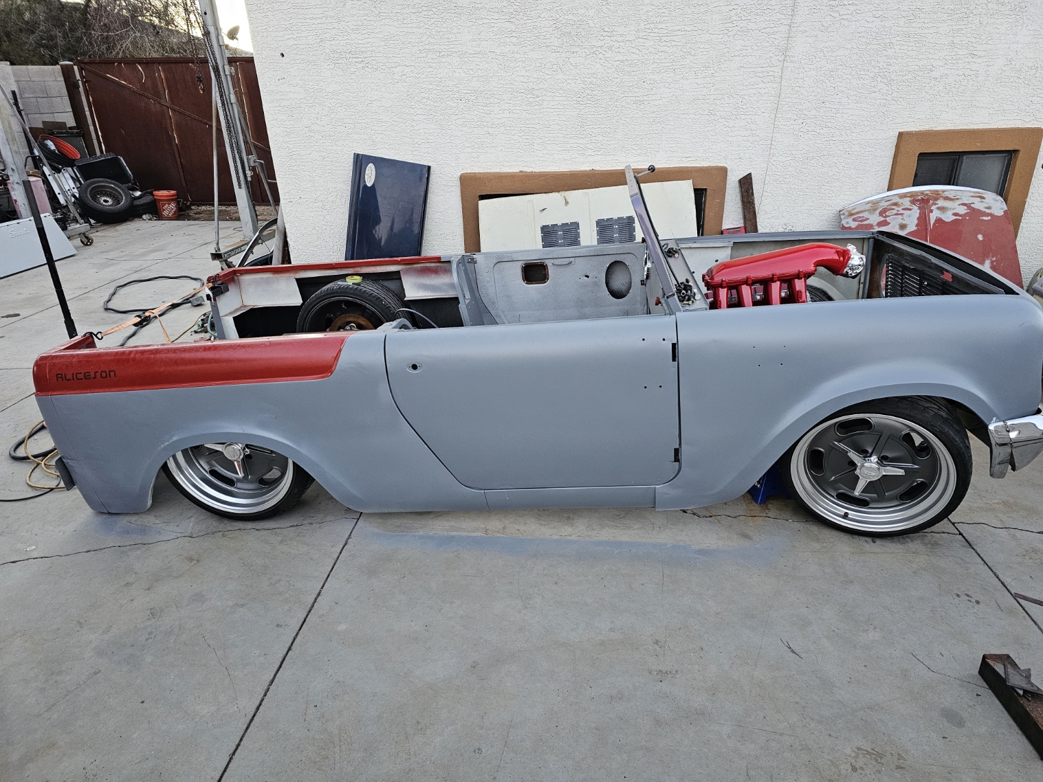

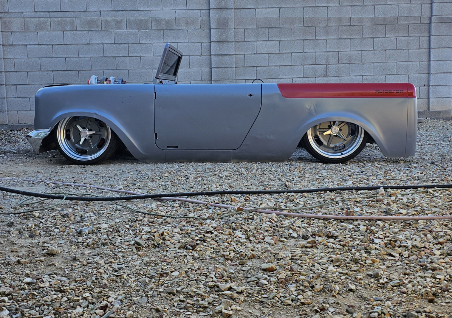

      Got the front bumper somewhat mounted. I got a few real good ideas on how I will be permanently attaching it after the show. But for now it won’t fall off and I can get some good eyes on to see where I need to adjust it. Not trying to be perfect, but, wanting to make it look like it is supposed to be there.
      I think this is the 1st Scout with a car type bumper, and I want people who see it to not know that. Unless you’re a scout fan, you probably wouldn’t know anyways.
      Started workin on the steering column mounts. The lower is done, just need to fab up a column drop for the upper.
      Also started the dash panel. I’m going to not use the stock scout panel and just start fresh with a piece of sheet metal as it will save time of me trying to weld up all those spots for no real reason. Also, I might mount the gauges in the middle of the dash.
      I had an old GM truck billet grill laying around so I butchered it to fit, not sure how I feel about it yet, but, we will see.
      I think I'm not posting any more pictures until after the show. Sort of want a bit of a surprise for y'all..

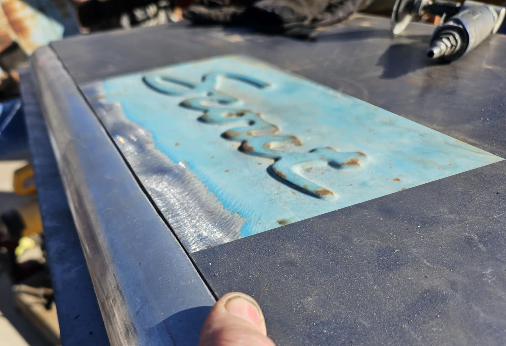

      Started fabbin up the new tailgate.
      I'm waiting on the hinges to arrive, but, it will swing open to the side, not down like a normal gate would.

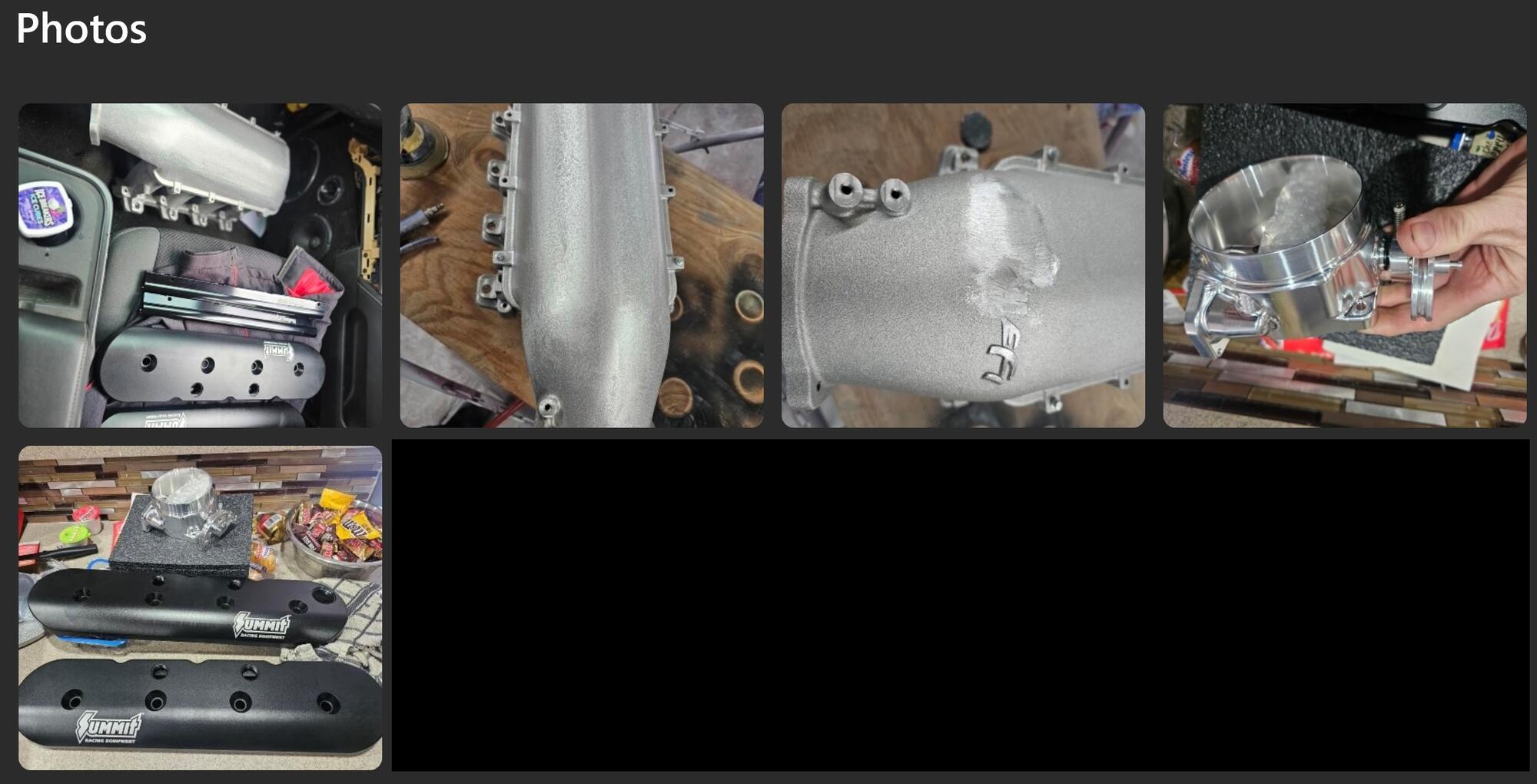

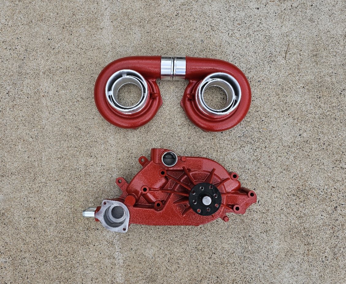

      today mr UPS man dropped off a few boxes.
      I promptly took the new holley intake and ground off the 'holley EFI' logo and ran a DA with 80 grit over the top surfaces to smooth out the rough casting and bead blasting they did.
      Then I put the parts in my truck and dropped them off for powder coating...
      -intake manifold
      -fuel rails
      -valve covers
      -front engine cover
      -valley plate / knock sensor cover
      -engine oil pan
      -4l80e transmission case
      -aluminum trans pan
      I also dropped my cell off for new glass as it has had some nasty cracks for awhile now.
      And since my phone is linked to my computer, i cant upload any full res pics, so youll have to enjoy this tiny one for now..

      ....and now they are all red

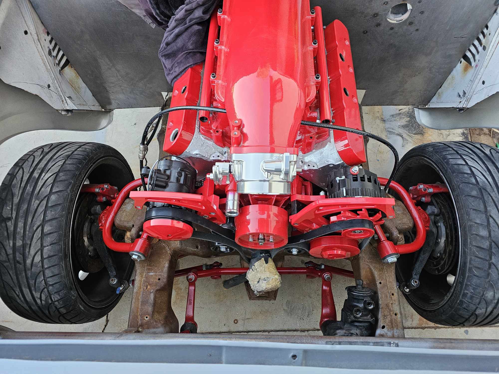

      Getting the parts bolted up and readied for transportation to the exhaust shop for the custom up and rear twin turbo manifolds to be built..

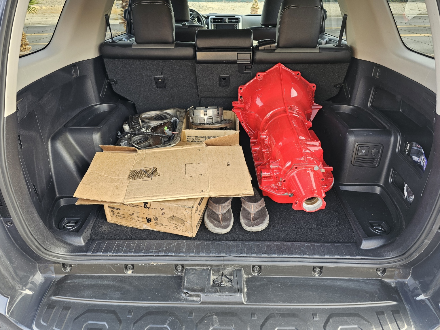

      Took the trans out to vegas to have a rebuild done on it for the power levels im planning on putting through it..

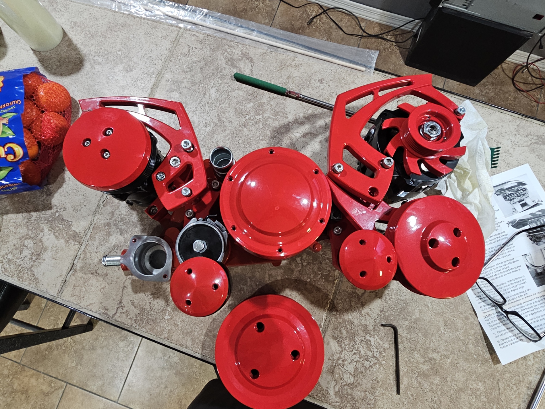

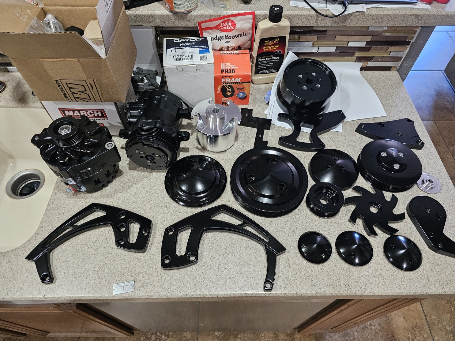

      The March accessory kit arrived...
      took all the parts out, inventoried, and dropped off to the powder coater to be stripped and coated red..
      The alternator, PS pump and AC compressor will all stay black.
      Only waiting on the turbos now.

      Trans is cleaned, parts have arrived, and it should be assembled in day or two...

      ....some more red for the ole gurl
