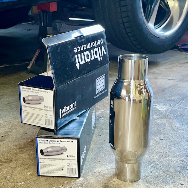

      I just went though this process. I installed a pair of 20" DynoMax, SuperTurbos and loved the smooth, throaty sound, but with headers and a lumpy cam, it was just too loud. My solution was a pair of 12" resonators from Vibrant grafted into the tailpipes. Retained the throatiness, just reduced the loudness.
