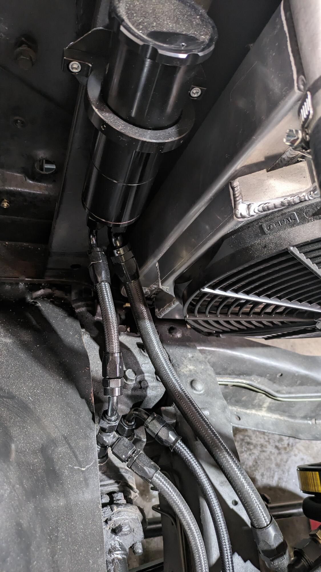

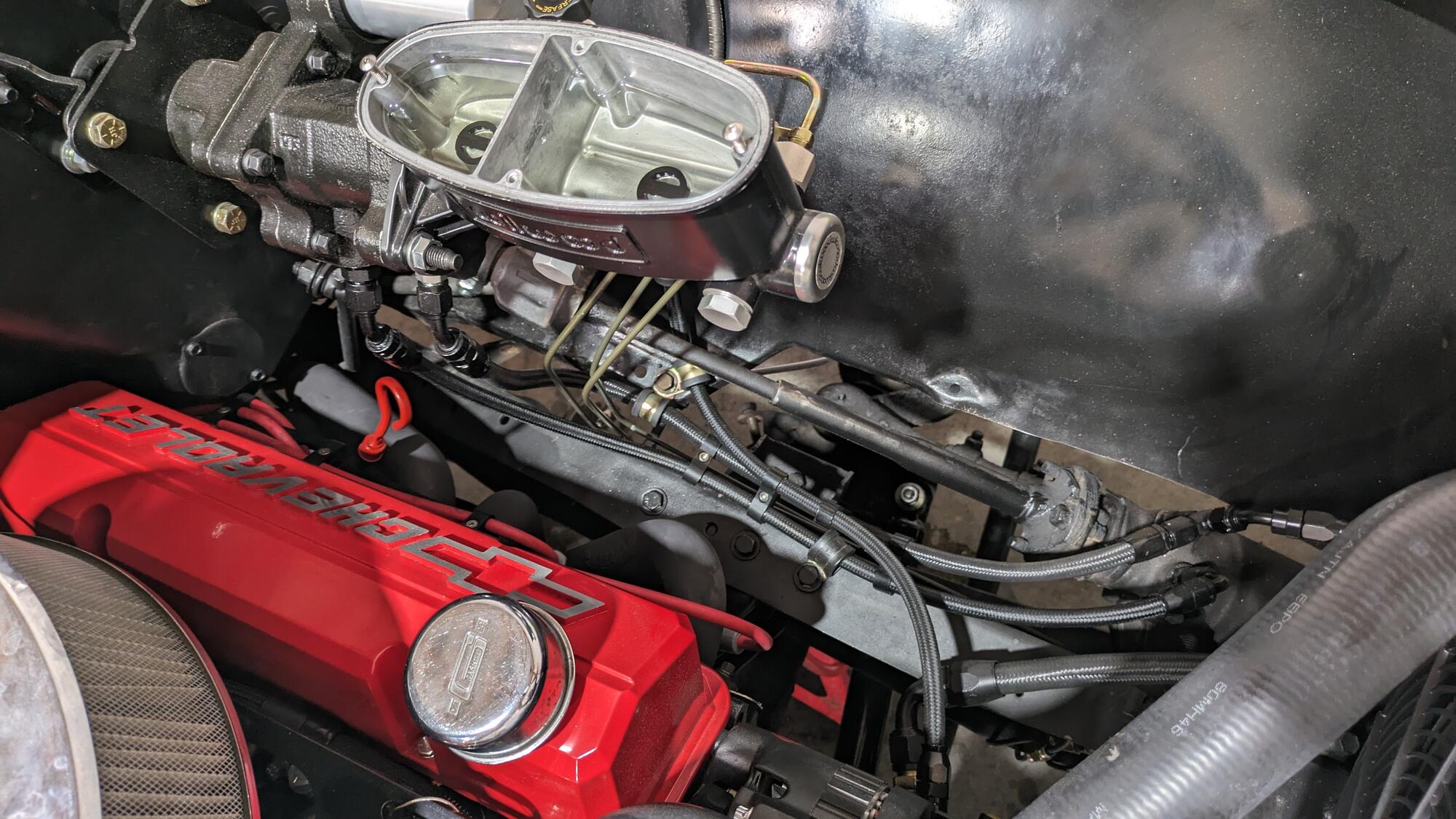

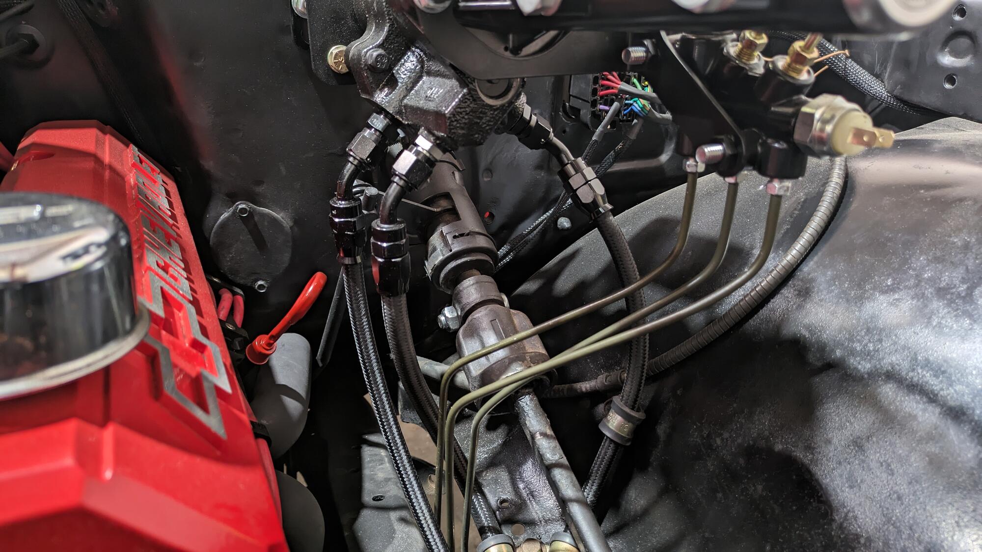

      Here are pictures of the lines and routing:
Size:  316.4 KBName:  PXL_20240515_210110450.MP.jpg
Size:  308.6 KBName:  PXL_20240515_210116829.MP.jpg
Size:  299.6 KBName:  PXL_20240515_210123276.jpg
Size:  235.4 KBName:  PXL_20240515_210126875.jpg

      Teeing the HB return into the box return like that is a no no. Even when you get the system working you will have issues with pedal knock back as the fluid will hit that 90 and build pressure. You need to run separate returns from HB and box to reservoir for a trouble free install. Or at LEAST Y the hoses together as close to the reservoir as possible to reduce any pressure from the box being fed back to the HB return. It's like you've plumbed your fuel return line into the pressure line.. there's no place for the HB to exhaust..
      Your lines are ran correctly and the HB system should work.
      Out of curiosity, do you have an AN6 block off that you can put on the tee and run the engine w/ the HB return loose to see if fluid is flowing? I know you said there's no fluid coming out but wondering if that was w/ engine off? Either way, you may have a bad HB as there should be fluid coming out of the pressure reservoir when pumping the pedal.. Also crack the return loose @ the HB and see if you have any fluid flowing there to eliminate the return hose as a restriction..
