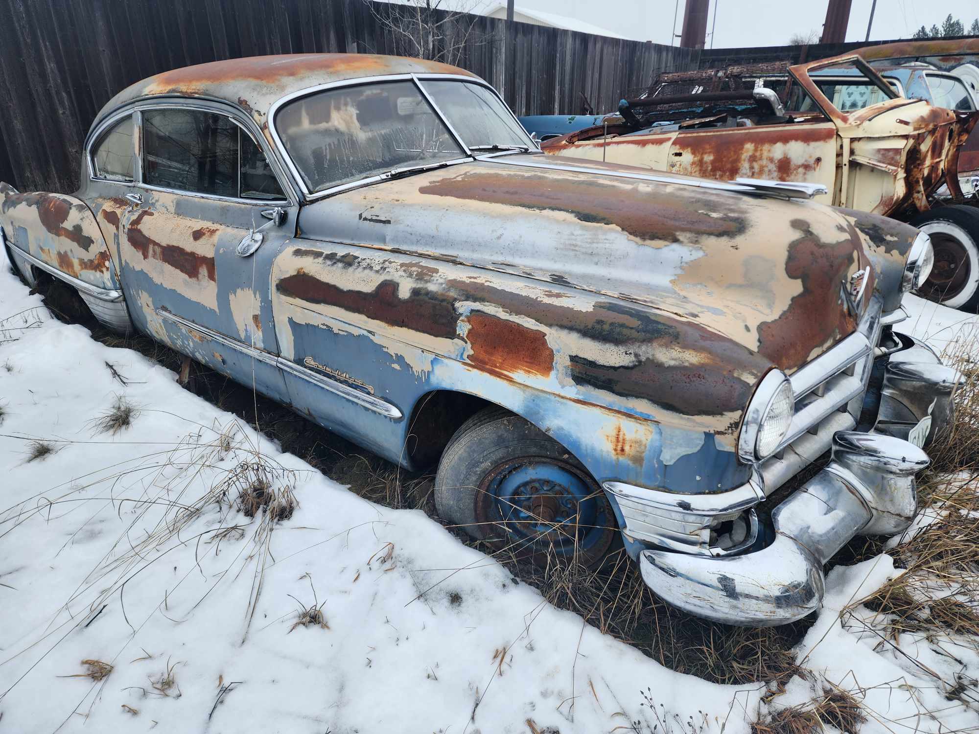

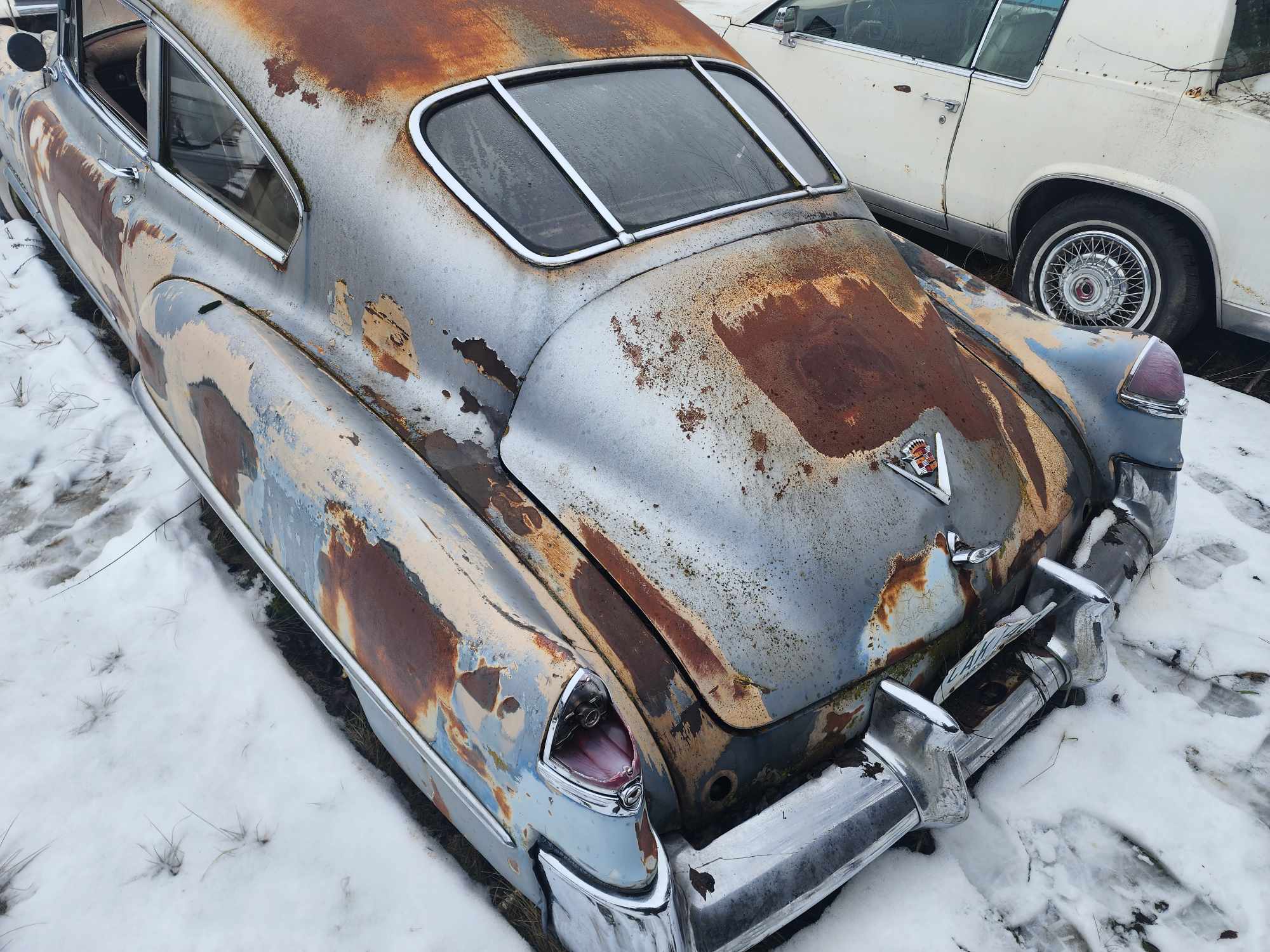

      Well I'm back. The car sickness has me again after a few years away. I found a 1949 Cadillac Series 61 for sale and picked it up for a reasonable price. Some people call this a Sedanette, but really that's for the previous body style. Either-way, it's the 2 door. It's still in shipping and should be here tomorrow but I thought I'd ask the questions now so I can research more on this rainy afternoon.

      Pics tomorrow / Friday once it's here and I start tearing into this. May start a youtube channel too idk.

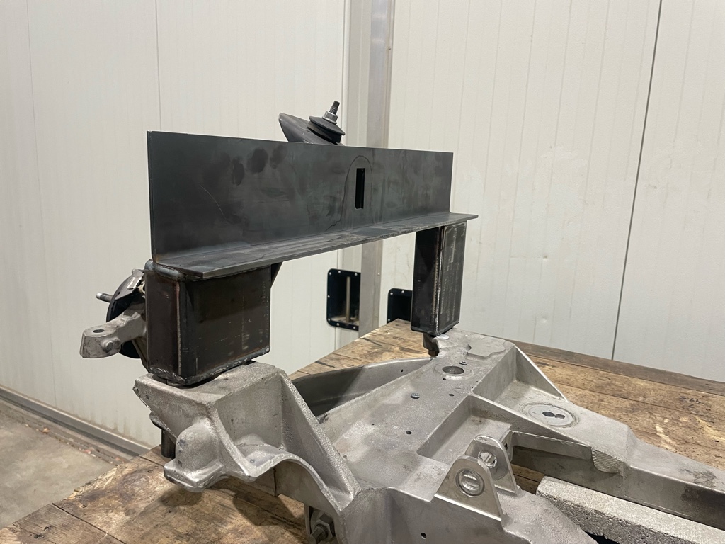

      I make and sell adaptors to incorporate the full c5 front subframe and suspension. That might be an idea for you

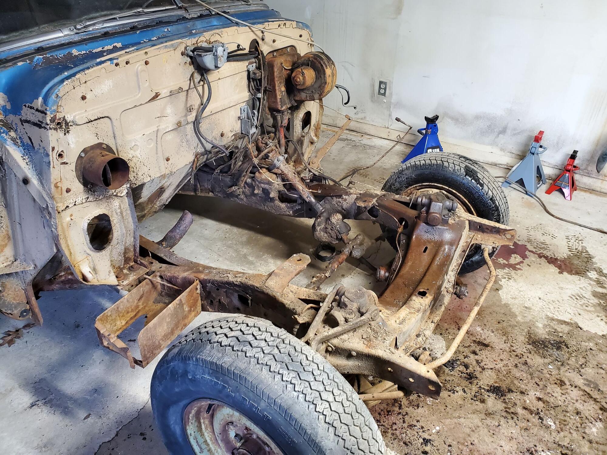

      Hi Joris! I may go this route so I'll keep you in mind for sure. Current opinion of my frame by me - a non expert - is that it's too weak to do any sort of spirited driving in. But we will see. Stick around and find the holes in my plan though, I always can use a second opinion from others that have done something like this before.

      Those would be to use with a new frame of 2x4 tubing. Not to tie into an existing frame.

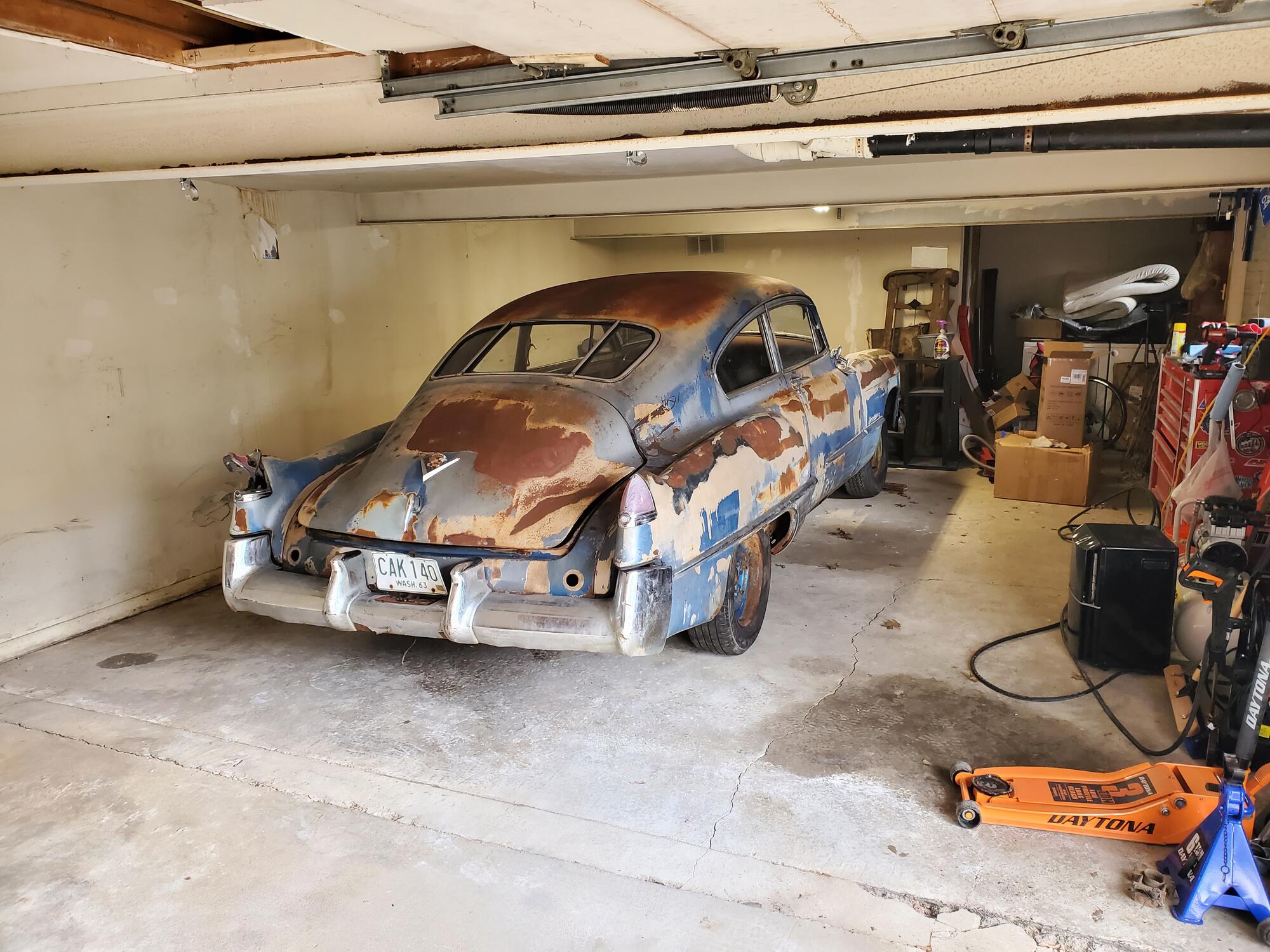

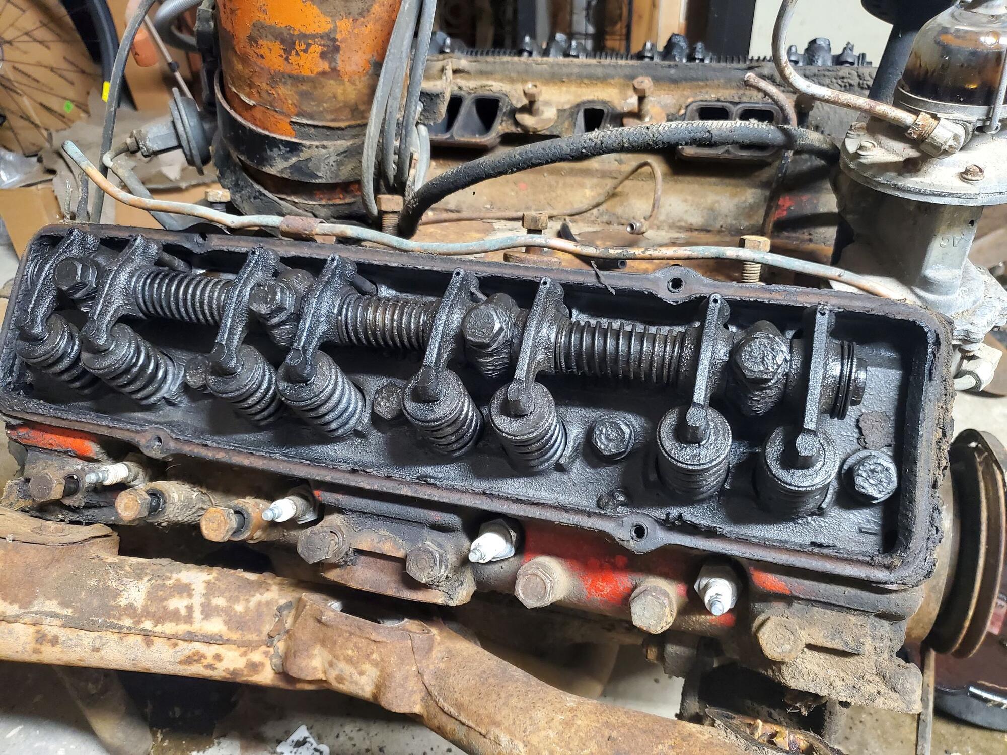

      Just a small update. I stripped out the interior and power washed the car. I think 5 lbs of dirt / mud came out of it.. I wish I thought of doing the frame as well because it has a ton of dirt on it .. but oh well.. it'll get dusty. I then pushed this tank into the garage and took the front end off to gain clear access to remove the engine. Hoping to remove the engine and transmission today and do the assessment on the engine. Check out this suspension. The upper control arm is also the shock. One thing that's good that I've noticed so far is that the engine is further back than I thought, and the front suspension is in front of the engine. I can also move it 2 more inches back before the firewall needs modification.
      - Alex

      Thanks for the post!
      I may attempt fuel injection but I know the way the heads sit with intake manifold opening I'll have to lay those injectors nearly horizontal to get them aimed at the valve. I may give this more thought when I build the custom intake manifold if this 331 is good to use.

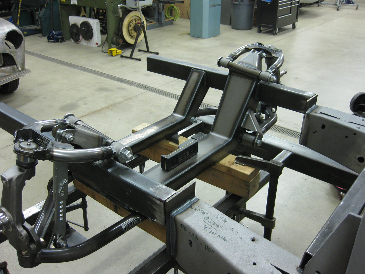

      If the track width works, and I think it will. I would use Corvette stuff for sure. Cut the frame off near the firewall and build from there. This was a Heidts clip on a Buick but everything is quite similar to your Caddy.

      Pick wheel and tire diameter.
      Pick ride height.
      Set frame at that height and cut off anything that is in the way of new suspension.
      Install new suspension.
      Everything in between there is simple math based on spindle centerline. 5" is a good number, the Buick isn't that low because it didn't need to be. We wanted the wheels wells full and for it to look pretty stock.
      Before cutting the front of the frame off, I made fixtures to locate the core support and bumper mounts. That is why I included the pic of the whole chassis on the table. After the new clip is on you can either weld those pieces back on or fabricate from scratch like was done here.
      Sidebar. This is an enormous amount of planning and work, especially if you have never done it before, and doubly so if you are equipment, space, and ability limited. While I am capable and have everything needed to pull this off at a relatively high level I would absolutely do this first.
      https://roadstershop.com/chassis-and...8-53-cadillac/
      I also understand that everyone has different priorities for builds. For some the build is the fun, I would rather drive.
