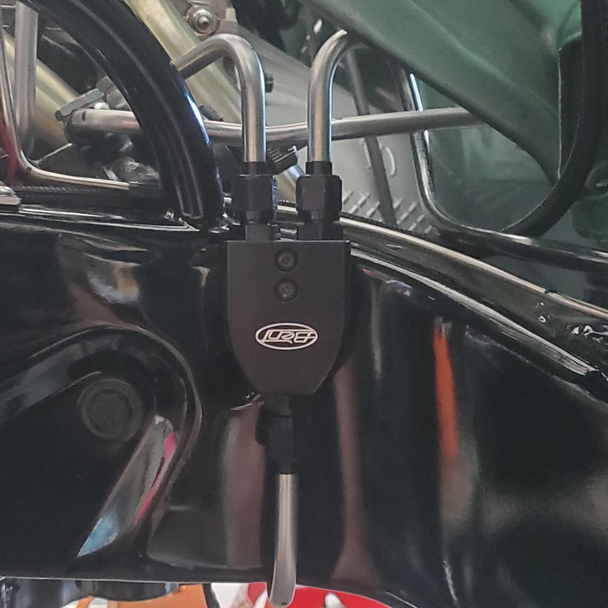

      has anyone hard lined a hydroboost to to the steering box? or aleast to a tee?

      found some one that has done it. will see how it goes.

      Here it is plumbed, need some more fittings to finish the return. still a way out from running it but will give feedback when it is drivable.

      Looks really clean. Curious to hear how it performs

      IF you're going to put miles on this car, you might be regretting the hardline. Steering box is mounted to the frame, hydroboost mounted to the body.. The body is on bushings that will flex, the stainless hardline will not.

      Yup it looks great but you should definitely think about adding some flexible line in there. Even with solid body mounts there will be some flex between the body and the frame.

      Shouldn’t hardline something that should and will flex
