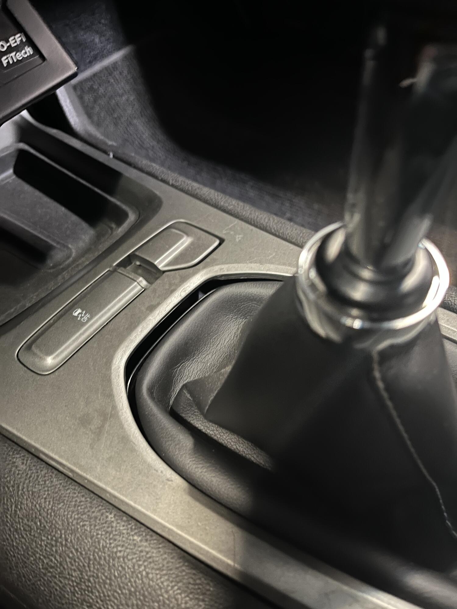

      They are different. I put a manual shifter boot on an automatic bezel and it fits but there’s about a 1/8” gap towards the dash end. You can dreamel the tabs that mount the shifter boot ring to the console though to make it work.
      Dec 2011
      Oregon coast
      255
      Here’s the gap Name:  IMG_5506.jpg

      I think I got the 2010-15 Camaro shifter boot from eBay or Amazon and then the ring is from Lokar. The lokar ring and the plastic bit at the top of the camaro boot snap together pretty nicely with a bit of massaging.
