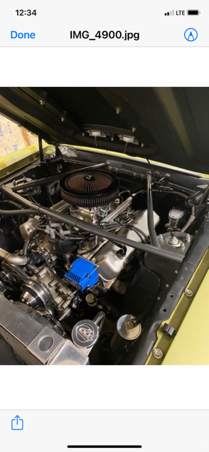

      Thanks. I have a BE COOL rad and it has the cap on the side. When I pull the cap off it has a little metal landing and then the water flows in the rad from the side. So it's stupid but I can't see the water in the rad. Ill try and peek in from the side tonight when I get home but I don't think I can see it. Below is a pic for reference. I doubt the hoses are collapsing but I will check that as well. I will also try the cap, you might be right, it might be that simple. Thanks for the ideas.

      Nice engine bay. Update us when you tried a new thermostat.
