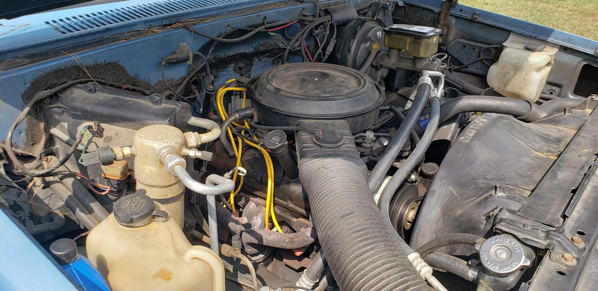

      Name:  OG motor.jpg

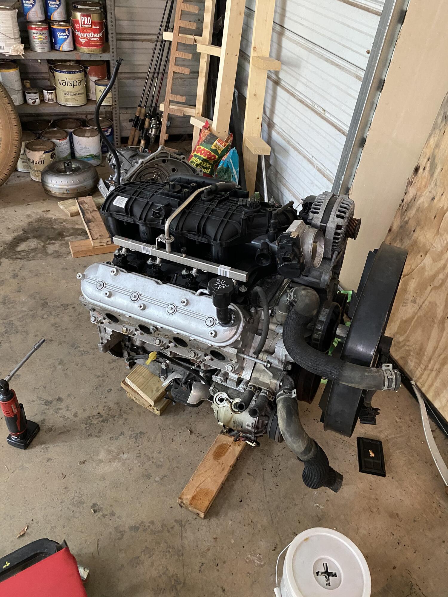

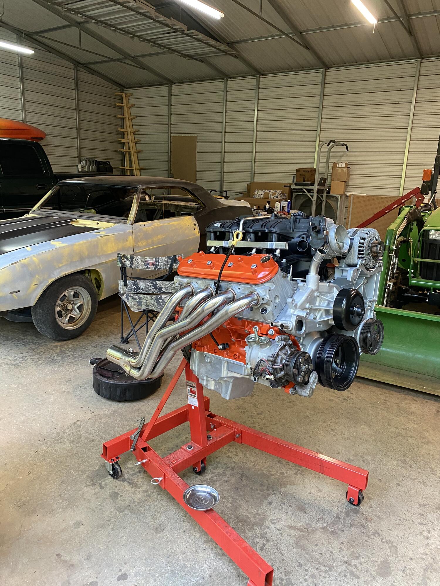

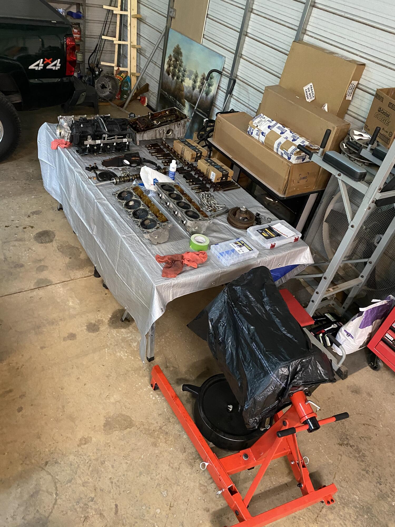

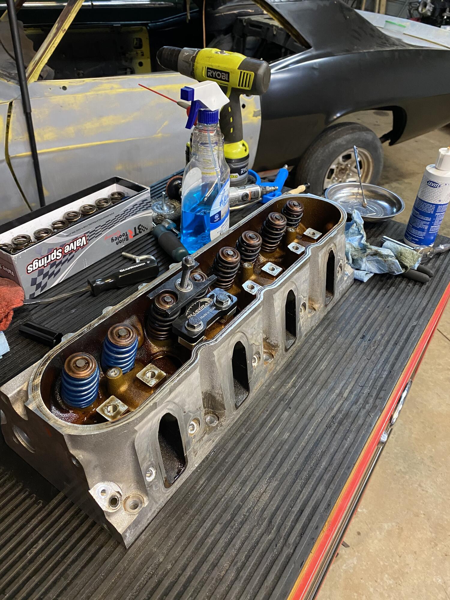

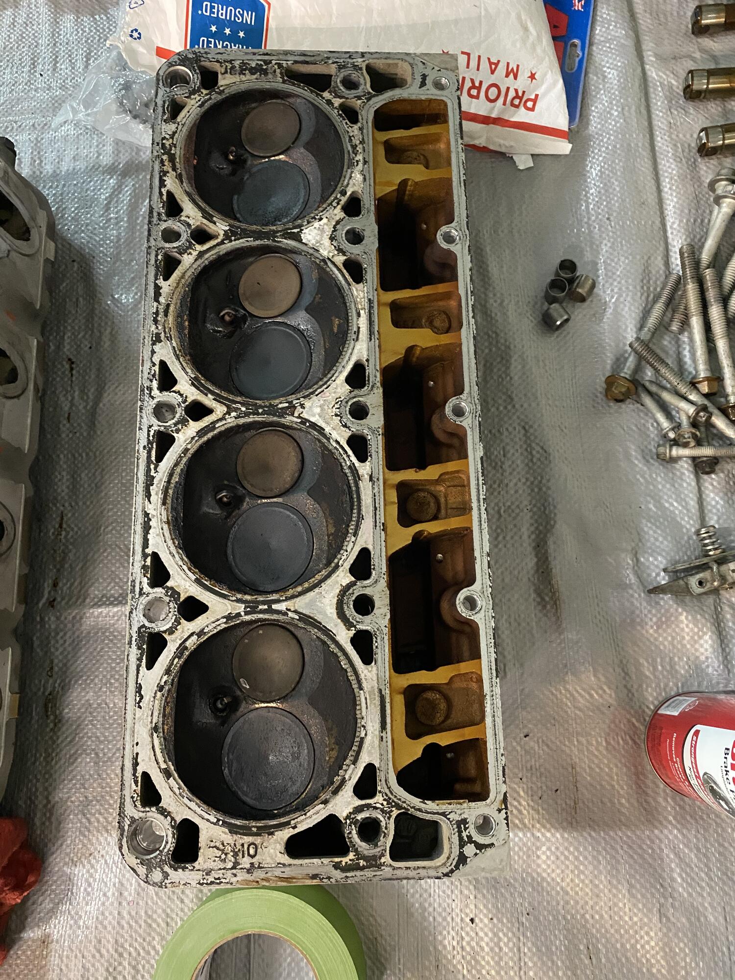

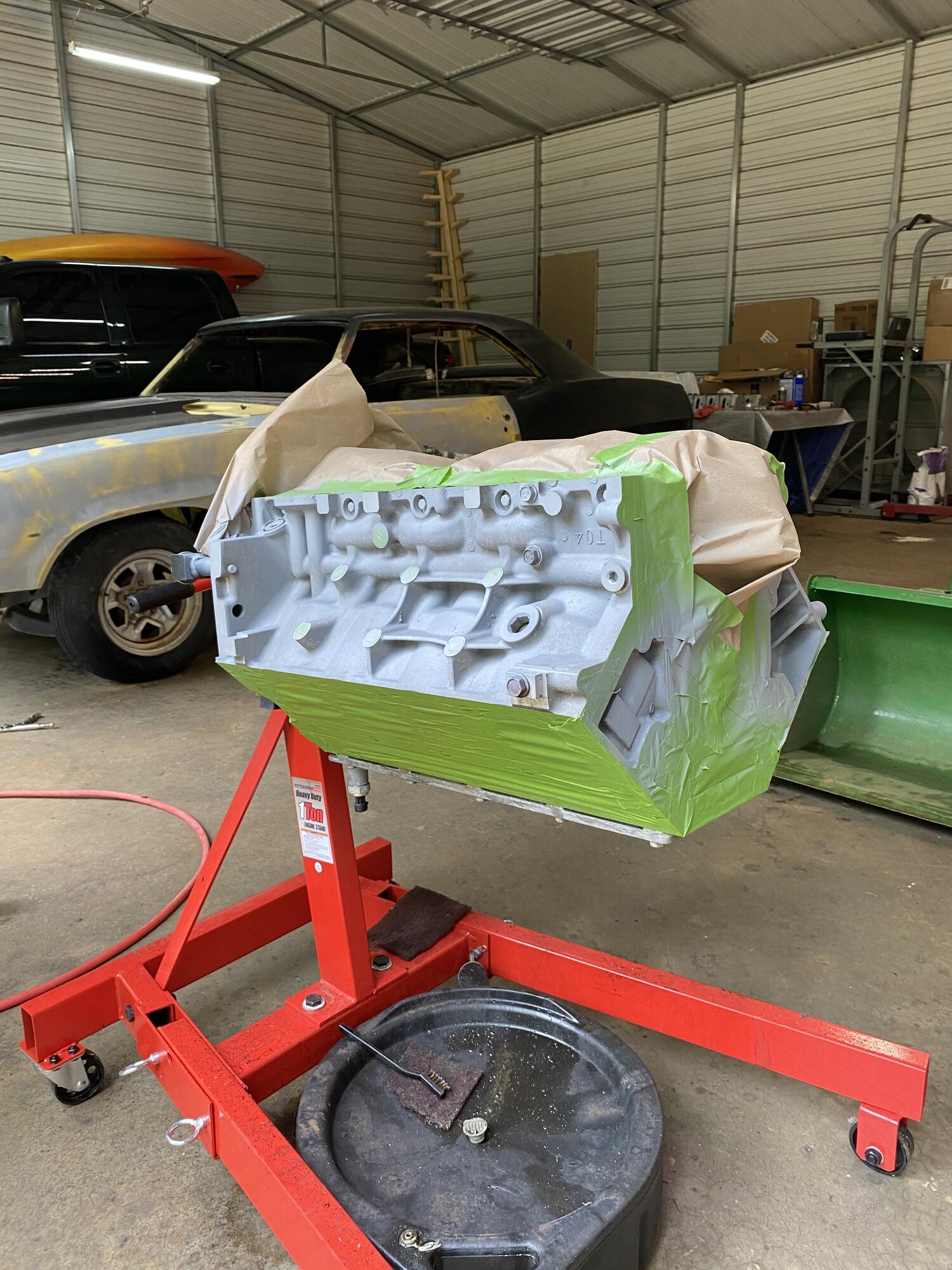

      Started looking around for a motor. I briefly considered a Coyote for poops and giggles but decided to go tried and true LS since that's what I have the most experience with from all my NBS trucks. A friend of ours owns a salvage yard so I paid him a visit. In his personal stash he had this LH6 out of a rear ended Envoy Denali. Perfect!! All aluminum for lower weight, flat top pistons, 10:1 compression, 799 heads, TBSS style intake and larger TB. Paired with the 4L65E, computer and only had 104k, I grabbed it
      Name:  new motor.jpg

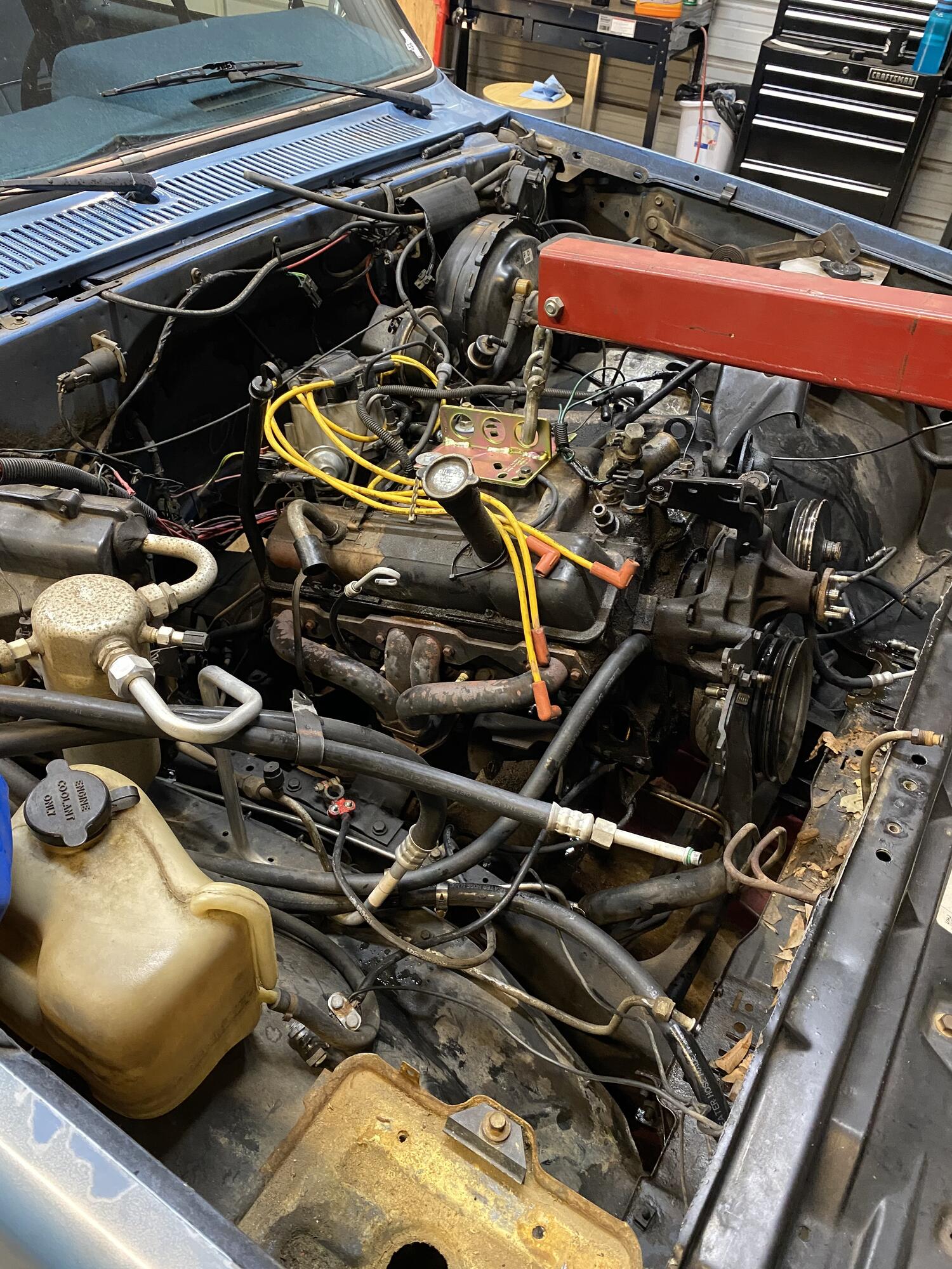

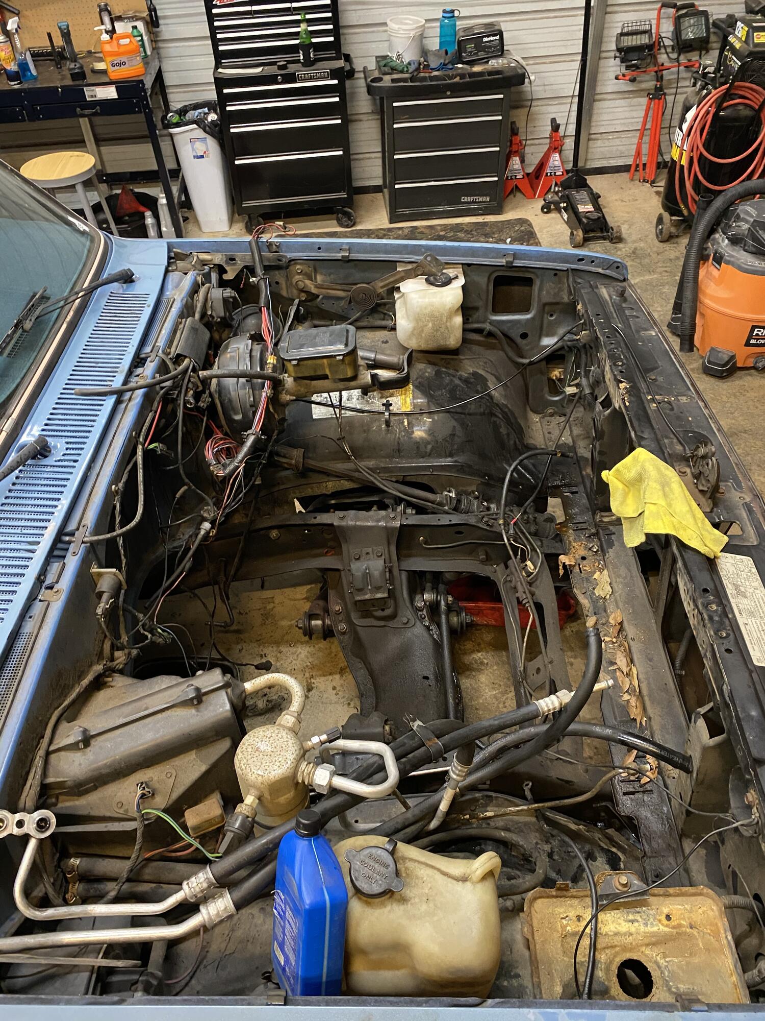

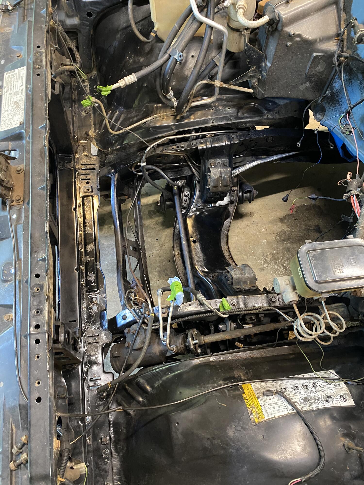

      So then it was time to start yanking out the wheezy, hurt ole 305 and T350C. I started the swap a little sooner than planned after a trip up to TN and it couldn’t keep 30mph going up the mtn, manually shifted down into 2nd with my foot to the floor lol. It had 2 dead holes when I checked compression. So we yanked it out as one unit, pushed the truck to the door of the shop and cleaned it with some degreaser. Then sprayed the frame with some VHT Chassis Black. Wanted something I could touch up easily as time goes

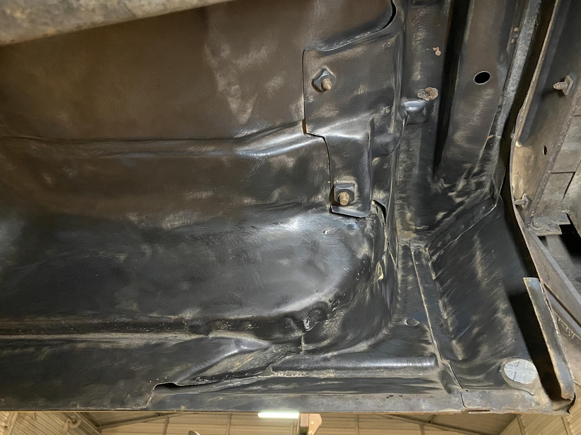

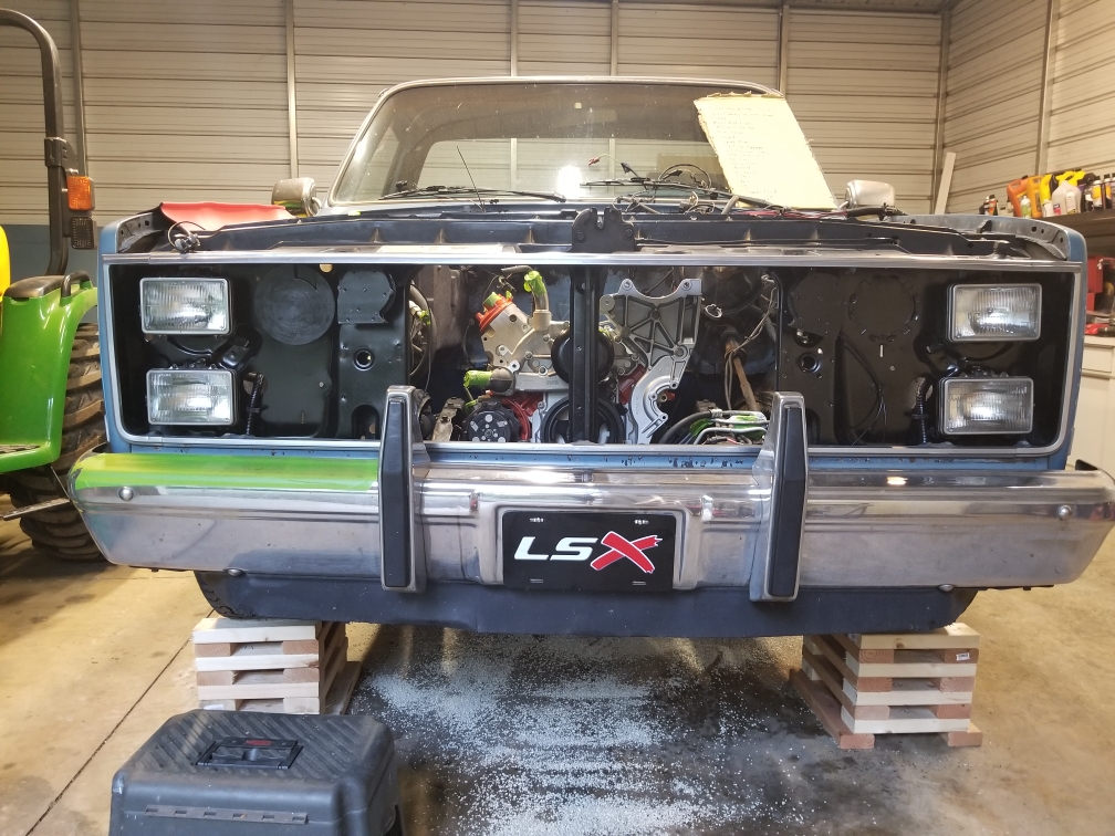

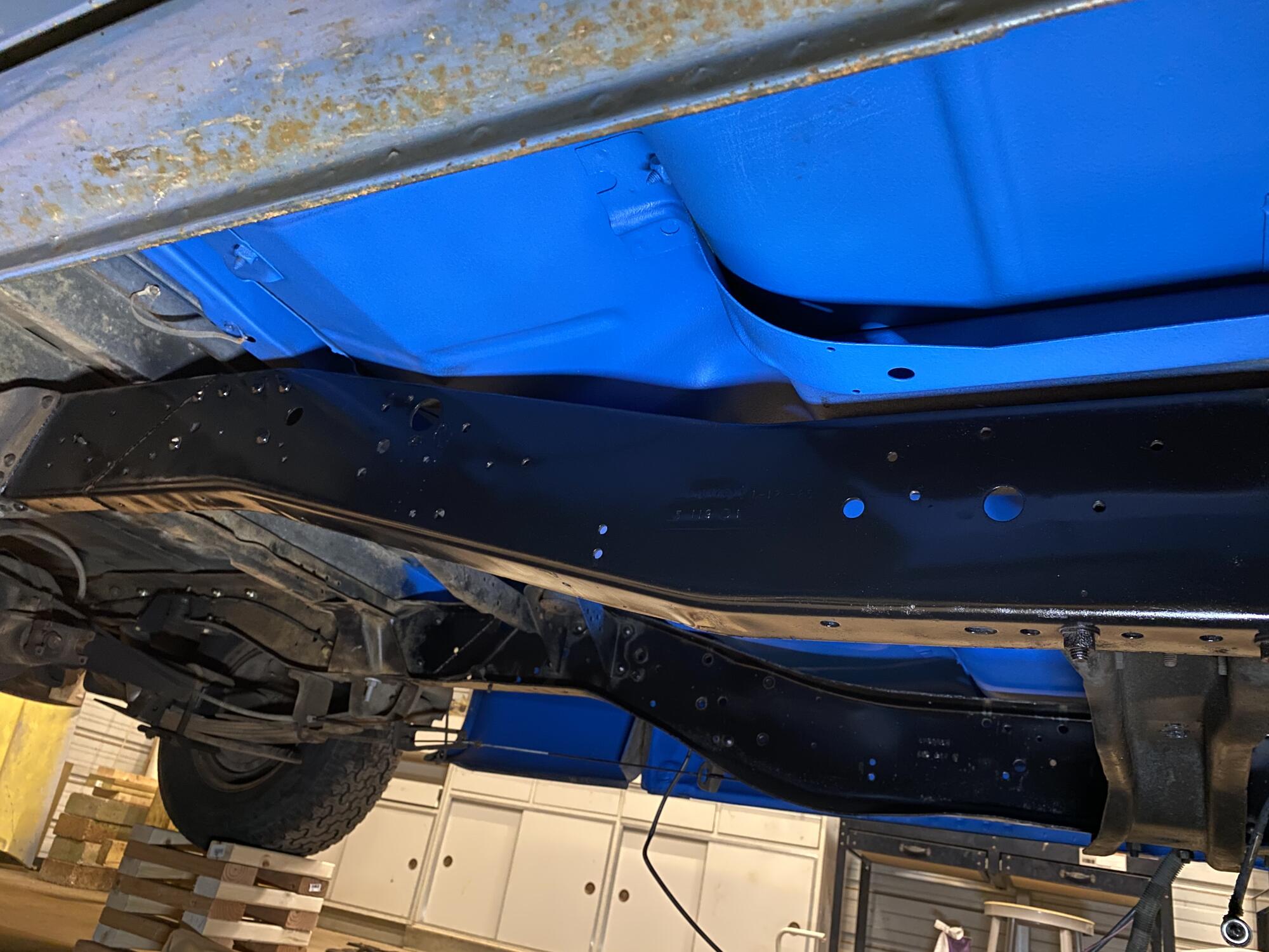

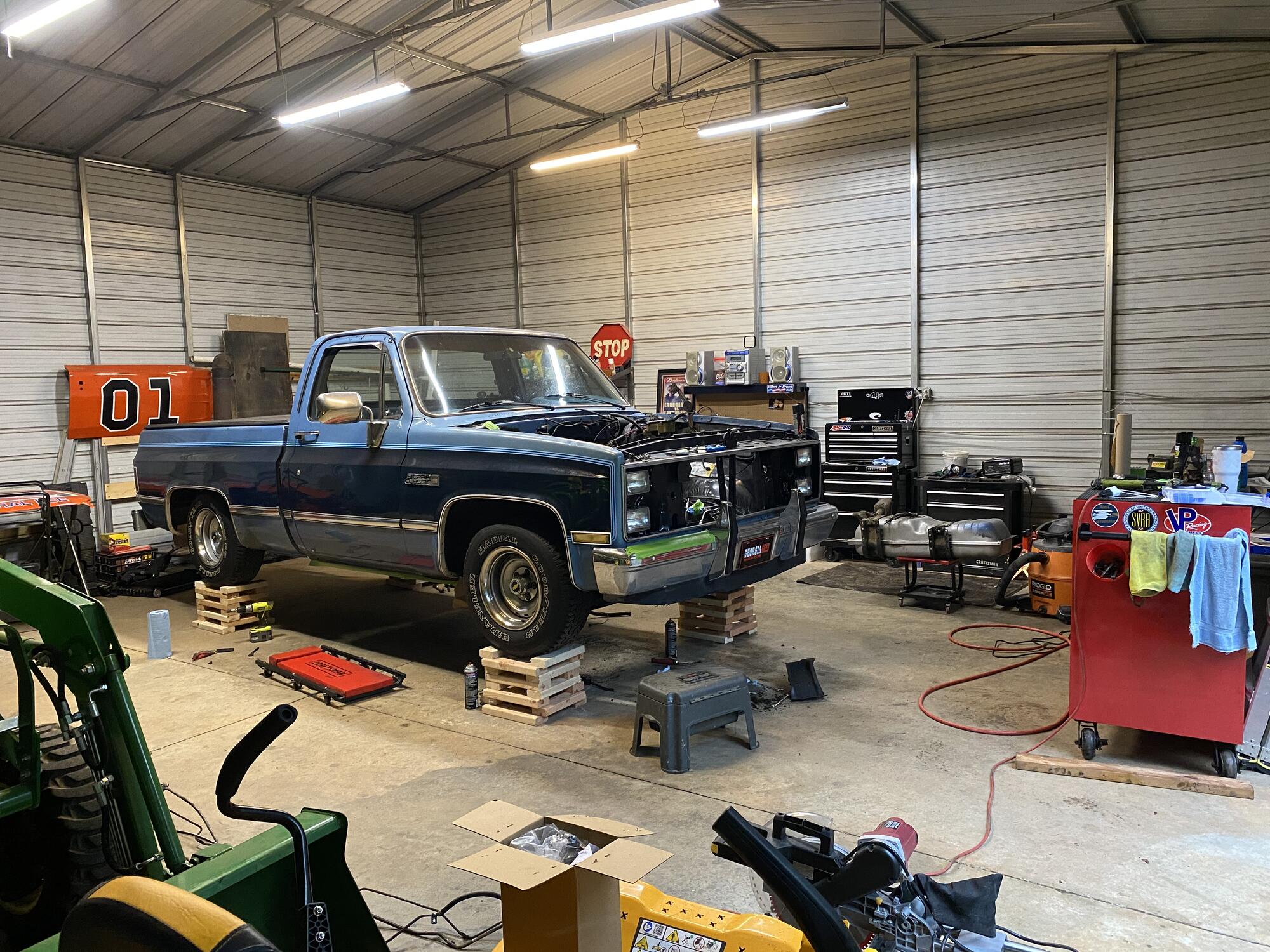

      So at this point I rolled it back in the shop, put it up on cribbing and started wire wheeling the frame and cab. The main reason I bought this truck is that it was 100% rust free. Just some surface scale, nothing of any real note. Check out those inner cab corners!

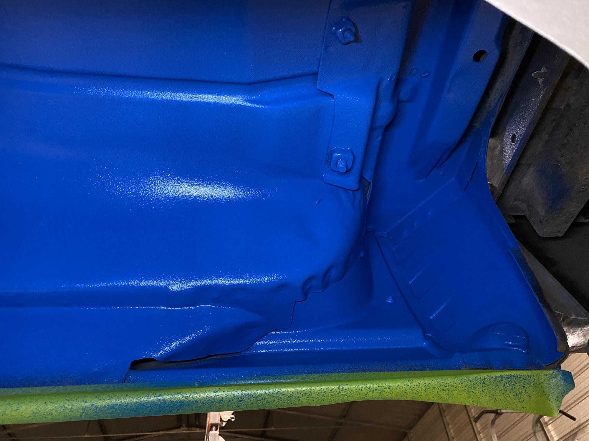

      I'd been researching what I wanted to do underneath and decided on Raptor Liner. The deciding factor was that I could get it in aerosol cans since my buddy's shop that I was building the truck in didn't have a big enough air compressor to do a traditional spray gun. Instead of the normal black, I decided I'd take a chance on the blue hopefully matching. It did not. At all. But it's all good. It looks great against the VHT Chassis Black on the rails and makes it easy to see leaks/issues
      Looking back now (this part of the build was over 3 years ago), I should've lifted the cab up a few inches to get full coverage but I didn't. Anyway, I did all the way back to the back of the cab with the Raptor and VHT. Figured I'd pull the bed off to do the back half of the truck at a later date. 3 years later, it's never been done lol. That'll change soon.

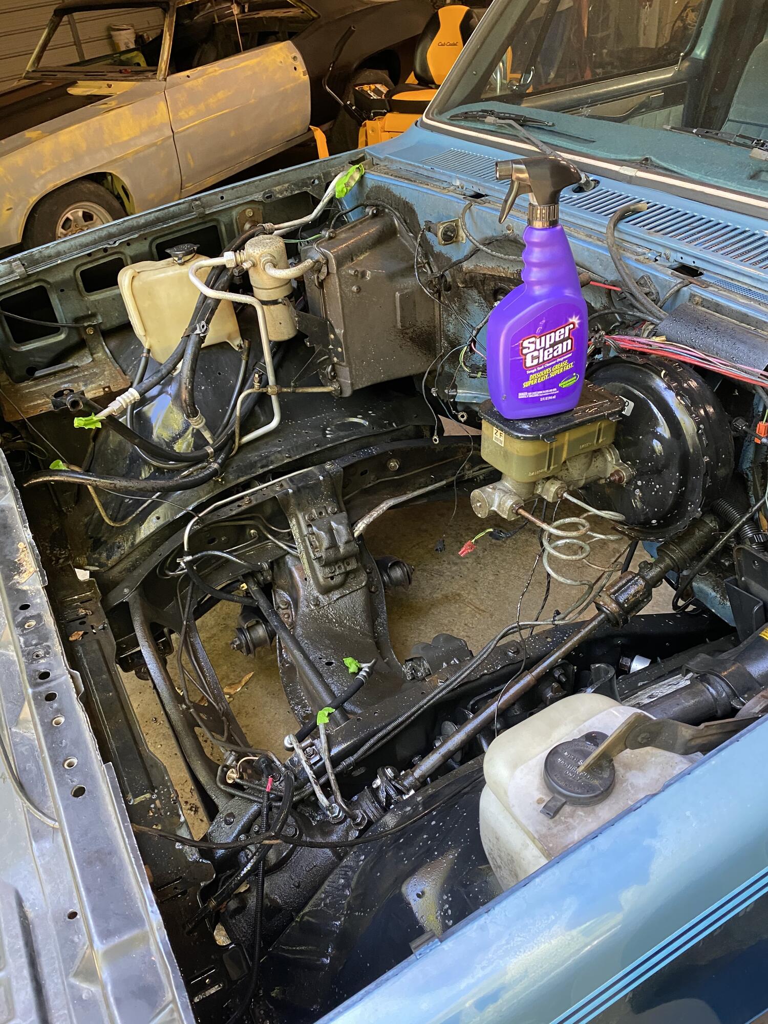

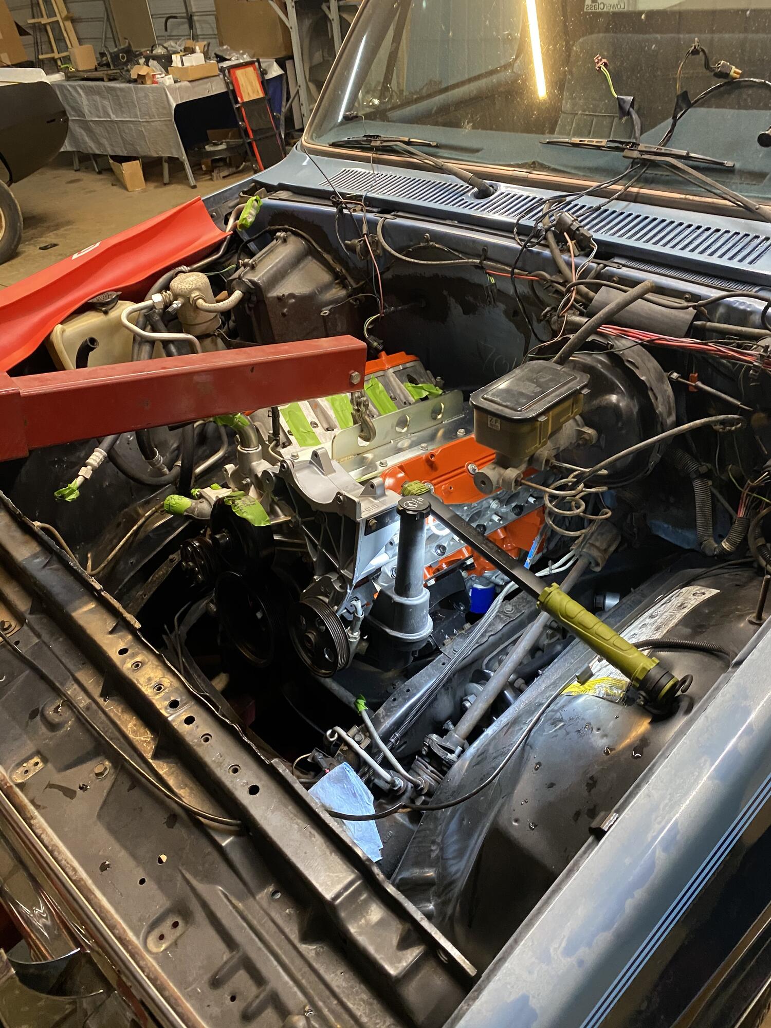

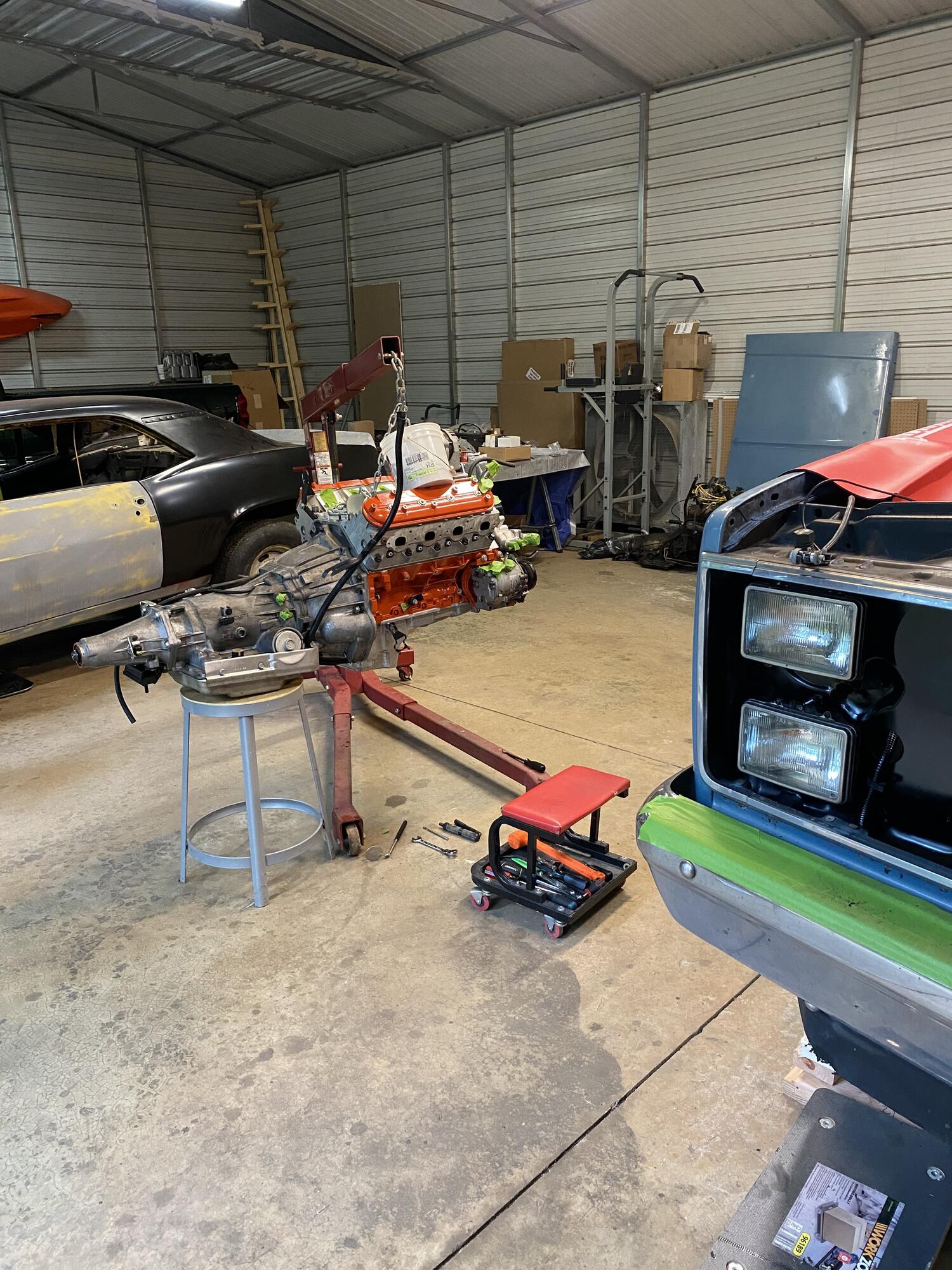

      So then we moved onto getting the engine and trans set in. Y'all already saw the motor makeover, the 4L65 just got a fresh filter and Circle D 3000 converter. Nothing more

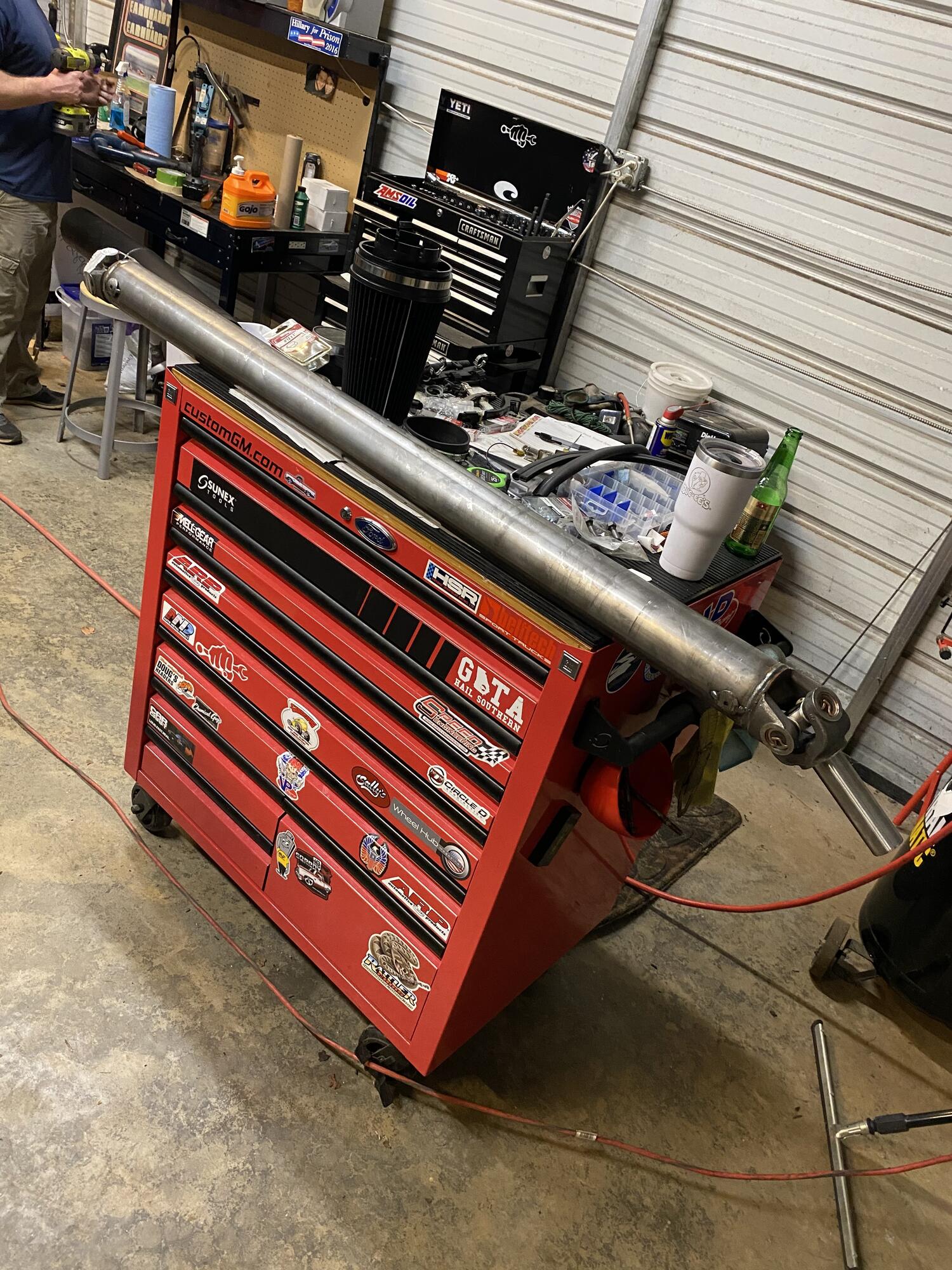

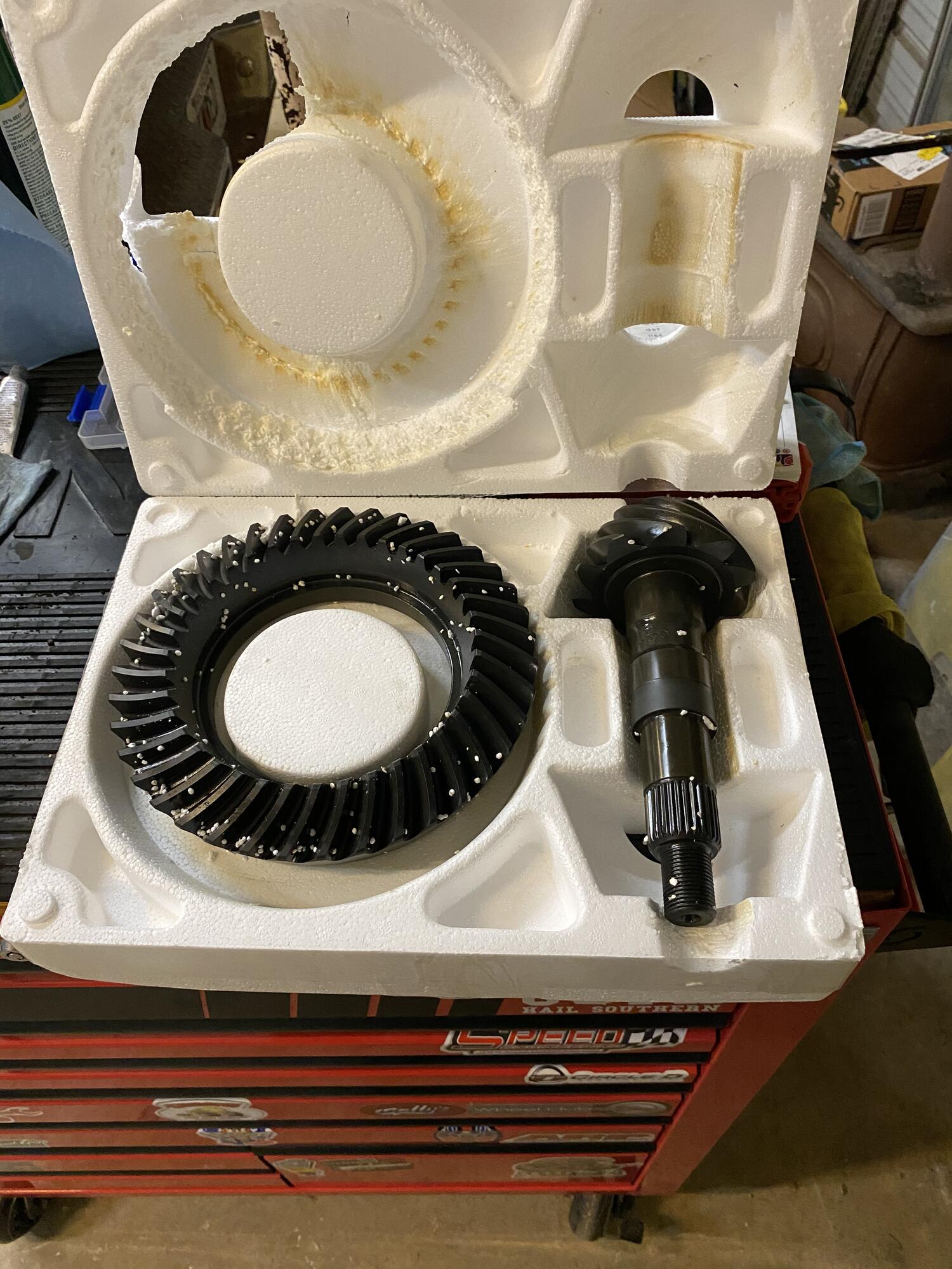

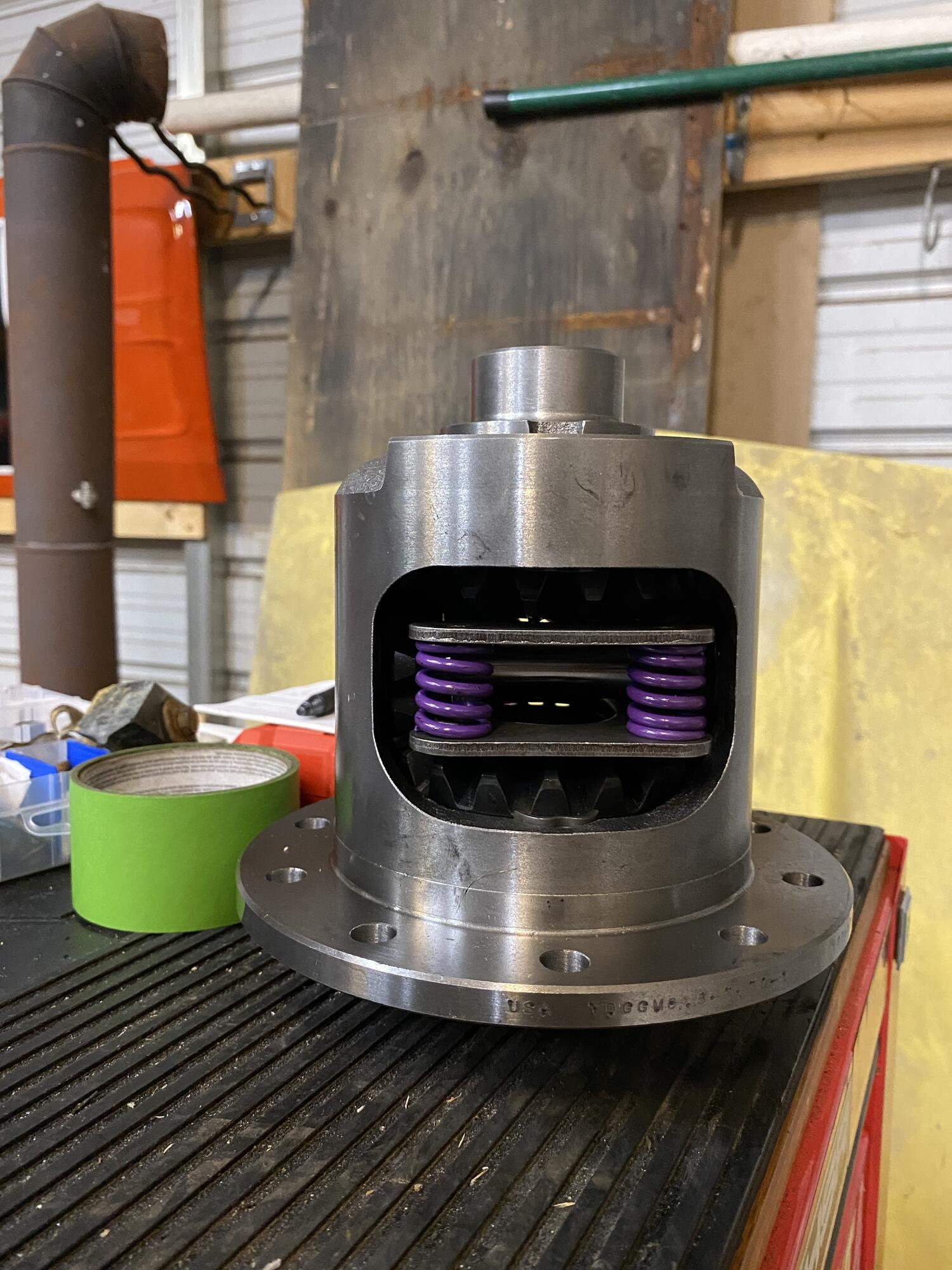

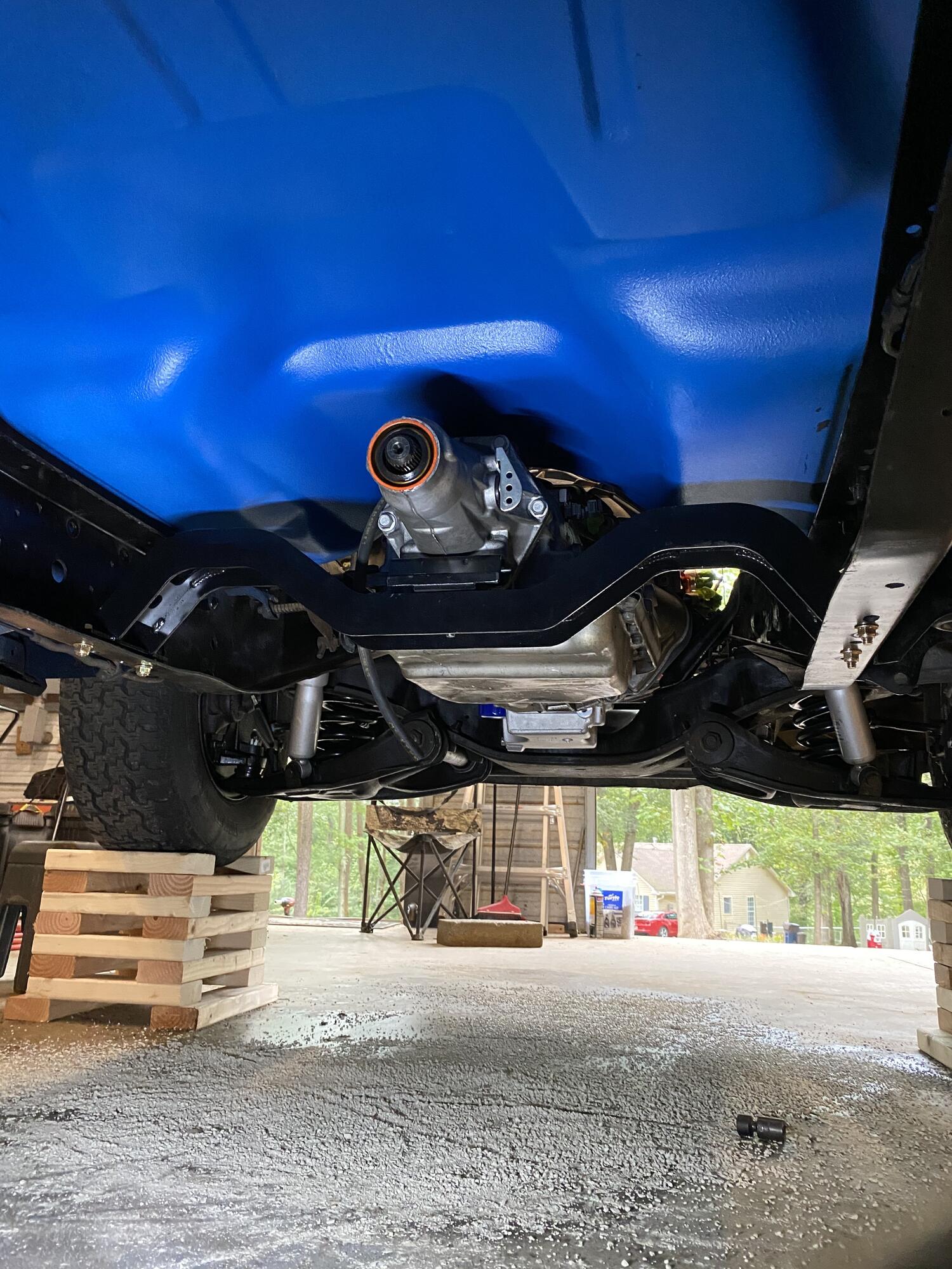

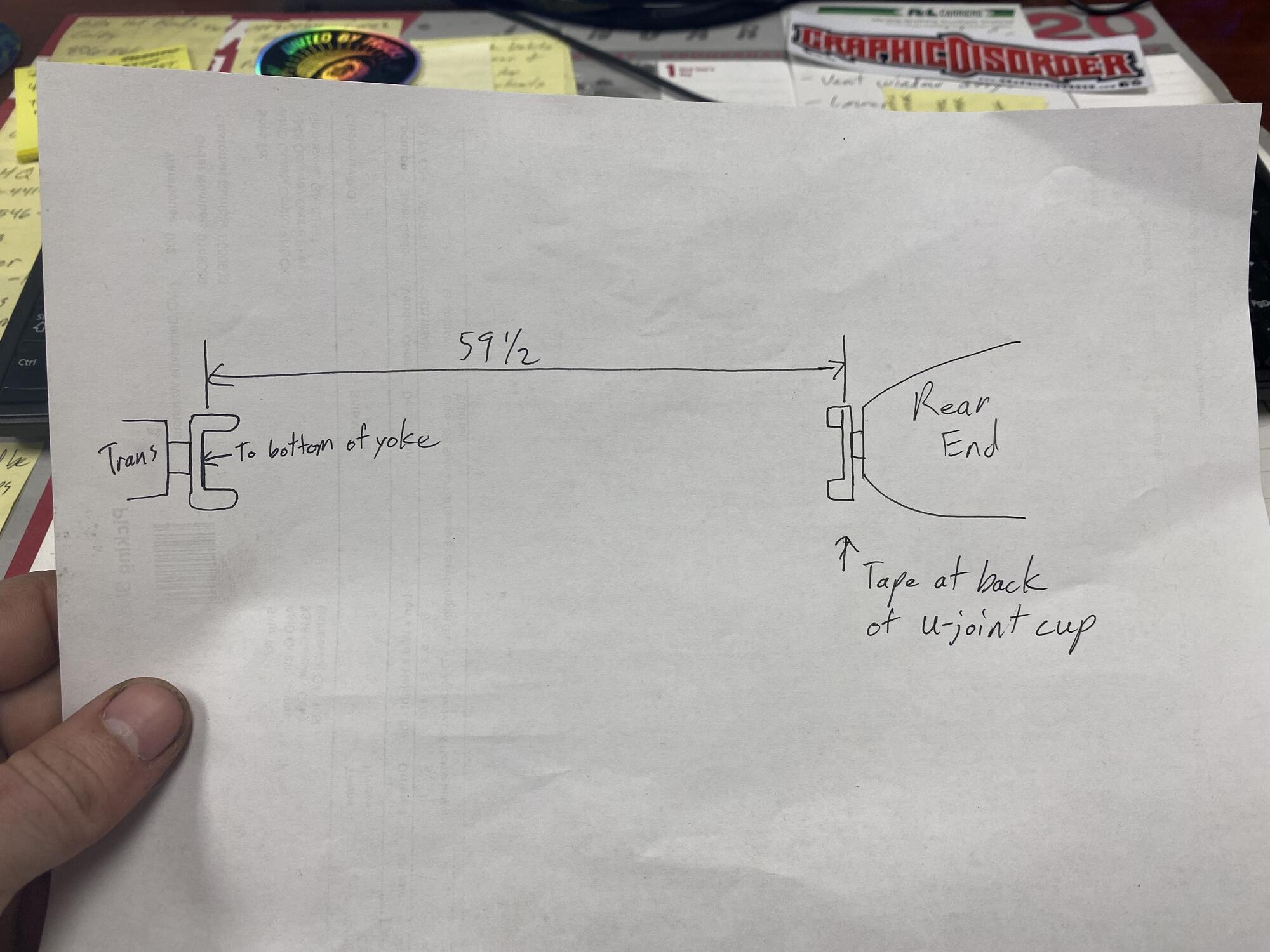

      So at this point, I started ordering parts for the rear axle. I'd found a local guy that said he'd build it for me for $500 if I bring him the axle and parts. Ordered everything from Quick Performance. They have the best deal for a "kit" for the center section, you get to choose your Richmond gear set, 28 or 30-spline Yukon Dura-Grip diff, all bearings and seals for $500 at the time. I went 30-spline so I picked up their matching axles, 1350 forged yoke and T/A girdle while I was at it. Went with 3.90 gears.

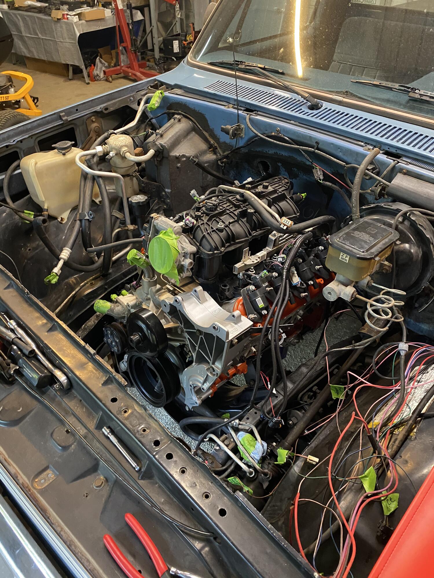

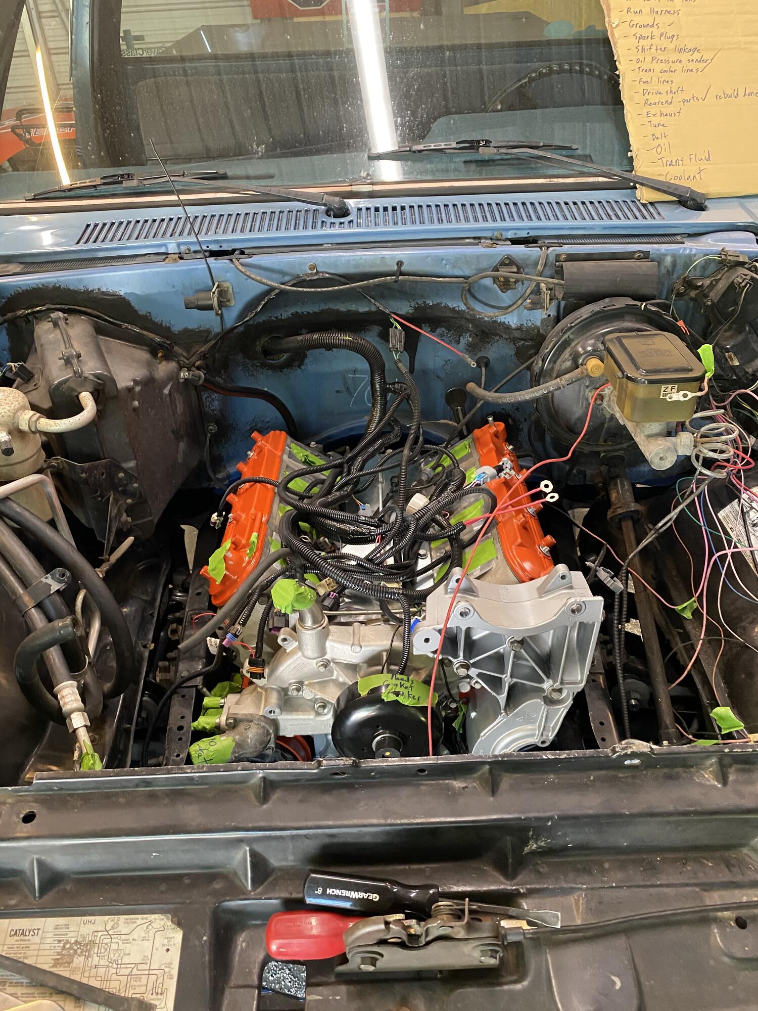

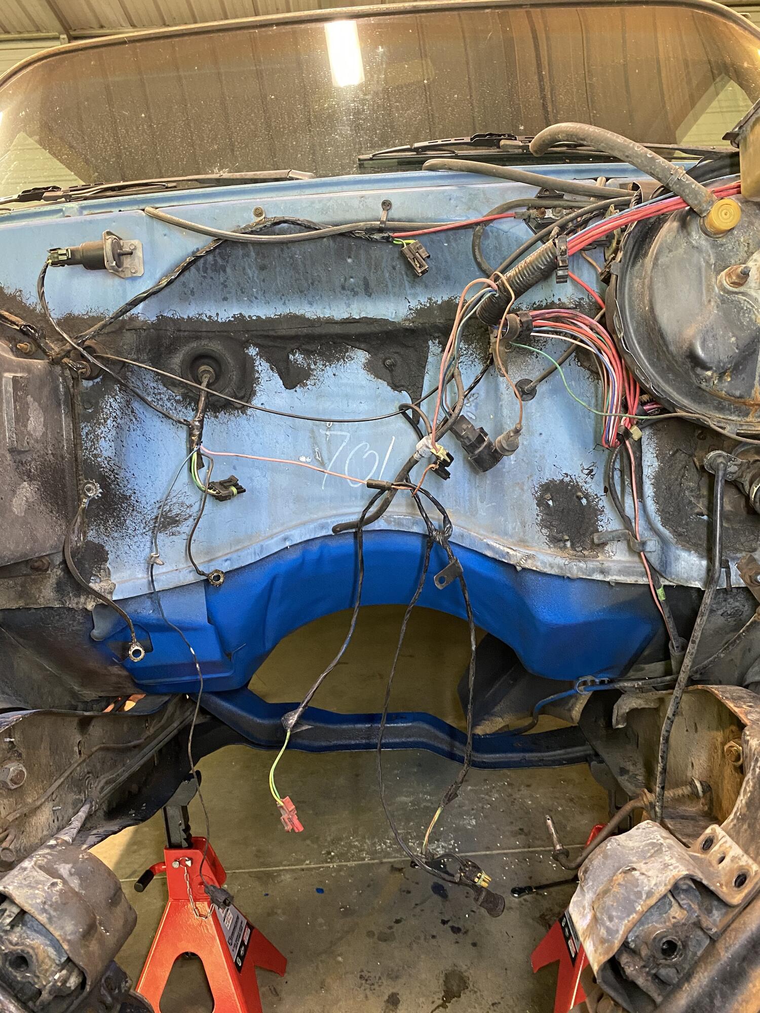

      So now that the drivetrain is in, it was time to start installing the new PSI Conversions harness and figuring out what original stuff to keep or get rid of
      Threw the intake on to double check the routing of everything. I hate wiring lol

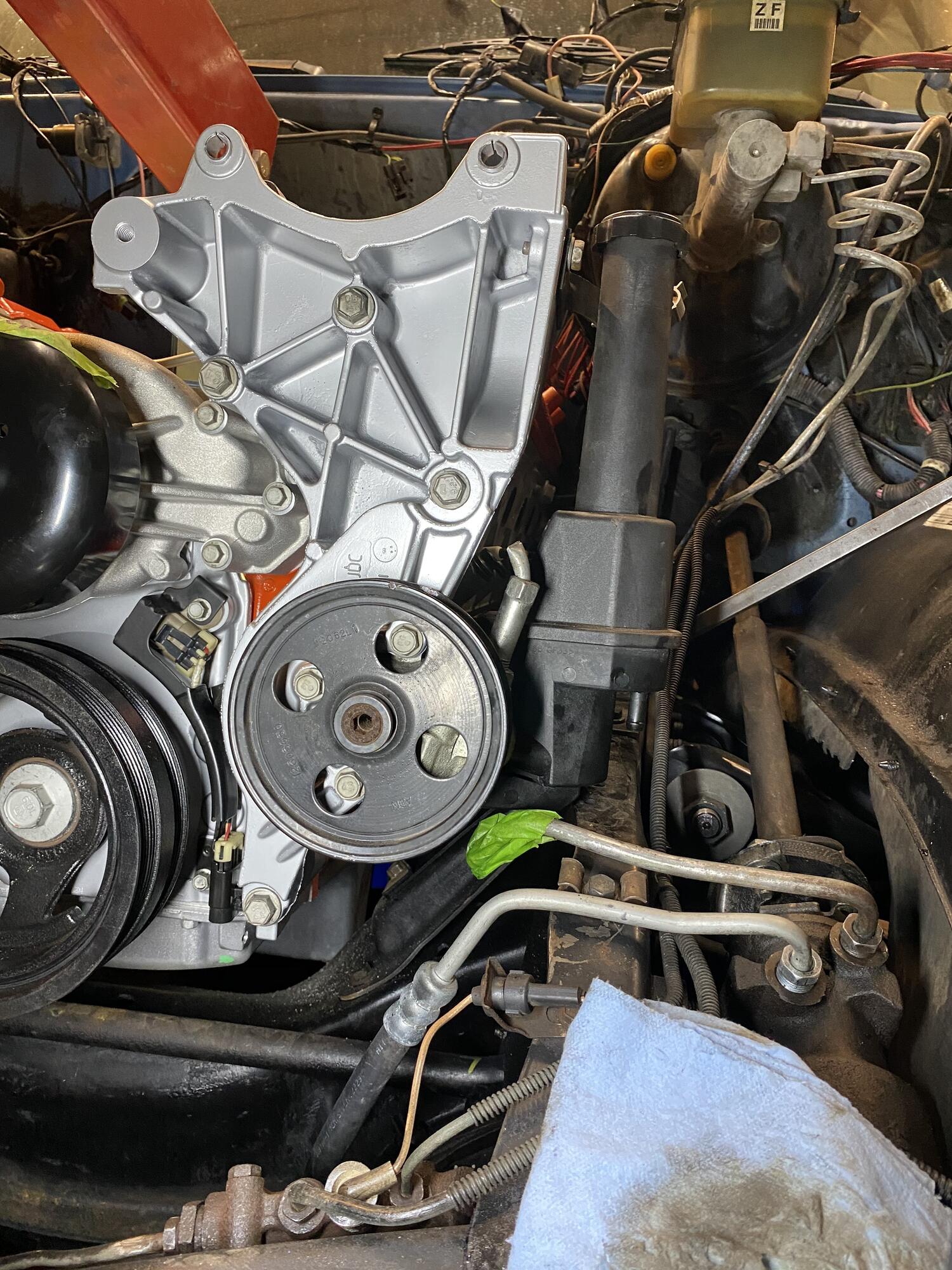

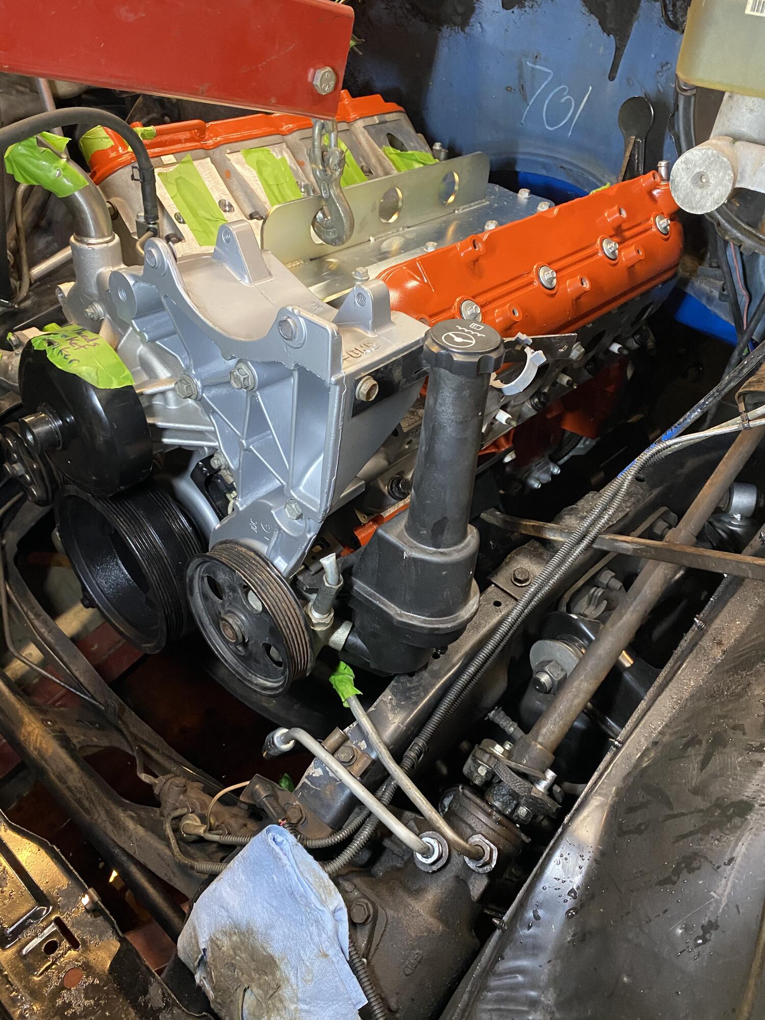

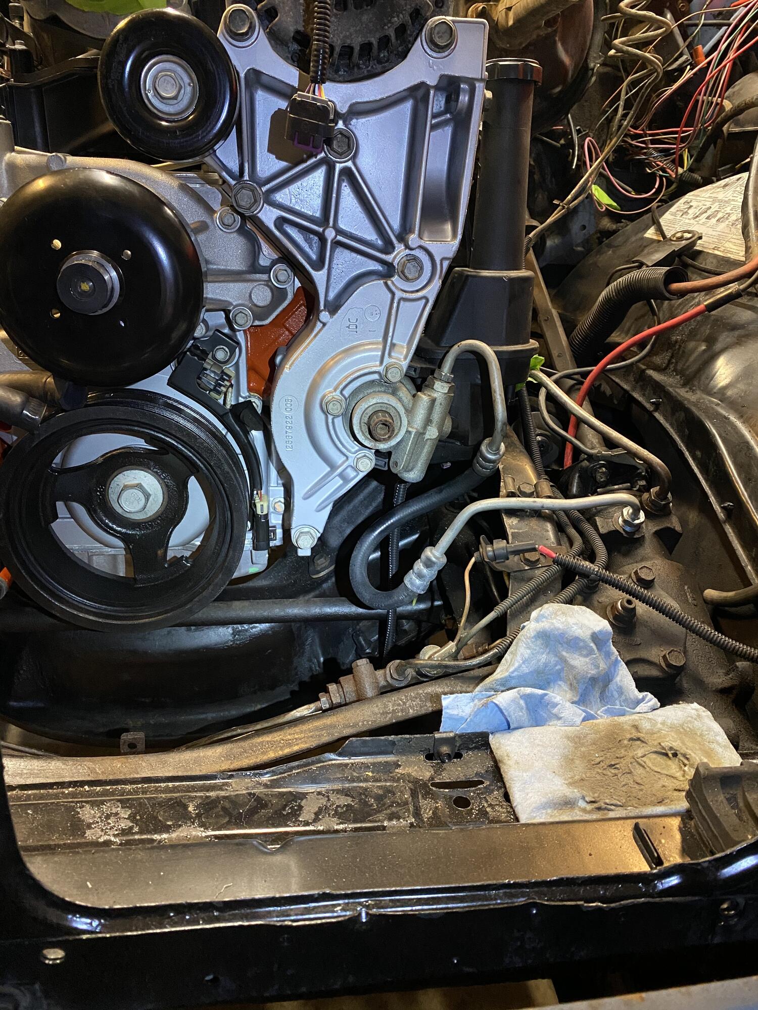

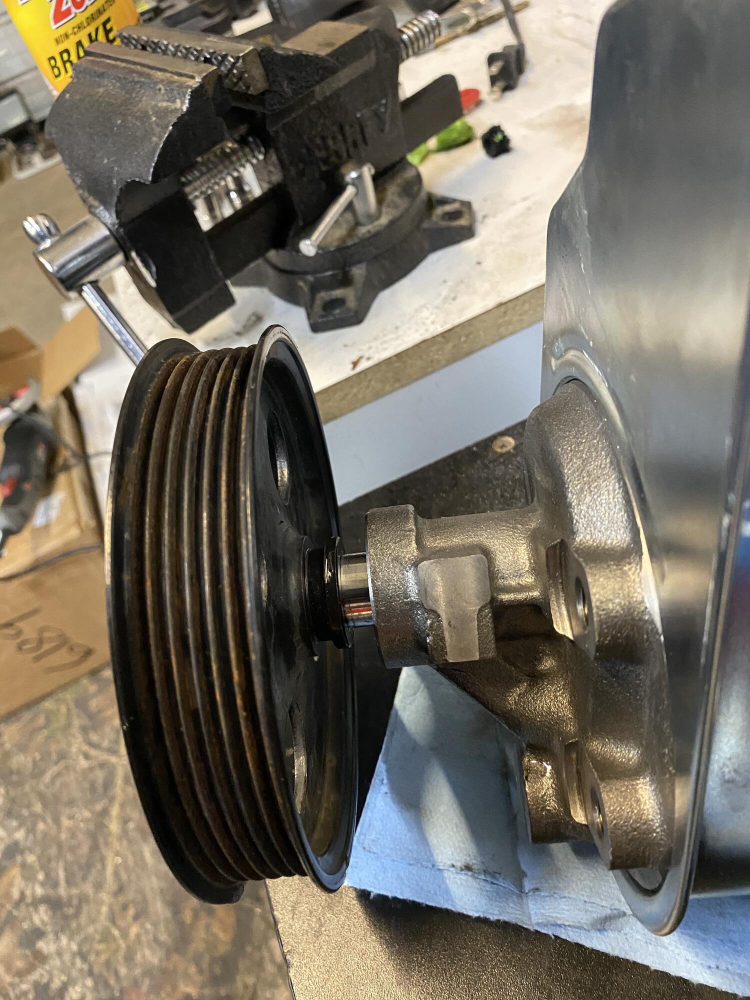

      It was around this time that I also attempted to replace the Envoy PS pump with a truck pump and found out the bolt pattern is different. (Don't mind the backwards pulley, that was a distracted moment) The truck pumps have 4 larger bolts in a square pattern vs the TB/Envoys that have 3 smaller bolts in a half moon. So out came the BFH and back in went the Envoy pump

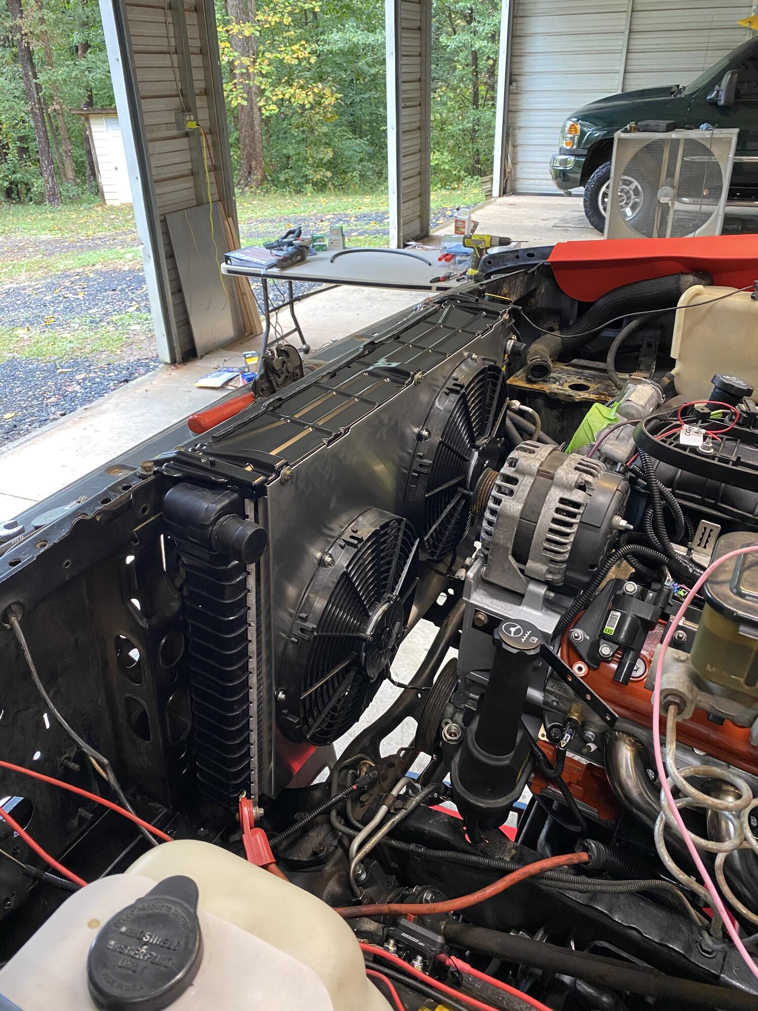

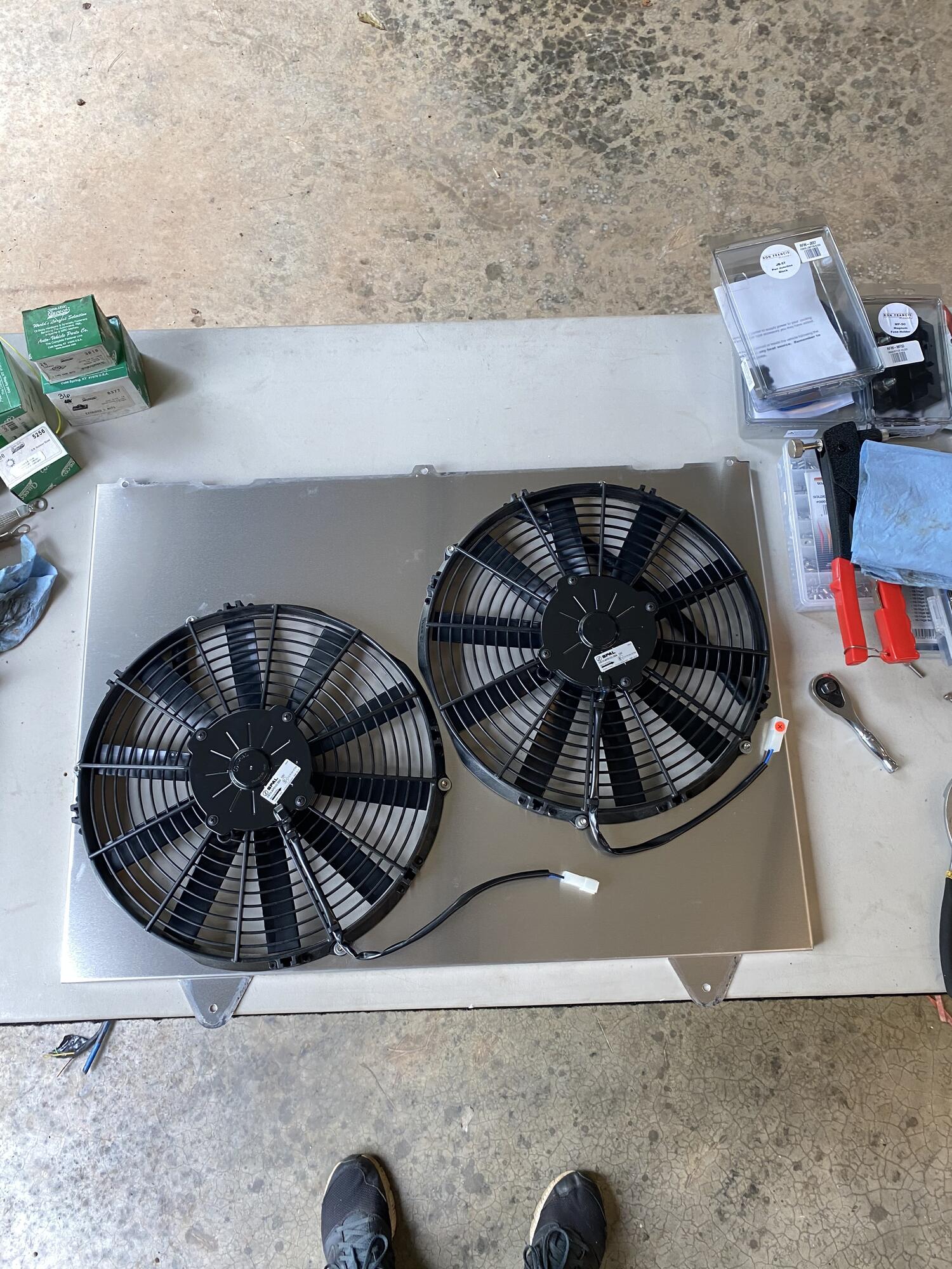

      I picked up the fan shroud from Tejas Steelworks as well. It's meant to work with an OE 454 radiator and use dual 13" fans, either Spal or V6 4th gen Camaro fans is what they recommend. I picked up the middle of the road CFM Spal's

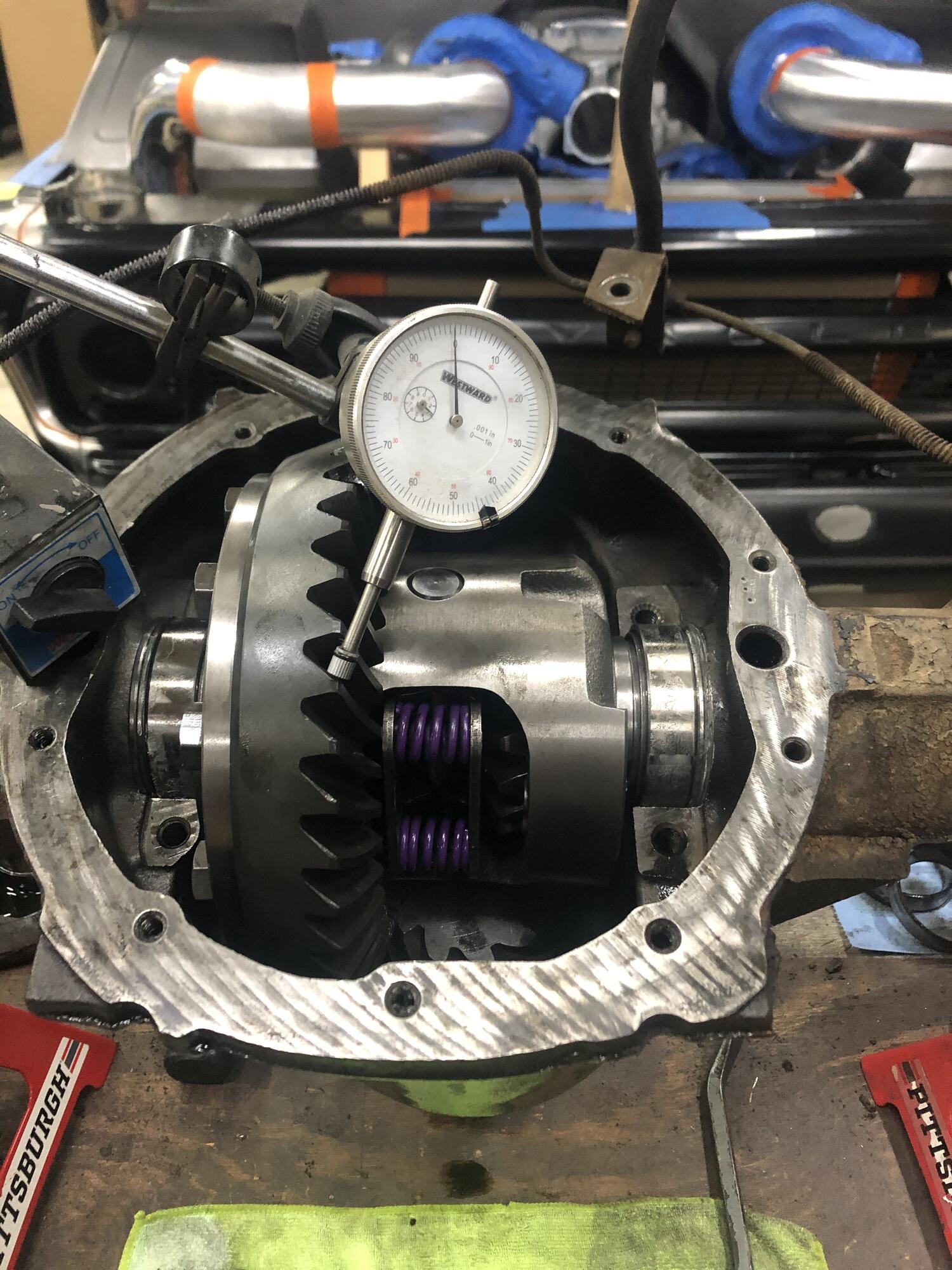

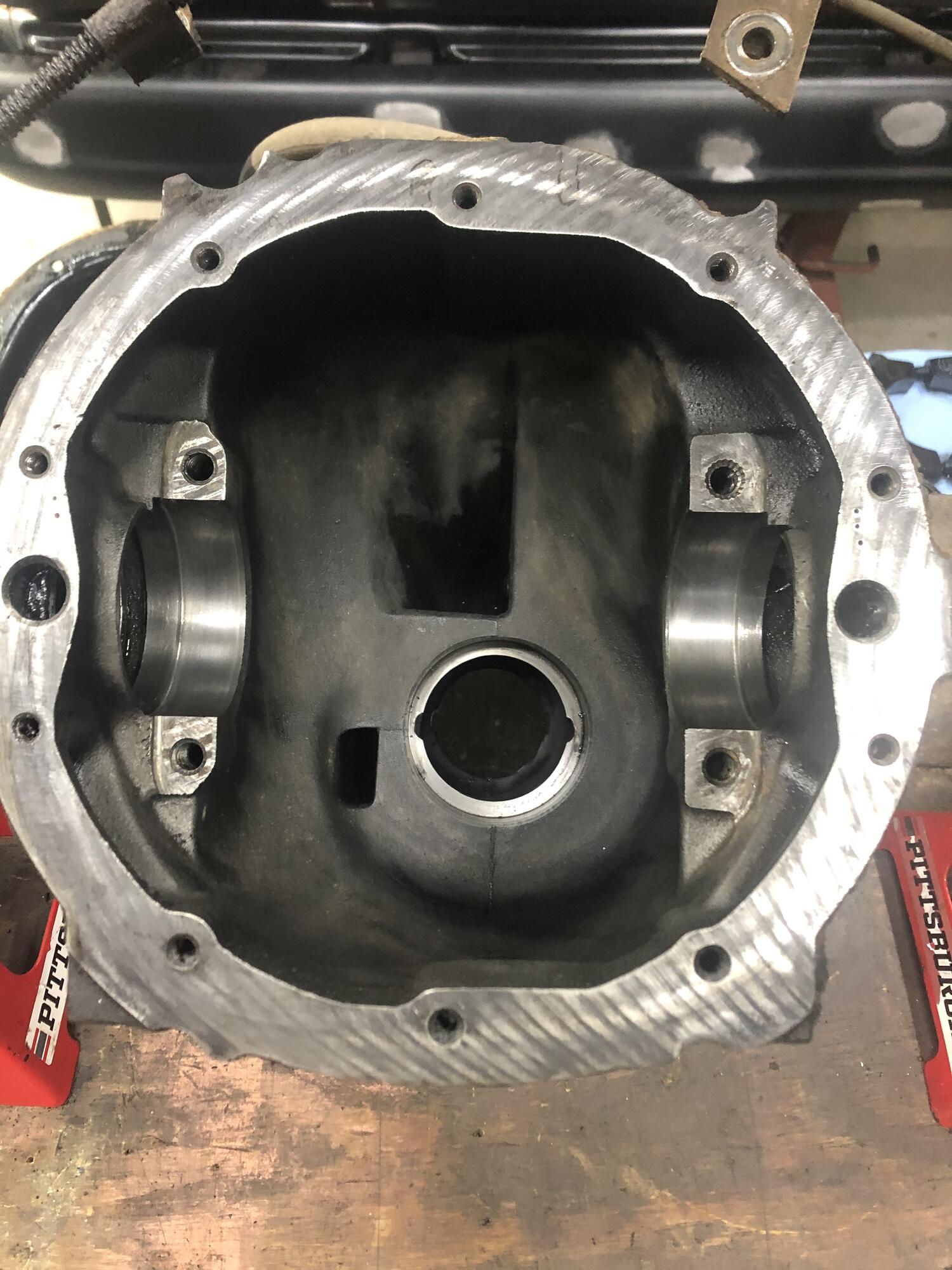

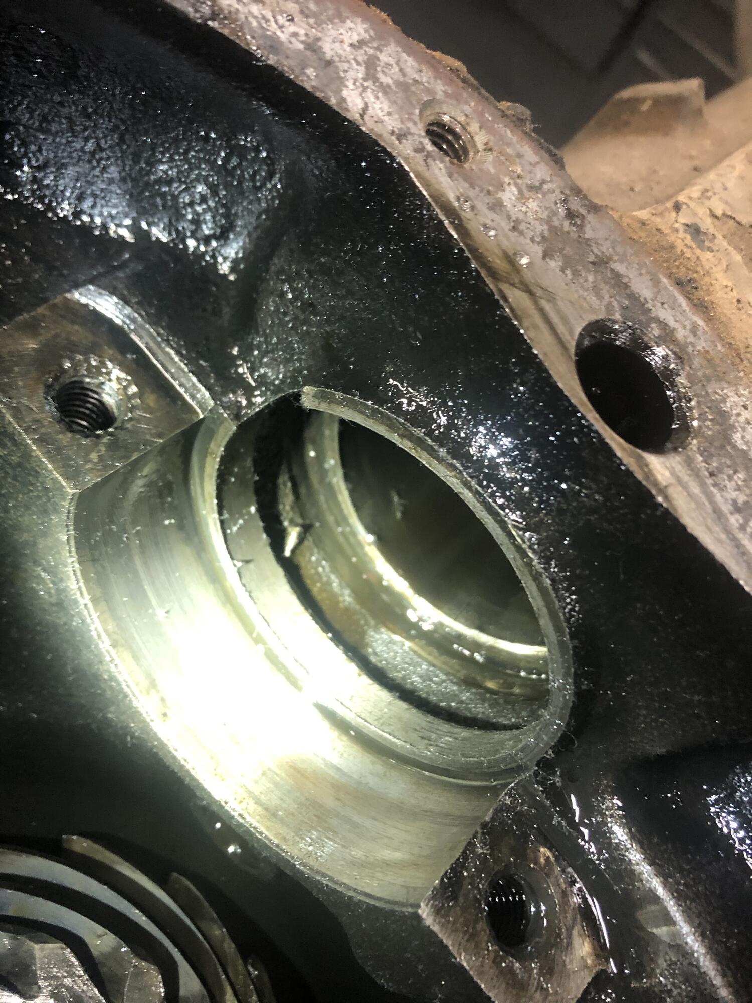

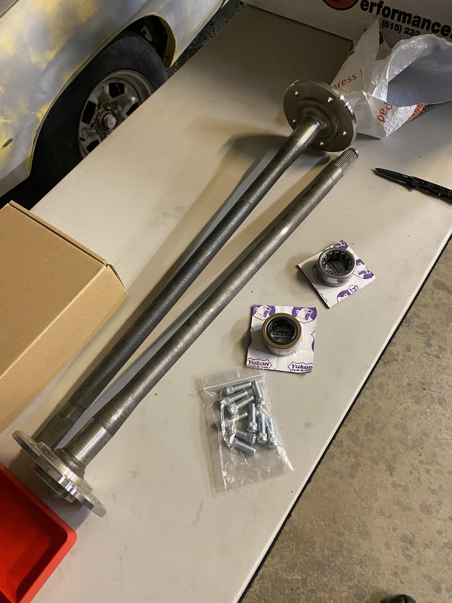

      My rear end guy sent me some pictures that day, said my axle had been into before and there were a few burrs and junk in the axle tubes but thankfully everything cleaned up just fine.

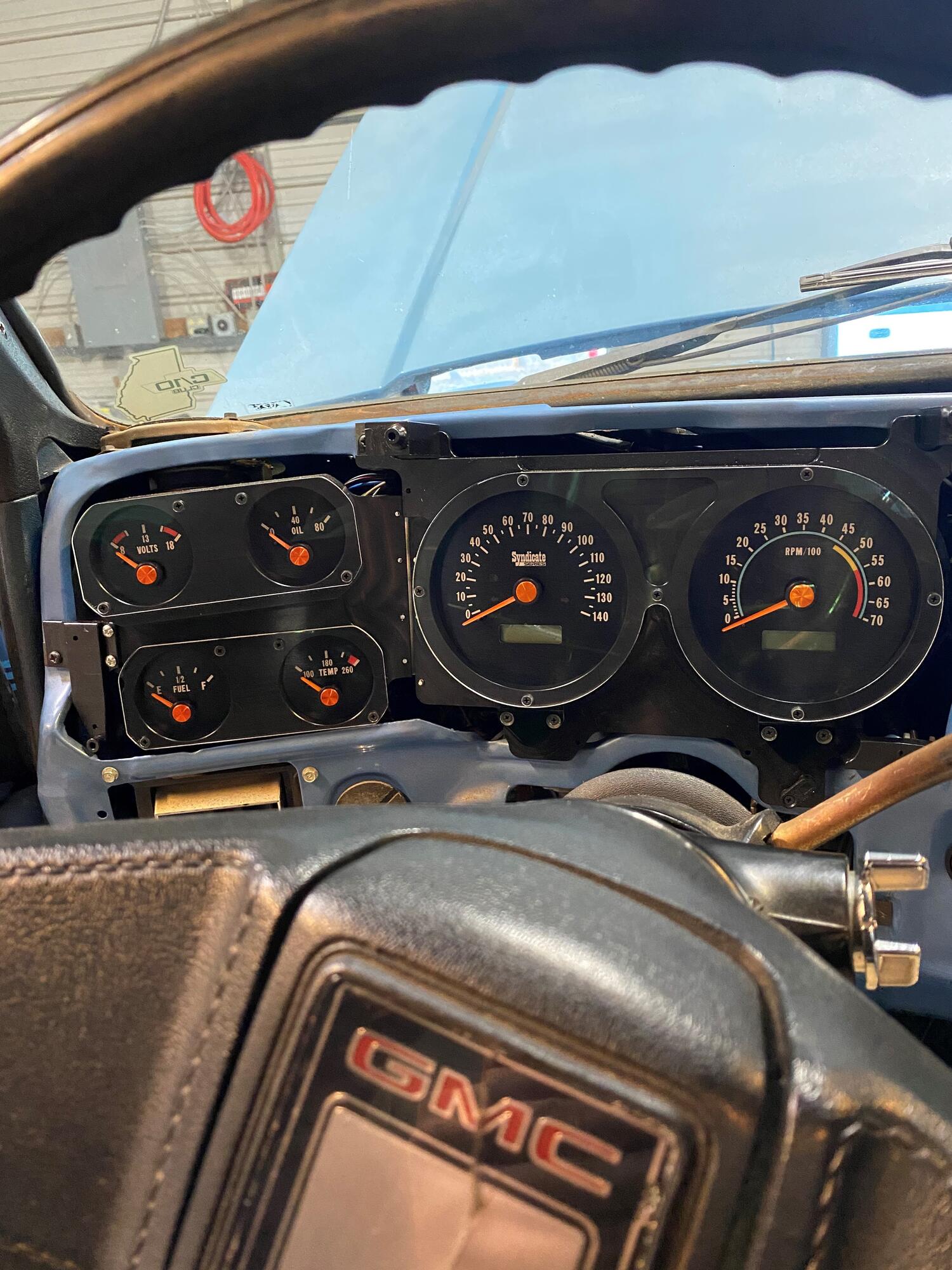

      Around this time we started working with Joe over at Squarebody Syndicate on one of his builds, so we worked out a deal on a set of his gauges. I love these since they look very close to stock, but they're made by Dakota so they have all the fancy features too. They were super easy to wire up once I found the master pin-out chart for these trucks
      Name:  Gauge install 2.jpg

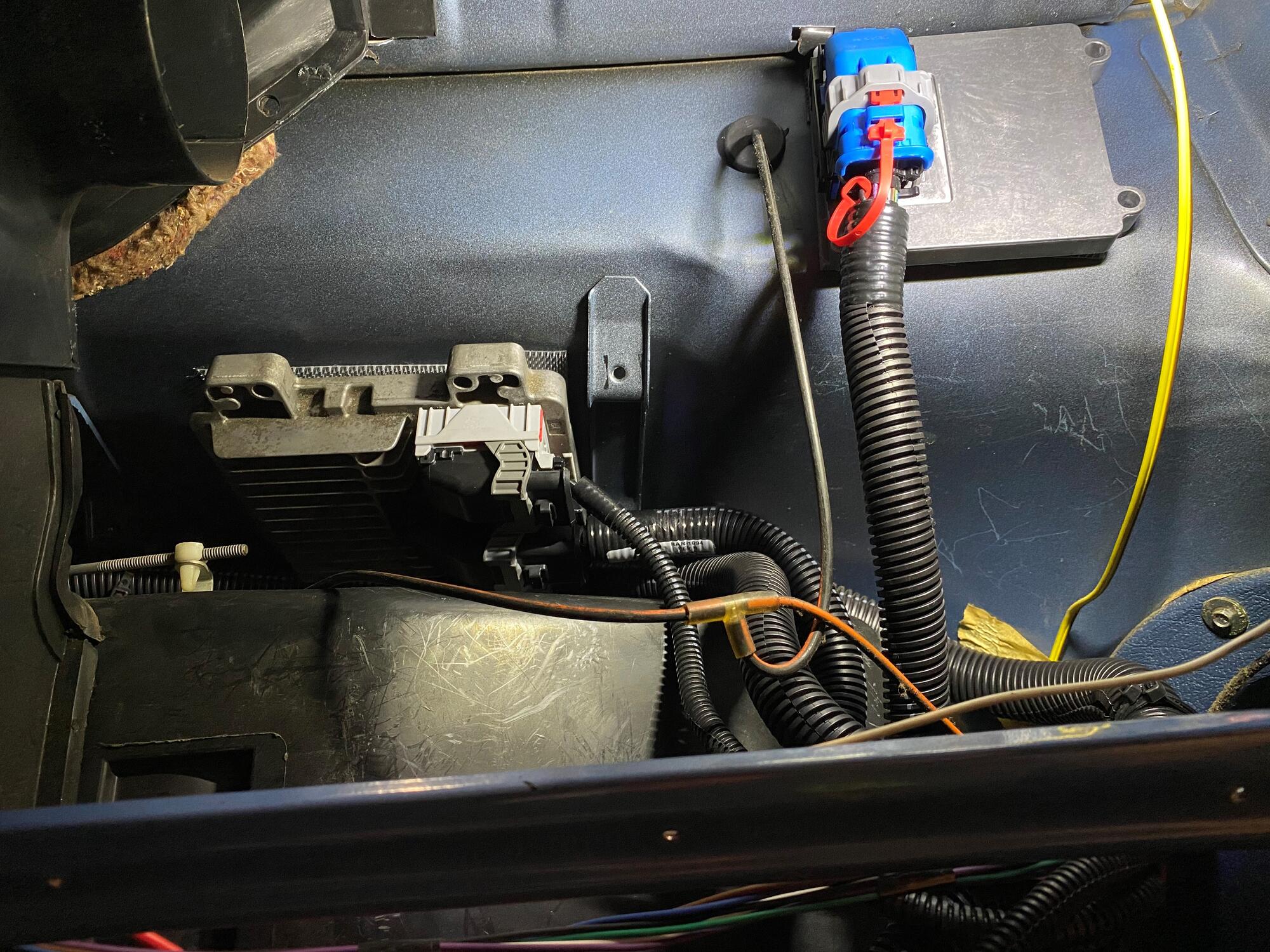

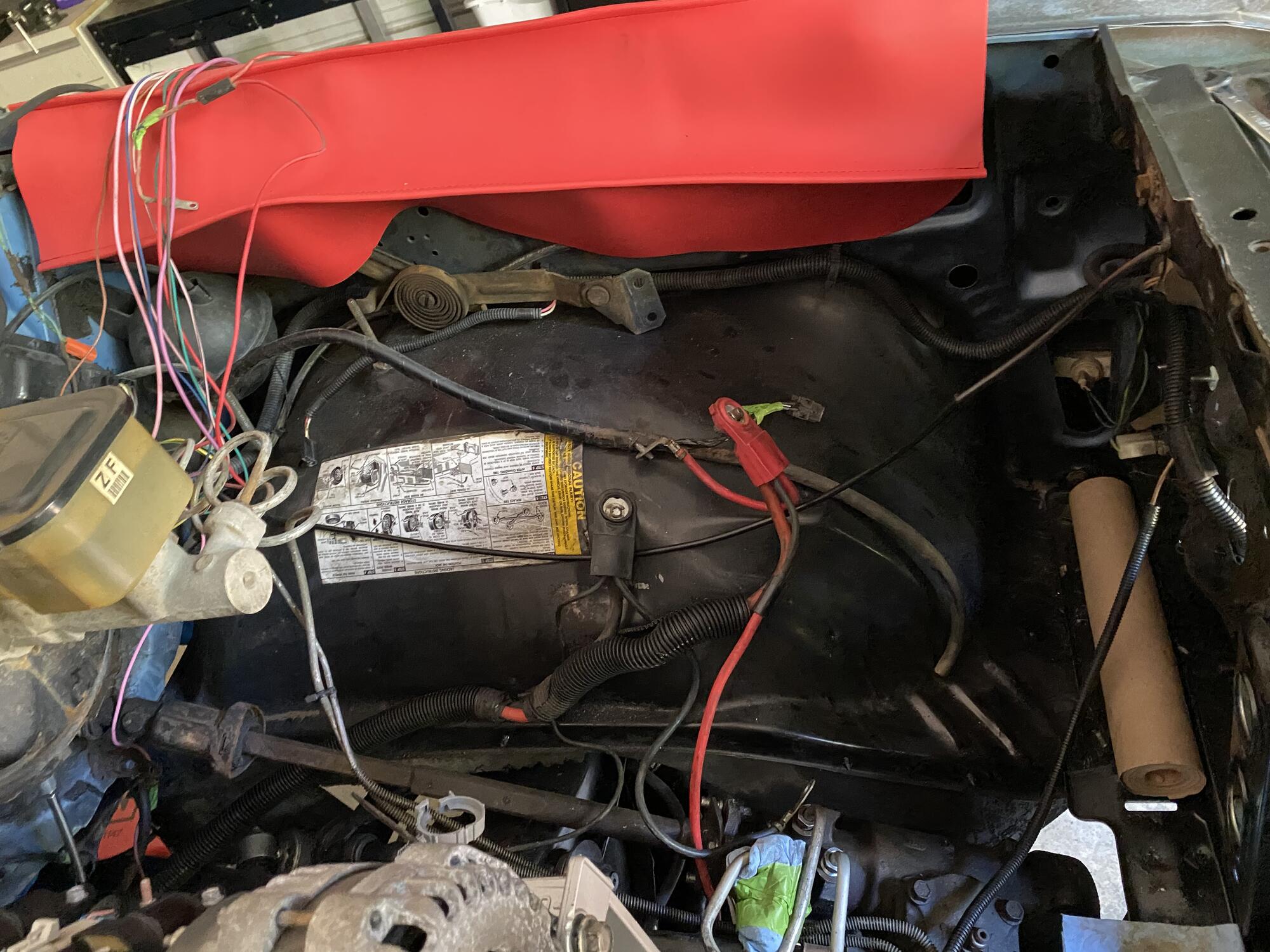

      While I was in the dash, I started working on making all the connections in the cab between the factory wiring and the swap harness and mounting the ECM/TCM.

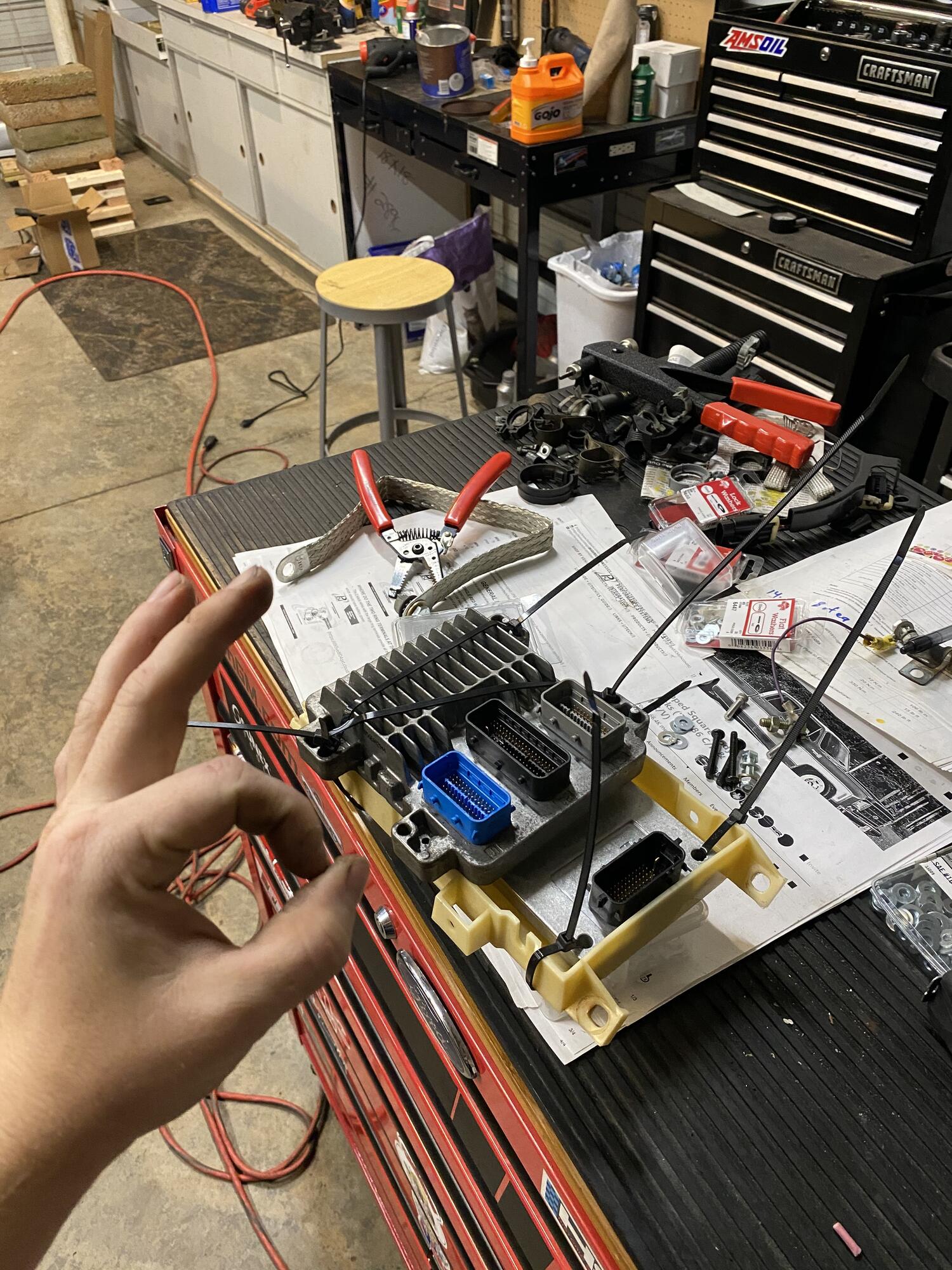

      Tried using the factory ESC computer box but that ended up not working. I ended up using industrial strength velcro to the top side of the cowl in between the original computer mounts and a couple zip ties to the mounts for good measure
      Name:  Computer mount.jpg

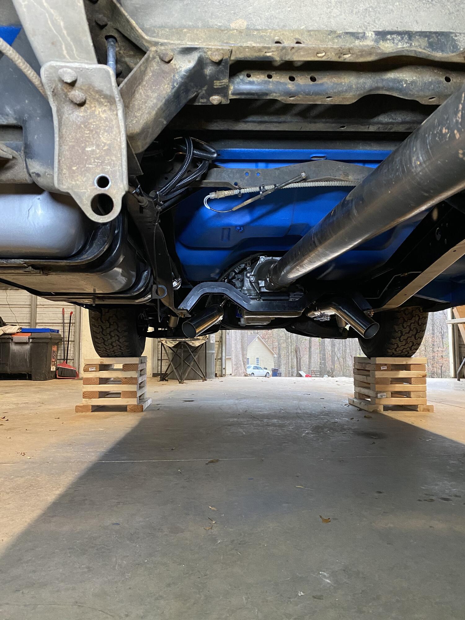

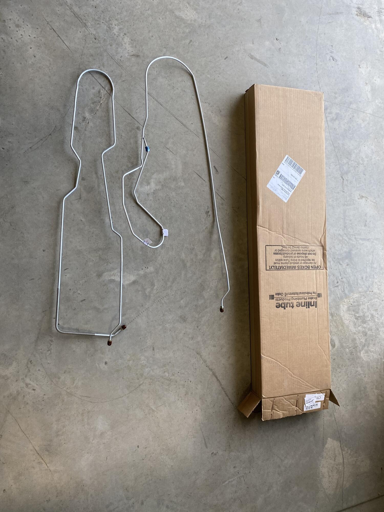

      Also had to cut all the e-brake cables when I pulled the rear end out. When they chopped the truck down, instead of buying new cables, they just used a nut and a ton of weld to shorten the longbed cables. So they got ziptied to the x-members for now

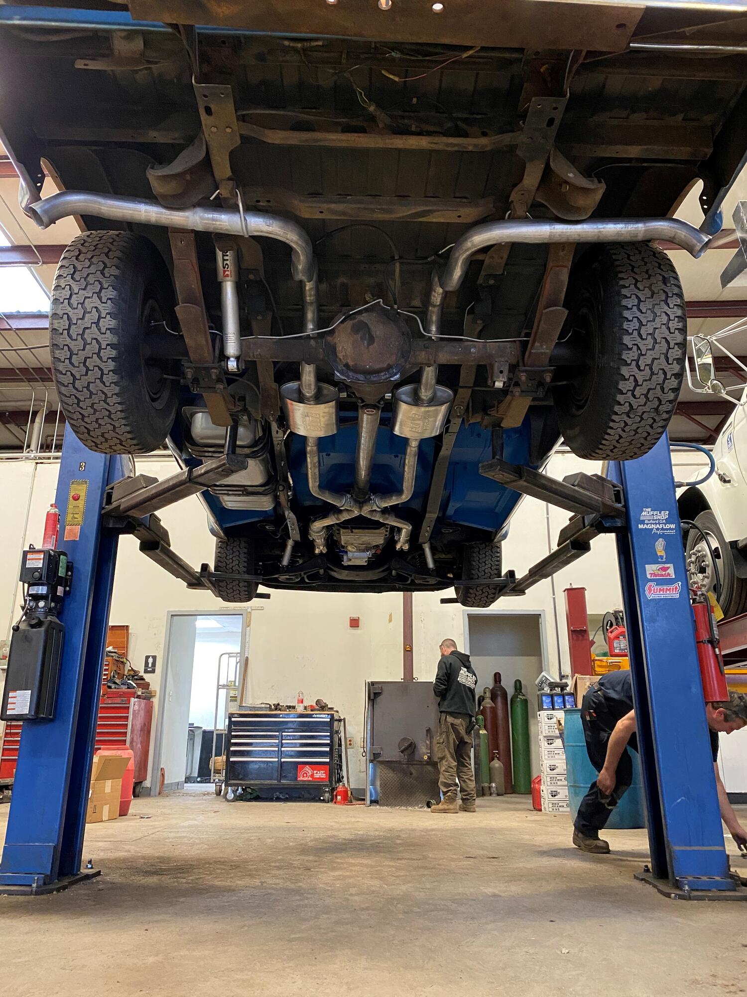

      Then threw on some extensions on the headers so we could do the first fire and have the o2s be happy. We fired it up briefly before the fuel pump died. This would be the beginning of a long saga...

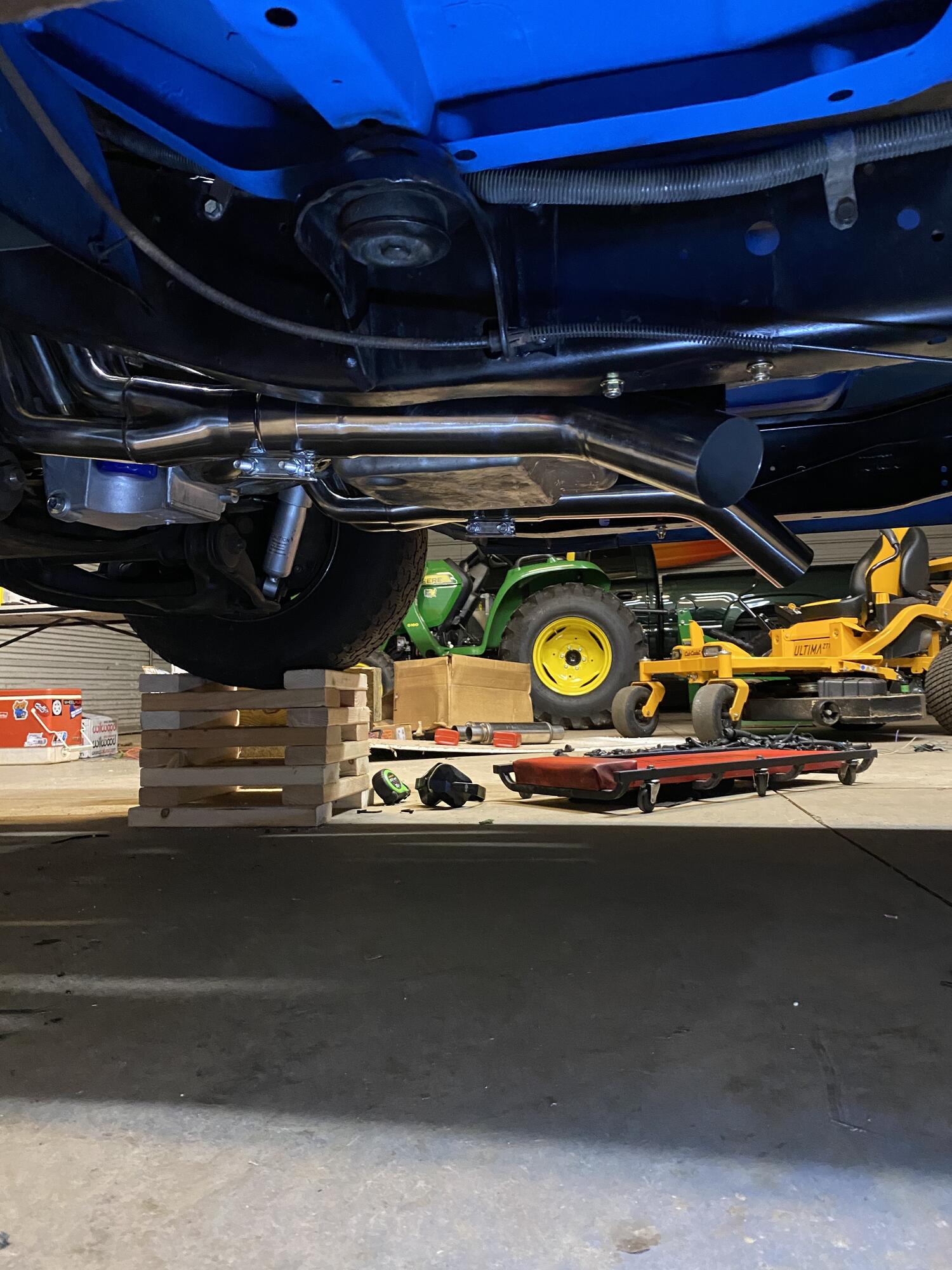

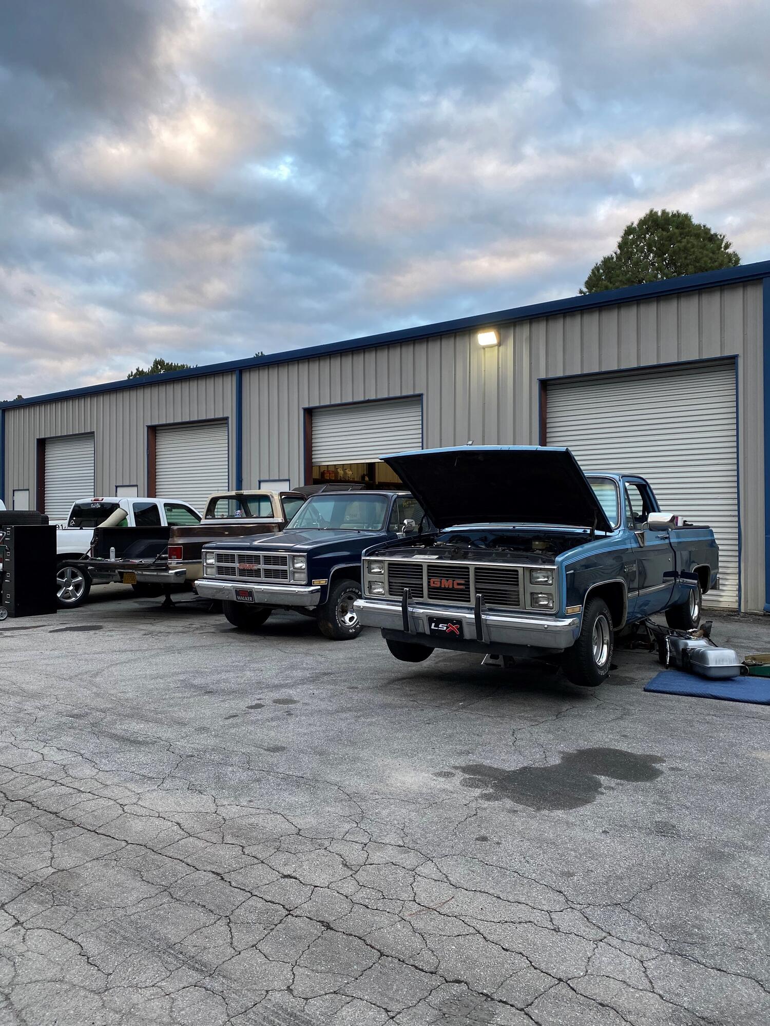

      So that pump was a Delco EP381. Nobody had one in stock so I bought the equivalent Delphi pump and through it in. My tuner came by long enough to load a basic tune in it so it would idle. Then we loaded it up and took it to C10 Fall Revival '20.
      https://www.youtube.com/shorts/hWqK0yfPyGw

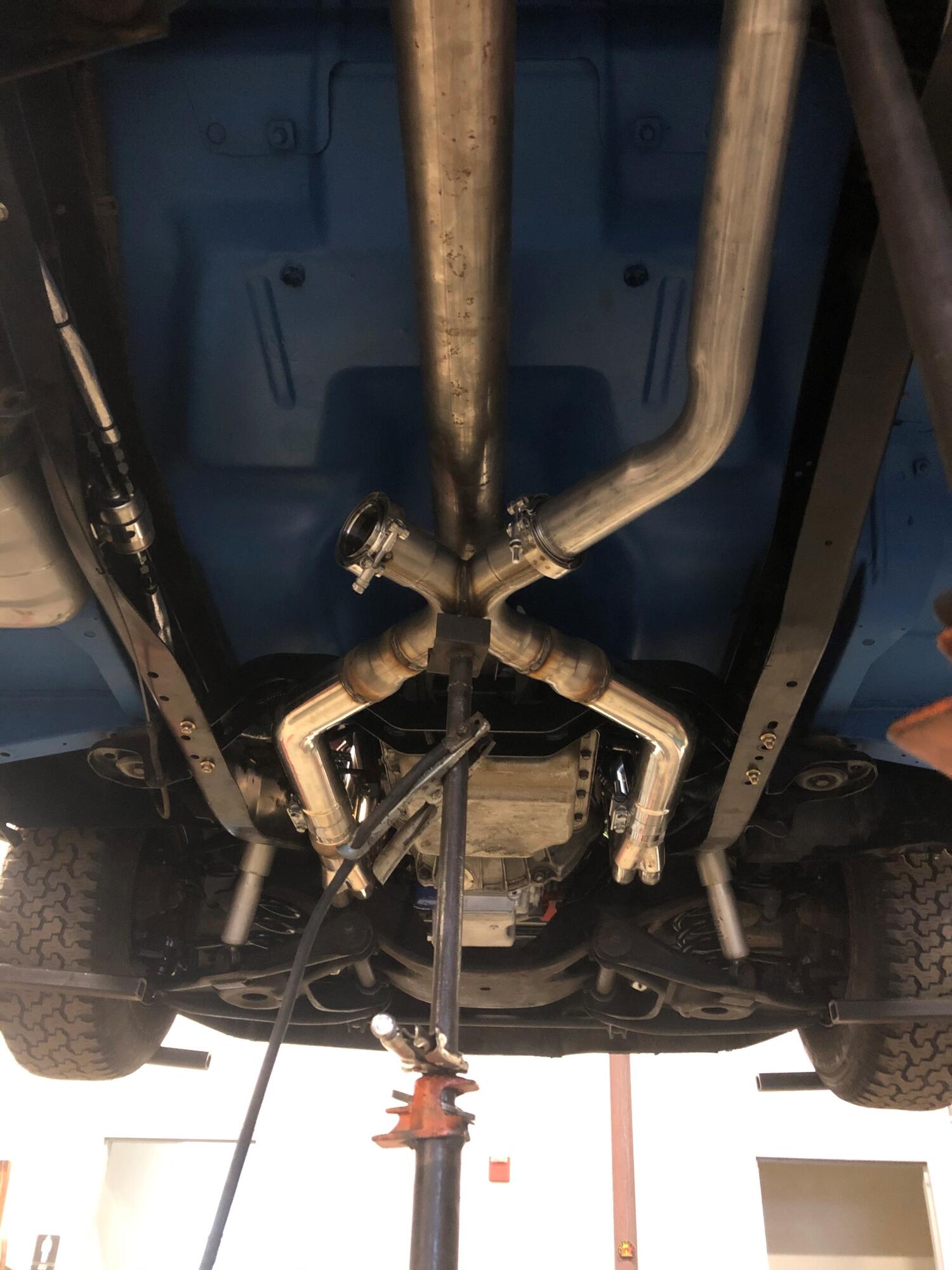

      Brought it back home, finished up a few things and tried to load it in the trailer to go to the exhaust shop and it wouldn't start again So winched it in the trailer and pushed it into the exhaust shop. They do good work but it's just a run of the mill shop, no mandrels or anything. For a driver, that's fine. Got 'em to neck down the 3" collectors to 2.5" pipe (I like the way it sounds raspier over the boomier 3" and I was hoping to mitigate drone), into an X-pipe and Borla ProXS mufflers.
      Name:  Exhaust shop 1.jpg
      Name:  Exhaust shop 6.jpg
      Took it straight over to my tuner and got it to start and cough once but that was it. Ran all the usual tests and decided we didn't have fuel. So down comes the tank again...
      Name:  3rd pump install.jpg
      Ended up bringing it back to work to get it out of his way. Got another Delco EP381 this time. He swears by these but I've had ZERO luck with them. I ended up redoing the wiring with a weather pack relay back there right at the tank and larger gauge wire and threw it all back together
      Name:  Exhaust shop 7.jpg
      That worked and he came up to start actually tuning it. Got it pretty decent but it had a dead skip at idle. Got the temp gun out and sure enough, #1 was cold. So he left and I pulled the spark plug, looked fine. Pulled the injector, it was wet and had been firing. That's weird. Pulled the valve cover and found the culprit...I forgot to tighten down one of the rockers
