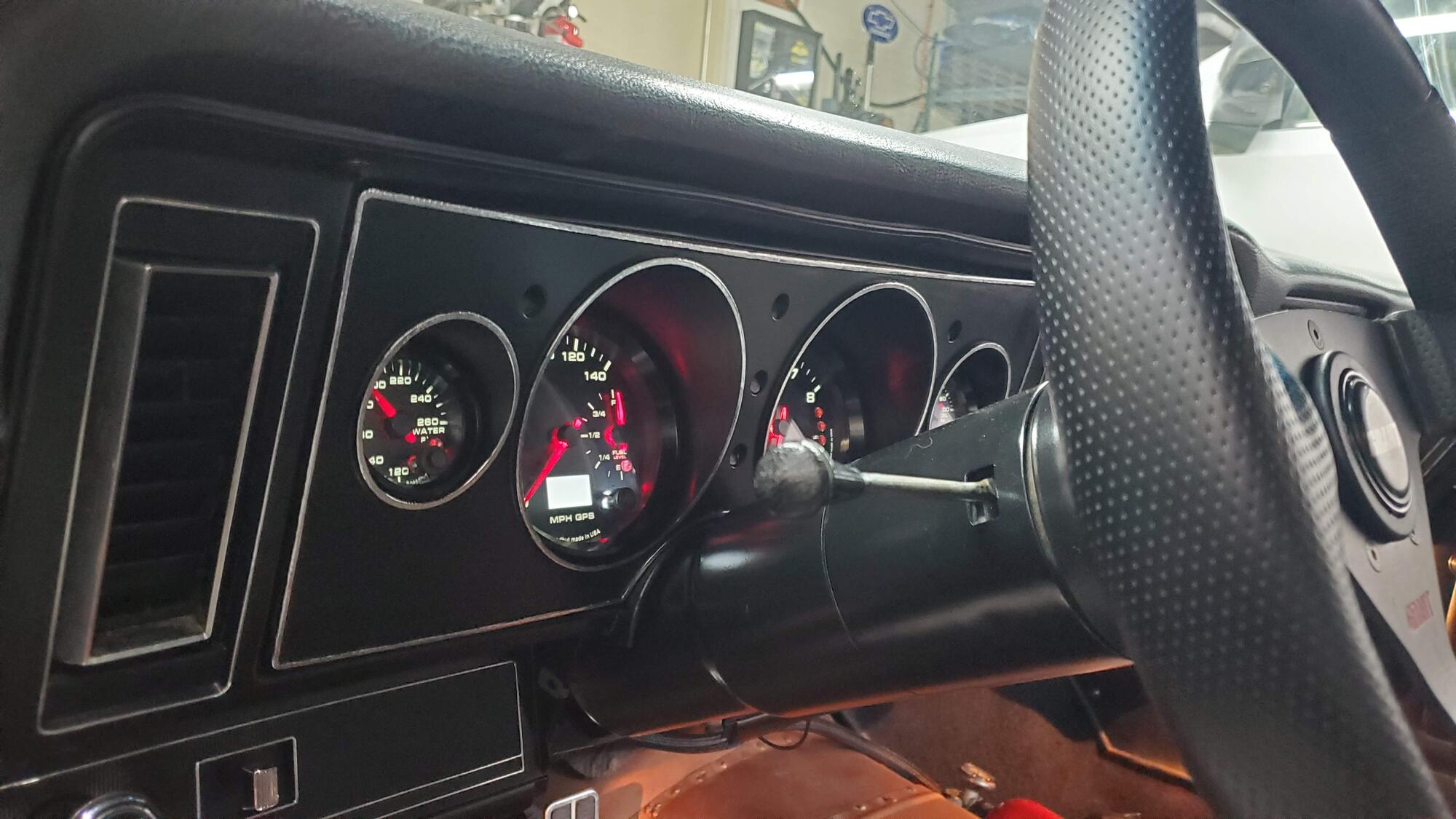

      I used D3D printing services in Tujunga CA to print my gauge cluster insert out of ABS. Mine measures about 18" wide and was printed with the front curved face down on the bed. I designed this myself. Looking at the size of yours, you may be better off using two pieces and joined by pinning and gluing, then hide the seam with body filler and sanding.

      Here you can see the layer lines before filler and sanding. They are a bit exaggerated because the face is curved. If yours is flat, the layer lines will not be nearly as noticeable or take as long to sand smooth.

      I used several coats of Bondo sprayable filler primer with hand sanding in between by an assortment of sanding sticks (made by gluing sandpaper to popsicle sticks) and sponges to clean up the layer lines. This took quite a bit of work and you might consider using vapor smoothing or another method of filling if you want things to be smooth.

      I finished my insert using SEM black interior dye spray (which I also used on the original dash piece) and Molotov chrome pen with a Alclad Aqua Gloss sealer for the 'chrome" edging.

      Getting the design right took a lot of time in CAD and I printed 2D templates from my CAD model to check fitment before I finally sent it for printing. It's not perfect but it's unique and was a really rewarding project. I hope you have a good experience!
