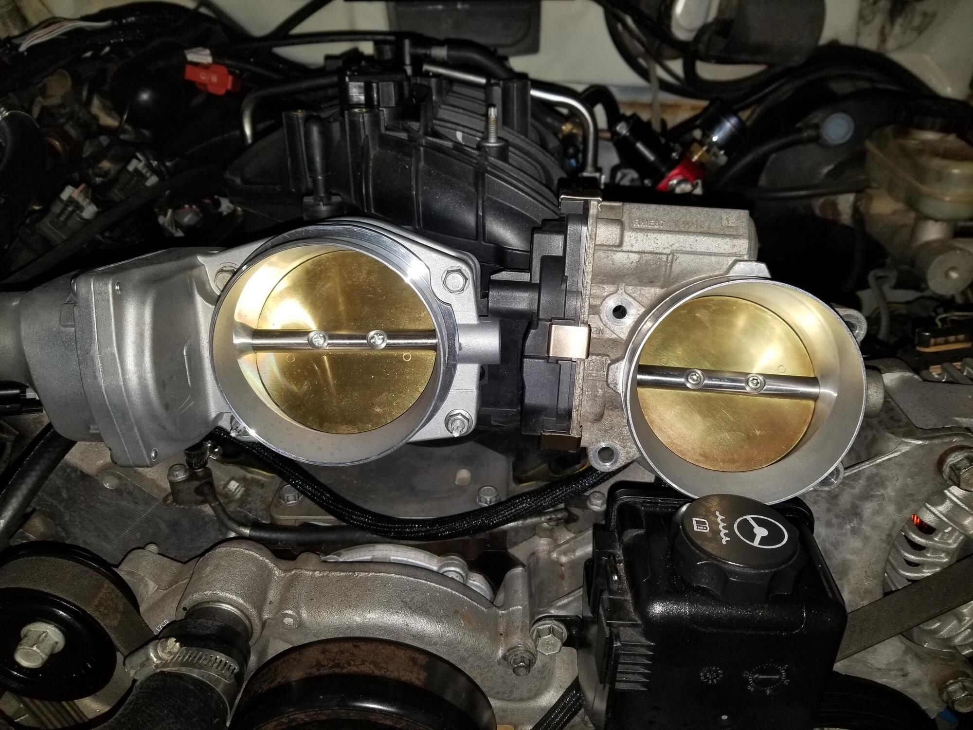

      out of curiosity, did somebody drill the throttle blade hole for that cam?
      Oct 2010
      SLC
      659
      Quote Originally Posted by KEGS73 View Post
      No.
      Zach
      Nov 2018
      944
      It might just be the picture, but the lower right side on the right hand throttle body looks like someone took a file to it. Might be enough to cause the problem.
