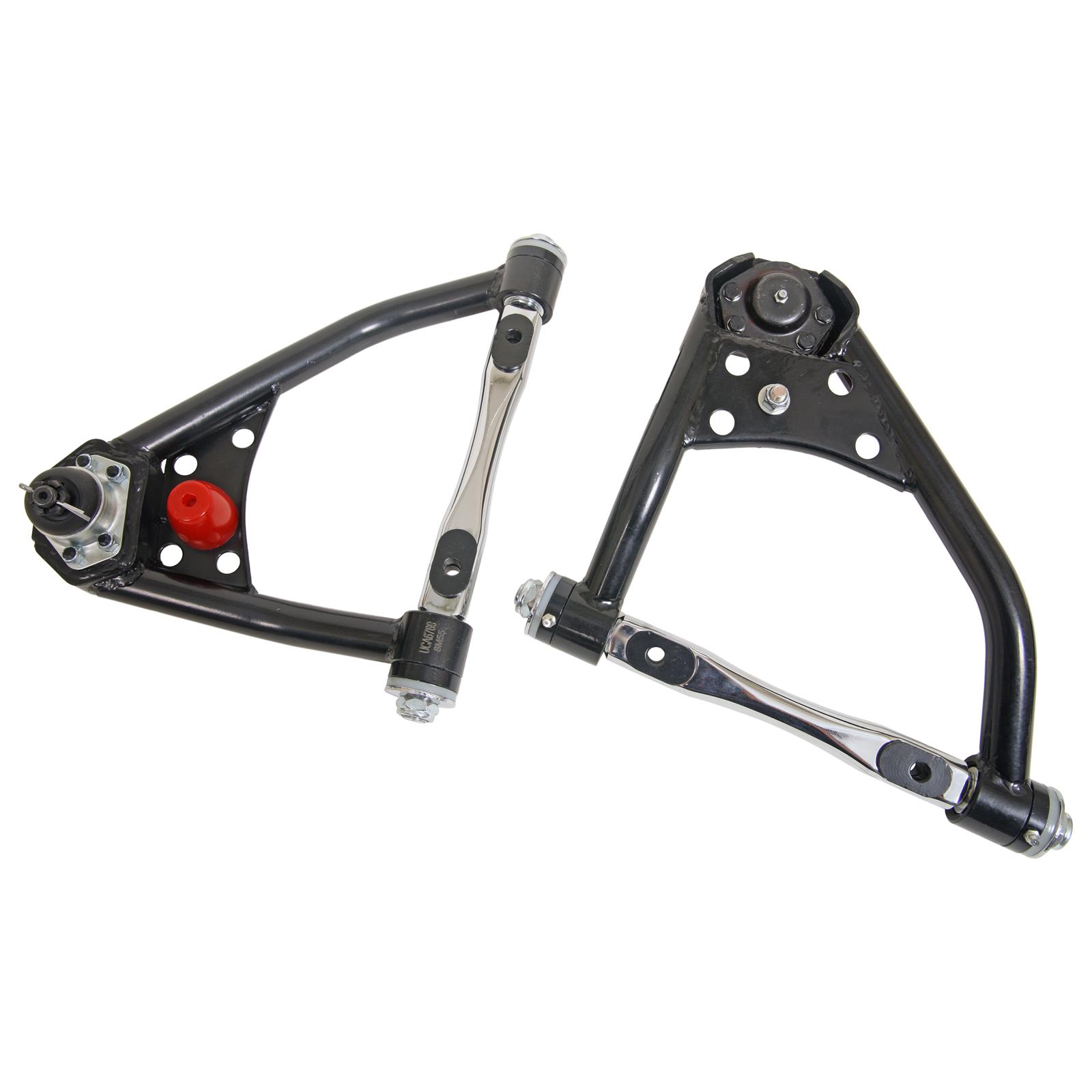

      No... the offset shafts allow more adjustment, but you have a clearance issue, not an adjustment issue.
      You need a smaller diameter upper control arm for more engine clearance.
      If you run out of stud for the shims, then you need the offset shaft.
      This smaller bushing like these from Summit will give you more clearance.

      Is your subframe mounted solid? Is something else loose? Lower control arm bushings good? Doesn’t get much easier than aligning these old Chevrolets. I never cared for the shaft w/ the shims; prefer something a little more solidly mounted. The suggestion of going to the SPC is not a bad idea. The shaft is mounted without shims and you adjust the arms. So addresses your clearance issue and gives you the adjustability. Their lower arms give you a 1” drop and a little more castor dialed in. They have multiple options including accommodations for coil overs.

      +1 to the idea of the SPC arms. I put them on my Camaro several years ago. I tried them first with the stock lower arms, but adjusting in a lot of caster put the wheels too close to the rear of the fender wells. The SPC lowers cured that problem. Also available for the lowers are spring pocket shims so you can adjust the ride height.
      Still bothers me that the camber changed when you drove the car; see if you can figure out what causes that before you throw money at the issue.

      I would go with some SPC upper arms and tall ball joints from Howe or ProForged. Taller balljoints raise the upper pick-up points of the ball joint for better camber curve in suspension travel - see link below.
      Rodney
      https://www.spcalignment.com/compone...AFrom&to=USATo
      https://howeracing.com/collections/h...er-Ball-Joints
