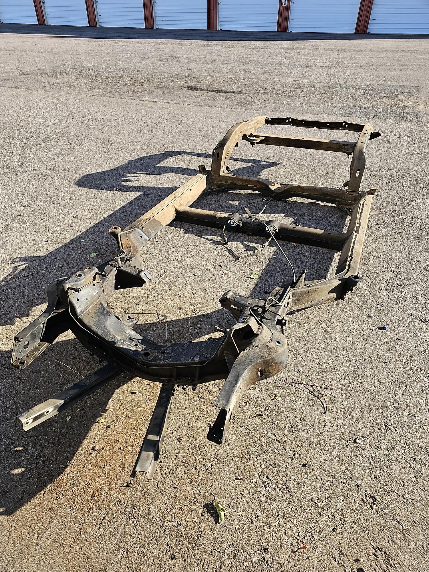

      Hi been on this forum for a while never posted just liked to look at the project updates. Well I thought I would give it a go on posting on my newest project. Most of my projects have both a Hotrod feel with a good amount of pro touring. I bought this 65 out of Idaho on a Facebook ad a couple of months ago sight unseen and to my surprise it was pretty much in better condition that I thought.

      The plan: The complete Vansteel catalog for suspension and brakes. Smedding Performance 416 LS 600HP in the process of being built. TKX 5 speed. Dakota Digital Dash.

      I then wire wheeled the frame zero rust which was awesome. Did the transmission mount cut out mod. Primed and painted the frame.
