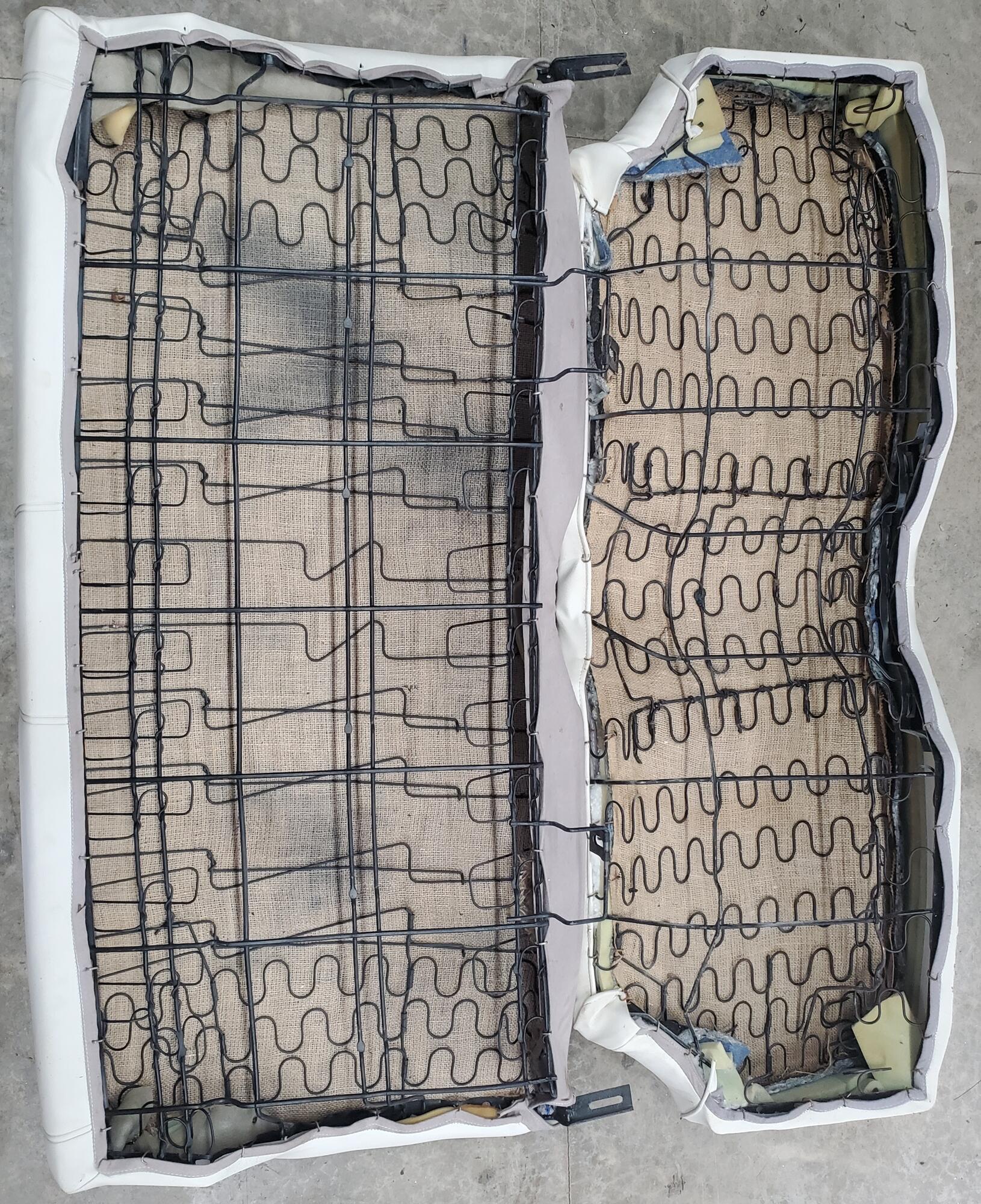

      Little update
      So I got my rear seat cut down where needed to acommodate the mini tubs. Honestly way easier than I thought it would be. Hardest part was not catching them on fire lol. Also got a little bracket mounted up to hold my Holley 3.5" touchscreen under the ashtray. Didn't take the best pic of that but you get the idea.
