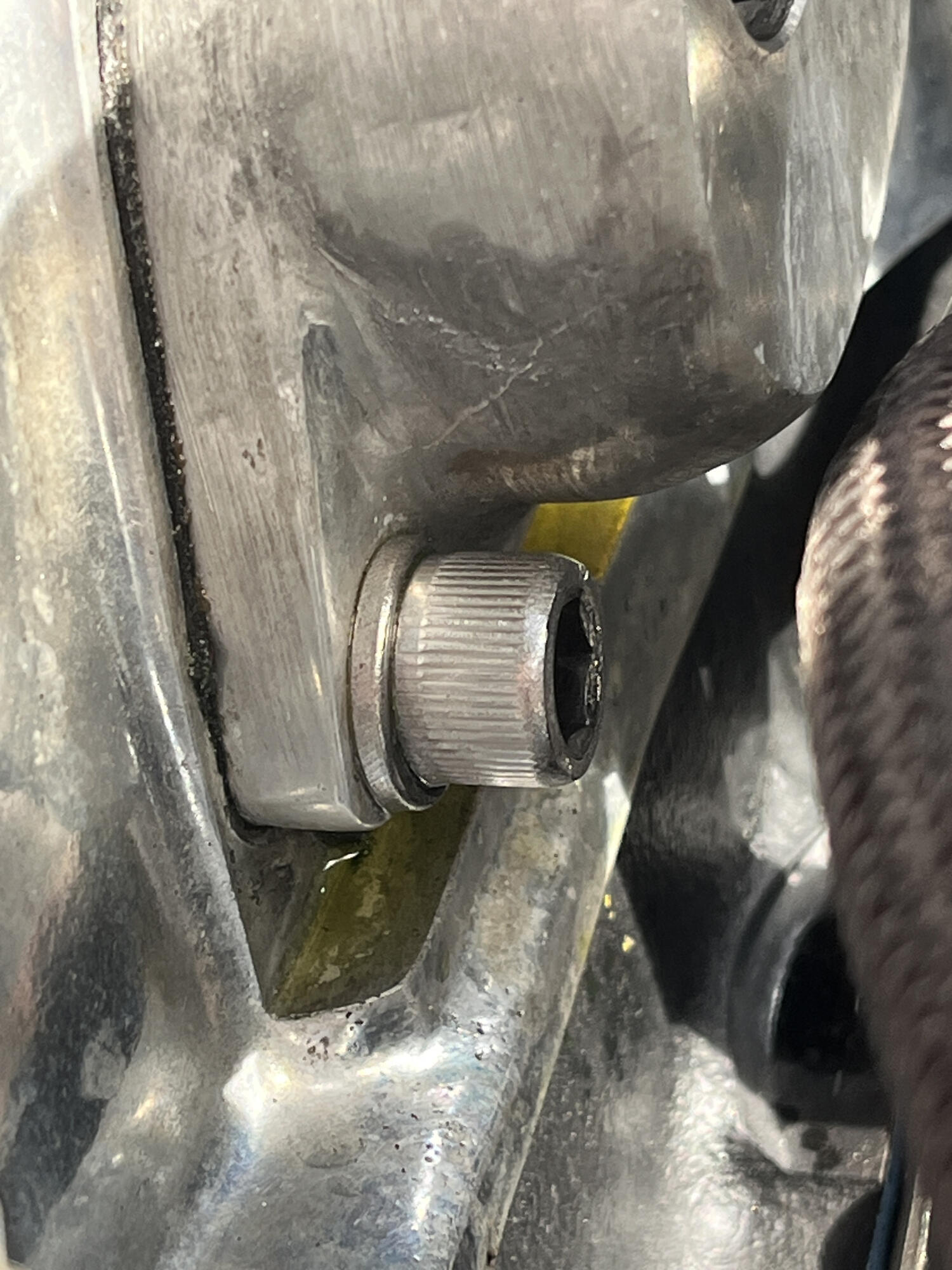

      Found some oil leaking here as well. Might need new seals.

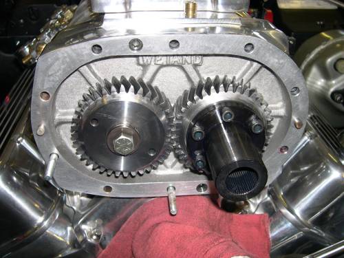

      Edit: I just now saw your above photo. I use a gasket not silicone.
      And this kit: https://theblowershop.com/product/fr...seal-kit-1152/
